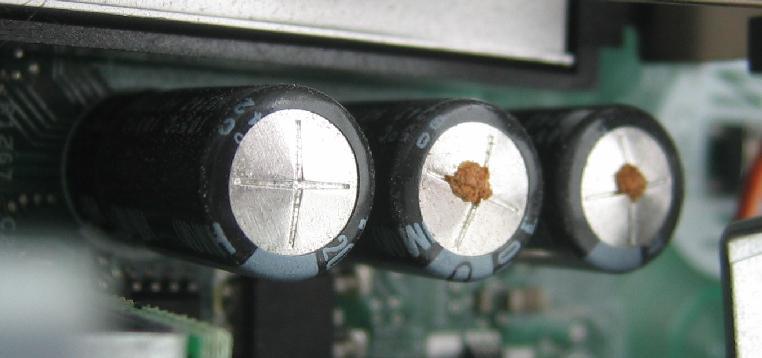

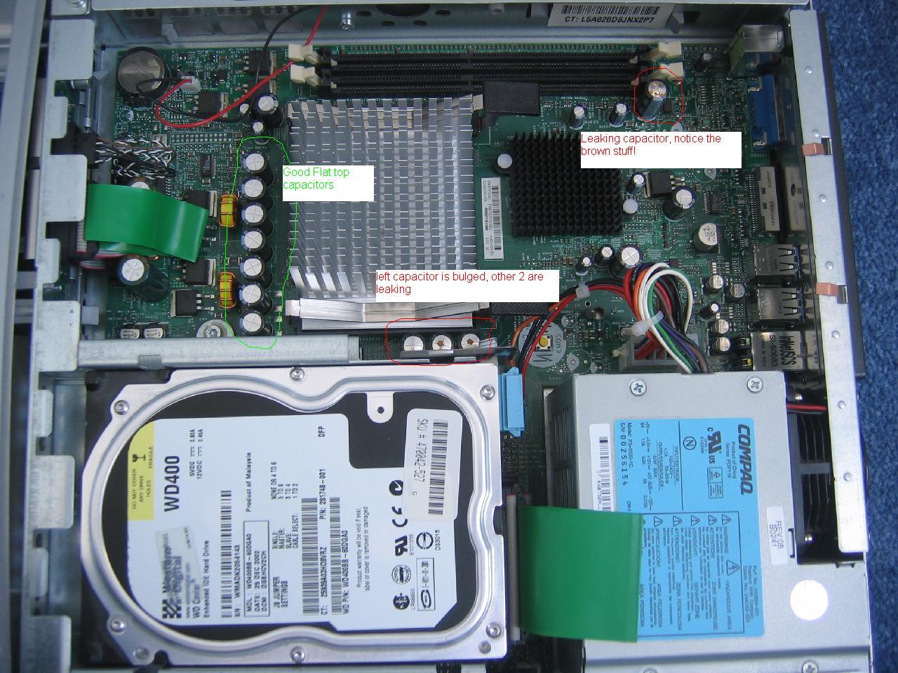

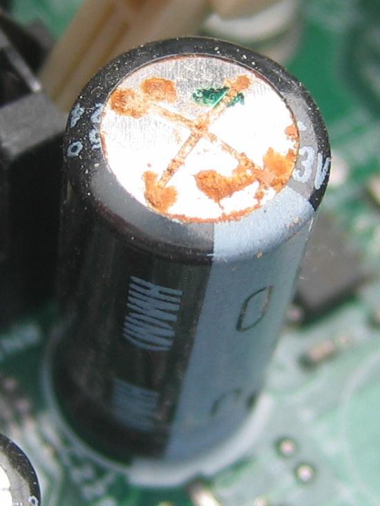

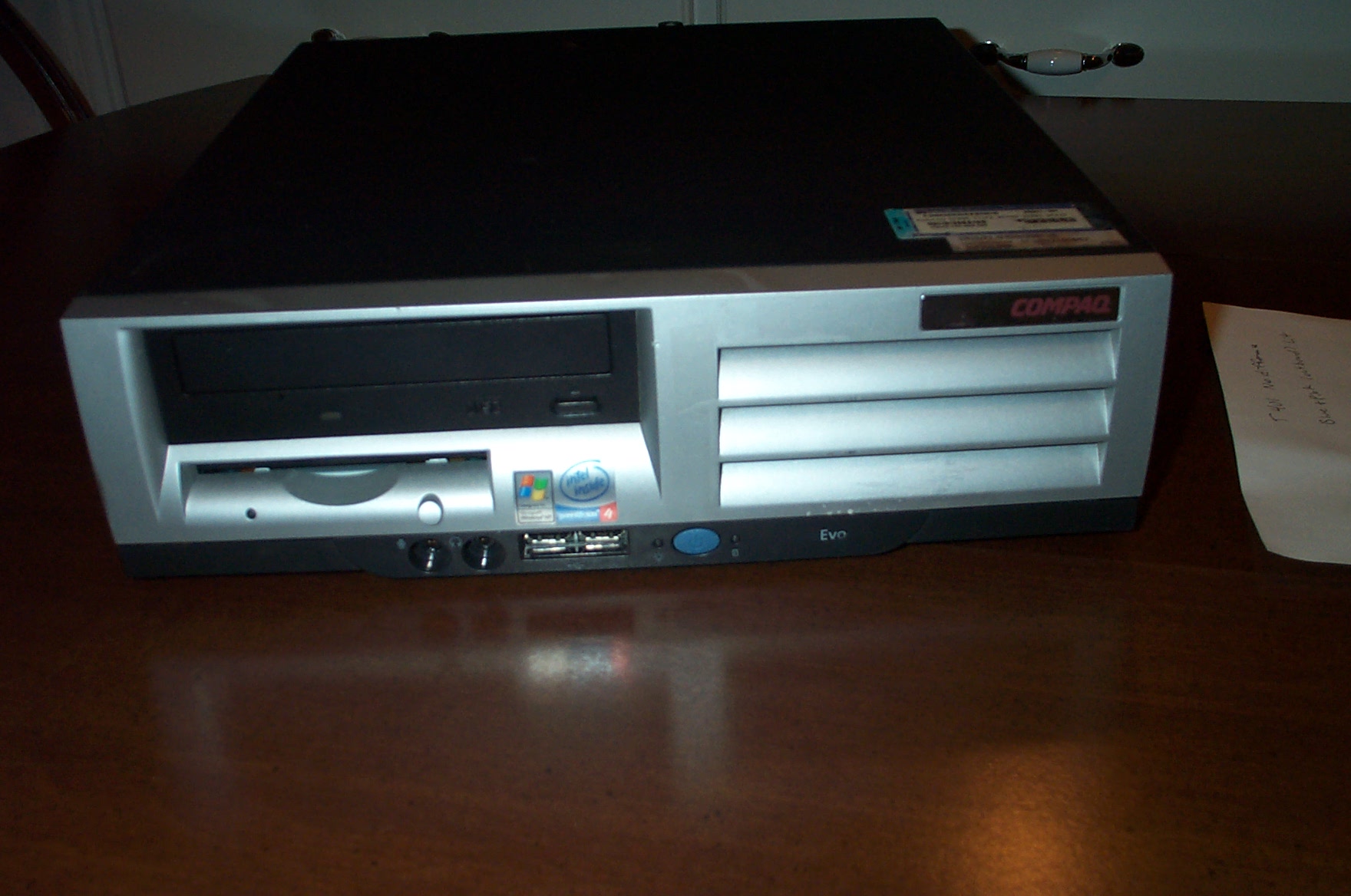

    I purchased an used Compaq EVO D510U (Ultra-Slim Desktop) and while it boots (I can't do any more testing because I don't have an USB keyboard and can't get past POST), I noticed 3 leaking capacitors and 1 bulged one. These desktop is very compact and may not have very good cooling?
    Obviously, I want to replace these 4 Nichicon 2200uF 6.3v, 10mm diameter, 20mm height, series HM(M), 105C. See pics.
    There are 7 Nichicon 2200uF 6.3v similar ones that look good with flat tops. It seems that the sentiment (but not consensus) from some on this forum is to replace them all regardless because if one fails, they *might/will* all fail, but since my soldering skills are a "D-" right now, I'm a little bit hesitant on a board this small with a lot of SMT chips next to the capacitors.
    Opinions on "don't fix it if ain't broke"? From skimming this forum, Nichicon seems to be a good name?

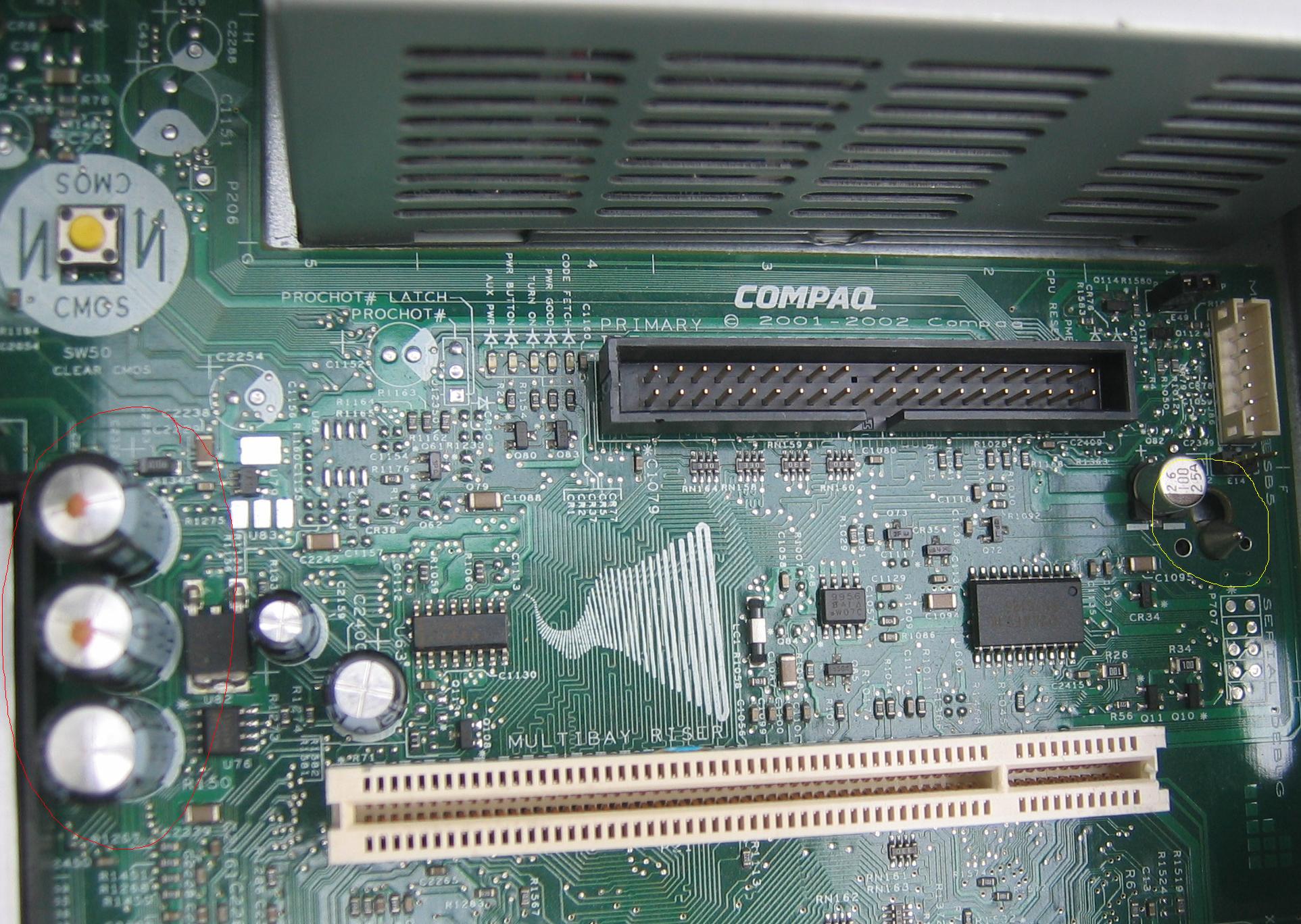

            I included 2 pics. I took everything out of the machine and need to change those 4 caps circled in red.
            There are 4 solid steel/aluminum standoffs circled in yellow. The problem is that I cannot move the board sideways. I have tried pushing the board sideways, but those steel brushed standoffs have a very tight grip on the motherboard.
            I also cannot remove the power supply because the motherboard is blocking it. I can't life the power supply out because the "sides" and back are solid steel and not movable so the power supply is "trapped" in there.

              And the secret I discovered today is:
              remove the heatsink and CPU.
              There are 2 screws holding down the motherboard (hidden by the heatsink). Once those are moved, the board slides out nicely.
              Got them recapped, but one cap lead broke in the desolder process - the other 7 leads were removed cleanly. Arrrgggh.
              I managed to work around it, but no amount of fresh solder, safety pin, etc would get it out. I didn't go any further since I didn't want to dislodge the solder pad from the board.

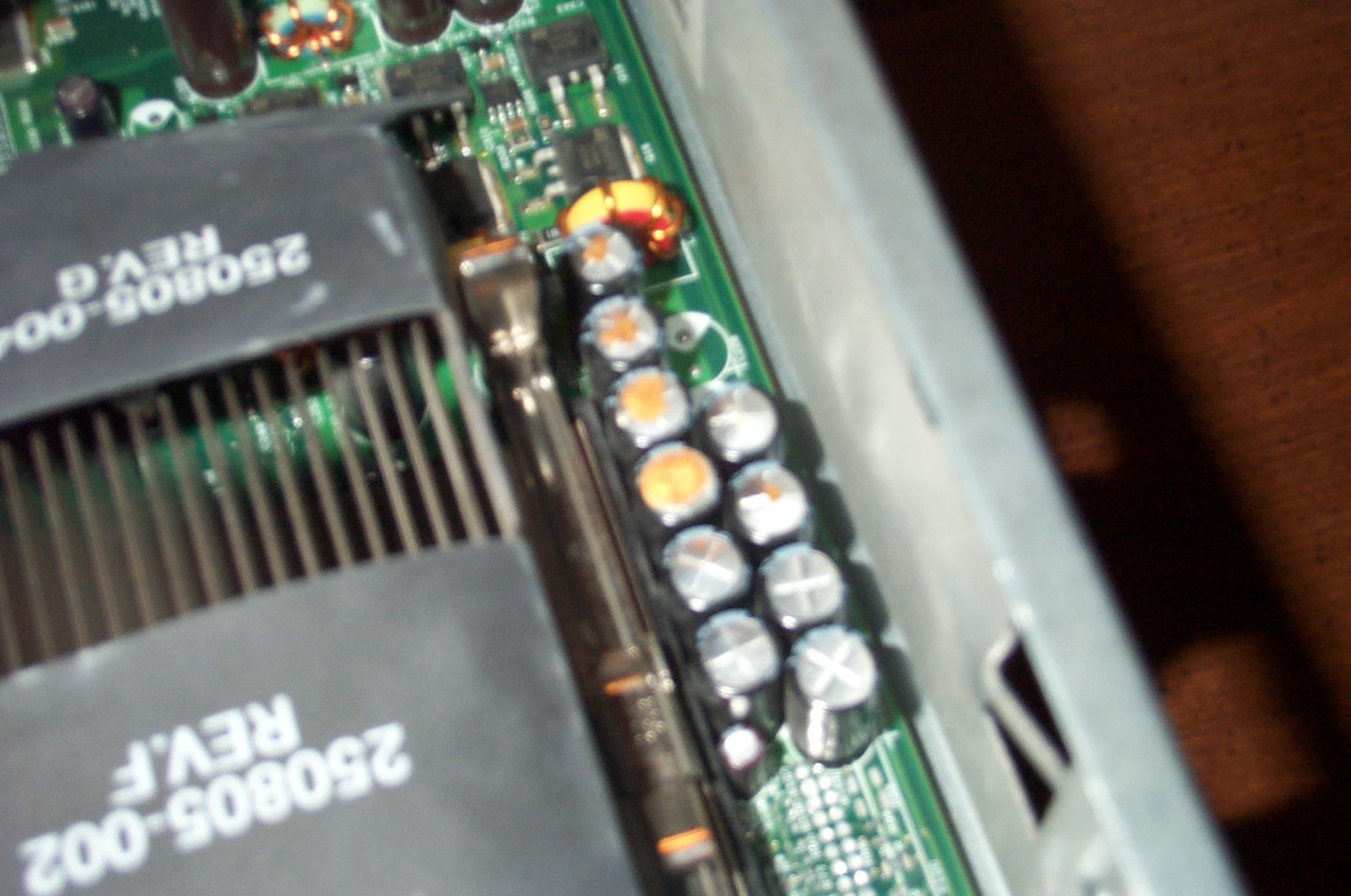

                  I just picked up a Compaq Evo D513S over the weekend at the off lease computer store. I took the lid off to clean out the dust bunnies and lo and behold there were a dozen bad caps next to the CPU. All of the bad ones were Nichicon HM(M), date code H0306. Par for the course on those Nicicon's from the plague era. Its a good thing the store has a liberal return policy, because I'll be taking this one back!
