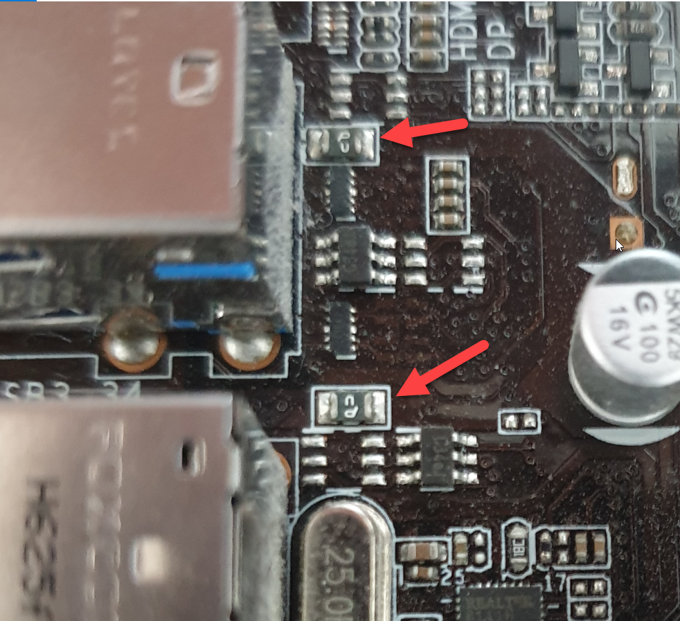

                    Take some pix of your board so we can compare them against what little public information is available on the net.

                      Here are the pictures. I got as many as I could using my S9 which has a somewhat high res camera so they can be zoomed in at.

                        Attached are the locations of your polymer fuses.

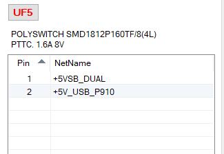

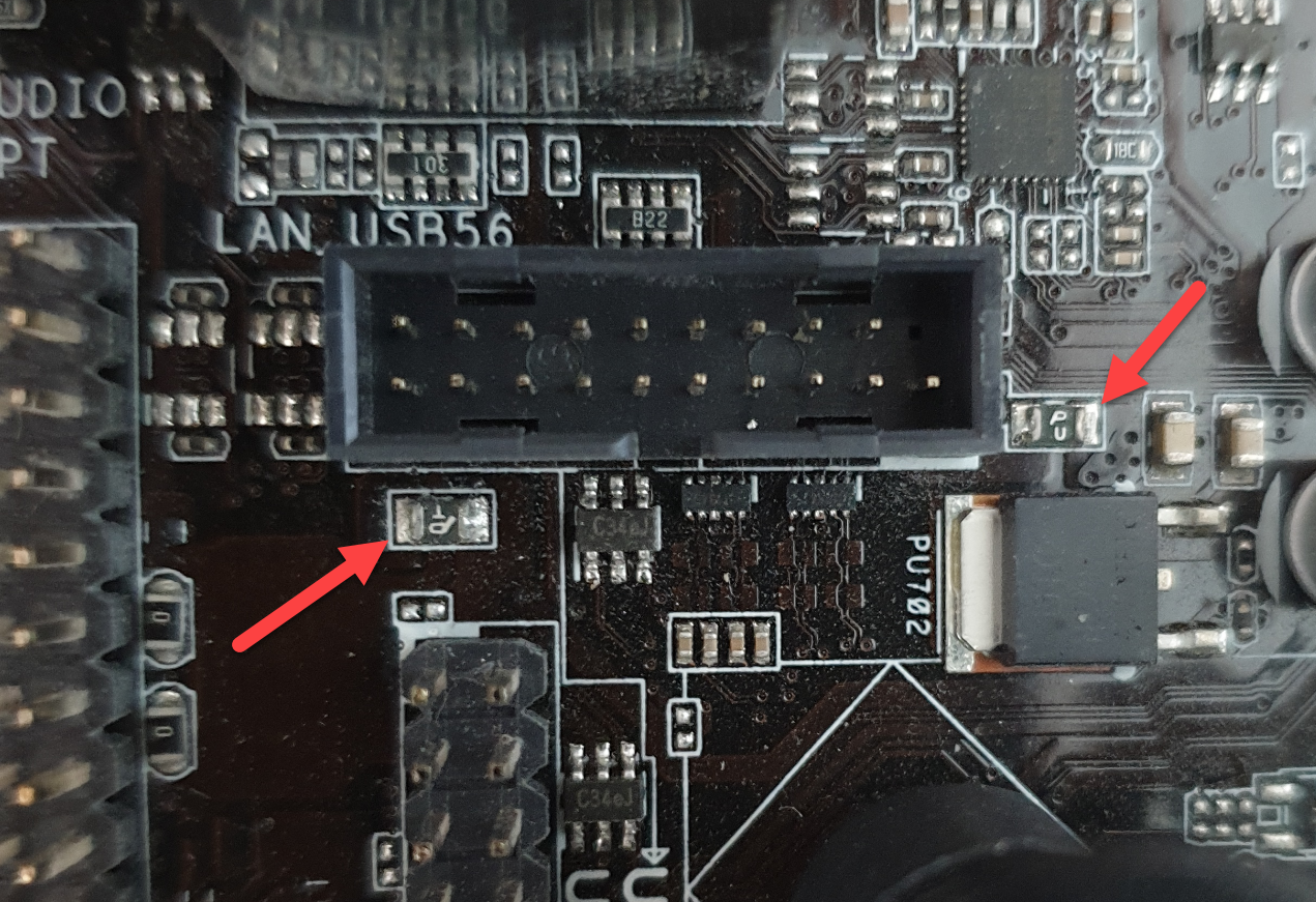

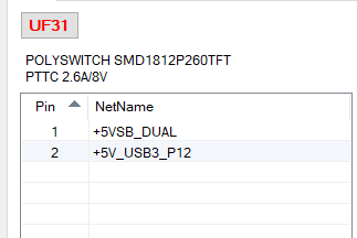

                                Hello everyone, I apologize for disappearing. I was extremely busy, but today I had a chance to look at the board again, and the schematic that was sent to me.
                                Unfortunately, the layout for the K version of this board is very different. But I had an idea: I tried to check if the ports are on some kind of different VBUS (because they have to be, right?) and they are not. Both USB2 and USB3 headers have a deadshort between their VBUS pin and the VBUS pin of the working ports, which is super confusing.
                                I suppose there could still be an inbetween component that's dead and causing a voltage drop on load (hence why my multimeter's little current passes through perfectly) so I guess the only way to firue this out is put a load (like a phone charging) and my meter in series with that. Otherwise, I'm not sure what else to do without a schematic.

                                  I this this might be it.
                                  It seems to have two different 5v lines and all ports are connected to it through small caps around 850uf (according to the schematic anyway)
