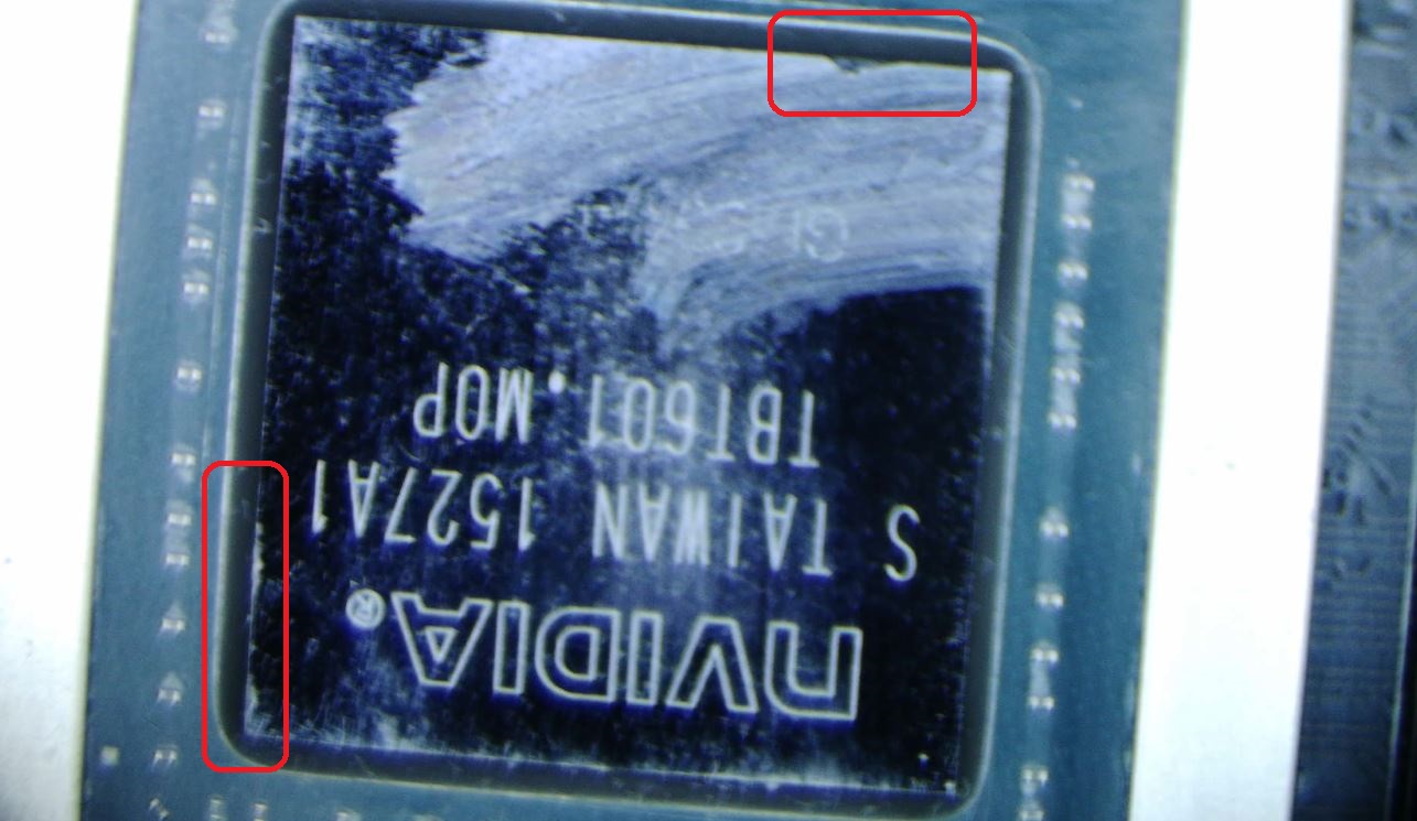

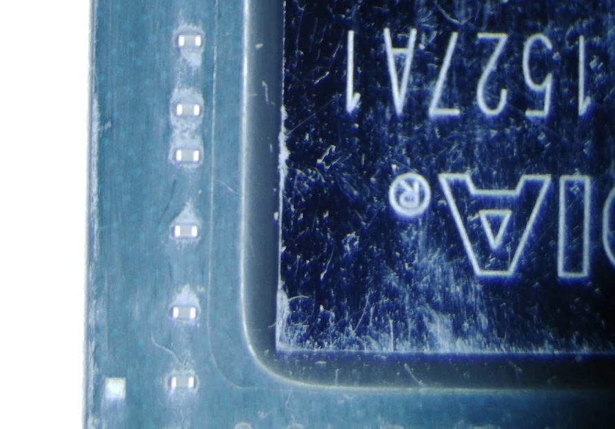

    Got this card broken, no image.
    Ive checked there are a few resistors and caps missing, also a small coil as far as I can tell.
    The point is that ive checked also the GPU die and Ive found 3 cracks in the corner die...
    This would also need new chipset right?
    Or still could work?
    Just to know if its worth trying to identify the few missing components and give it a try.
    Would be good to hear the opinion of someone who had several of these
    Thank you

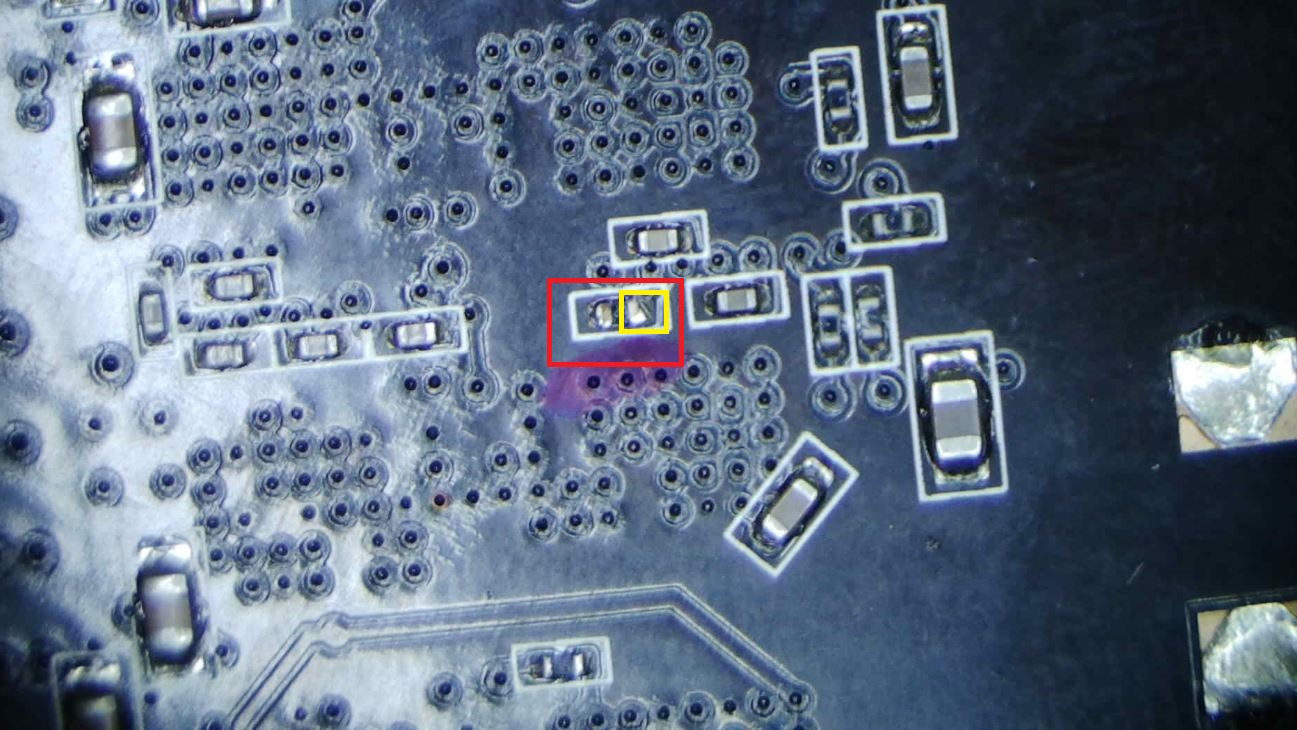

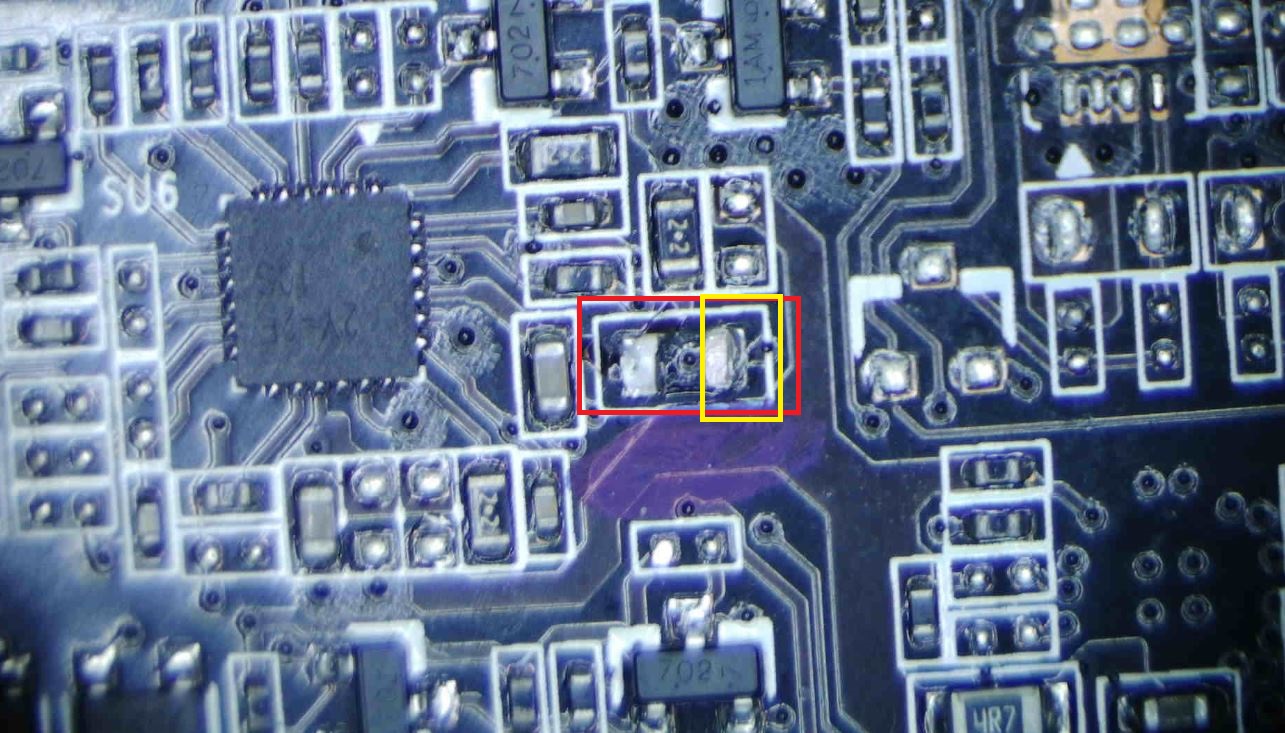

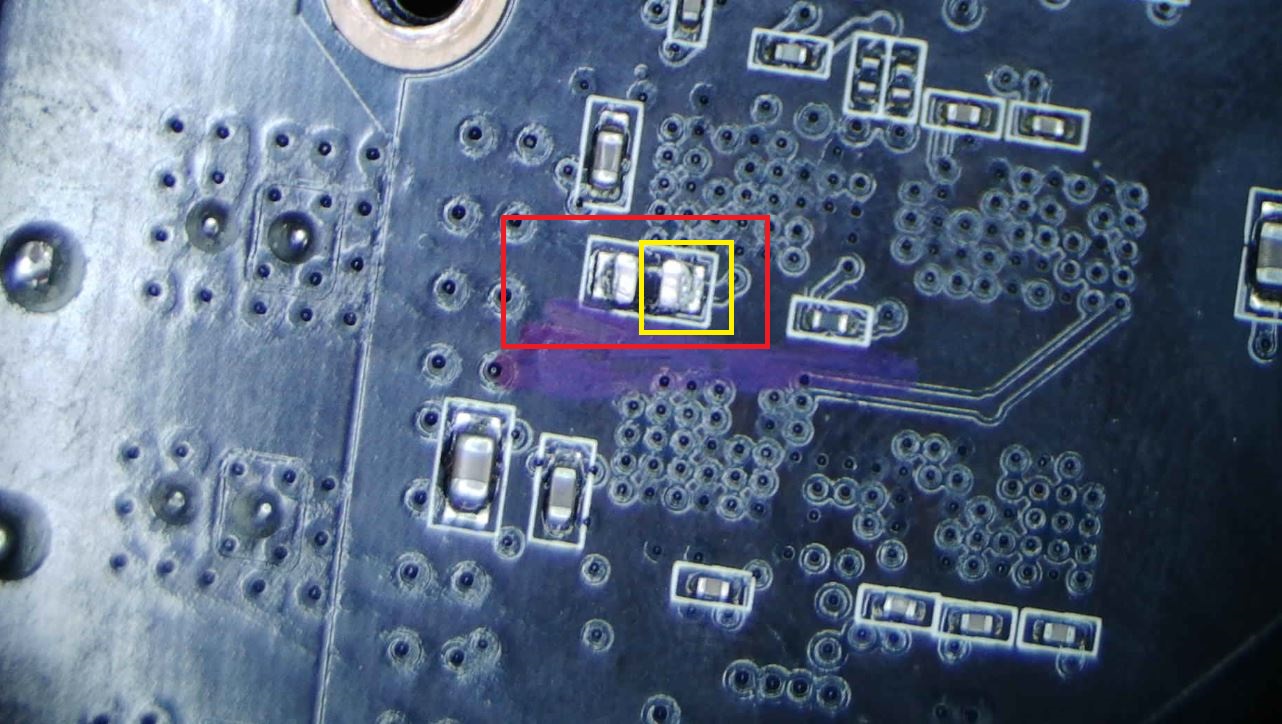

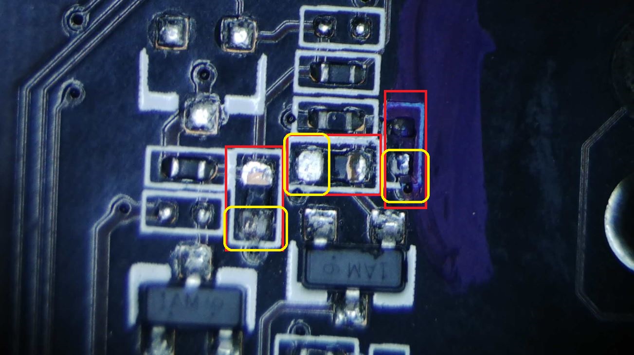

      Just visual inspection, and found these components missing (see pics)
      For what I know, it does not give an image and fans do spin.
      I can test it later on.
      In these pics in red the components missing, in yellow the ground pad.
      Pics 3,4 and 5, its almost for sure a cap, so not the reason for no image problem for sure.
      Pic 2 its where I say it could be a coil, but now that ive measure the ground pad, most likely a cap.
      I think the most important components missing are in Pic 1, where there is for sure a resistor missing.

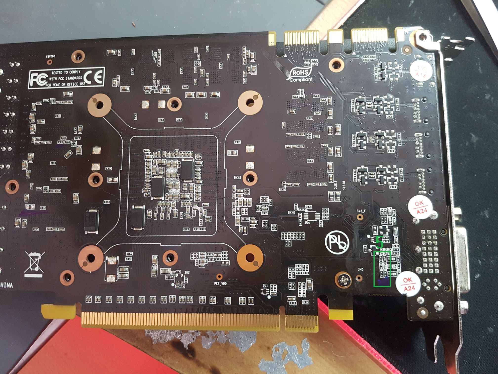

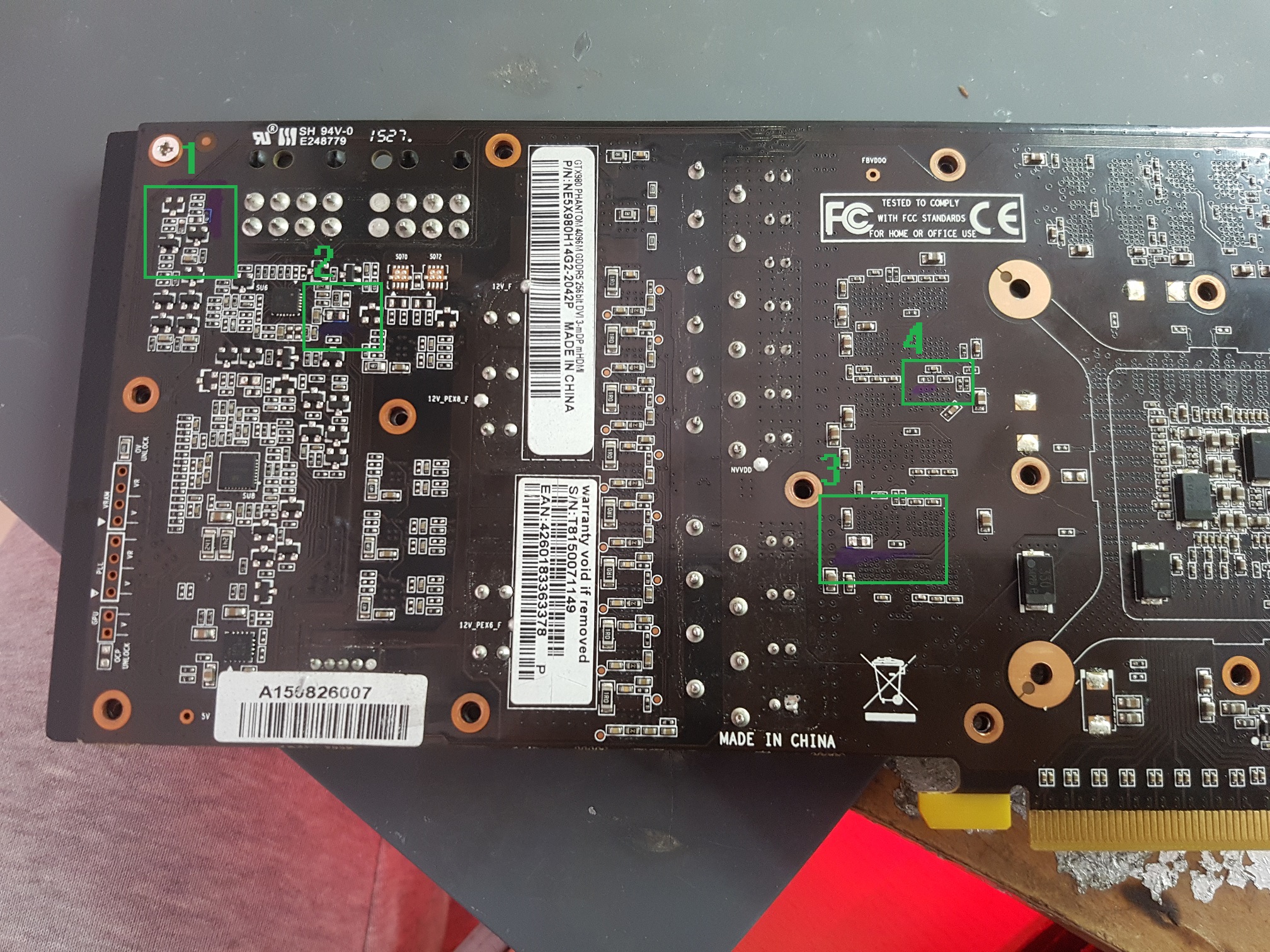

      ive also identified the zones in the PCB in another pic.

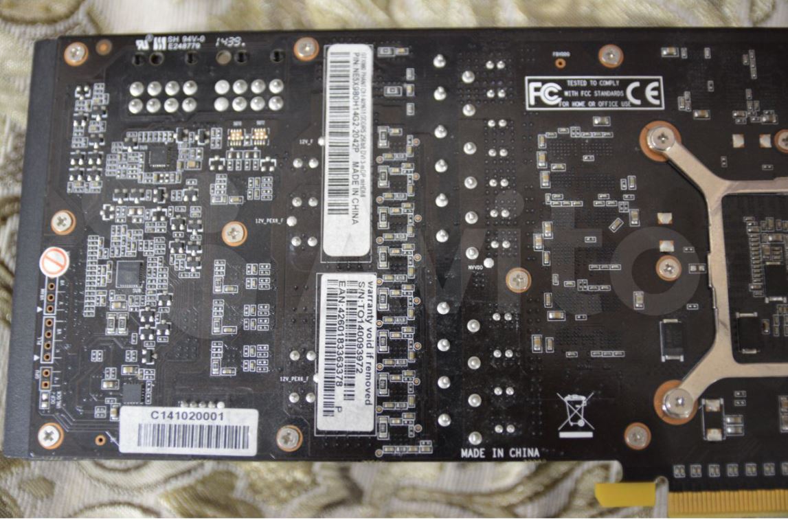

      And also the best pic of the same PCB of the same card I could find to compare.
      What do you think? waste of time?

          But before this Ive checked on the PIC1 where we can see 3 components missing, one of those is indeed one resistor, and comparing with other similar Mosfets below that one, a 1K resistor.
          Ive soldered it back, and fired up the card.
          Fans spin, GPU chipset heats up.All tensions are present.
          Screen detects the input and resolution, but no bios screen or any image.
          All other components are 90% for sure caps, so would not cause the card not to boot.
          I think those cracks in the GPU die will be the sentence...

            No, but knowing how problematic the GTX980 cards are (well, all large-die, high-power GPUs are these days), I don't suggest spending too much effort on it. Good chance the GPU is probably toast too, and not just from the cracks in the core.
            With that said, probably replace all of the critical SMD parts (looks like there may be a few, but not all of them are) and give it a try. If nothing, check all voltages (which it looks like you already did.) If voltages are correct and GPU still appears dead, give it a baking/reflowing as a last resort. If that doesn't bring it back, it's probably dead for good.

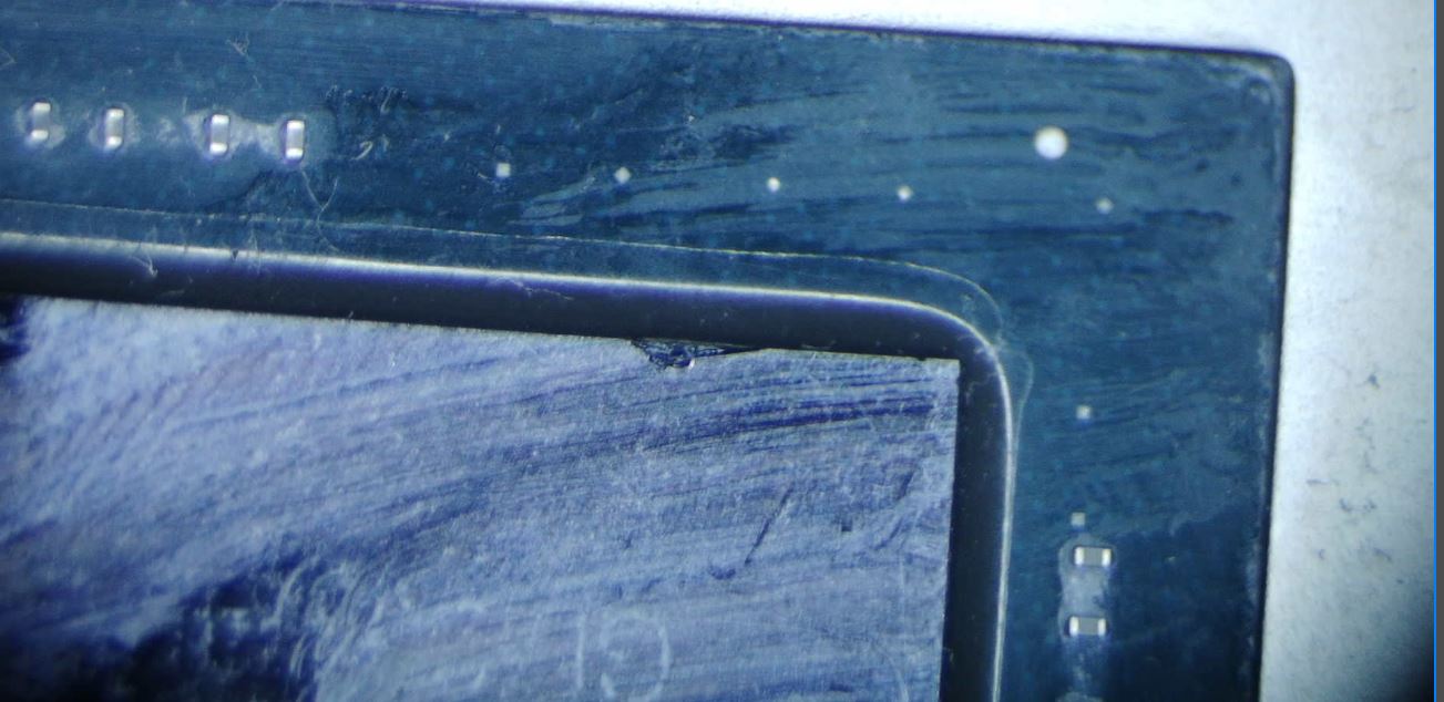

            The cracks in the corner in picture #2 likely aren't an issue. But the one crack/chip shown in picture #3 is not in a corner (though it is at the edge), so it could be potentially fatal.
            Using this picture of yours as a reference...
            Area 1 is probably power detection logic circuitry, so you will likely need to find out what the missing parts there are. Otherwise, card may not POST.
            Area 2: this appears to be some kind of a buck regulator controller, so MOST DEFINITELY find out what the missing parts are. Not having the correct parts here could cause an under-voltage, over-voltage, or just plain bad regulation on one of the rails, so the components in this area are critical.
            Area 3 and 4: I see only chipped/missing ceramic caps, which is *usually* no big deal, as most of these just filter the RAM V_dd rail. However, any missing resistors should be replaced back. Also, a few of the ceramic caps could be signal-coupling caps... so if any of those are missing or shorted, you may get artifacts. I saved a Radeon HD6850 video card from a fault like that (had a tiny shorted ceramic cap used for signal coupling and not as V_dd filter.)
            Area 5 from this image: those components are for the VGA (analog) output only. It looks like you're missing a resistor/jumper/inductor and a cap on one of the lines. But all that should do is cause missing Red, Green, or Blue color from analog output and nothing else. So no need to worry about fixing anything here, at least for testing.
