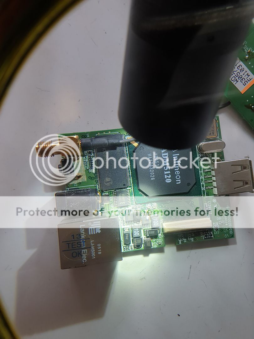

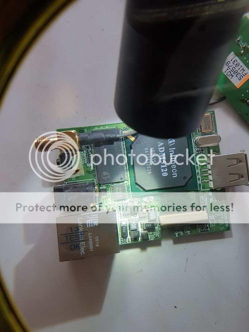

    Hi everyone, I was doing spring cleaning and came across a little box. This is a wireless lan USB print server. Model planes Mini-UWG. One of the component is burnt and the markings on it is charred. I would like to replaced it to repair, but couldn't make out the marlings. Luckily there 1 component exactly the same on the logic board.it says
    Row 1 - 1550
    Row 2 - C069
    Row 3 - 7GC
    I searched the internet but couldn't find any leads to the manufacturer or replacements. Any help is appreciated. Thanks.

      This is the one

        Which part is burned? Can you circle it?

          I can't find any information on the burnt ic, but the ADM5120 has a VDD of 1.8V and a DVDD of 3.3v so I suspect the two dfn8 ic's supply the two voltages

            Hihi, Thanks for the reply. Was away for a long time. It was tucked away while I was trying to fix my ps3. In that case, can I ask you what ic should I use to replace the 2 dfn8 ic? Thanks a lot for your kind advice.

              Its an Analog Integrations Corp. AIC1550 ,the datasheet is attached
