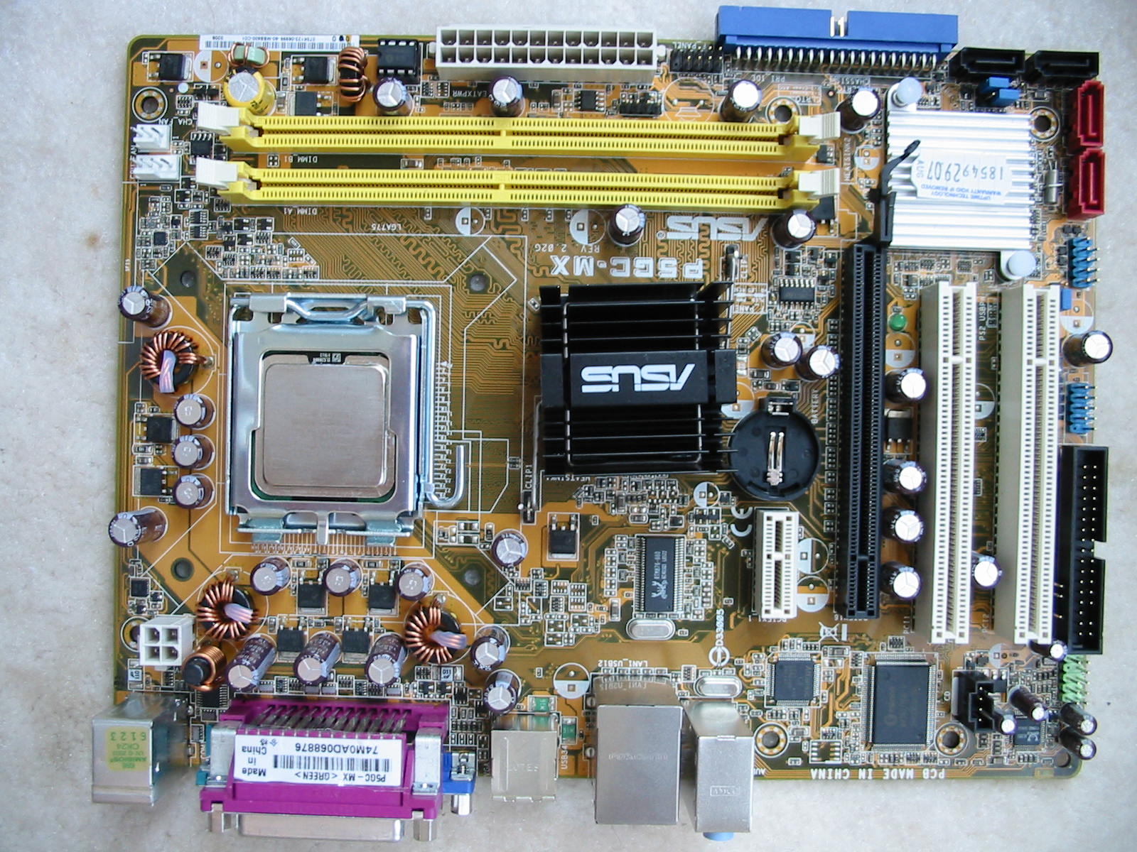

    Here’s another motherboard that needed a full recap: an ASUS P5GC-MX.
    This one was gifted to me some years ago by user Pentium 4, along with a few other goodies. It actually came in working order with no bulging or leaking caps. However, I noted there were United Chemicon KZG caps everywhere on the motherboard. The CPU VRM output (CPU V_core) was the only exception: it had only 2x KZG. The rest was 6x UCC TMV 4V 680 uF caps… which aren’t any good news either.

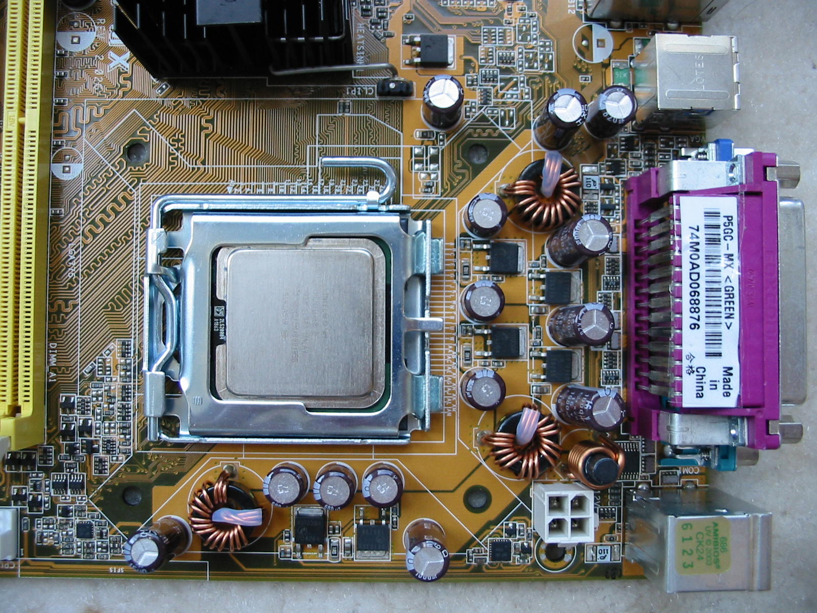

    So here is what the motherboard looked like with its original caps:
    CPU VRM area up close…
    https://www.badcaps.net/forum/attach...1&d=1611813246

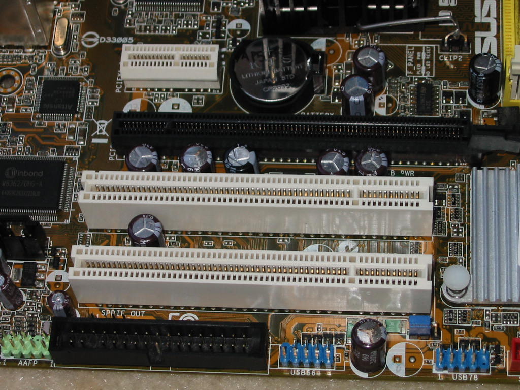

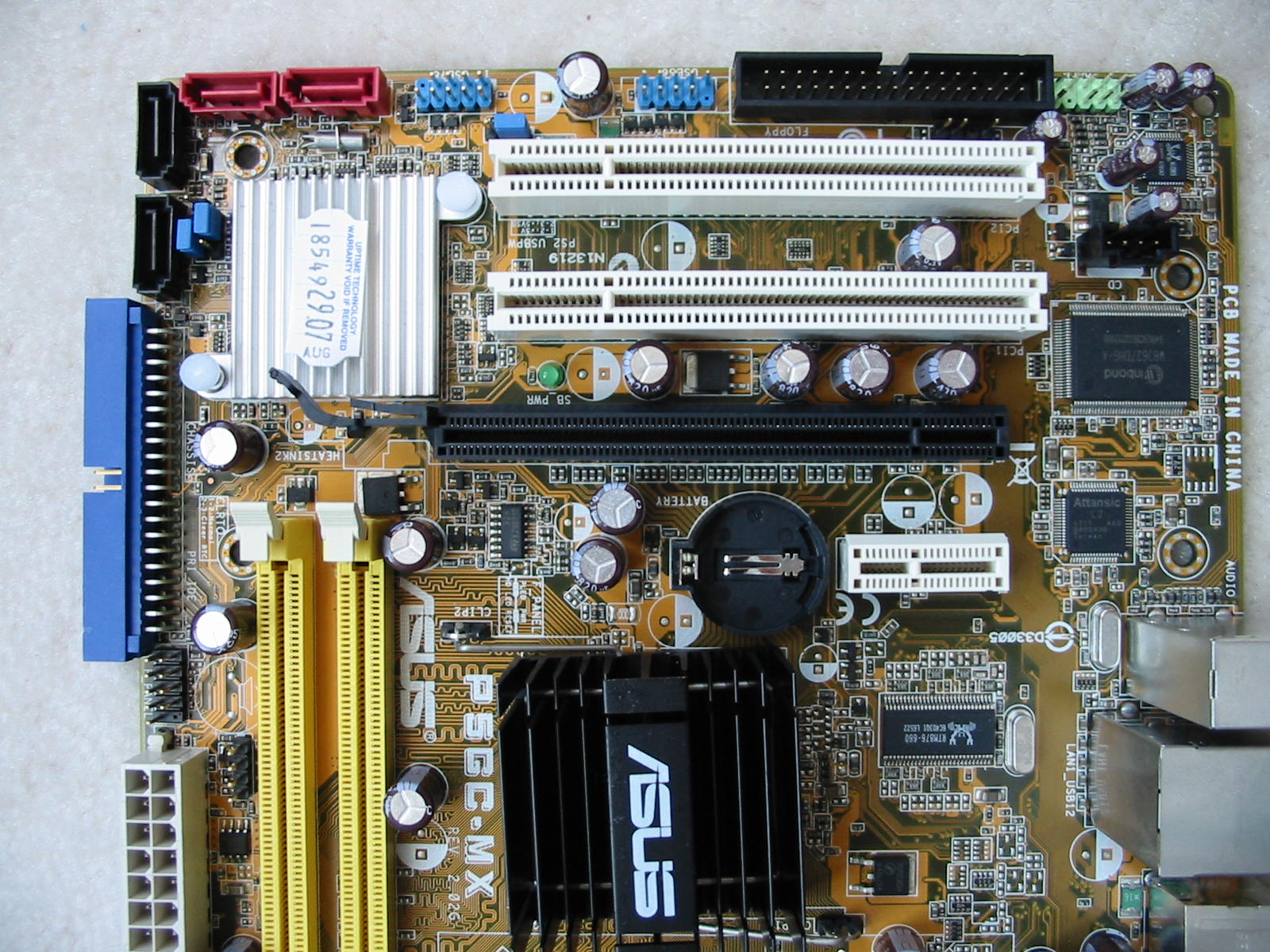

    And the rest of the lower half of the motherboard:

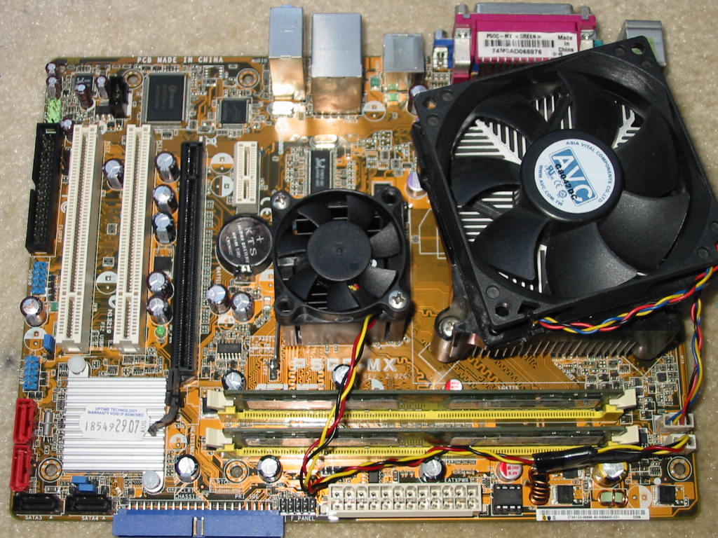

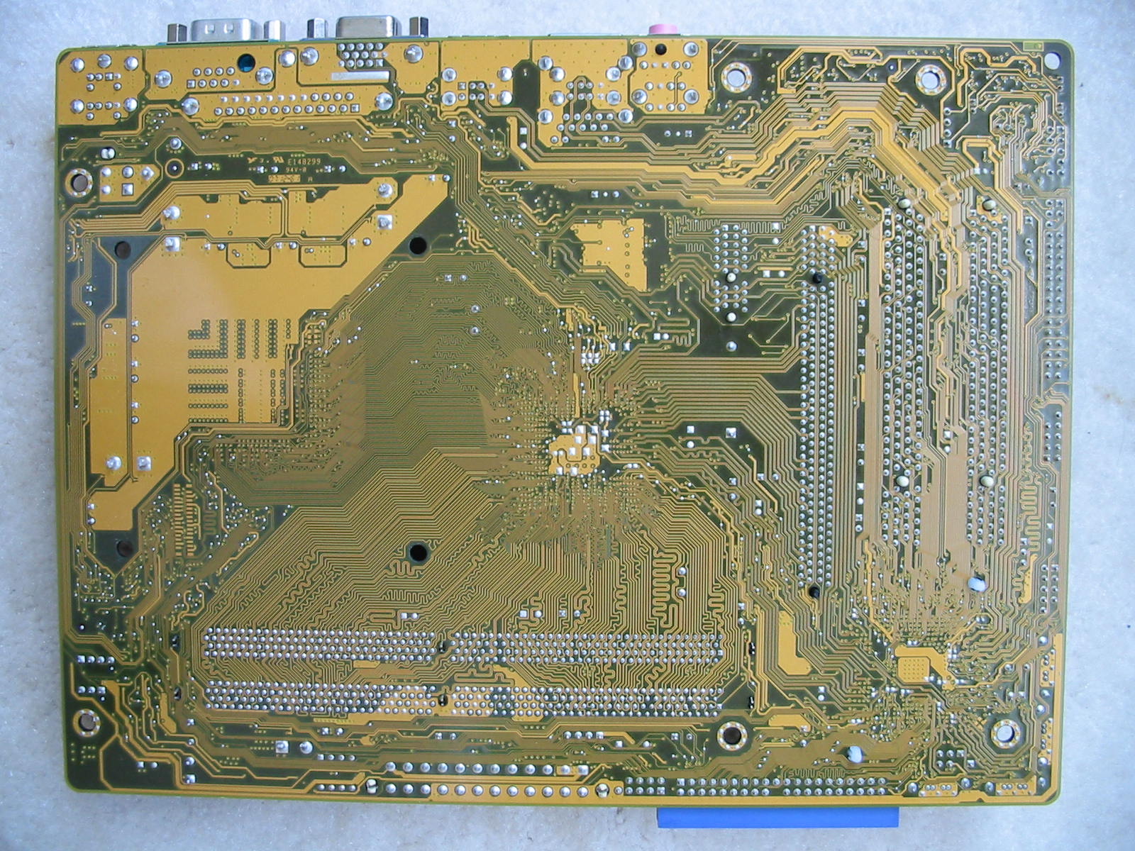

    Also including a back-side picture below, just because I really like the bright yellow PCB on those old ASUS motherboards. (I really wish manufacturers would stop making just black motherboards, like it is nowadays.)

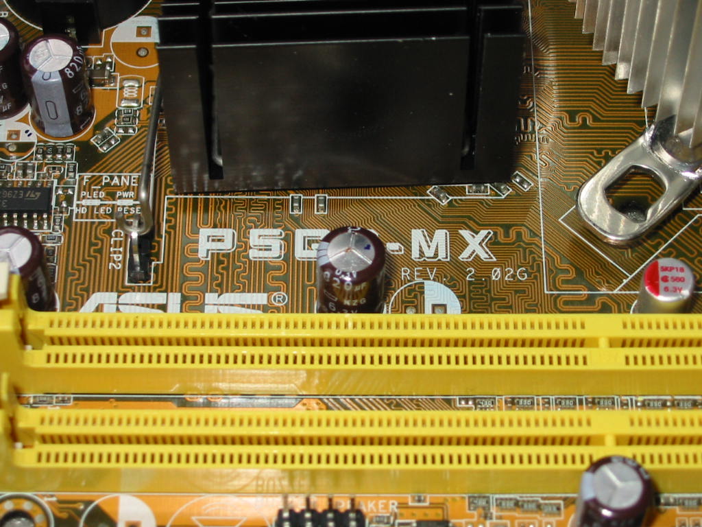

    I didn’t have any immediate plans for this motherboard at the time when I got it, but it was one of the best motherboards I had back then, so I started thinking what kind of system I should build with it. In the meantime, I decided to at least recap the CPU VRM output, since I remembered seeing threads here on badcaps.net that showed UCC TMV caps going bad. Moreover, I was told the motherboard had several 10k’s worth of power-on hours. So that weighted in even further on the decision to do a preemptive CPU VRM recap, rather than wait for caps to start failing on their own.
    Because these Chemicon TMV caps are right along the CPU socket (and in the path of hot air from the CPU heatsink), I thought it would be best to use polymers here. Also, since buck-regulated circuits put more stress on caps, I went after a few of the KZG on the RAM V_DIMM (RAM V_dd) as well.
    And speaking of voltage rails, it wouldn’t make sense to talk about them without showing a cap diagram. So here is that:
    Since no socket 775 CPU runs at over 1.4V on its core, 2.5V polymers on the CPU VRM output (CPU V_core, rail #2) should be fine. For these, I used 6x Sanyo SEPC 2.5V, 820 uF – a slight (but welcome, I’m sure) boost in capacity over the original 680 uF TMV. Meanwhile, the RAM V_dd runs at 1.8V (though some DDR2 RAM could require up to 2.1V), so I figured it’s probably safer to use caps rated for at least 4V there. Unfortunately, I didn’t have any 4V polymers at the time. However, I did have 2x 6.3V, 560 uF Apaq –branded polymers that came from a newer parted ASUS motherboard. So I pulled one 6.3V 820 uF KZG cap from the RAM V_dd rail and then substituted those two Apaq polymers. I then concluded the recap done for the time being, which was this:

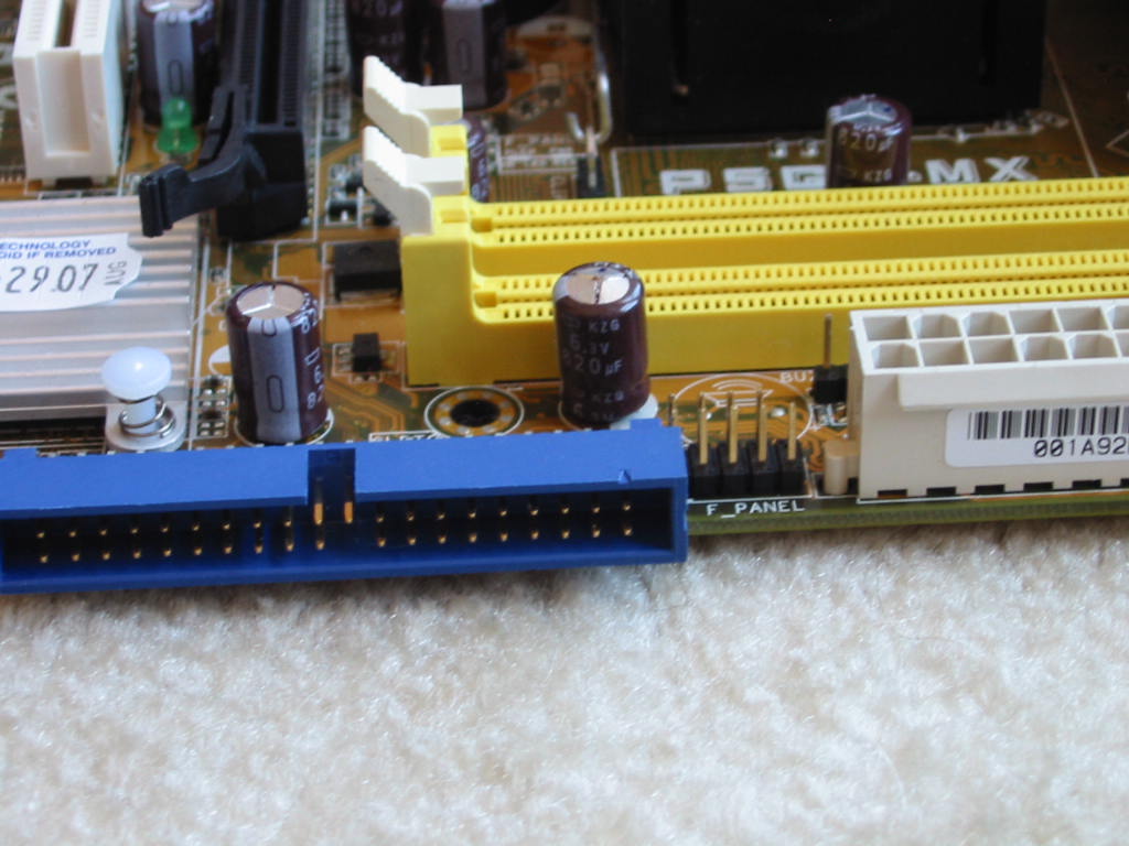

    Then I decided to take a look inside that PC one day somewhat recently, since it had been a few years and I thought it might need a dust cleaning maybe… plus, what a better time to check on the last few remaining 6.3V 820 uF KZG caps left. Sure enough, I found more bad ones! This was the motherboard as of August 2020:
    Basically, 3 more KZG’s had failed of the remaining 9 on the board.
    https://www.badcaps.net/forum/attach...1&d=1611813392
    Two of these were for the USB 5V filtering, and one for the 3.3V rail for the PCI/PCI-E slots. The other 6 looked OK and tested OK.
    This time around, though, I actually had all the caps needed to complete the recap. So I pulled the rest of the 6.3V 820 uF KZG out and replaced them with more Rubycon ZLH of same voltage and capacity.
    The only United Chemicon KZG that remain now on this motherboard are the 4x 16V 1000 uF units on the CPU VRM high-side. From what I have gathered over the years, 16V 1000 uF KZG don’t seem to be a common failure (I actually don’t recall seeing any.) Moreover, my parents have, like many other folks, started to move more towards using tablets. So this PC would rarely see any use anymore. Thus, as an experiment, I decided to leave the 16V 1000 uF KZG in there. I pulled one a few years back and it tested perfectly in spec, so I think it should be OK. The whole case has good cooling and those caps don’t run hot, so I do expect them to last. As another experiment, I even put some OST RLP for the filters on the USB ports in place of the 6.3V 820 uF KZG, since low-ESR caps are not really needed there. We will see how long those last, but I think they will be fine too. The PC barely gets any use now – mostly when someone needs to print or scan something… or when those silly tablets can’t open a page properly. As such, it sits turned OFF most of the time (but plugged in.)

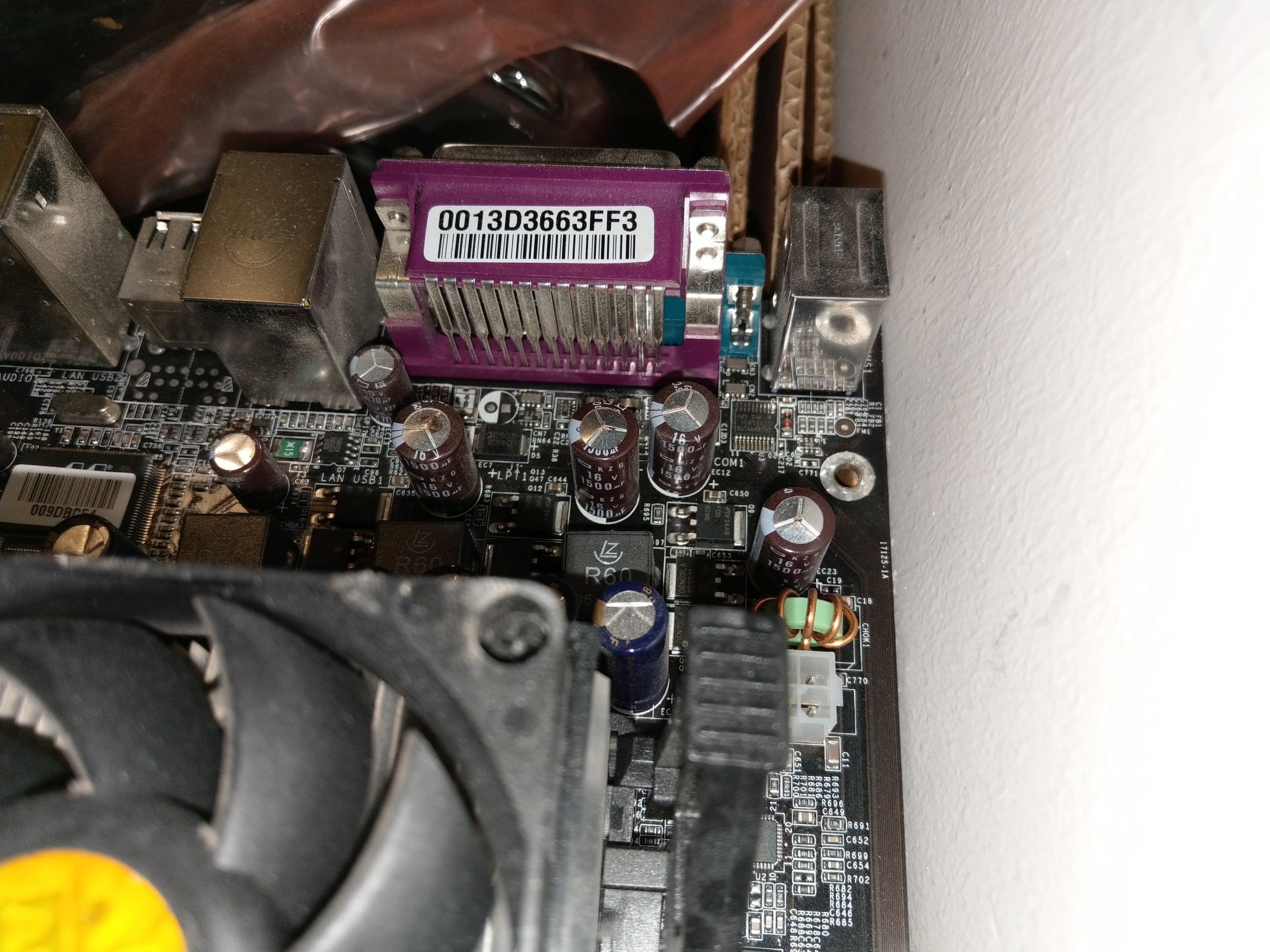

      Just realized something: that board I mentioned, the caps that have failed are momaka's favorite KZG 1500uF 16v
      So maybe you will have to replace yours too eventually

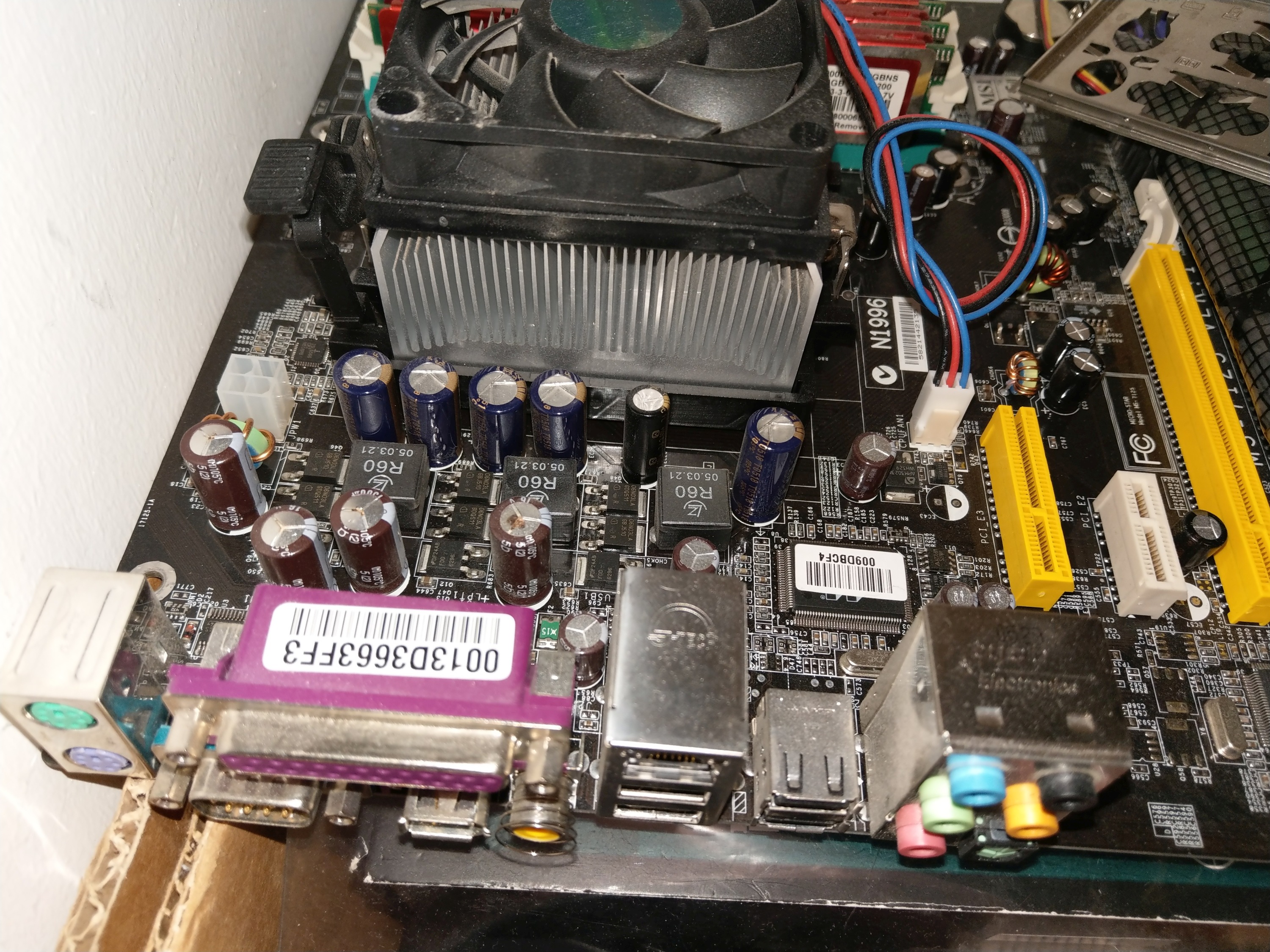

        odd those bloated when its an athlon 64 system u have there... msi k8n neo4, isnt it? athlon 64 systems dont really run hot. at least not at the level of the presshots... how's the psu and the ripple on the 12v output during load? dont tell me it failed in storage de-energized?

            Re: ASUS P5GC-MX motherboard recap
            I've seen 1500 uF 16V KZG fail before too on various motherboards I've looked at on eBay. But it's a rare occurrence. Nevertheless, I do replace them when I have a chance, as I have lots of Nichicon HN (H05 and later) along with MCZ (T05 and later.)
            Mine above are 1000 uF (@ 16V.) Not that this means they can't go bad... it's just that I haven't seen a whole lot of these fail. Will certainly keep an eye out on them from time to time.
            I also already replaced the 1500 uF 6.3V ones too... and they bulged in storage (with mild use as test caps) a few years after.
            True.
            But how hot the caps run can also depends on who made the motherboard.
            Generally speaking, MSI VRMs tend to be pretty well-designed and run cool - at least on most of their motherboards I've seen. ASUS - mostly good, but occasionally not so good too. Gigabyte was good with the old boards, but AM2 and newer have their VRMs run silly-hot sometimes.
            And Biostar and ECS seem to run hot no matter the CPU, if the various ones I have in my collection are to be used as an example.
                Yup, you identified it correctly.
                Originally if memory serves only one cap was failed.
                The others have failed in storage, well, the first one could have failed de-energized too in hindsight, I don't remember how long it sat here
