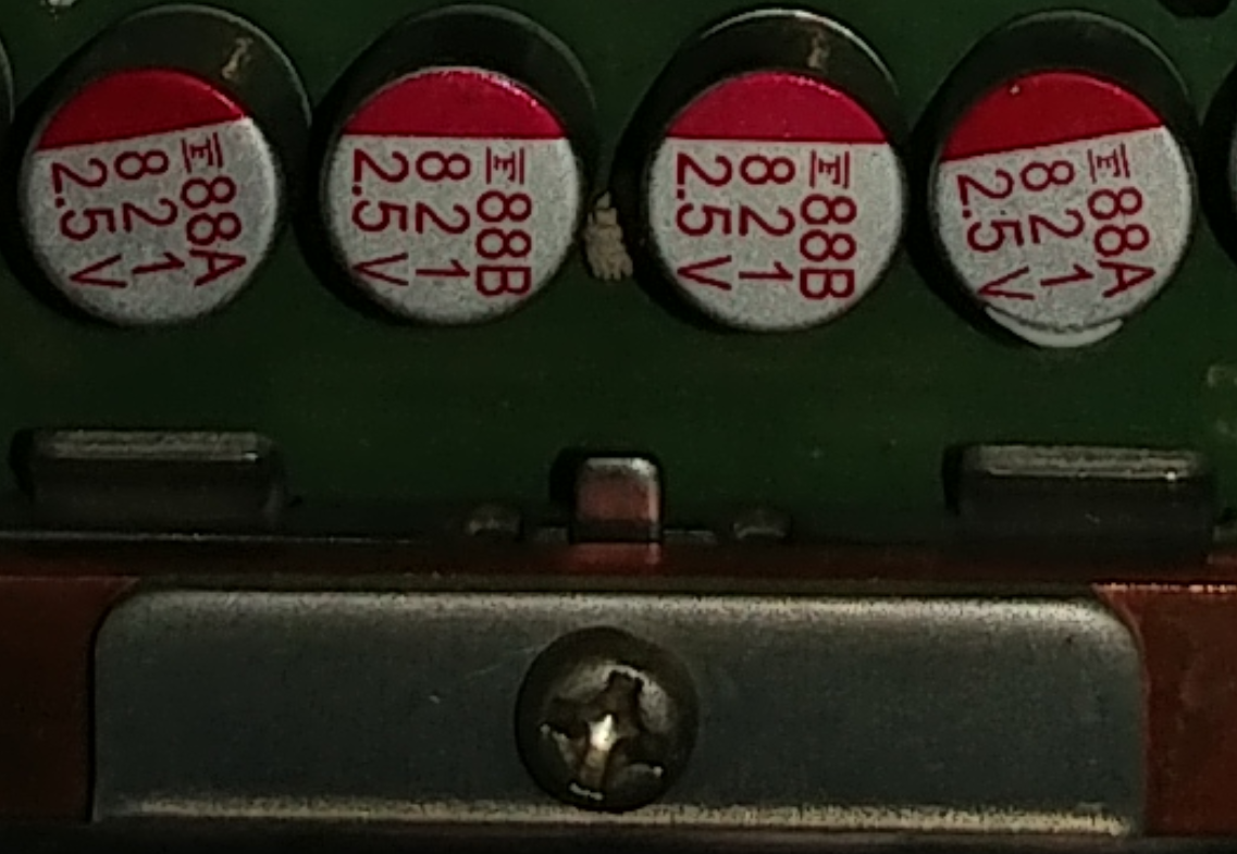

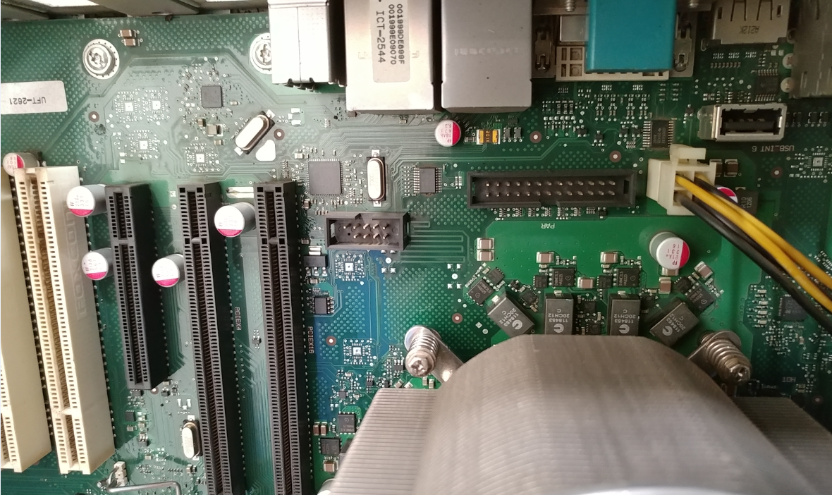

    Hello guys,
    I have Fujitsu motherboard that starts, fans are spinning but no display. It has integrated graphics, but i also tried with another graphics card and the behavior is the same.
    I had almost identical issue with one older motherboard D2156 -S21 and I solved it by replacing caps near CPU.
    On this board caps are solid, and I have standard electrolytic caps.
    I wonder if I can use 1000 uF 6.3V instead of these 820 uF 2.5V caps?
    Thank you.

    You can buy the proper replacements cheap enough (aliexpress and elsewhere) but in my experience this type of capacitors dont' tend to fail. did yo remove them and check them (capacitance and ESR)?

      The board is fujitsu d3076-s1. I also know these caps very seldom fail. But there are no any other types on the board. I didn't remove them so far. My experience with these types of problems tells me that recap is solution. Fans running and no post no display usually means one or more caps failed. I have already checked RAM.
      I already have 1000 uF in my stock so I wouldn't wait for long.

        there are many threads on here like yours with the symptoms of motherboard starts and fans spin but no display. and in some of these threads, recapping didnt fix the problem and the issue and symptoms remain unchanged.
        in these sort of situations, im hesitant to say a recap will fix the problem. u have to see why the motherboard wont start the post process and why is it halting? if u have a post card, i'd like to see which post code it stops at and if u have a multimeter, i'd probe the inductor legs at the cpu vrm to see what voltage is going to the cpu to see why the board and/or cpu wont start.
        that would be a good start on things to make an informed check to see what is going wrong and why the board wont start rather than gamble on a blind recap which wont necesarily fix the problem but waste your time instead if it doesnt work...

          you're probably right, the motherboard is about 8 years old and it s unlikely that solid polymer alu caps failed. I don't have post card and not really sure what it is.
          During normally scheduled restart computer didn't start but had TEMP LED red flashing. After removing dust with compressed air and starting again, I only have green LED and I can hear that HDD is vibrating. Case and CPU fan are working but there is no post or beep. After cca 1 min, fans accelerated to full speed and become noisy. I have replaced RAM but that didn't help. I also replace thermal paste, but nothing changed. I'll try to measure voltages on coils on the motherboard.

              I have checked all voltages around CPU ad I have 1.1V on all four of the coils. I have also checked on different areas of the motherboard and I have 12V, 5V and 3.3V.
              Perhaps, the CPU is dead because it doesn't getting warm when computer is started.

                      Hello guys, here is the update.
                      It took me a while to find the same board (D3076-S11) and to read BIOS from it. I wrote that BIOS to the faulty board and it came alive. So it was a corrupted BIOS after all like @stj suggested.
                      However there‘s more to it. The original configuration had external GPU card (the board has integrated graphics as well).
                      So, I went to BIOS and there was the following option chosen PEG/IGX as priority graphics boot. I have chosen IGX only, and after reboot the same situation, no picture, but all fans spinning on the board. I removed external graphics card, but that didn‘t help. So I had to reflash BIOS again to make it work.
                      I have played a little bit but it was not possible to start the PC correctly with only integrated graphics.
                      There is also one more thing. Original problem happened when I restarted the computer and pressing F2 in order to enter BIOS and to change boot order (didn‘t start from bootable CD, so I suspect CD is lower on the boot list). I didn‘t wait to see the message „Press F2 to enter Setup“, but was pressing the F2 key during process of rebooting the machine.
                      So I decided to make the same test and the result was the same. I chose restart from Windows menu and during the shut down process I was pressing F2, and when the computer restarted (black screen), it stayed in that state.
                      So, I had to rewrite BIOS again, but this time I downloaded the latest BIOS version for this board from Fujitsu support web page and performed BIOS flash from windows. That went well, but I don‘t have time and courage to try F2 during restart any more, so I don‘t know if I solved that problem.
                      Anyway the computer is working, but still remains two things unexplained:
                      - cannot boot when only internal graphics is present. If changed in BIOS to IGX a new BIOS write is required
                      - it was possible to knocked out BIOS by pressing F2 during restart of the machine.
                      Is it possible that actually there is a HW problem with integrated graphics on this board?
                      Thank you.
