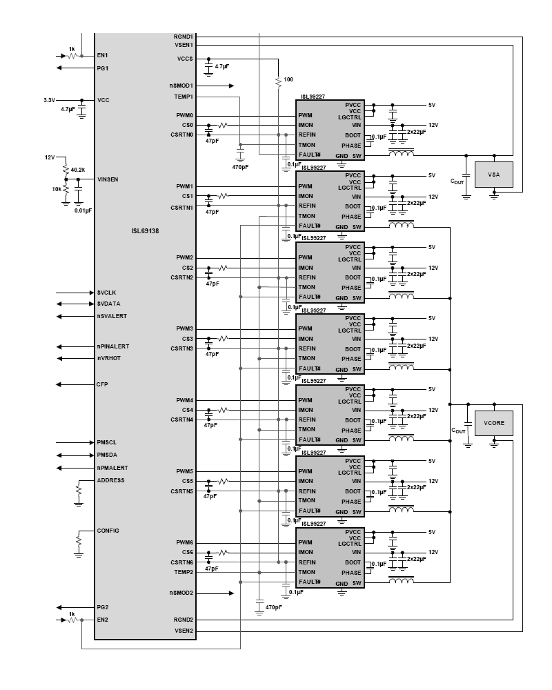

    Does anybody have a pinout or a boardview / schematic of a motherboard featuring ISL69138? Please?

    Which laptop or motherboard has this component?

      Does this help?
      https://ez.analog.com/power/f/q-a/52...power-solution

        Re: ISL69138 Pinout
        Gigabyte Z390 UD desktop motherboard.
        @dicky96

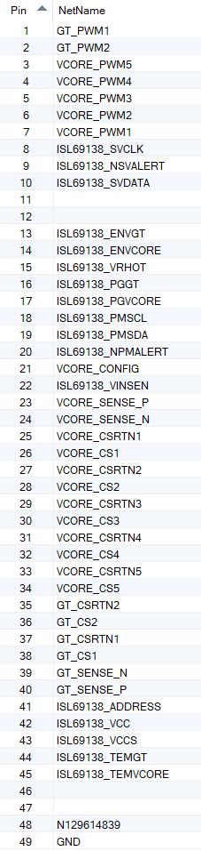

        Ive seen that too but I need isl69138 pinout to be exact.

          Keep searching for other possible boards that use this controller. Perhaps we will get lucky on another. So far nothing on the Asus / Asrock series. No schematics.

            Re: ISL69138 Pinout
            Found it:
