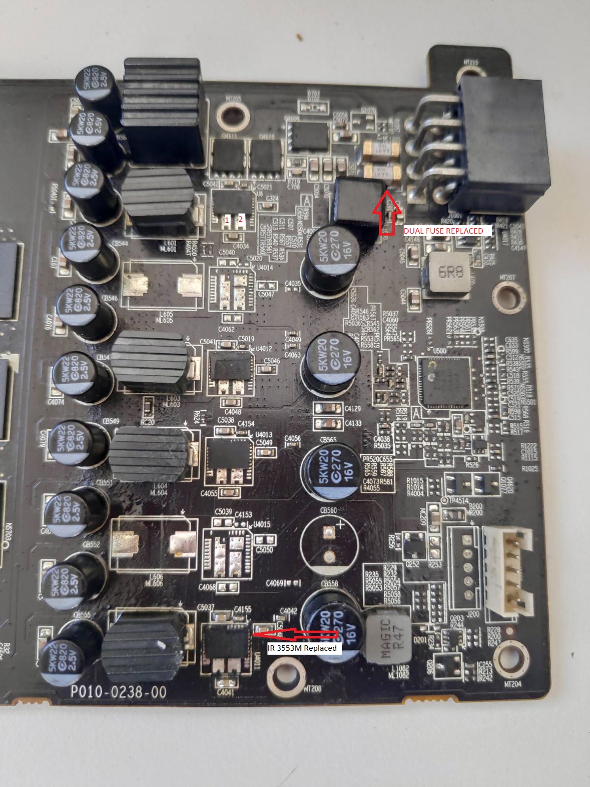

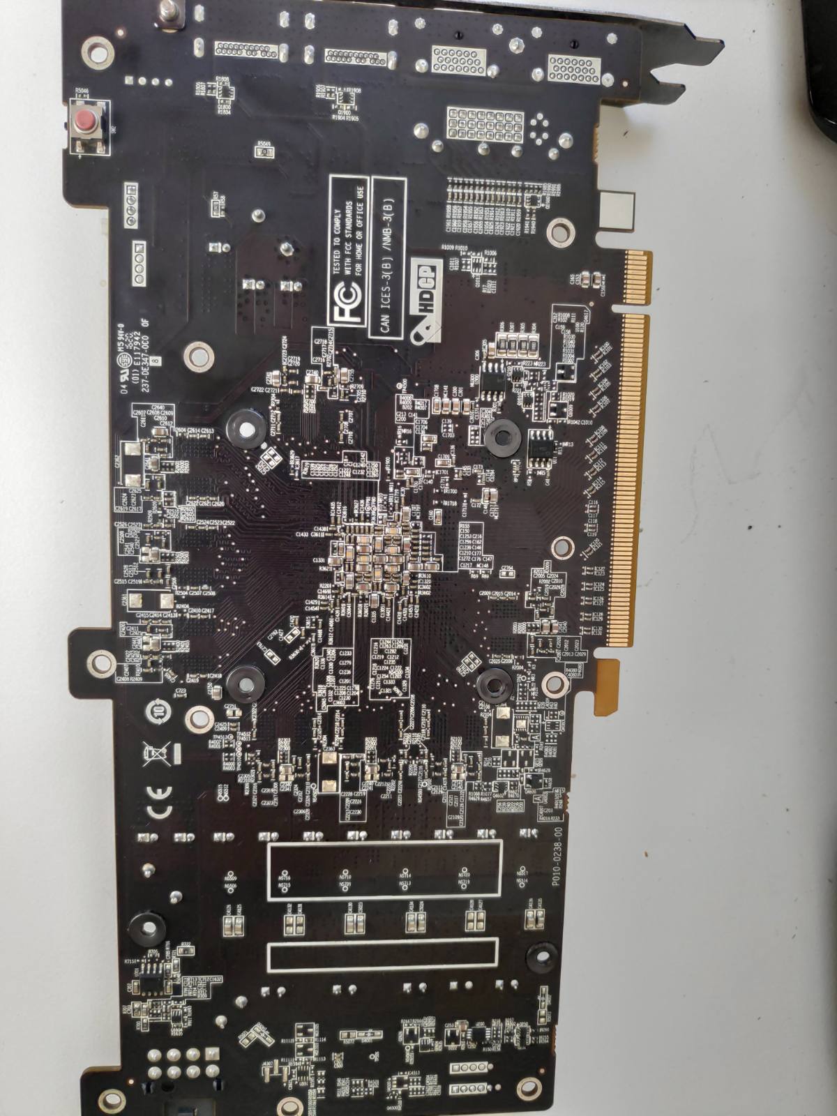

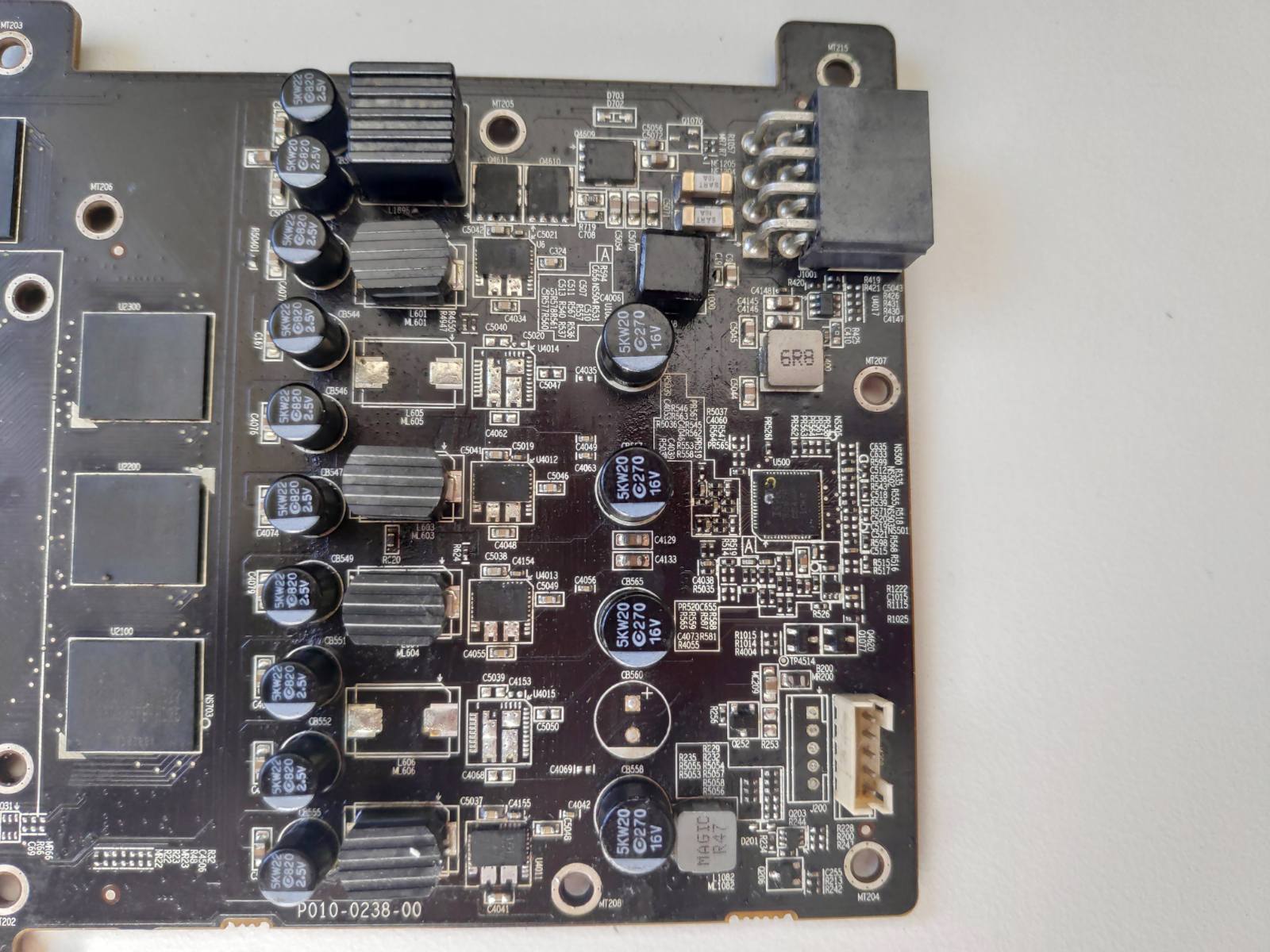

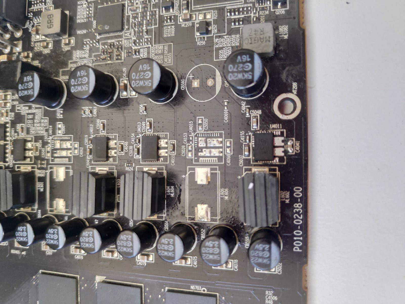

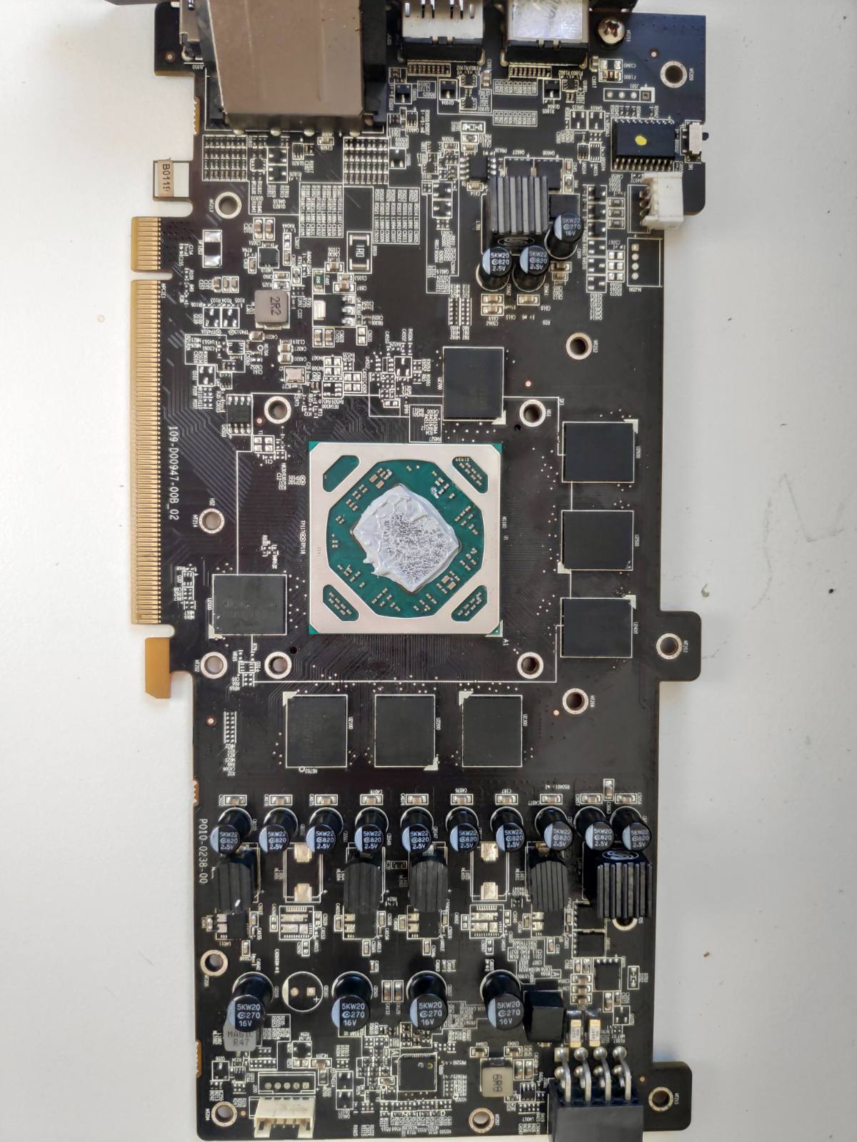

    Hello to all.
    My personal card, has suddenly died, i was helping for 1 week to folding@home , when the COVID-19 occured. And suddenly it didn't get any power.
    My PSU Titanium grade, and is connected to powerline with UPS.
    So the :voltage: is everytime safe and good.
    Now, i have tested via youtube,that saw some videos from RX470/480 dieing on spot ,that the chip IR3553M is making a connection to ground and dies and takes the Dual fuses,with it.
    I have taken some photos and i am attaching them here to get help from you guys,if you can help me out.
    Indicators.
    Replaced the dual fuse , top right corner (2X 10 A)
    Replaced the bottom IR3553M which had conntected to ground.

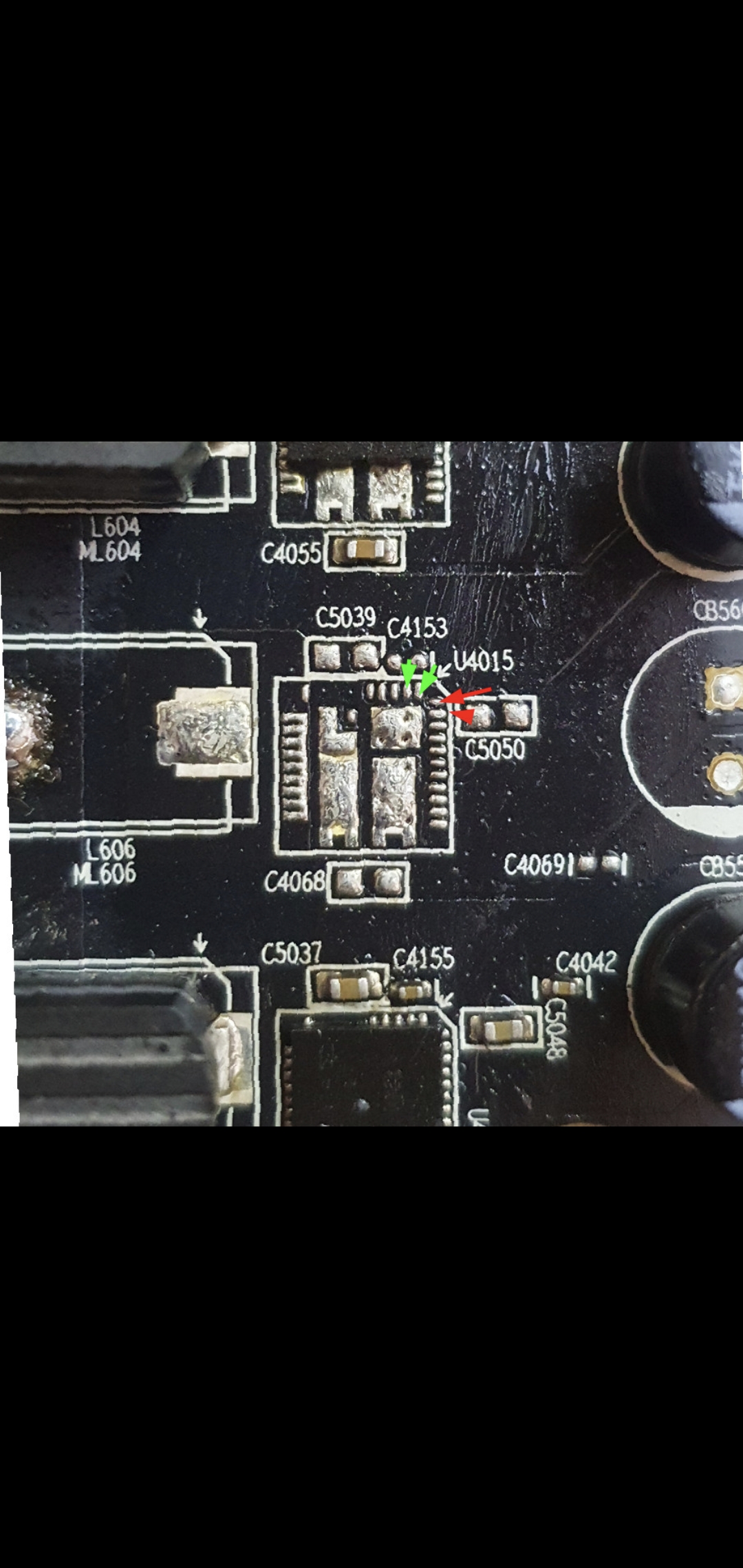

    As i saw the 1,2 points in the IR3553M (that i have in the top photo) , 2 should not beep ,and number 1 should beep (solder point) .
    All the IR3553M now, remain silent on leg 2 , and on leg 1 beep.
    I don't see any other faults, but the card still remains cold as dead.
    Any suggestions ?
    Here are extra links for high resolution photo :
    https://imgur.com/a/hAL65R7
    Thank you.

      I see there is 2 x capacitors missing from the IR3553M in line, 2 x really small ones. Can you or someone figure out, why this is happening and how can i measure what capacitor should i use ?
      The picture i attach shows the 2 capacitors,that are missing today.When yesterday they were on place.
      • Acnologia
        • Dec 2016
        • 421
        • Poland
        Re: No Power RX470 8GB - IR3553M
        I measured another capacitor from above,in the same place with target meter at 200nF, showed me 123nF , so the capacitor is 123nF ? Right ?
