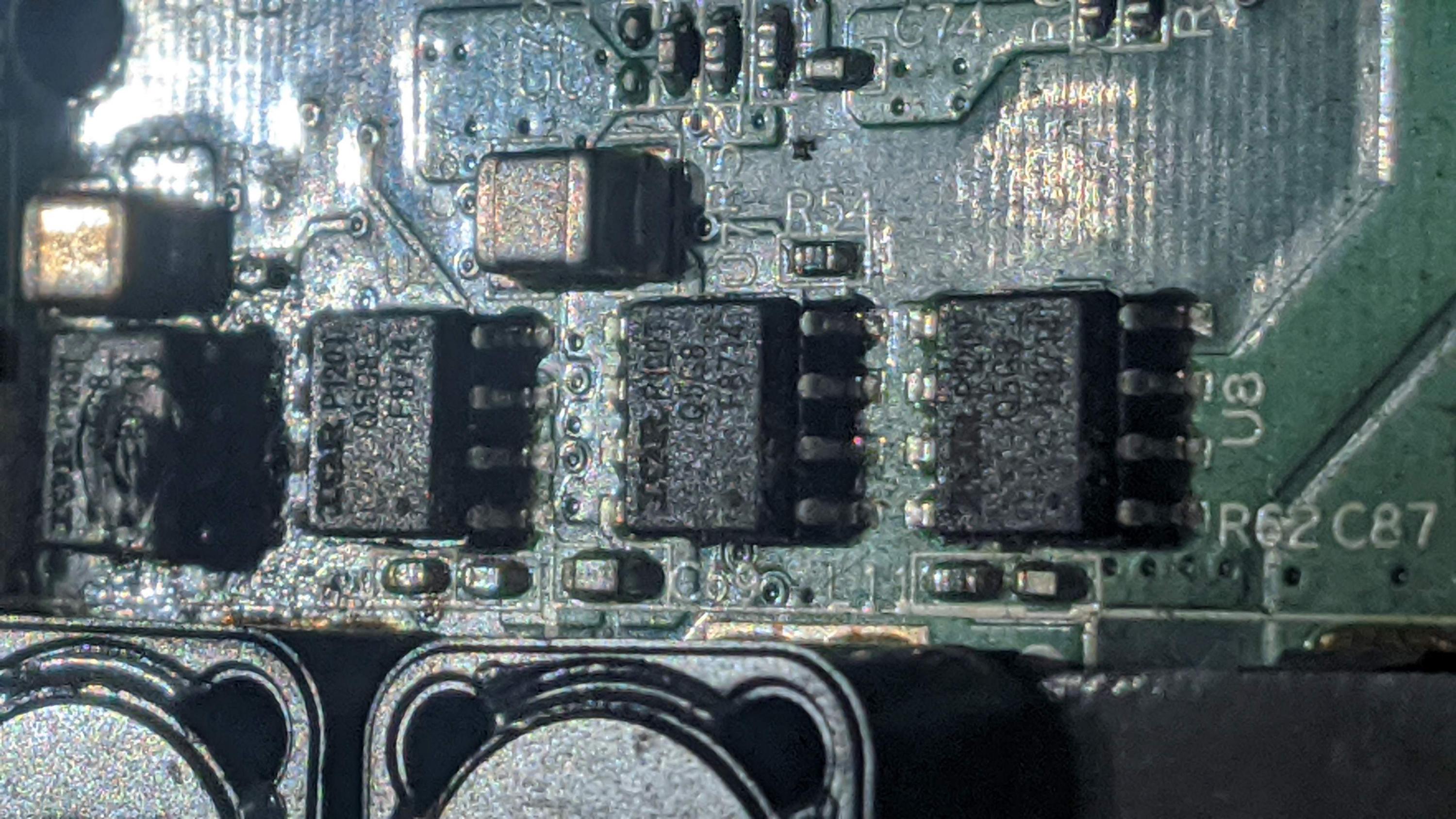

    Hi guys!
    I have this minipc with no power. I've found something broken on the board. It's called IRP1207 (or P120T), but I can't find it as replacement.
    I've attached a picture of it.
    Can you please help me to recognize an alternative for it?
    Thanks in advance for the reply!

    International Rectifier IRF8714 .Its a 30V N-channel mosfet,you can replace it with any other that have the same voltage and amperage.Or higher amps.

      Thanks a lot for the reply!
      Do you think Si4392DY or ME4856 can be used to replace IRF8714?

        The si4392dy max continuous drain current is 1.5A less,and the pulsed drain current is lower on both. I`d replace it with the same part if you can.

          I've tried with ME4856, but the computer still doesn't turn on. Maybe there's something more broken!
