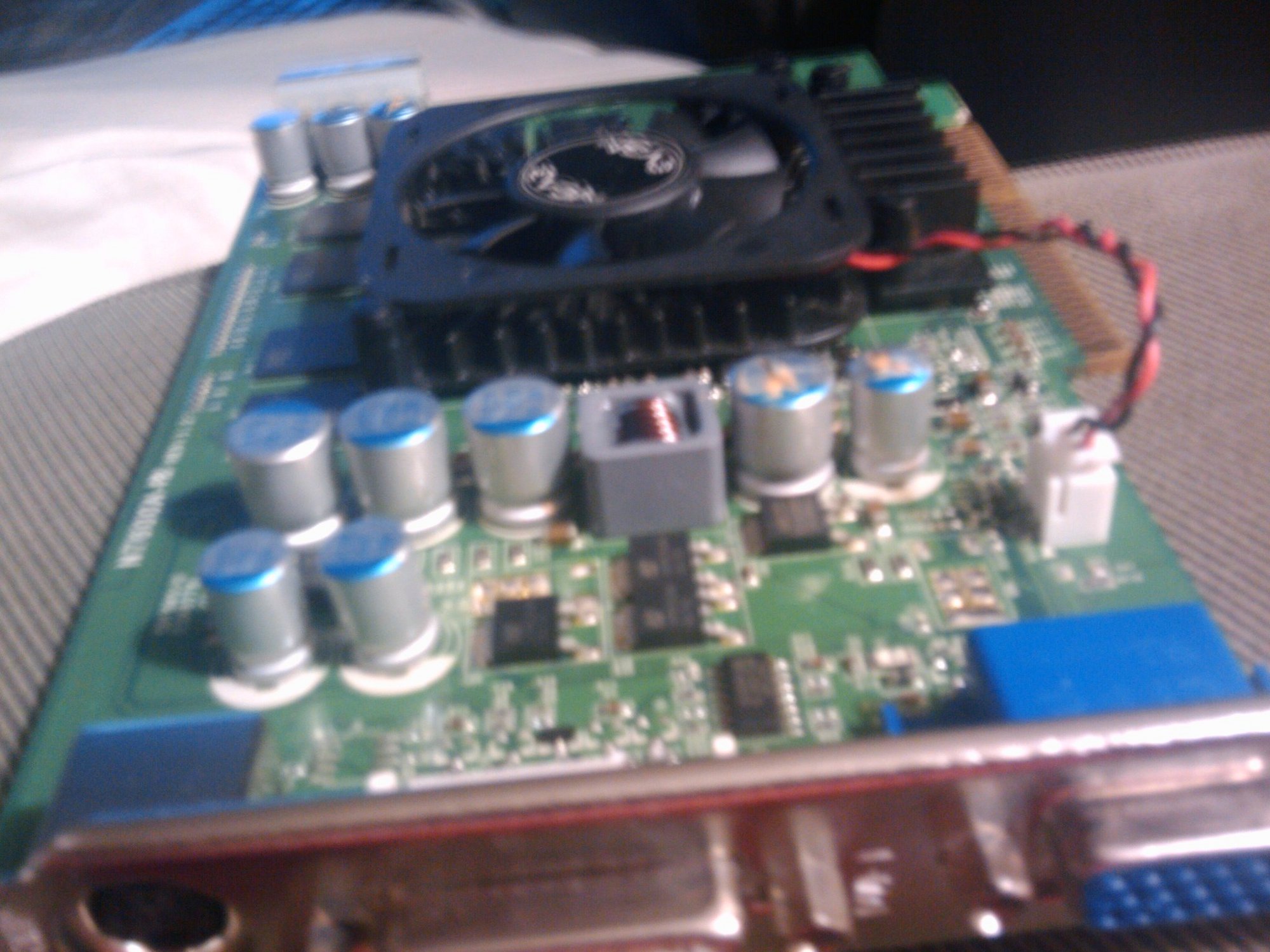

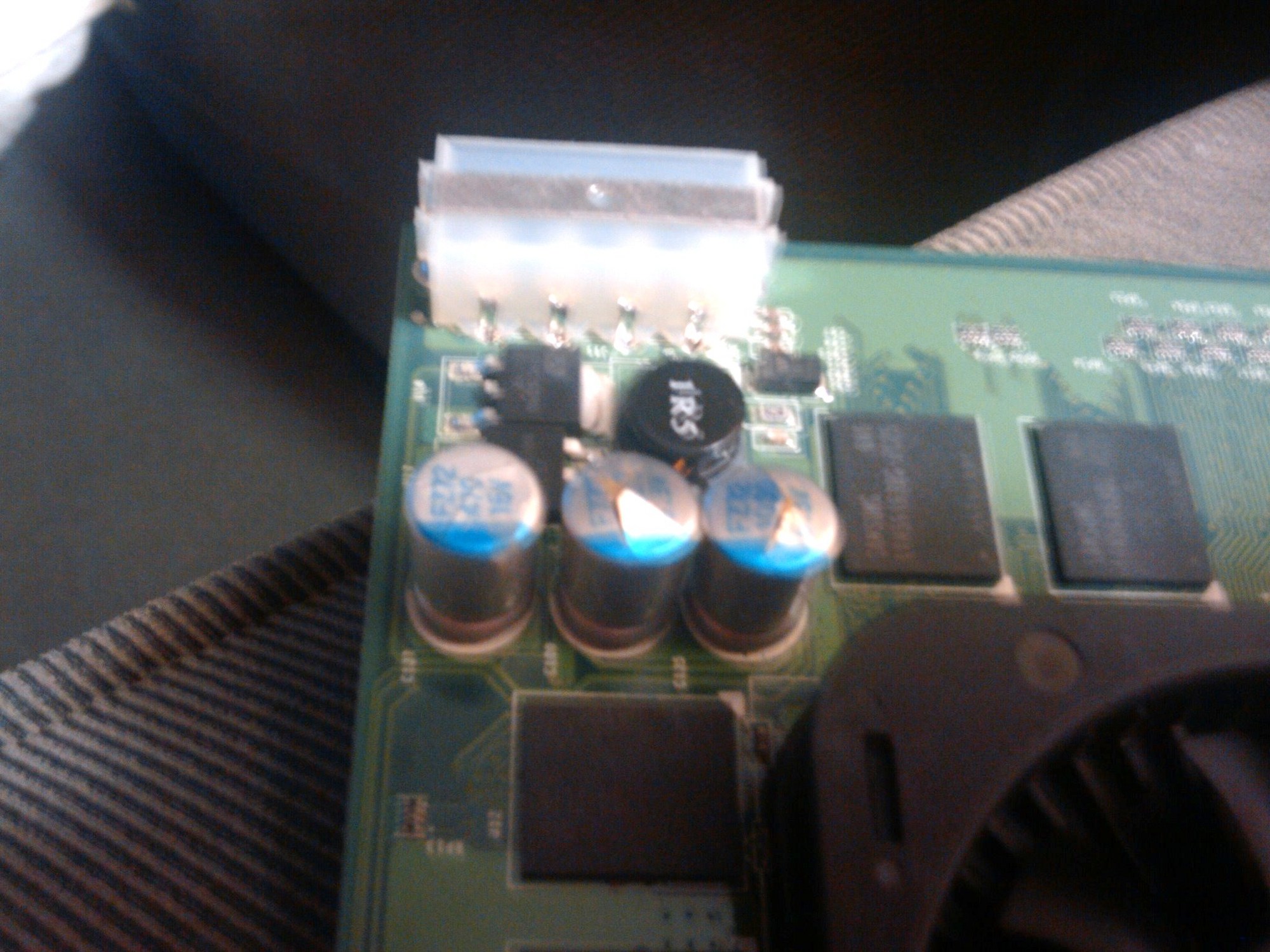

        Thanks for the replies- here are some images of the offending caps.
        My iron is a Craftsman 45 watt, and I have 95/5 lead free solder. I got the lead free stuff because I didn't think handling lead solder and breathing it in would be good long term. I saw in a few posts though that others recommend 60/40 lead solder. Not sure it it matters.

              Its alive! I can't believe it- even with my *atrocious* soldering (big chucks of solder on the board) it powered up and ran perfectly on my first run. Wow! Now I did only replace the caps that were visibly blown. I wasn't confident enough in my soldering skills and did not want to try the others until i knew the ones I put on there worked. I have to decide whether I want to risk my bad (apparently good enough) soldering on the others now.
              By the way- it did have RoHS on it. I didn't think it would because its an older card. I used my lead free, large gauge solder that I have (that probably led to the big chunks). Anyway- just excited my first recap was a success. Thanks for the tips all. I may post a pic or 2 of the results as soon as I get a chance.
