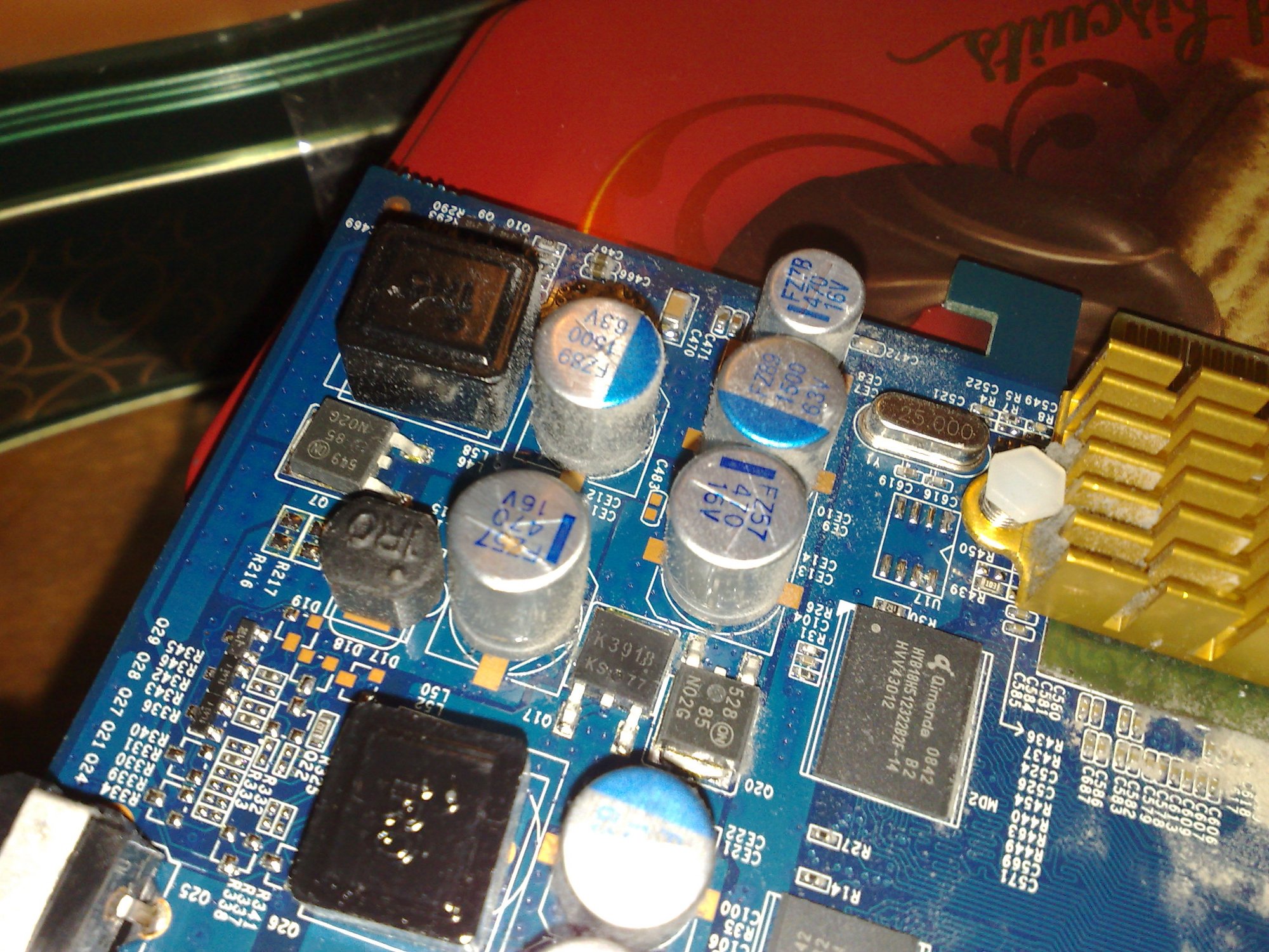

    Bad Caps on Galaxy 7950 agp
    I recently bought a Galaxy 7950 agp for my aging system, last week it just stoped working, after inspection I noticed a brown mark on the top of one of the caps. I've identified a bad cap and I want to replace it but i'm not 100% sure on what to buy,
    The bad cap says FZ57 470 16V
    Can anyone advise me on what I need to replace this with?

    They are Sacon FZ. Sacon are Evercon, which are GSC, which are VERY unreliable. Panasonic FM should be fine for replacments unless you want to poly-mod it

      Replace -ALL- the FZ caps. They're crap to begin with and don't get better.
      Your cap is 470uF @ 16 volt.
      A non-glare pic of all the caps will help us help you.

        Re: Bad Caps on Galaxy 7950 agp
        whats poly-mod?

          Falls under 2 categories -
          Actively seeking and replacing "wet" or "aqueous" electrolytic capacitors with the solid polymer electrolytic capacitors whether or not they need replacing.
          Replacing "wet" electrolytics once a failure of them has been discovered. Then determining whether to simply "upgrade" with a better grade electrolytic or to use a solid polymer cap and improve the functionality and stability of the circuit.
          Solid polymers are better suited for:
          1) hotter environments such as video cards and the areas immediately surrounding the CPU that regulates and filters the power available called the VRM or Voltage Regulator Module
          2) circuits where stability and "clean(er)" power have a positive impact on functionality again such as video cards (GPU) and CPU and the memory power supplies
          3) all of the above when overclocking
          4) any circuit or area notorious for causing heat related failures in other electrolytics
          Others will have more (better) reasons and perspectives.

              Originally posted by spaldingg
              whats poly-mod?
              Modify using solid polymer caps in place of electrolytic caps.
              [Kinda grouping toasty's responses into one there.]
              Now why I really posted:
              Some people have the idea that poly are always better insofar are ESR.
              That is NOT true.
              There are high and low end [low ESR] lytics and there are high and low end solid polymer.
              A low end poly could have worse ESR than a high end lytic so it's still important to look up both new and old caps in the data sheets to compare specs.
              Low end polymer are rather a new thing and people have ideas left over from before they existed and by that -assume- poly are always better.
              Four or five years ago solid polymer were too expensive to bother manufacturing them for the lower end markets but the costs are coming down now and they are expanding polymer product lines to cover those lower end markets too.

                Sorry I didn't explain it in my other post. Replacing the caps with solid polymer caps was indeed what I meant. Sanyo SEPC or OS-Con are good polymers, but they are more expensive than Panasonic FM Electrolytics, so if you are willing to pay extra for ultra-reliable caps, use Sanyo SEPC/OS-CON but if you just want to keep the cost down, use Panny FM.
