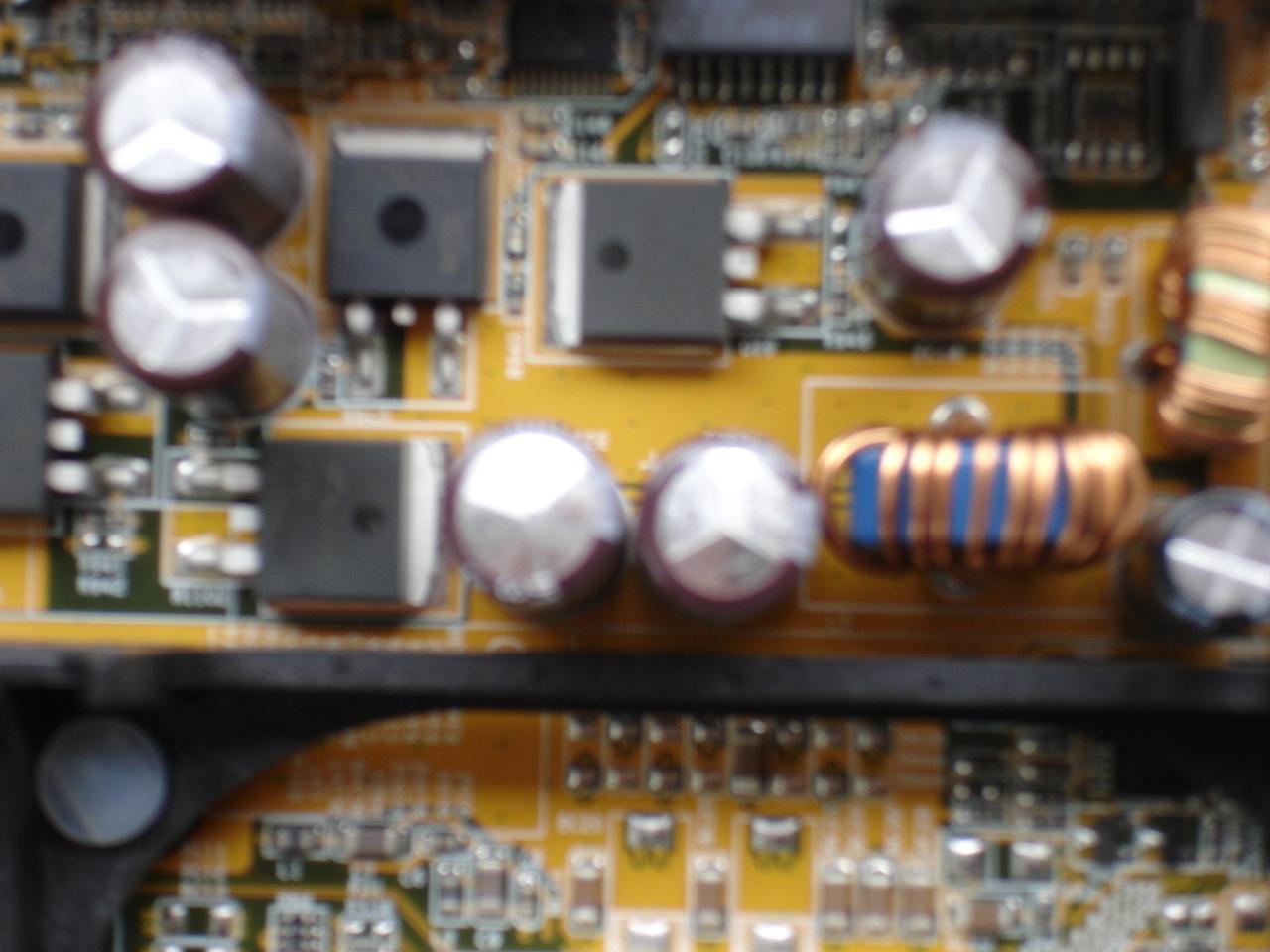

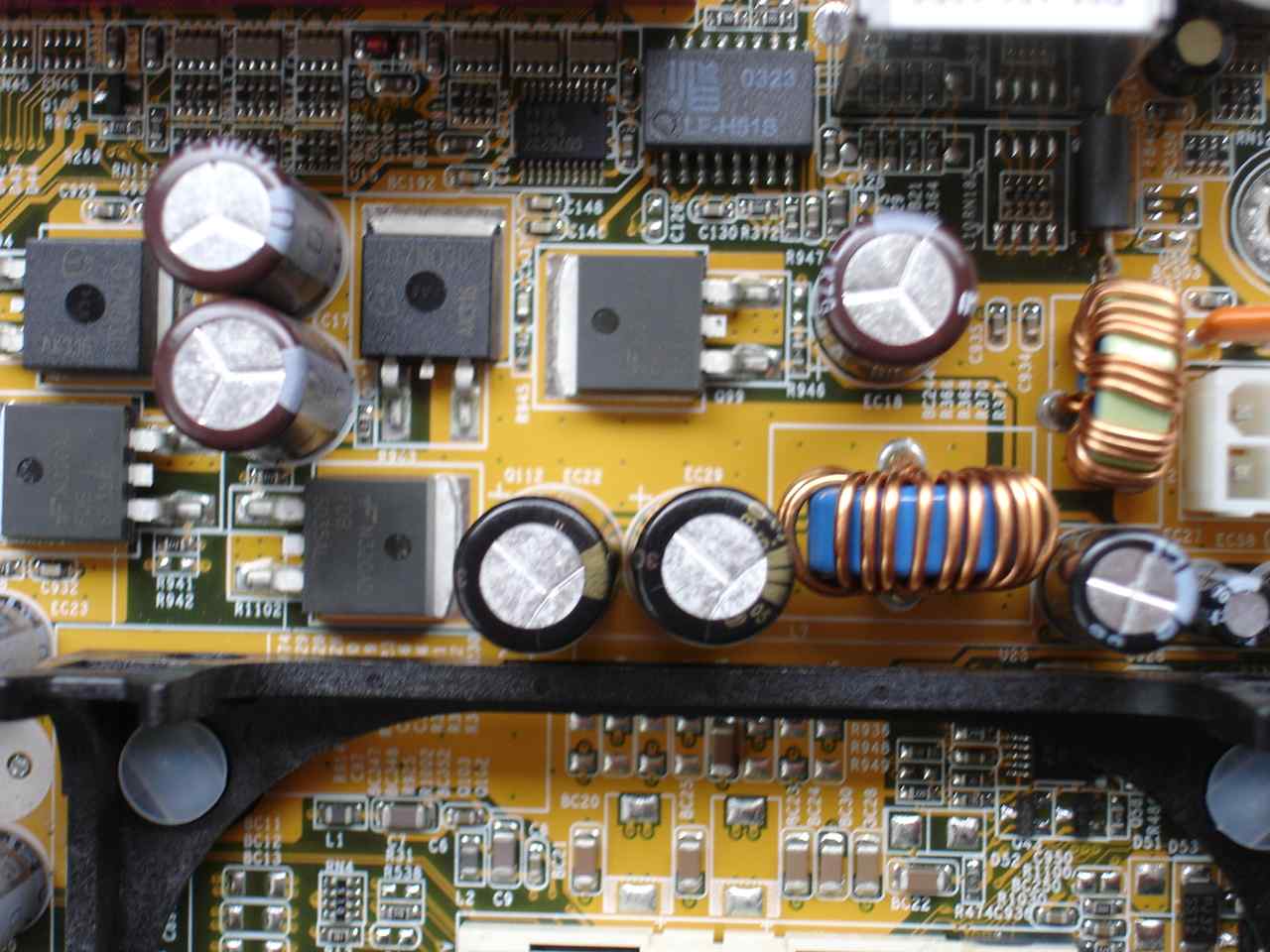

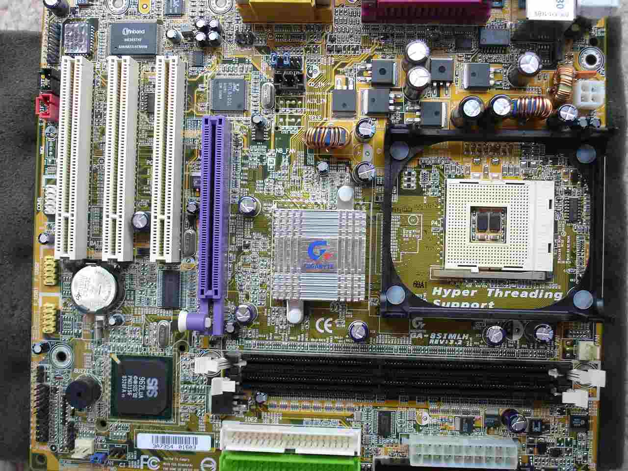

    Another Gigabyte with bad Chemicon
    This pair of KZG 3300uf 6.3v swelling at the top, next to the heatsink on a GA-8SIMLH
    Shouldn't have been too hot though, was only a Celeron 2000 running stock standard
    Other smaller KZG, further away from the heatsink, show no problems

    Re: Another Gigabyte with bad Chemicon
    Replaced by salvaged Panasonic FJ, verified OK on Dick Smith ESR meter
      Replace the others KZGs. they can fail without showing it.
        I don't think KZG need huge amounts of heat to go.
        They just tend to go where it's hot first.
        And, the older they are the worse they are going to be about it.
            No, KZG are failure prone, especially around the CPU area where it is hot. I'd rate them above GSC and Fuhjyyu, but below Teapo and OST.
                Treat KZG as an 85C 2000 hr cap....it HATES heat.
                      More like 2000hr at 30C!
