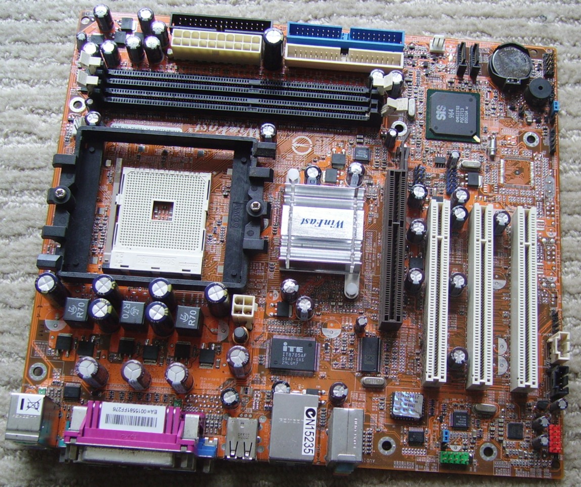

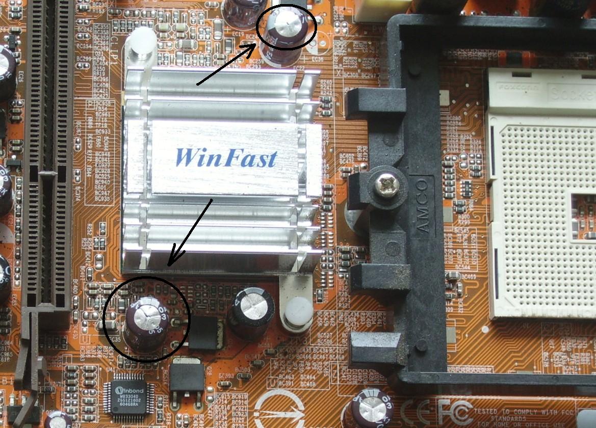

    It's another repair project of mine which I got from work. The caps on this are as follows
    VRM in:
    4x 16V 1500uF Chemi-Con KZG
    VRM out:
    6x 6.3v 3300uF OST RLX
    Other caps:
    17x 6.3v 1000uF Cheapo Teapo SEK
    10x 16V 470uF GSC ??? Series
    1x 6.3v 3300 OST RLX
    Obviously, All of these caps need to be replaced. Ruby MBZ for the VRM in, Panny FJ for the VRM Out and that extra OST, Nichicon HE for the teapos, and Panny FM for the GSC

        Finally, I have got the last of the caps I need, although I ended up getting rubycon MBZ for the 470uF 16v GSC rather than FM. Will go and re cap it now and post back with results.

            • c_hegge
              • Sep 2009
              • 5219
              Re: LeadTek WinFast PC760M02-GX-6RLS with bad caps
              I finished re-capping it yesterday arvo. I am currently stress testing it. No probs so far. I gave myself a nice big burn on the leg when a huge fly landed on me and I dropped the soldering iron.

                      It's now been running for ~48hrs with no problems (I'm using it to tpye this post). Is that a good enough test? Or are there better tests? I just had an embarrasment with an asus M2N4-SLI which I re-capped (died shortly after the re-cap) and I don't want this to be another one.
                      • c_hegge
                        • Sep 2009
                        • 5219
                        This is the exact problem I was worried about. It's stopped posting!! Any suggestions? Already tried different RAM, unplugging drives, removing PCI cards and a different PSU.

                                Does the MB power on and spin the fans? Does it find the keyboard? (I.e., do the keyboard LEDs light briefly at power on?) Is there any signal at all on the video? If the board does all these things but doesn't POST, then I might suspect that the BIOS battery died or the BIOS became corrupt. Did you try a different CPU? (Which is risky -- the board might be killing them!) I'd also use a loupe and check for small solder bridges. If you're testing the board on a bench, pressure on the back might have bent something on the solder side, causing a short.
                                • c_hegge
                                  • Sep 2009
                                  • 5219
                                  It's powering on and spinning the fans. The keyboard/mouse are powered by the 5vsb rail (ie. they're always on, even when the computer is off) and are getting power. there is no signal at all to the monitor (which is what I meant when I said not posting). I don't have another CPU. I can't find any evidence of a short on the solder side. I'll try re-soldering the joints, but if that doesn't work, I'll probably assume that the northbridge is toast, take the caps of and toss the board out.

                                    Do you have a different graphics card to try? I sometimes find that if the card is not straight in the slot, the board won't POST.
                                    • c_hegge
                                      • Sep 2009
                                      • 5219
                                      I'm using the onboard graphics
                                      • tj2
                                        • Oct 2009
                                        • 85
                                        It does seem as though there could be a problem with the board itself since the graphics card is built in, doesn't it? I'd definitely check the soldering, though it's hard to see how it could have worked for 48 hours if the soldering were bad. It seems more likely that bad caps could have weakened other parts just enough to fail soon after the caps did. Is this board in a case or on a bench?
