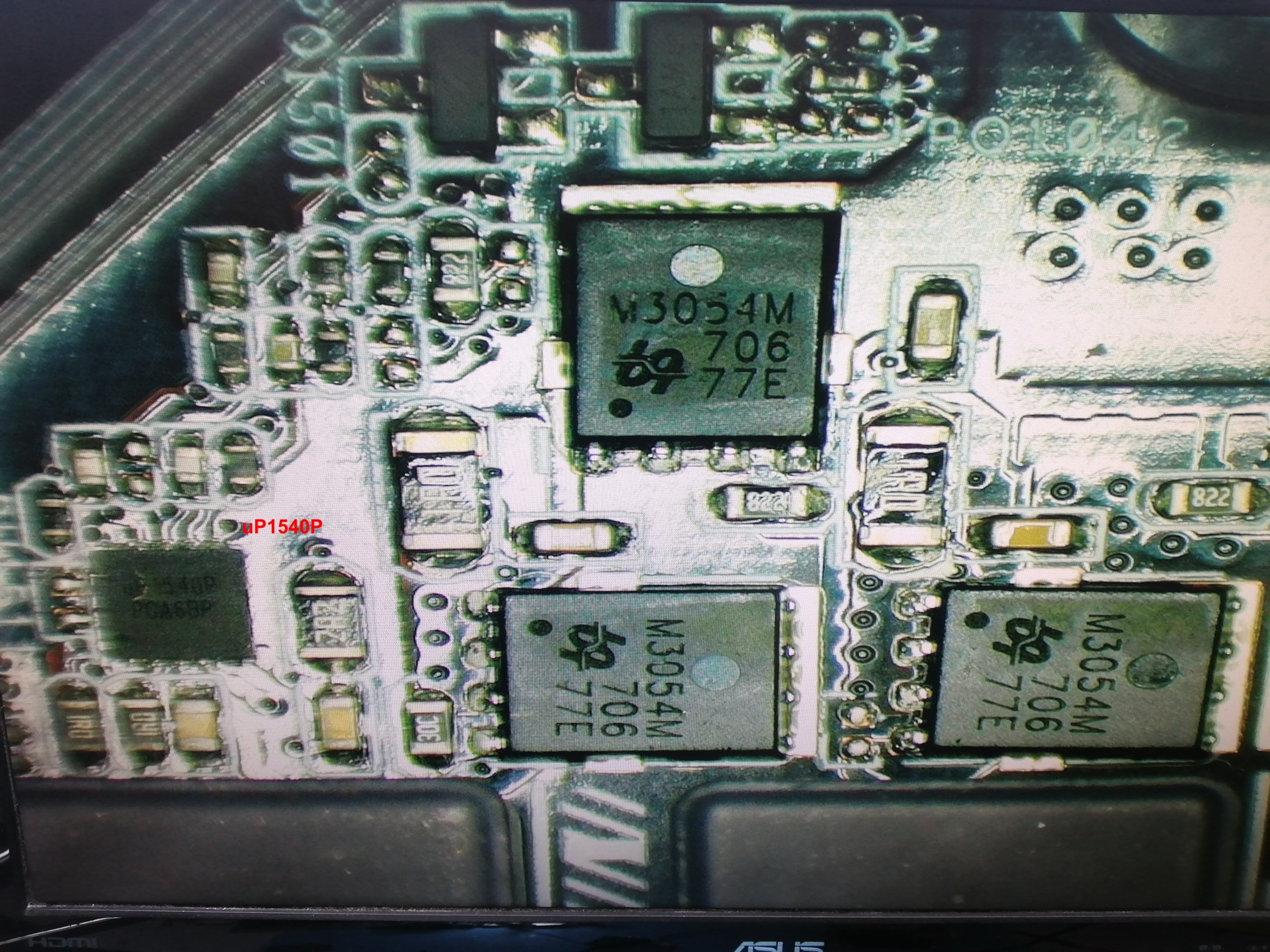

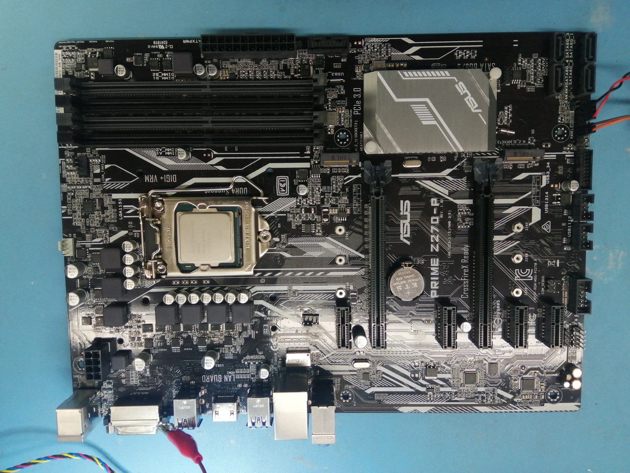

    Hi guys
    I have an Asus Prime Z270-P.
    With no CPU fitted it will not start
    With a Celeron G3900 CPU it starts but the CPU is cold and I have no Vcore
    12V to the 8 pin molex is good, as are 12V, 5V, 3.3V to the ATX connector
    Checking with a scope I have no drive to the high side gate of the Vcore MOSFETs, the gate is 0V. I didn't bother check the low side.
    The MOSFET are M3054M
    There is this chip uP1540P near the MOSFETs. Each high side FET has one pin of an 820R resistor connected to the gate and some of theee resistors then connect to one pin on the uP1540P but not all of them. The ones that do all connect to the same pin on uP1540P. I can't find a datasheet for uP1540P.

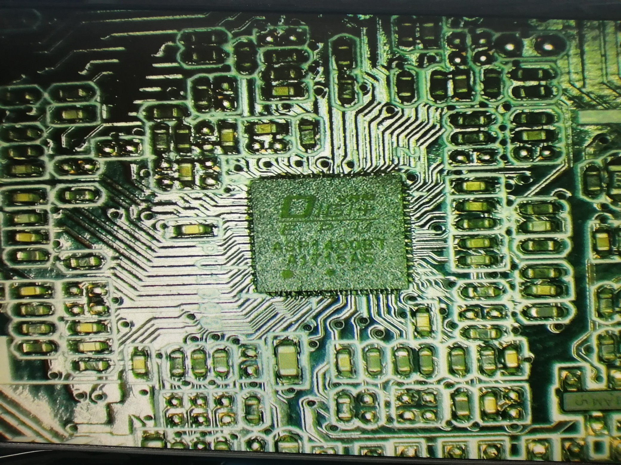

    Also there is this other nearby QFN ASP1400BT that I think is the controller for the Vcore PSU, there look like 7 phases. But I can't find a datasheet for that either.
    I do have a 1.2V supply near the DIMM slots which is probably Vram and that is running OK.
    Looking for a board view plus datasheets for uP1540P and ASP1400BT plus any helpful advice on diagnosing the fault

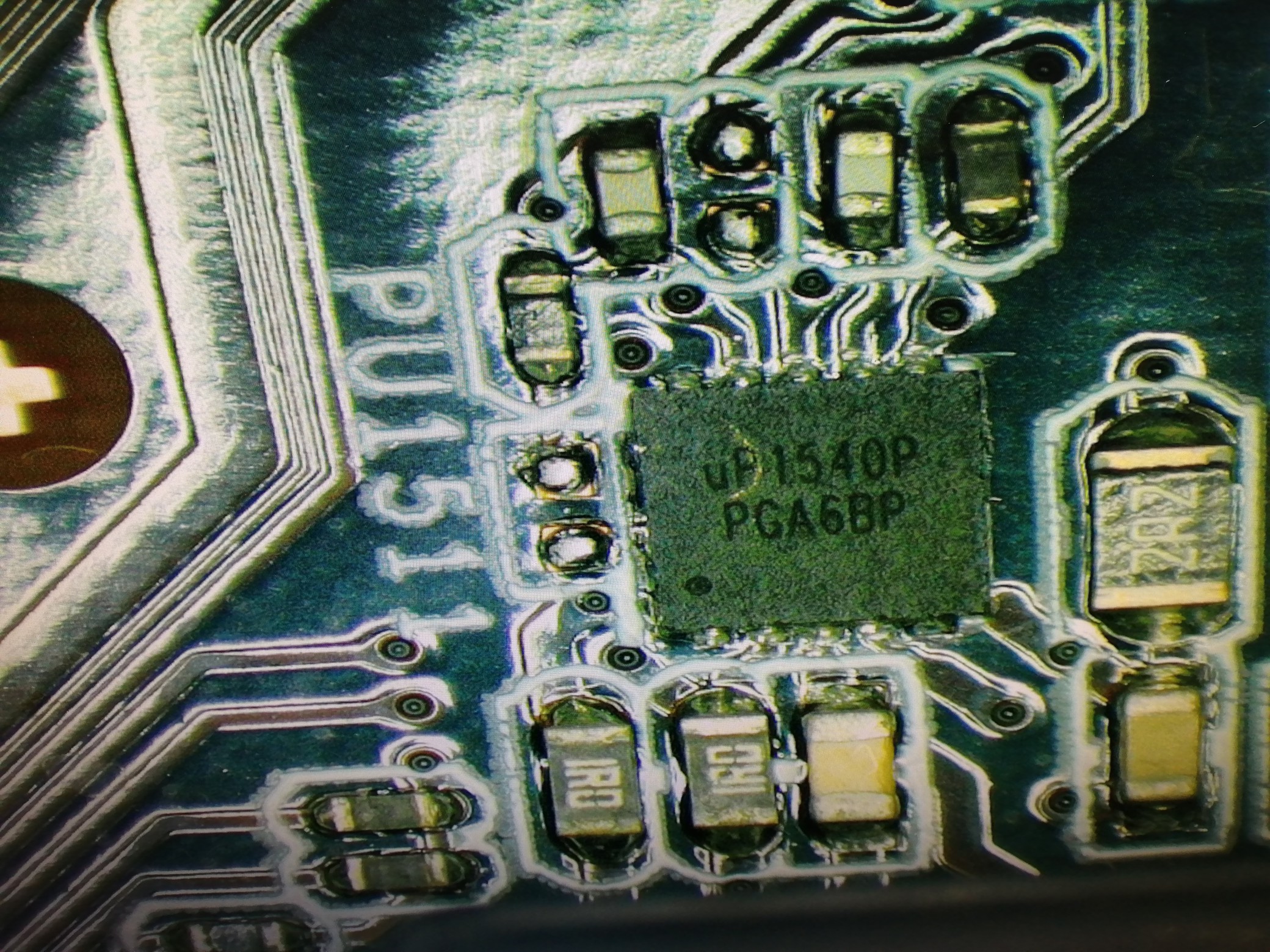

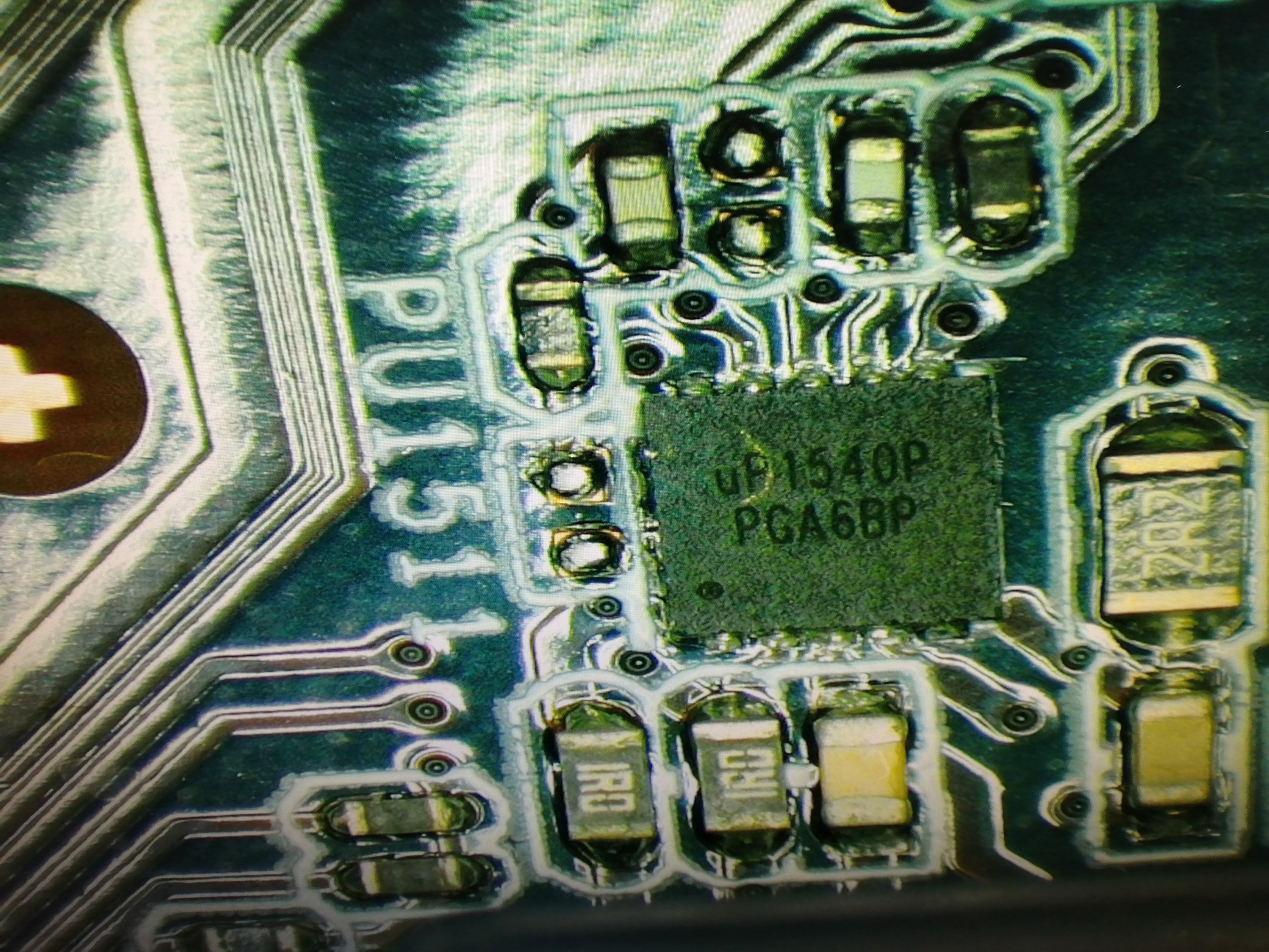

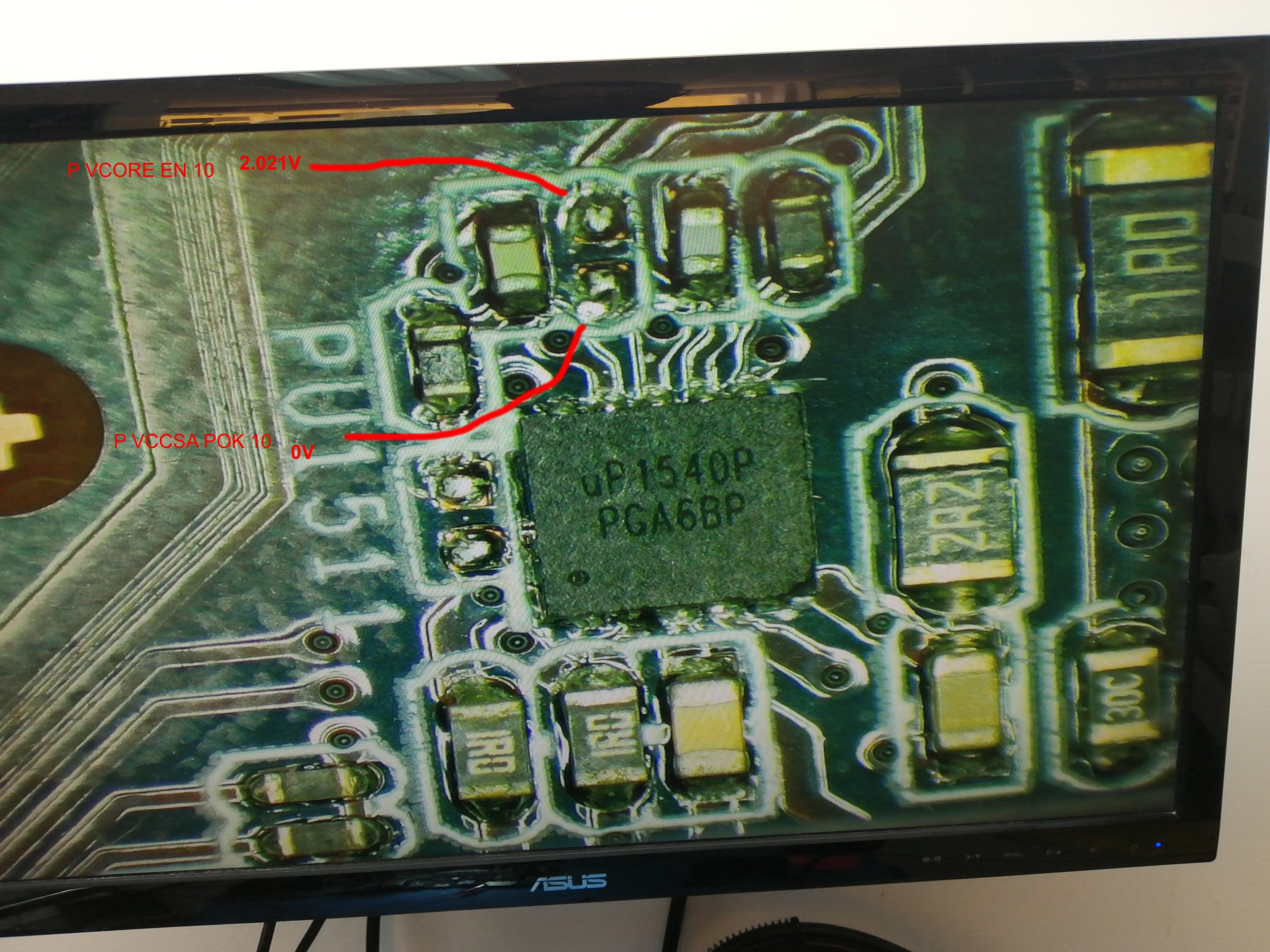

                Re: Asus Prime Z270-P no Vcore
                OK I took some voltages on the Colis and a few Power FETs
                PL2001
                +5VSB DUAL 4.98V
                PVDDQ REGIN S 4.98V
                PL2011
                PVDDQ PHASE 20 1.212V
                VDDQ 1.212V
                PL2211
                P+2V5 SW 2.510V
                VPPDDR 2.510V
                PL3011
                P +1.0V A SW 20 1.032V
                P1.0V A 1.022V
                PL1000
                +12V CPU 12.18V
                P VCORE L +12V S 12.18V
                PL1010 / PL1020 / PL1030 / PL1040
                P VCORE PHASE 1/2/3/4 20 OV
                VCORE 0V
                PL1310 / PL1320
                P GT PHASE 1/2 20 0V
                VCC GT 0V
                PL1511
                PVCCSA PHASE 20 0V
                VCCSA 0V
                PU1511 (uP1540P)
                PIN1 PVCCSA BOOT 20 12.18V
                PIN5 PVCCSA VCC 20 12.18V
                All other pins 0V
                Now here is the interesting thing...

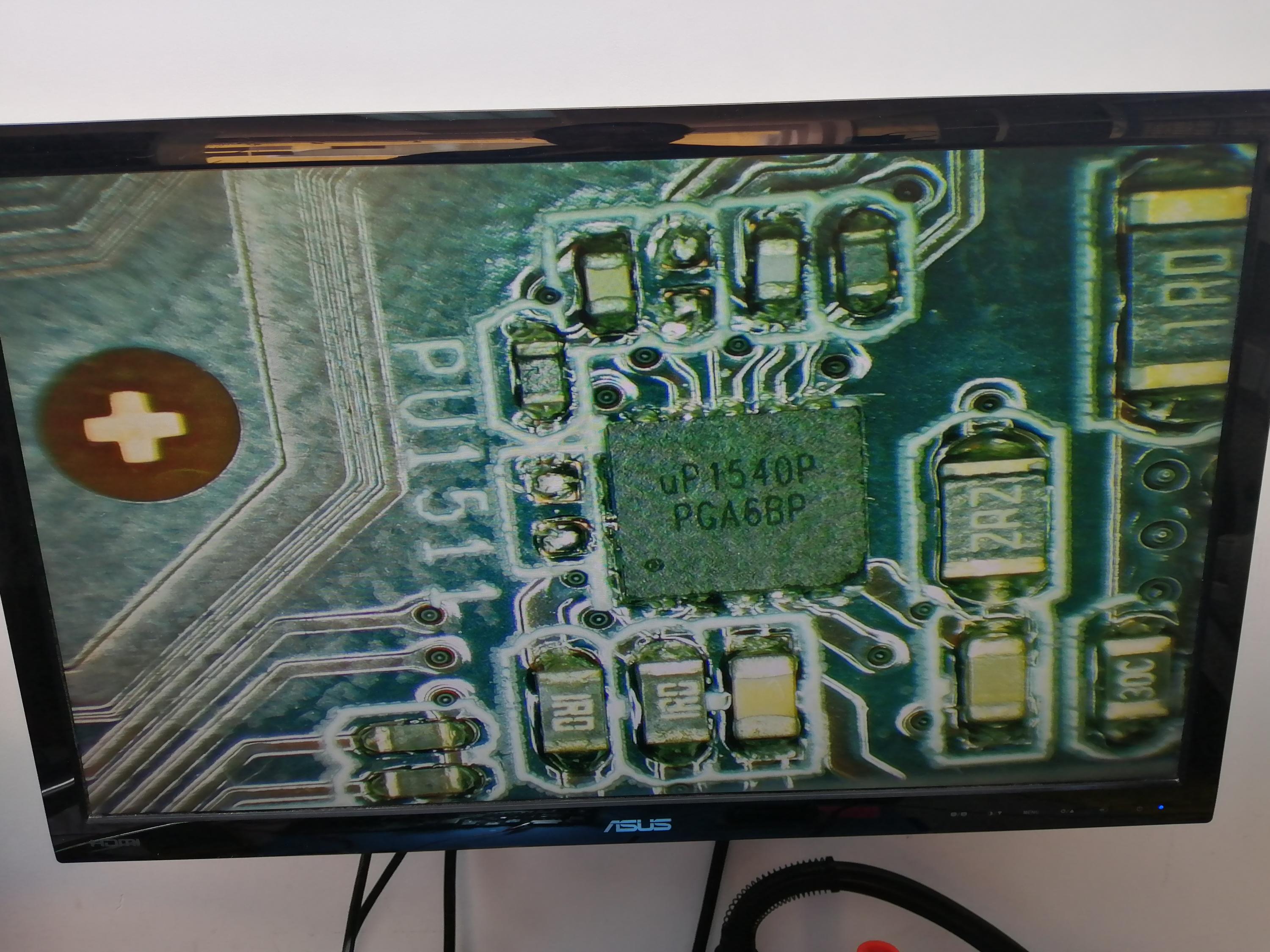

                uP1540 pin 8 is P VCCSA POK and its 0V. This comes from a resistor PR1063. The other end of PR1063 P VCORE EN 10 connects to pin 2 of PU1000 (ASP1400BT) and this is 2.027V.
                But this is because the resistor PR1063 is missing from my board and as this looks like it is the enable pin for uP1504P I don't see how it could work without it! Also the soldering here looks 'shiny' like maybe someone has been messing. The same with capacitor PC1509, which is missing, and which connects from pin 10 of uP1504P (P VCCSA REFOUT 10) to ground - but I don't think that is quite so critical.
                The board view says this resistor is MBS_R0402 but a lot of the resistors say the same. I measured PR1596 in circuit which also says MBS_R0402 and that reads 256R
                What do think? I should put something like a 270R resistor in there and see what happens? And maybe a capacitor of some value in missing PC1509?
                    It just occurred to me that MBS_R0402 will be the size of the SMD resistor, nothing to do with the value DOH
                    What value to put in there? I don't think it would be critical...
                      That definitely looks to be no stuff.
                      Check voltage on VCCIO.
                            YES!! I have a result!
                            I took a half educated guess and fitted a 470R resistor in place of missing PR1063. I didn't bother with what looks like a missing capacitor PC1509 partly because I don't think it is critical to have the capacitor but mostly because I have no 0402 SMD Caps!
                            And hey presto she fired up like a good 'un.
                            I attached a HDD with Windows 10 on it, booted windows and I'm online. I used SDI 1.20.0 to install all the drivers and everything looks rosy
                            Job done!
