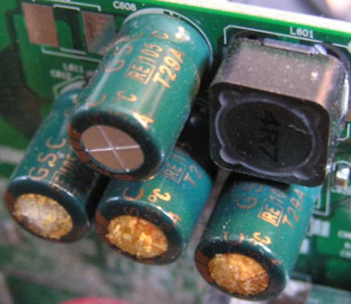

    GSC 1500 uF caps, three of them leaking:

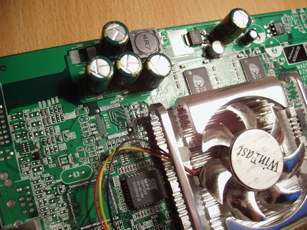

    Replaced with Sanyo MV-WX and the card is OK again:
