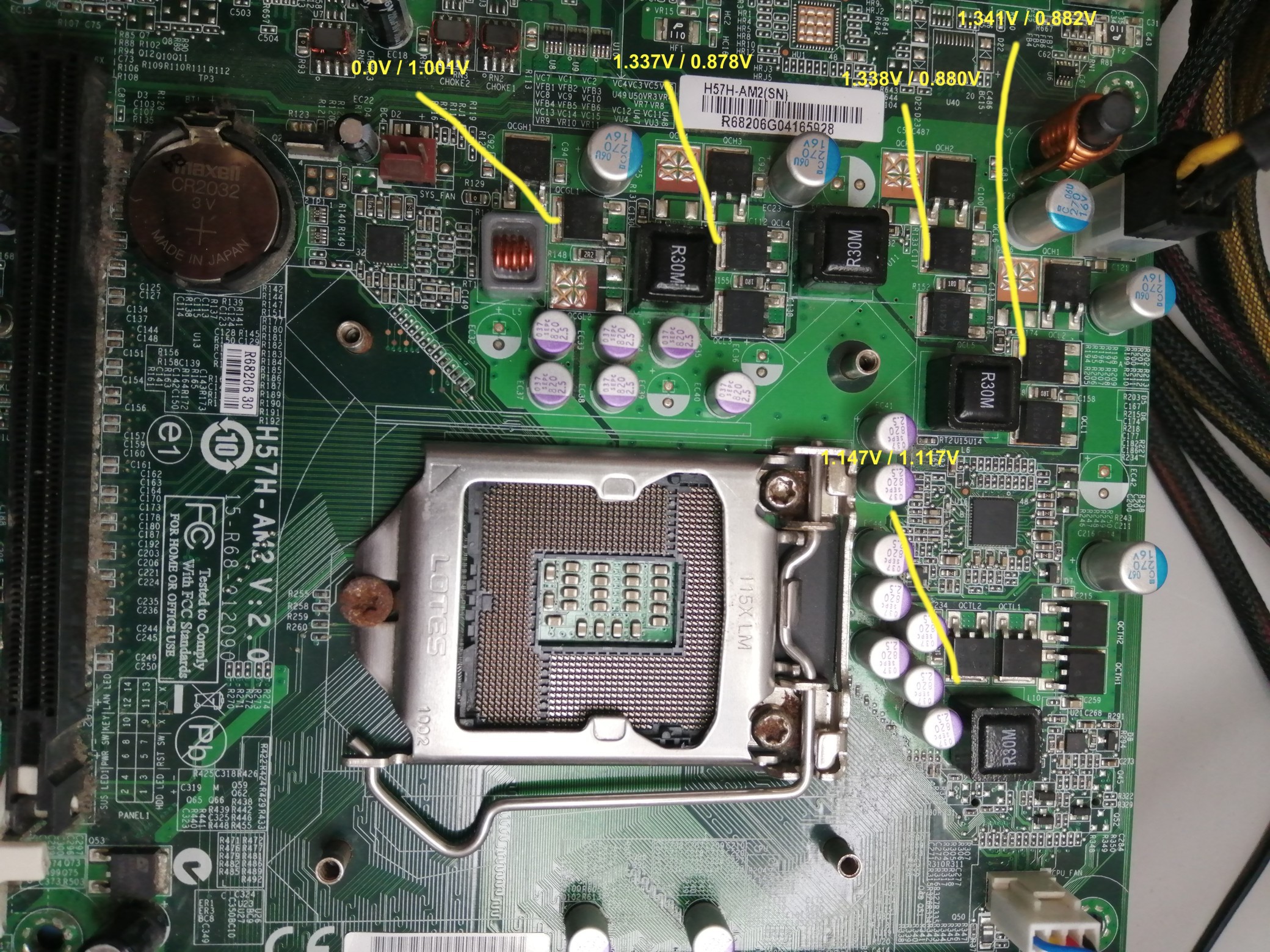

    What I have found is that the CPU voltage seems unusually low (unless I just need more experience to determine that is true) Also the CPU does not get warm with the heatsink fitted and without the heatsink it just heats up very slowly
    The attached image shows what voltages I am getting. The first figure is with no CPU fitted and the second is with the i5 CPU

    From your picture, I get that there are 3 phases for CPU VCore ( 1.3xxV/0.8xxV ), 1 phase for VCCSA ( 1.147V/1.117V), and one phase for VCCAXG (0.0V/1.001V).
    Typically CPU VCore will start at a higher voltage then drop a bit after BIOS is running, and usually VCCAXG won't come up if BIOS is not running. So basically my guess is that the board is actually getting pretty far in the POST process.
    Which in itself is kinda weird if you have no RAM... I don't exactly remember the behaviour on 1st gen though…
    To check the CPU VCore behaviour you can probe the CPU VCore then turn on the board, it should start at 1.1V then drop to 0.9V.

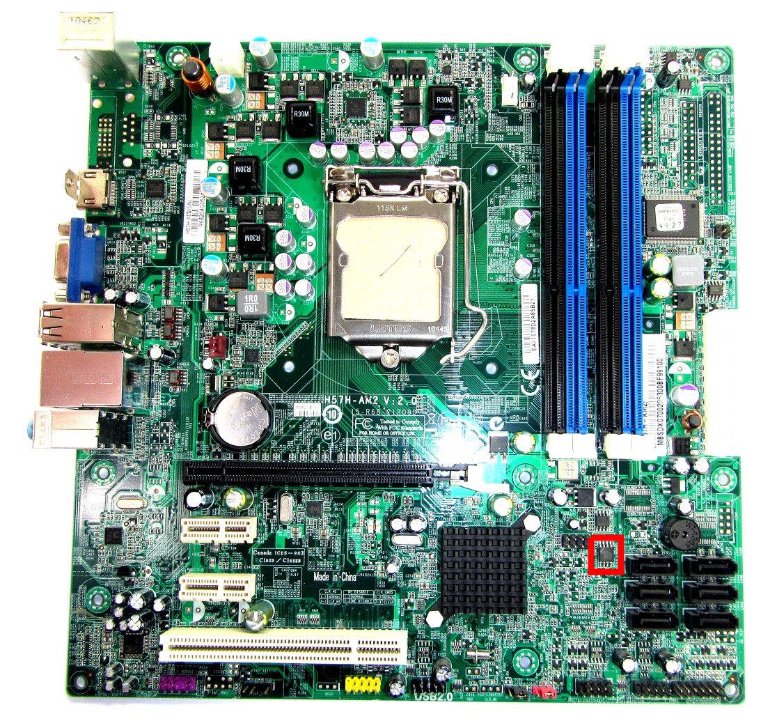

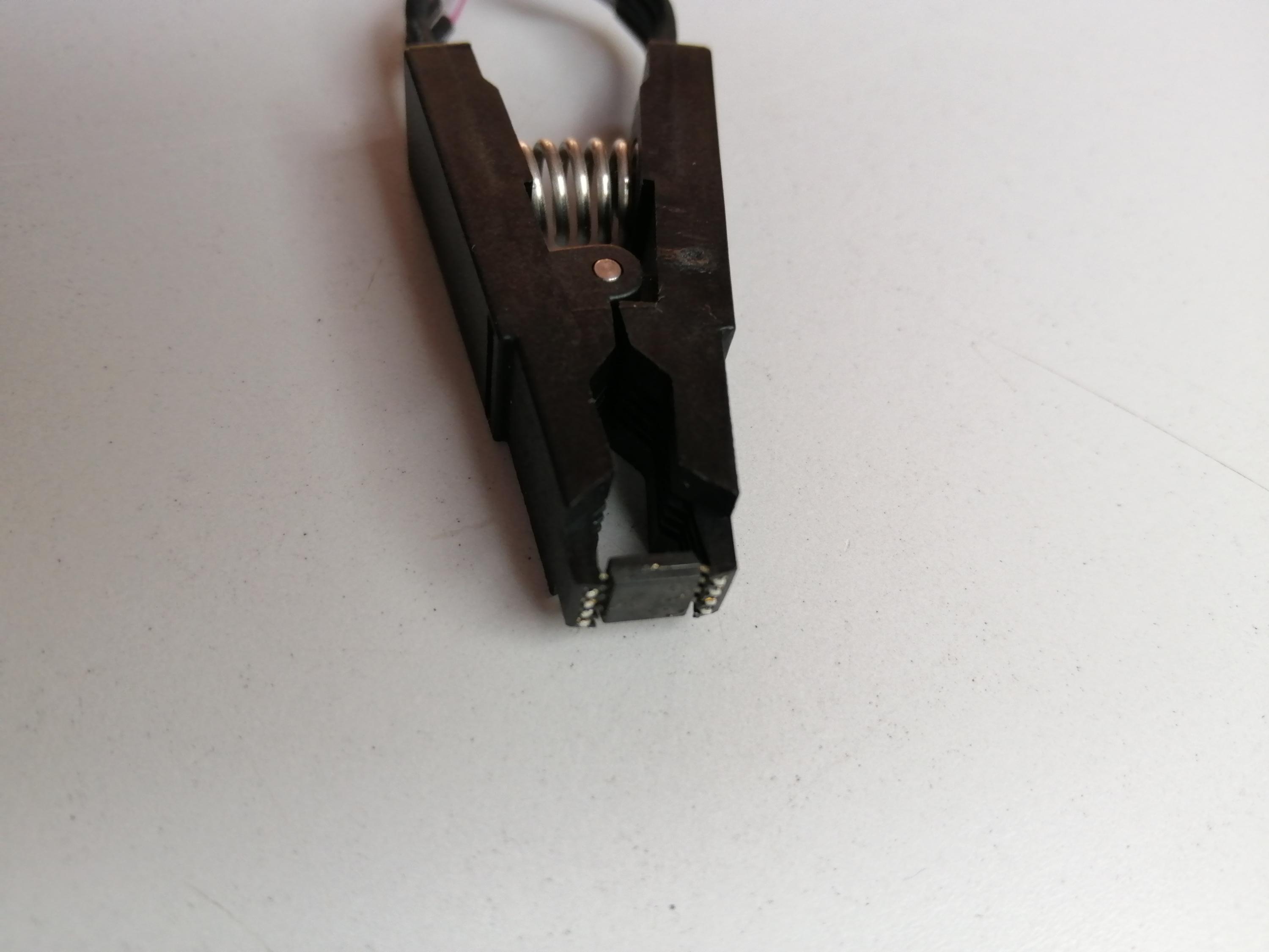

            OK there seems to be something wrong with the BIOS chip. Its a Winbond 25Q16BV. I selected W25Q16BV in the TL866
            When i tried using the clip to read the Eprom on the motherboard it just said 'Current Protection' though I don't see any shorts form the Eprom pins to ground on my multimeter.
            Anyway I unsoldered it and found I could get my clip to hold it tightly even though not mounted to a PCB (see pic)
            When I try to read it, everytime i get a different ID code, example 0x

              When on the board, the programmer cannot supply enough current because it'll try to power the whole 3V power rail, which is also connected to southbridge, Ethernet controller and a lot of stuff like this.
              When off the board, it just looks like it's not making good contact. Clean the pin and maybe use some sand paper or something like that.

                  OK, so I tried cleaning the pins on the eprom with an emery board (well that's what the missus calls the things she files her nails with, anyway) but I still couldn't get a good contact on the clip
                  So I soldered it to the SOP8 pin header instead. I could then read the eprom properly, which Check ID ticked. I could also use the clip lead to connect to the chip once it was soldered to the pin header PCB and read the BIOS properly.
                  I made a backup of the eprom BIN file and compared it with a downloaded BIOS which I think is the right one for this motherboard as it appears to be an OEM item used in various computers http://www.mxdtr.com/h57h-am2-drivers-bios-update/
                  They were very similar in structure but different.
                  As I am not sure that is the correct BIOS file I then unsoldered the BIOS and was going to put it back on the motherboard, but had a change of heart and soldered it back to the SOP8 header.
                  I read it again and compared with my original backup some areas had changed! I took a third backup and that was identical to backup number 2.
                  I wrote the original backup and it verified OK. I then decided to write the downloaded BIOS file anyway, and that also programmed and verified OK.
                  So I'm a bit confused how the contents changed apparently by unsoldering and resoldering.... maybe this chip does have a problem?

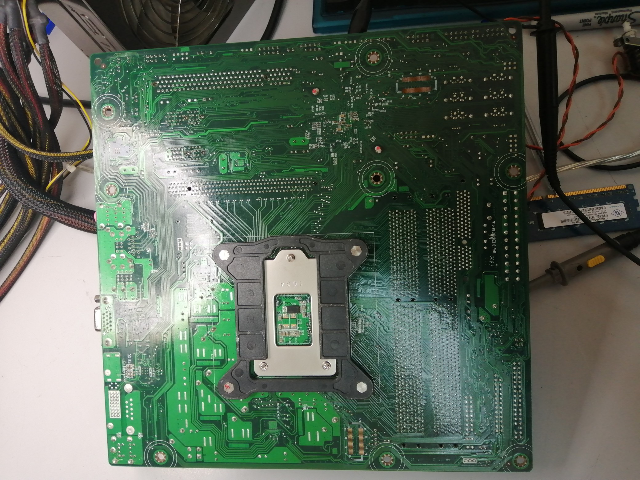

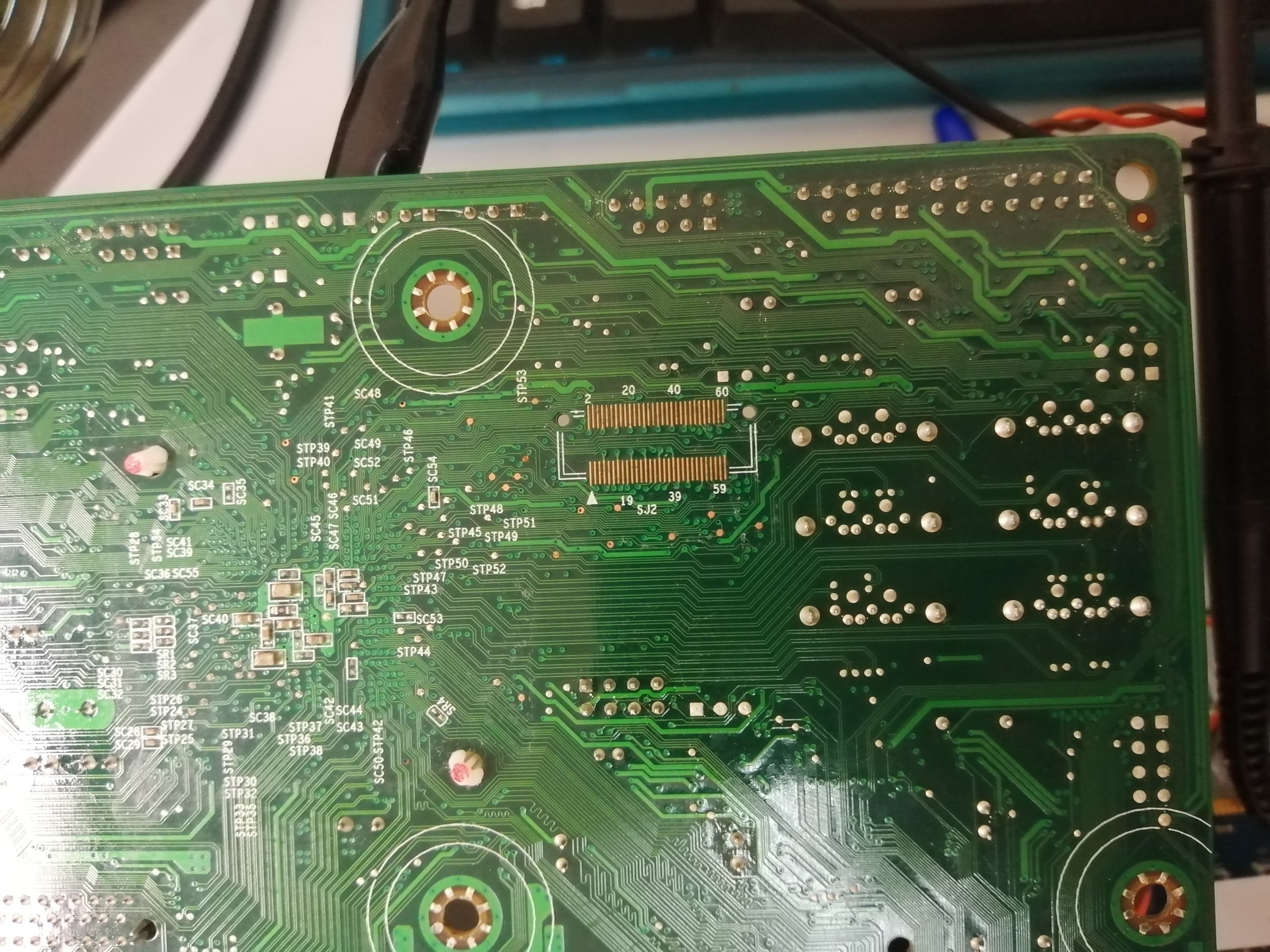

                        does the board have pads on the bottom that mirror the bga pads for the chipset?
                        • dicky96
                          Sun Seeker
                          • Mar 2017
                          • 1825
                          • Spain
                          Re: H57H-AM2 Motherboard with CPU voltage problem
                          @stj - no I don't think so. I've attached some pics of the rear of the board

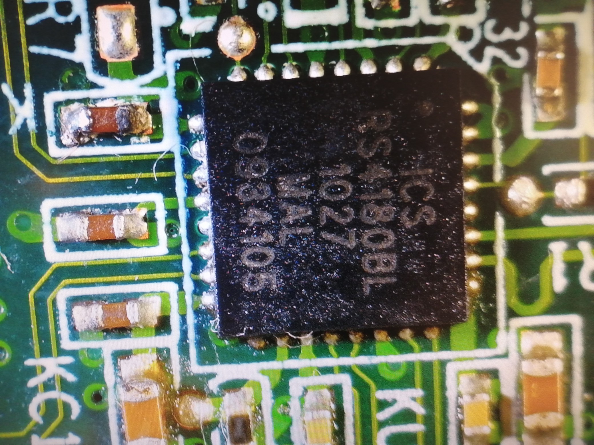

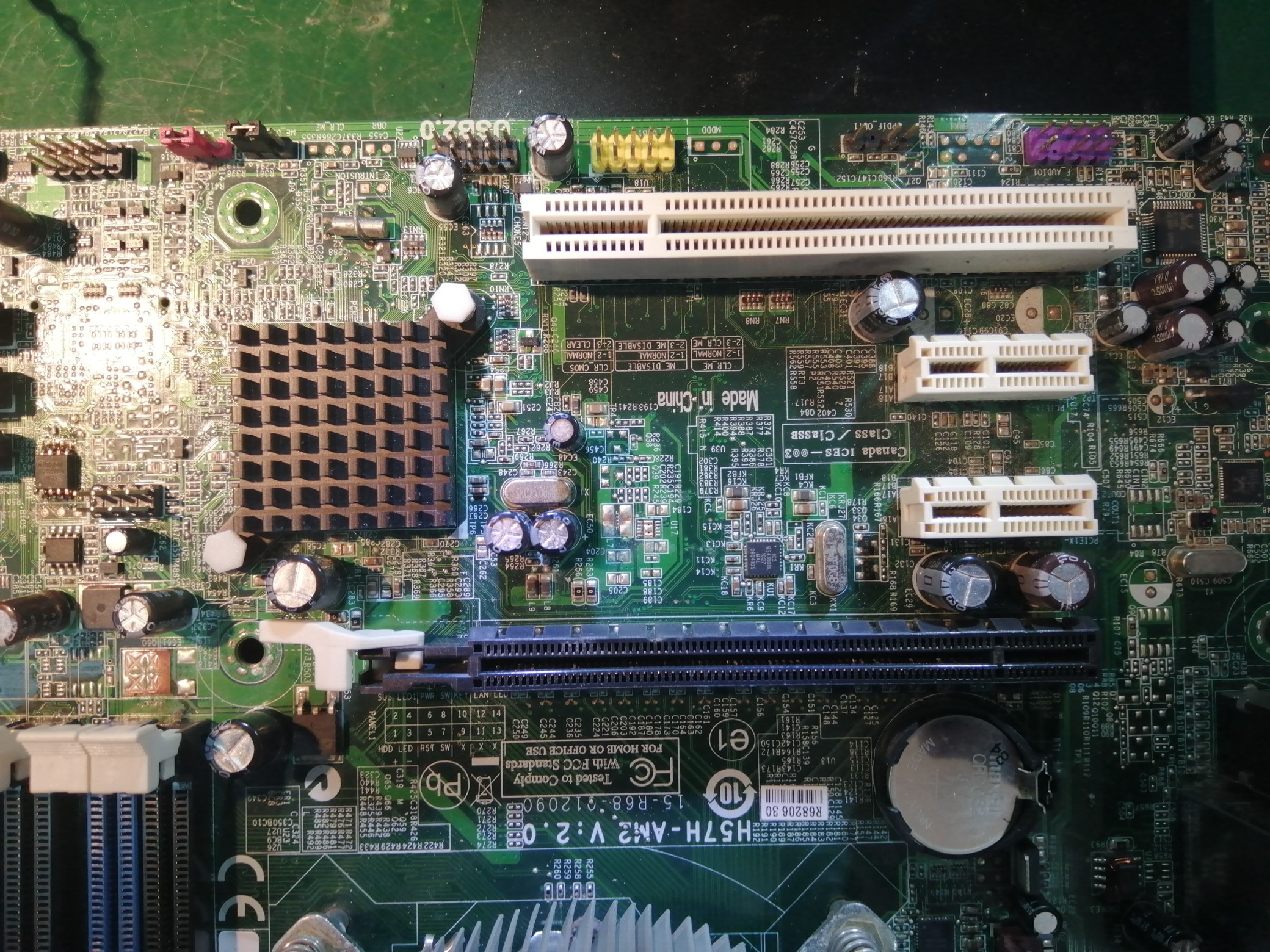

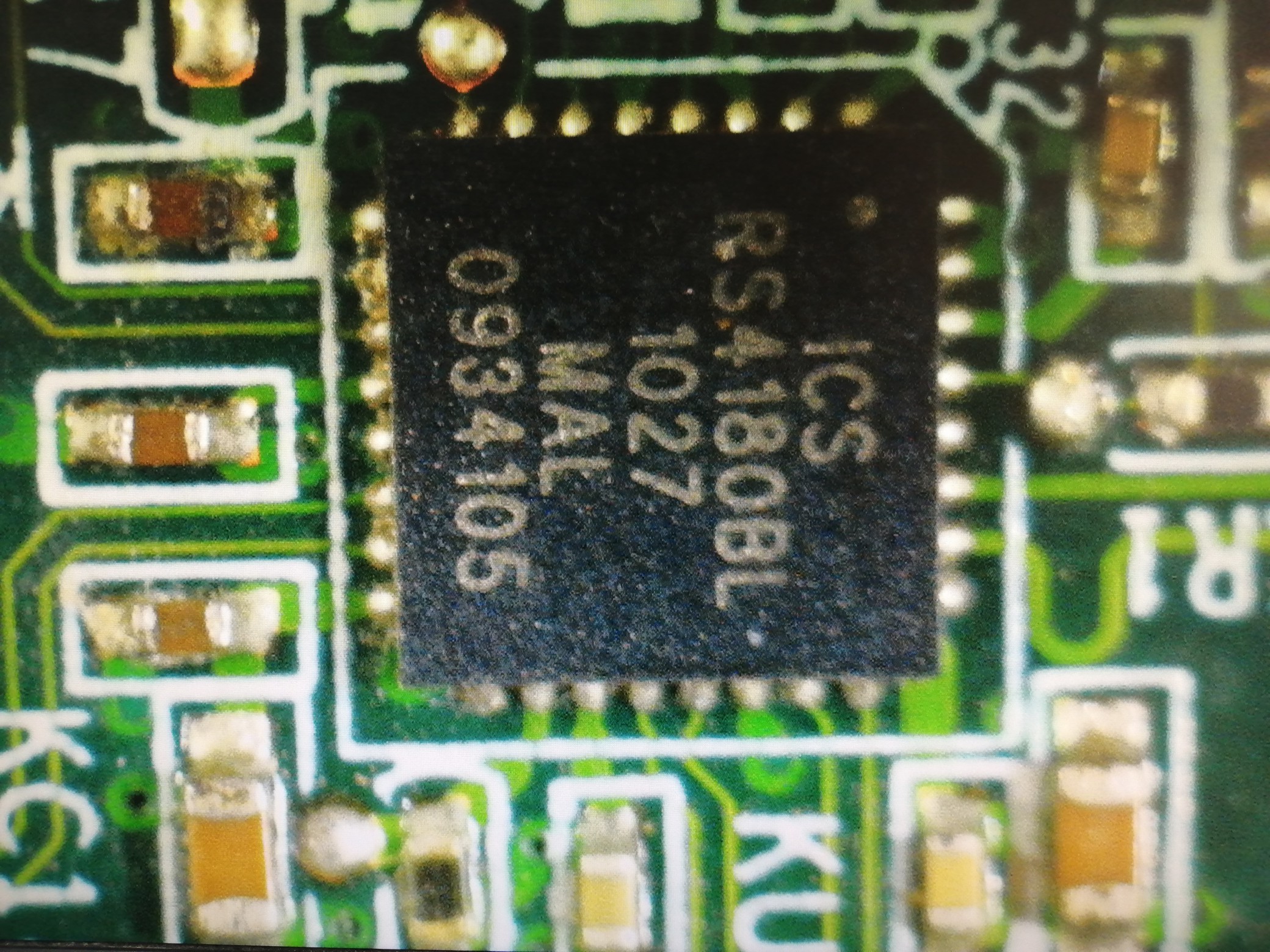

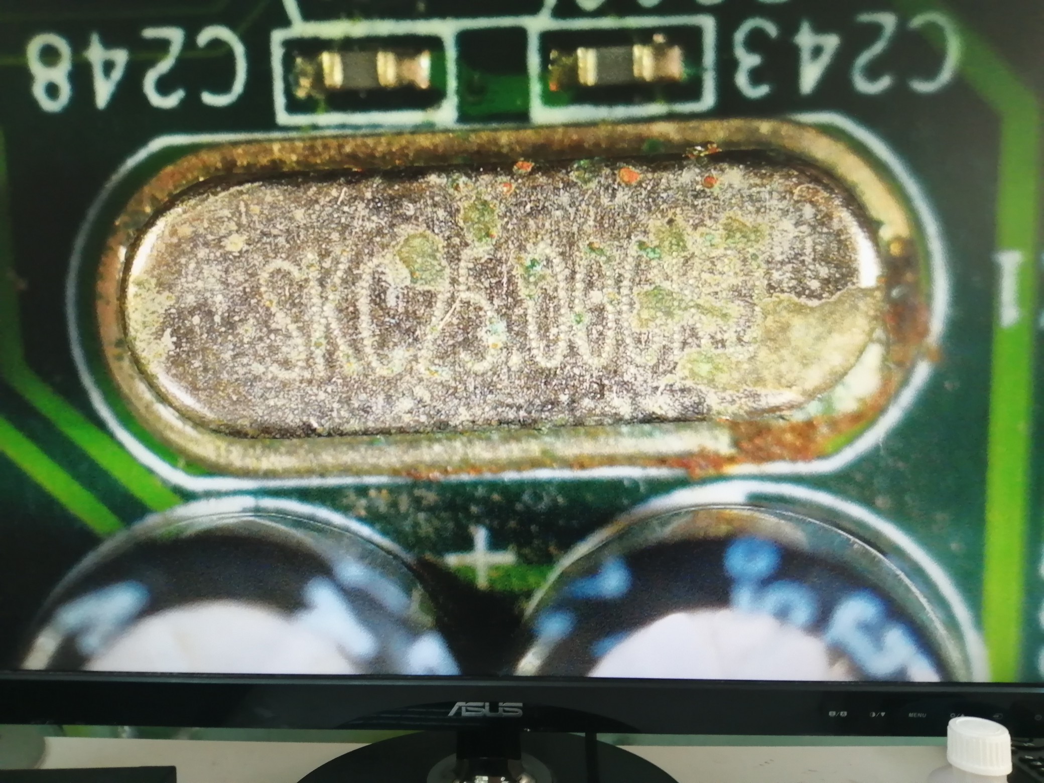

                          I had a look around to see if I could identify the clock generator chip. I think it may be this one RS4180BL but can't find a datasheet to confirm that. I didn't spot any other likely candidates, in fact I eliminated quite a few chips and there are several crystals in the area around RS4180BL

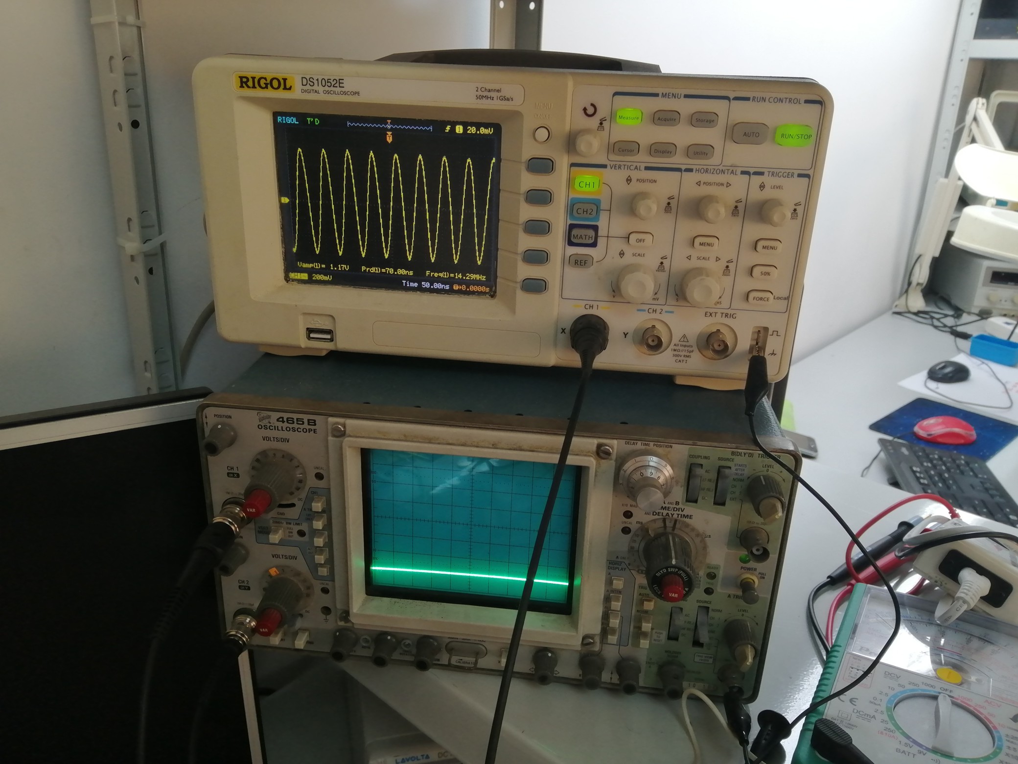

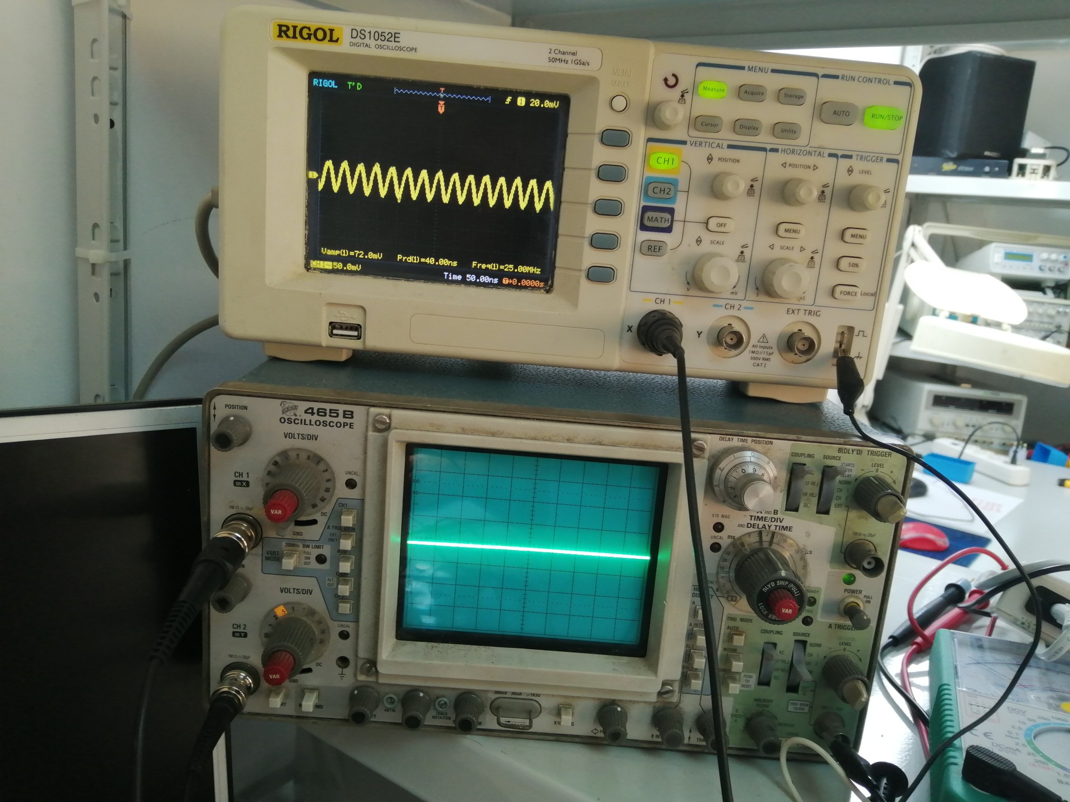

                          One of the crystals X1 is 25MHz and has some nasty corrosion around it. However it does appear to be oscillating but with a low level signal. See pics. The RTC Crystal has the same sort of amplitude. I'll have a look in my spares to see if I have another 25MHz crystal just to be sure it is good, but I think it probably is.
                          There is another crystal KX1 very close to the RS4180BL and the markings are not distinct and that is oscillating at 14.29MHz at a much greater amplitude.
                          I had a look around the capacitors and resistors surrounding the RS4180BL but could not see any other oscillations (multiplied/divided frequencies for example)
                          Also there was some more corrosion around this chip. I've resoldered some of the iffy looking joints on passives and then used flux and reflowed the RS4180BL. It looks cleaner now but it didn't make any difference.
                          The RS4180BL is cold. Also the Super IO doesn't seem to get warm either. I had a bit of a poke around the passives near to the Super IO and I could find some 0V levels, some 3.3V levels and some floating voltages around 1V but no 'activity/signals' as such.

                              I looked up the pinout for the DDR3 slot to see where the Clock signal should be. It looks like I have no system clock to be honest. I can get a pack of RS4180BL from aliexpress or even ebay for a few euros but would have to wait for them to arrive from China.
                              I found a simple schematic for a Crystal Oscillator tester so I'm gonna build one tomorrow and then I can desolder that corroded looking one and test it just in case the amplitude really is too low.
                              I do have a couple more 25MHz crystal 'pulls' in my spares box, they are the two pin ones but the tall package, not the low profile type though i doubt that would matter.

                                  If the RTC clock was an issue the board wouldn't turn on at all. 25MHz is a typical clock for PCH, so that should be good too.
                                  Not sure why CPU VCore would start at 0.9V instead of 1.1V though. Maybe something to look into, maybe not. CPU sets the VCore voltage, so it could be a CPU issue.
