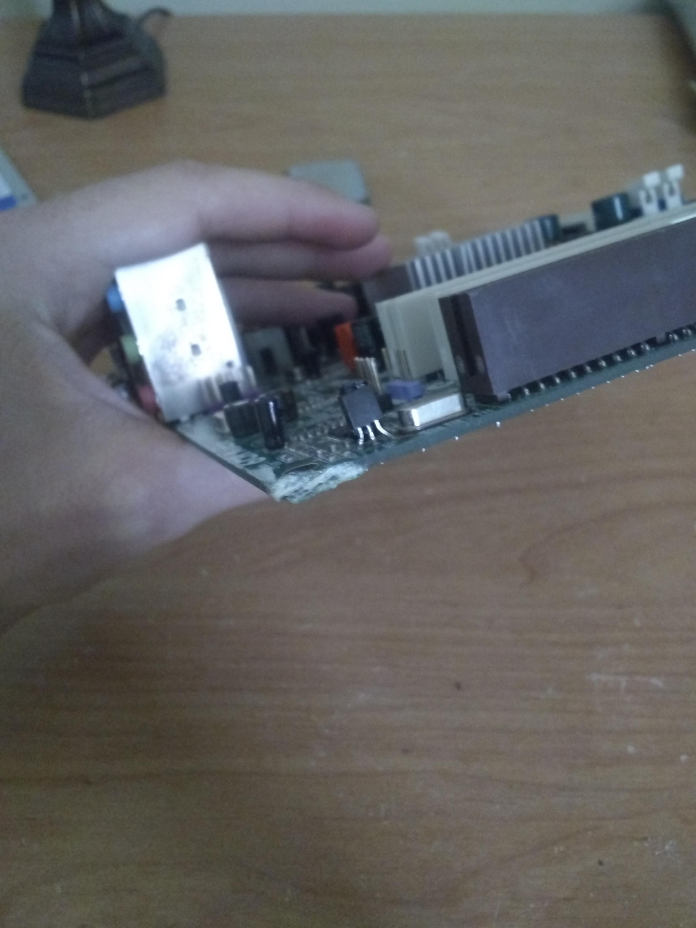

    I was given a machine by a friend that is used to run a CNC machine, and they said it suddenly just stopped turning on one day. I took the board out of the case and immediately noticed a few things.

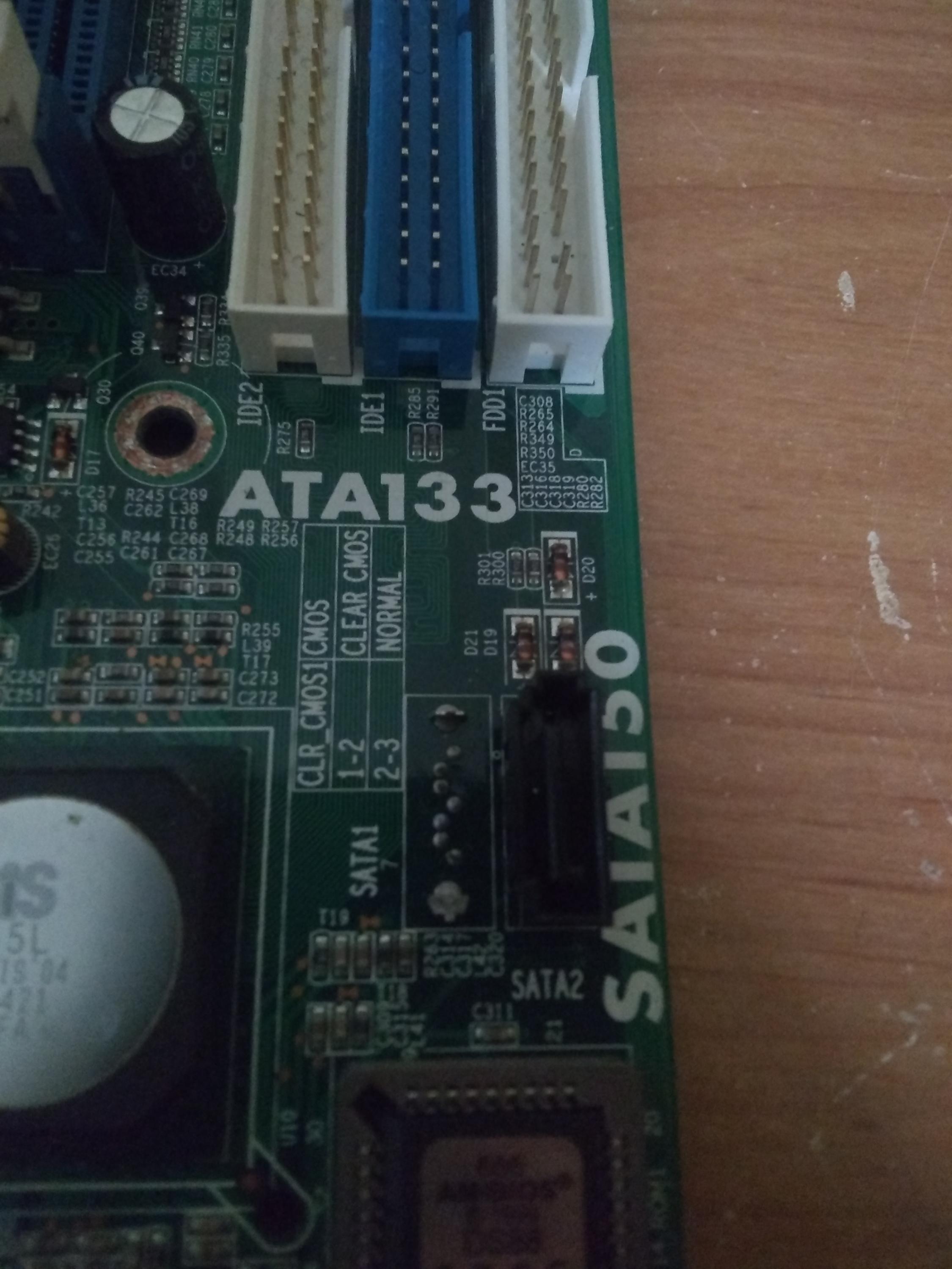

    First, one of the SATA ports is ripped off (there's soldered pins on the bottom)

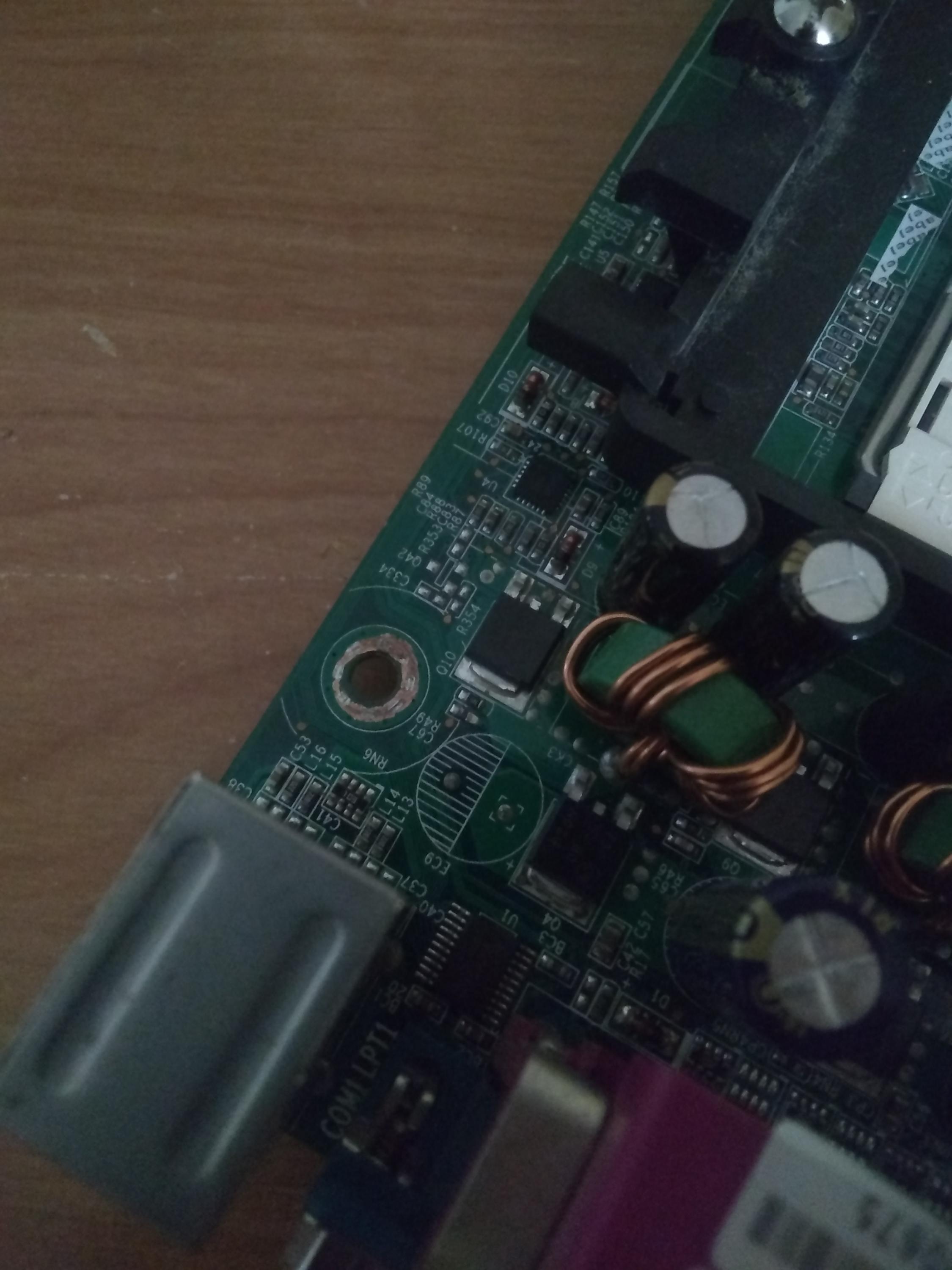

    Second, there's a capacitor missing. What is it's values?
    Third, the board is kind screwed up in the bottom right corner
    And last was that the entire board was slightly warped.
    When power is applied to the board, quite literally nothing happens. Not even a fan twitch. It's as if I'm not even trying to turn it on. Any suggestions?

    Missing cap should be the same as the one below the transistor. Won't cause no power, but may cause stability issue under load.
    The damaged corner could be an issue. I don't think there would be a critical line there, but it could be shorting a power plane to a ground plane for example.
    Try to turn on the bare board by shorting the power button pins, just the CPU plugged in and the 24 pins ATX power connector, nothing else (CPU 4 pins power connector disconnected).
    If still nothing (PSU fan doesn't start to spin), measure the voltage you get on the power button pins.

          Do you see any damaged traces at the edge of the broken corner? (in both sides) 3 volts on the power pin seems reasonable BTW.

            Check jumper settings to make sure Clear CMOS jumper is in proper position. Don't assume that someone hasn't moved it. A lot of motherboard I have will "do nothing" with that jumper set to "clear".
              It looks like just a big thick ground trace

                Re: PcChips (ECS) Goal3+ no power
                CLEAR_CMOS jumper is set to "Normal" position.
