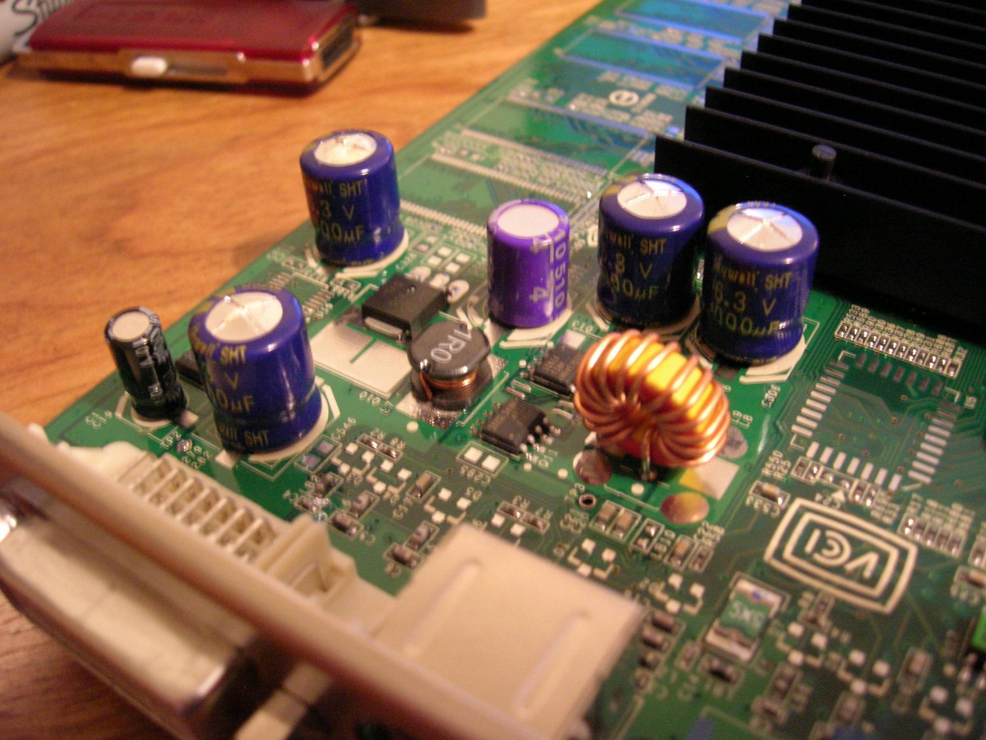

    Nvidea GeForce FX 5200 out of a DELL Dim-8300
    Exactly the same failure exhibited in an earlier thread here
    Attached images are of my card.
    Repairing will probably cost less than replacement, so that is what I'll probably do. Just need to find a good source for the 1000uF 6.3v caps. Probably from the forum owner.

      Found some caps on Ebay. I am going to try to combine shipping from a single seller and get a little stash of an assortment. I plan on only replacing the 4 1000uF 6.3V caps (Skywell SHT). The other two 1- 100uF 10V (Sanyo Black sleeve) and a 510/4 OS CONN (Sanyo as well I believe) have no visual display of malfunction. So we shall see if replacing the 4 blown caps will correct the issues with the board.
      If anyone happens to know, how do you decrypt the Sanyo OS CONN sleeve label? is it a 510uF 4V cap? just guessing here.
      Jim

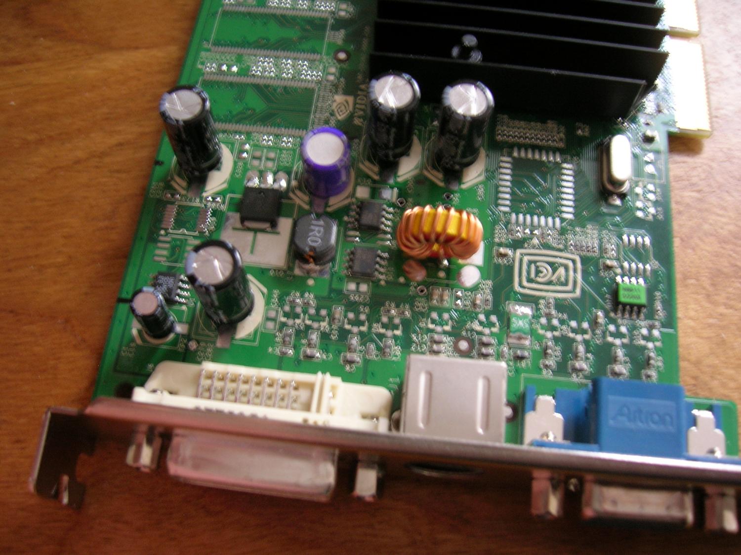

              I also have the same card. One cap was hit and pushed over sideways. I pushed it back to its normal position and plugged it in. It works for now... I think I will just buy a new card soon.

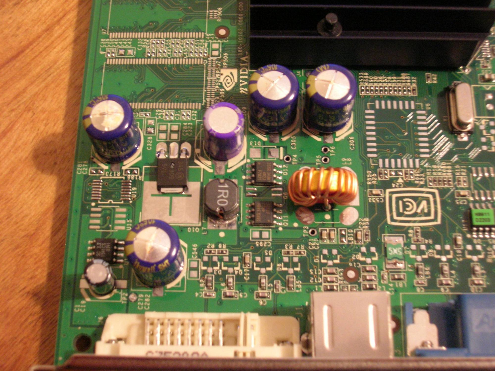

                Re: Nvidea GeForce FX 5200 out of a DELL Dim-8300
                Well can't test it... no AGP slots here. But the caps a swapped & I'll whine if it isn't working
                But my miserably out of practice soldering skills seem to have worked.
                        Board tested fine. Reinstalled the board in the system today, booted fine, display worked fine. Ran the diagnostic software (came with the system) for about four hours, glancing at it occasionally, never saw a hick up.
                        So I pronounce it good, for what that is worth
