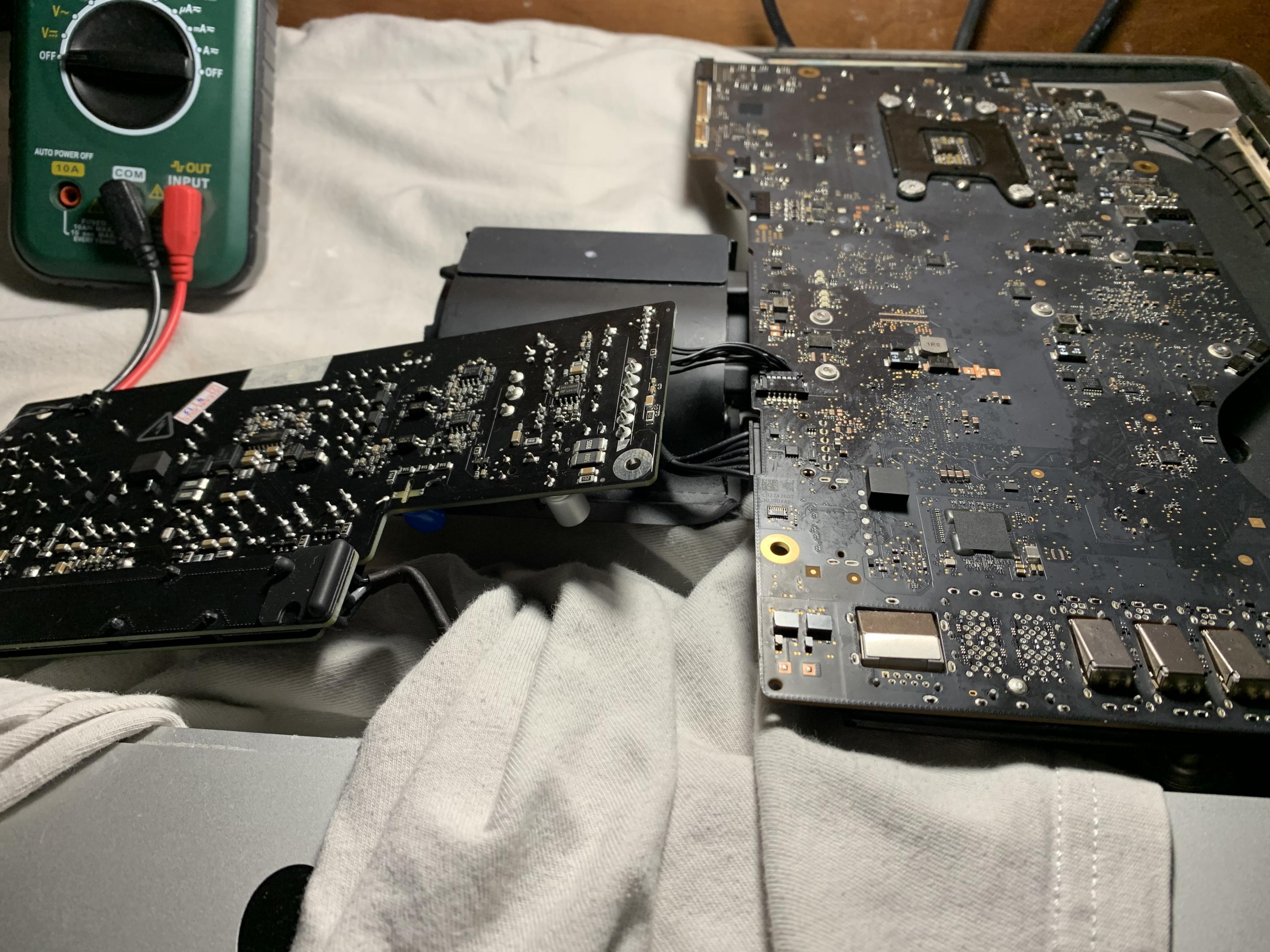

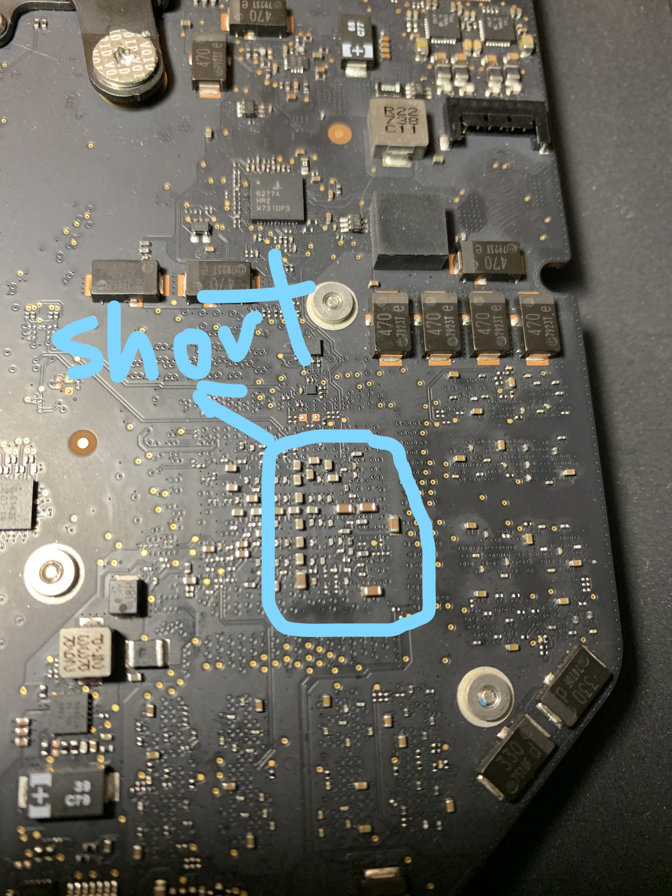

                  I have the same problem. The Mac is completely dead. No lights on the board are on. I used to think it was from the power supply. I changed the power but still the same problem. I have a 12 volt input.
                  please helppppppppppppppp

                    Re: iMac A1418 21 inch 2013/2014 820-3588-A NO POWER, FIXED!
                    Unplug all power to the chassis and then confirm that the ac plug and socket on the back of the enclosure is reaching the power supply inside.
                    If you do not see the first led ON then you have no power to the logic board. Could be as simple as a loose power connector.

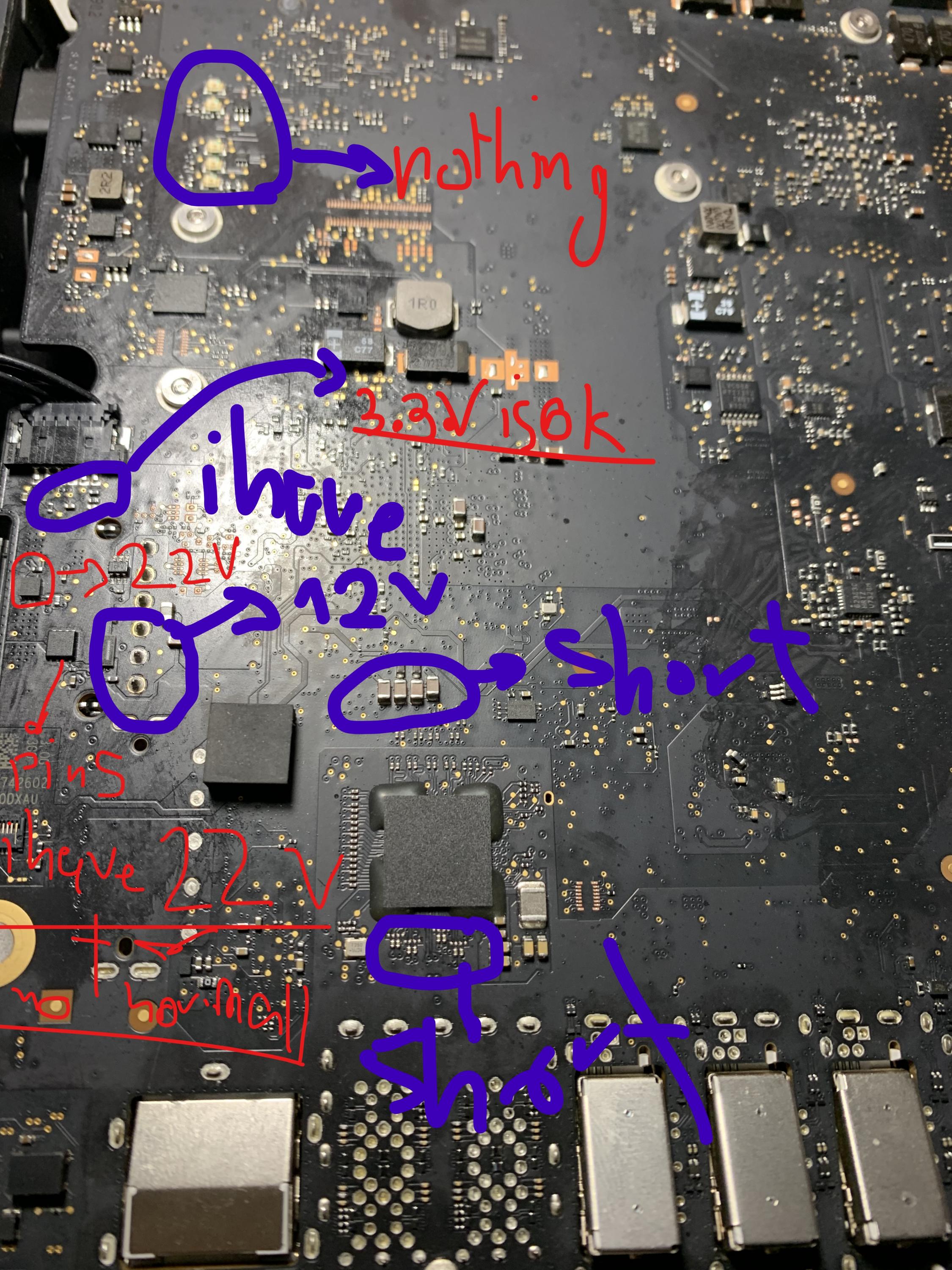

                      but I have learned so far the I mac runs on three voltages - 5v, 3.3v and 12v for the inverters.
                      i have 12 v in pp12v_g3h
                      i have short in region U2800 this is for gpu
                      i dont think socket power loose on logic board
                        Check the resistance to ground on the polarized caps (tantalums with the "+" or solid white BARs markings) - do this with the power OFF. Like the 330 in your shared pic.
                        It is ok to have a low resistance to ground on the CPU and GPU as they are low voltage rails but list the values you find.

                          Thank you very much for being online. I will review the circuit again and send you the report. Thank you very much
