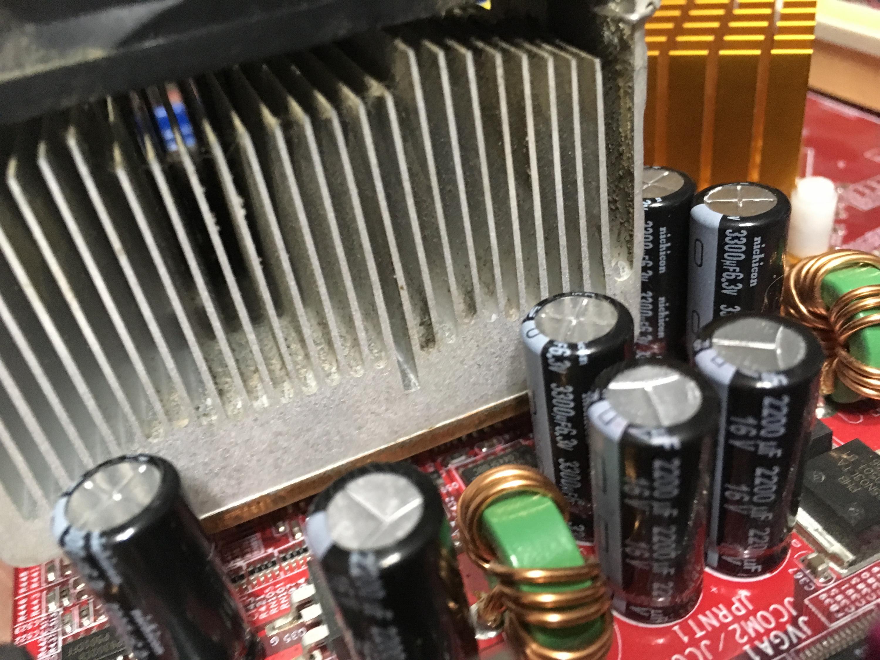

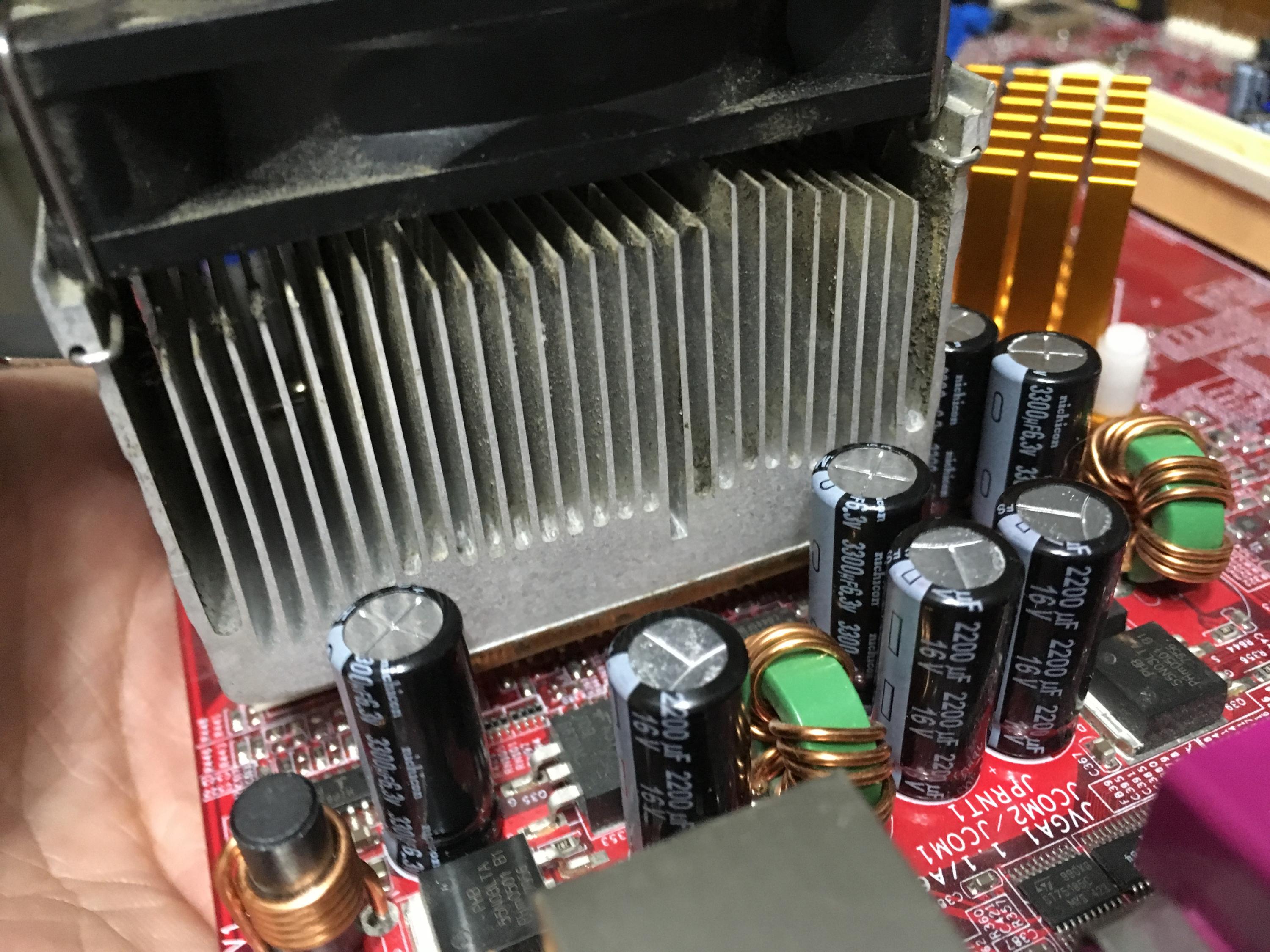

Hello all I was planning on recapping my N7NCG 400, the VRM section is what has me concerned. It has 4 3300UF 6.3 OST RLX capacitors and 3 2200UF 16V caps also RLX. I was wondering if I can go 10V caps for the 2200UF I wanted to do some older nichicon HM for this VRM. The last thing I want to mention is the 2200UF 16V caps look to be OST black RLS on other boards and I thought the RLS wasn't a ultra low ESR cap so I thought maybe I could get away with regular low ESR for the 2200 caps like a panasonic FM or something.

May we see some pictures of the board? The images I'm getting through searches on the internet are being inconsistent. If that board has a 4-pin 12V CPU connector, then NO, you cannot use 10V caps to replace 16V caps, because it means those 16V caps are likely connected on the 12V rail.
And yes, Panasonic FS should work fine for the recap - both for the OST RLX and RLS. RLX is supposedly motherboard-grade ultra-low ESR, but their specs trail those of Nichicon HM and Rubycon MBZ by a fair bit. Meanwhile, series like Panasonic FM and FR are not that far behind the RLX specs. So in a pinch (especially now that mobo-grade ultra-low ESR caps like HM/HN/HZ and equivalent are no longer made), Panasonic FM, FR, and FS should work alright. I think the Rubycon-equivalent of those are the ZLS. For Nichicon, it should be HW. All are still active parts, as far as I know.Last edited by momaka; 01-23-2019, 10:35 PM.

BigTroll: You can measure the voltage on the places where 16v OST caps were and check the voltage going through. Most likely it's an design similar to ASUS' A7N8X-E Deluxe where they got away with an boatload of 3300uF 6.3v caps and no 4pin 12v connector.Main rig:

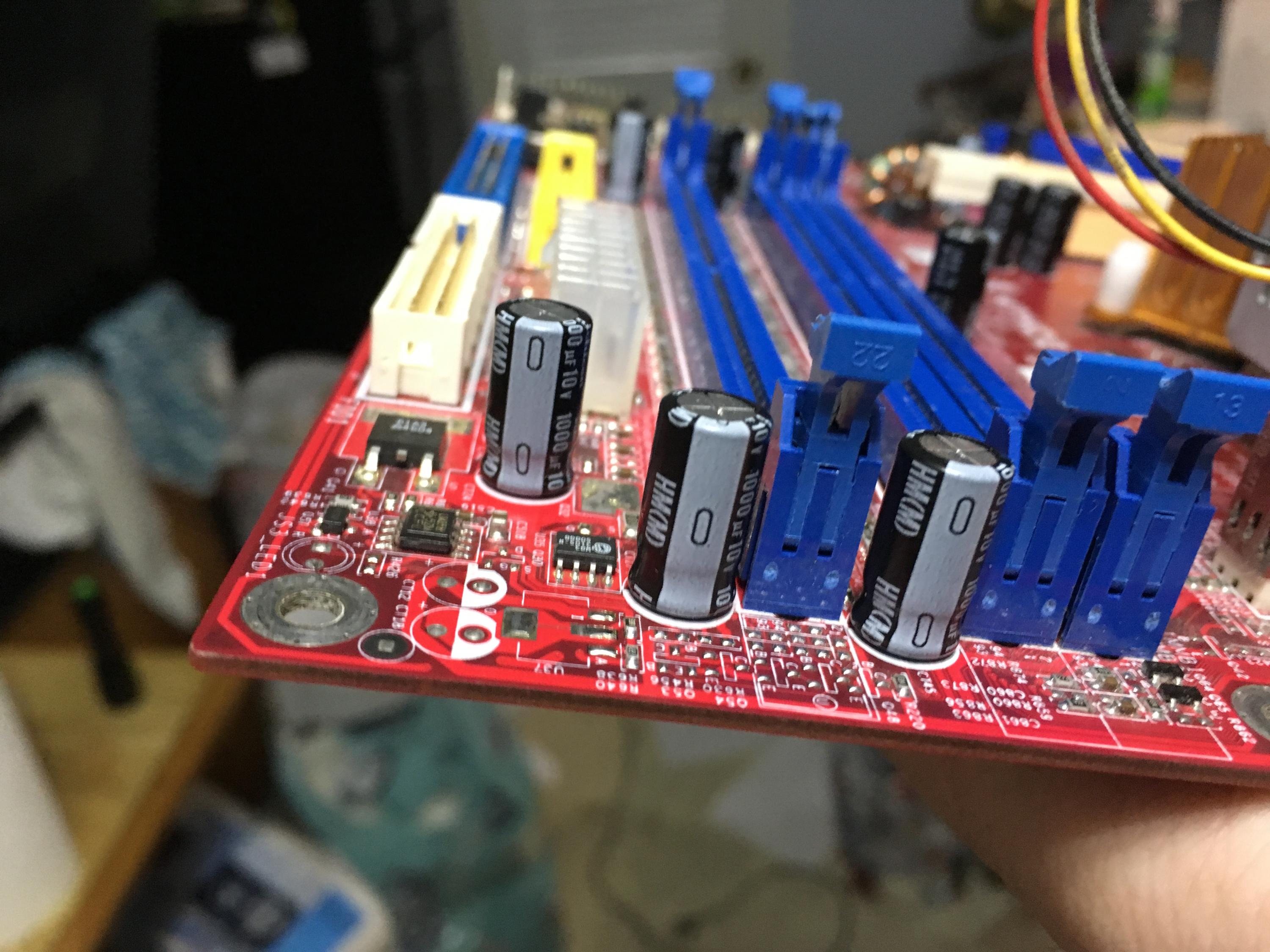

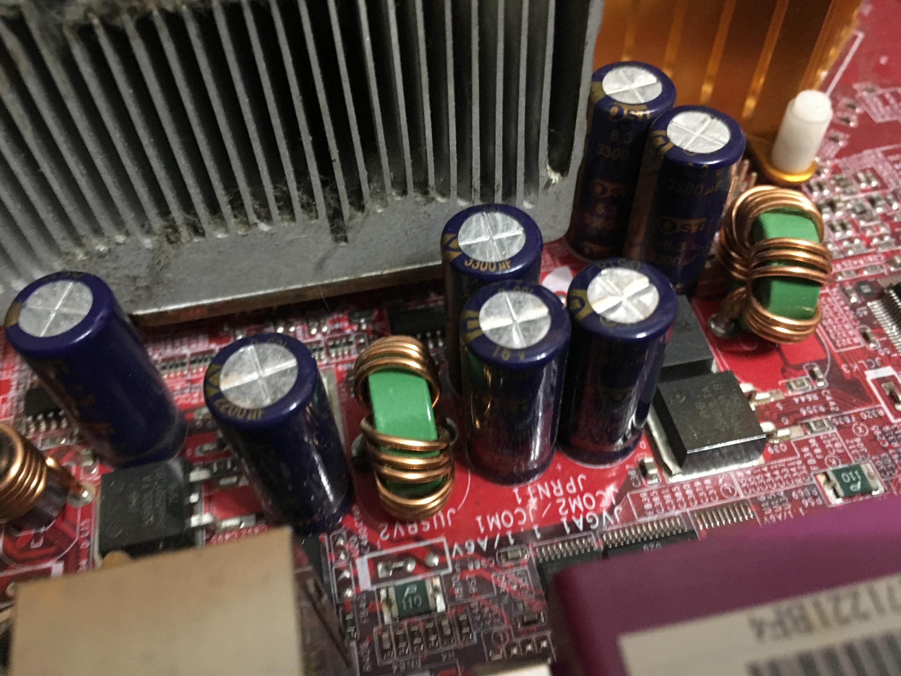

Hi guys so I did order the 2200uf 16v pannasonic caps that are 10mm. I finished recapping the board but have to wait on mouser to ship the panny caps and they are taking forever.My Computer: AMD Ryzen 9 3900X, Asrock X370 Killer SLI/AC, 32GB G.SKILL TRIDENT Z RGB DDR4 3200, 500GB WD Black NVME and 2TB Toshiba HD,Geforce RTX 3080 FOUNDERS Edition, In-Win 303 White, EVGA SuperNova 750 G3, Windows 10 Pro

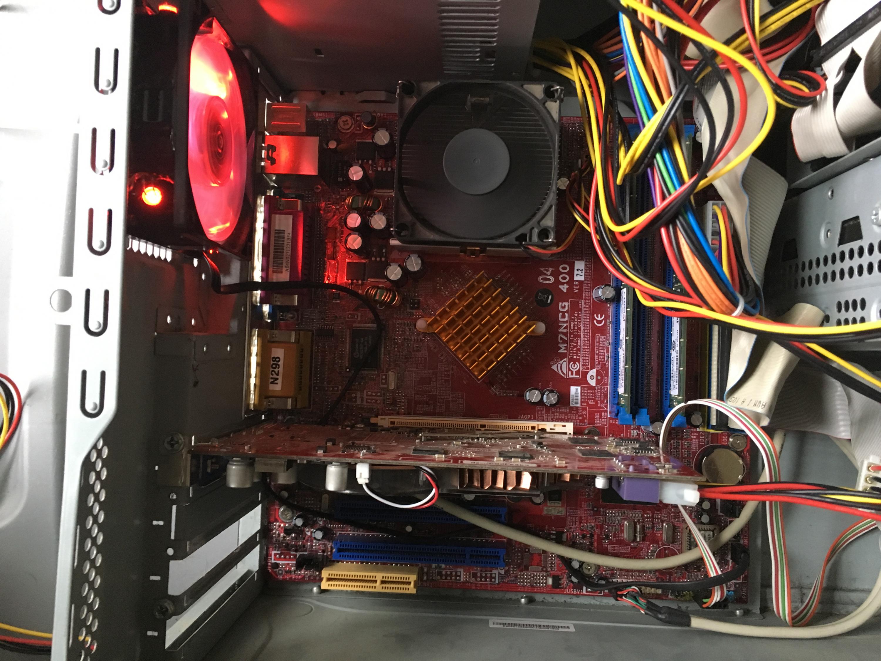

The recap seems like a success so far 2 passes in memtest where it kept erroring out before, will let it run all night and see how she does. Its a athlon XP-M overclocked to 2.4ghz with 2gb ram, 200gb WD IDE, DVD-RW, ATI X800 PRO.
One More thing I want to mention using a temperature gun, the OST caps were running 100-110F when taking the temps, the new nichicons are only 89-95F or so. I took the temps while the system was running memtest for 30 mins both times.Last edited by BigTroll; 01-26-2019, 07:18 PM.My Computer: AMD Ryzen 9 3900X, Asrock X370 Killer SLI/AC, 32GB G.SKILL TRIDENT Z RGB DDR4 3200, 500GB WD Black NVME and 2TB Toshiba HD,Geforce RTX 3080 FOUNDERS Edition, In-Win 303 White, EVGA SuperNova 750 G3, Windows 10 Pro

Or maybe the OST's parameters (ESR, capacitance, leakage current, etc...) just degraded over time (which is quite possible given the previous memtest errors), if the specs of that batch weren't exaggerated to begin with. I take it those older Nichicon HMs were made after 2004 or 2005. I think the low temperatures are probably because of the low TDP (albeit overclocked) Athlon XP-M.

I like how you have a red AMD motherboard, red ATI video card, and... red LED fan. Go Team Red!
BTW, that ATI X800 Pro looks like the old gen, before ATI started using a separate AGP bridge chip. Make sure to keep it cooled well (might want to invest into a bigger heatsink). Otherwise, it'll probably fail over time.

Not to say your measurements are not true... but all I will say is that I don't usually trust those laser temperature "guns". Depending on the color and surface texture of the material (i.e. dark vs. light and smooth/reflective vs. rough), the temperature can vary quite a bit. Granted cap sleeves are typically pretty smooth, so there likely won't be much error in those readings (at least in the temperature differences). Still, I rather use my type-K thermometer.
