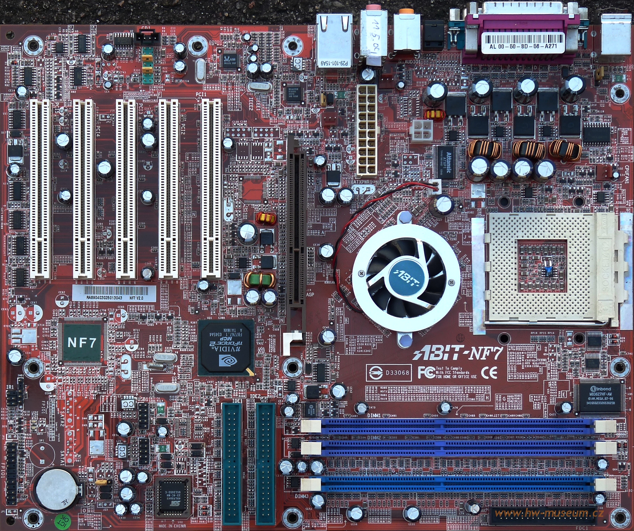

      lastly, u didnt post an image of your board, so i had to find one from around the web. is the attached image the correct picture of your board? i need a proper image of the board to study the cpu vrm to see how its designed to help u with the overclocking difficulties u are experiencing with the board.

        Yes, that's the board. Mine also has SATA, but otherwise it's identical.

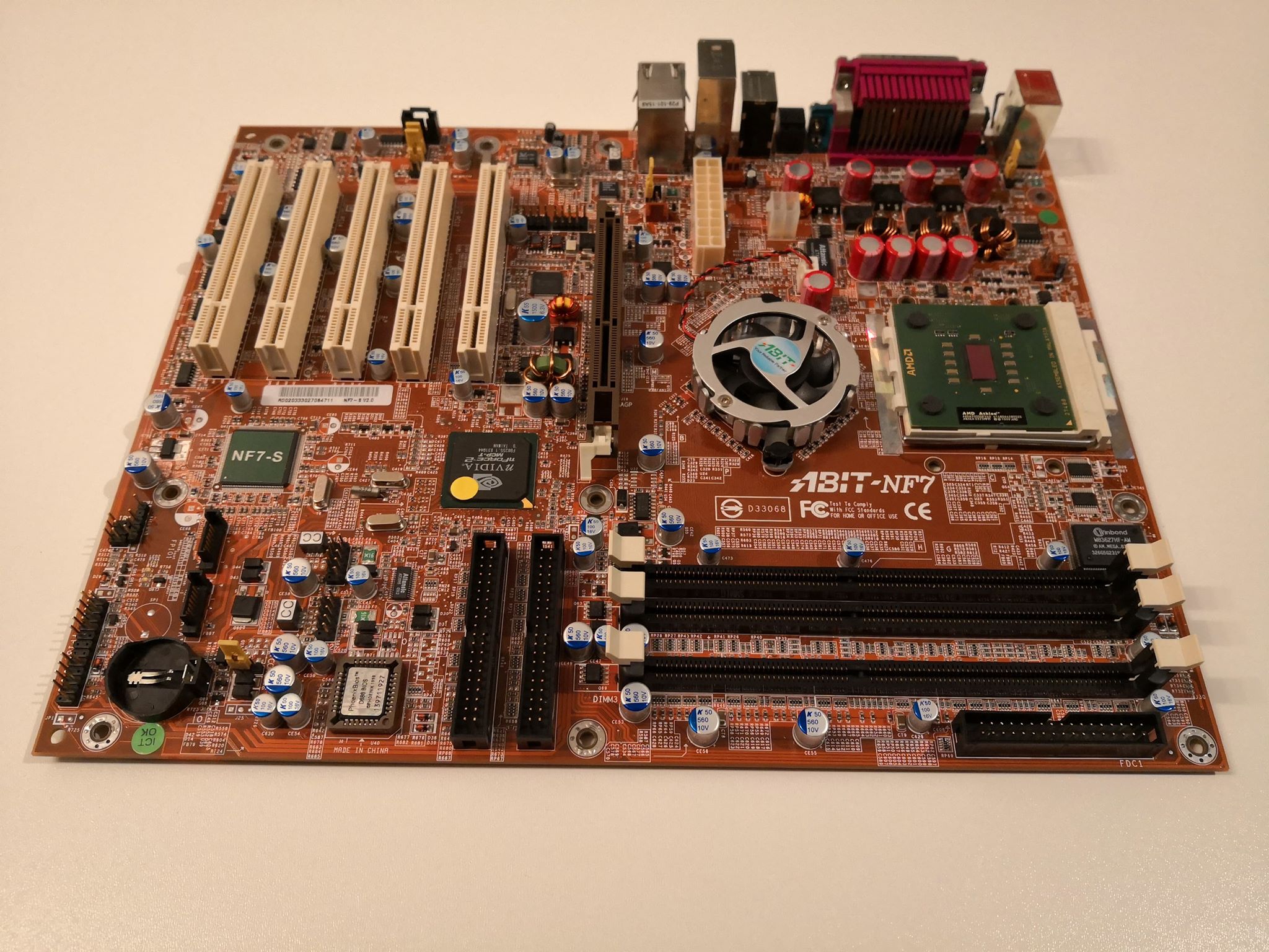

                Thank you for all your suggestions and advices. Job is done, here it is:
                After swapping all the capacitor, board seems to have regained some of the original OC capability. Further tests are needed, but not much time to do that ATM. For one, I clearly need to test with a stiffer PSU.
