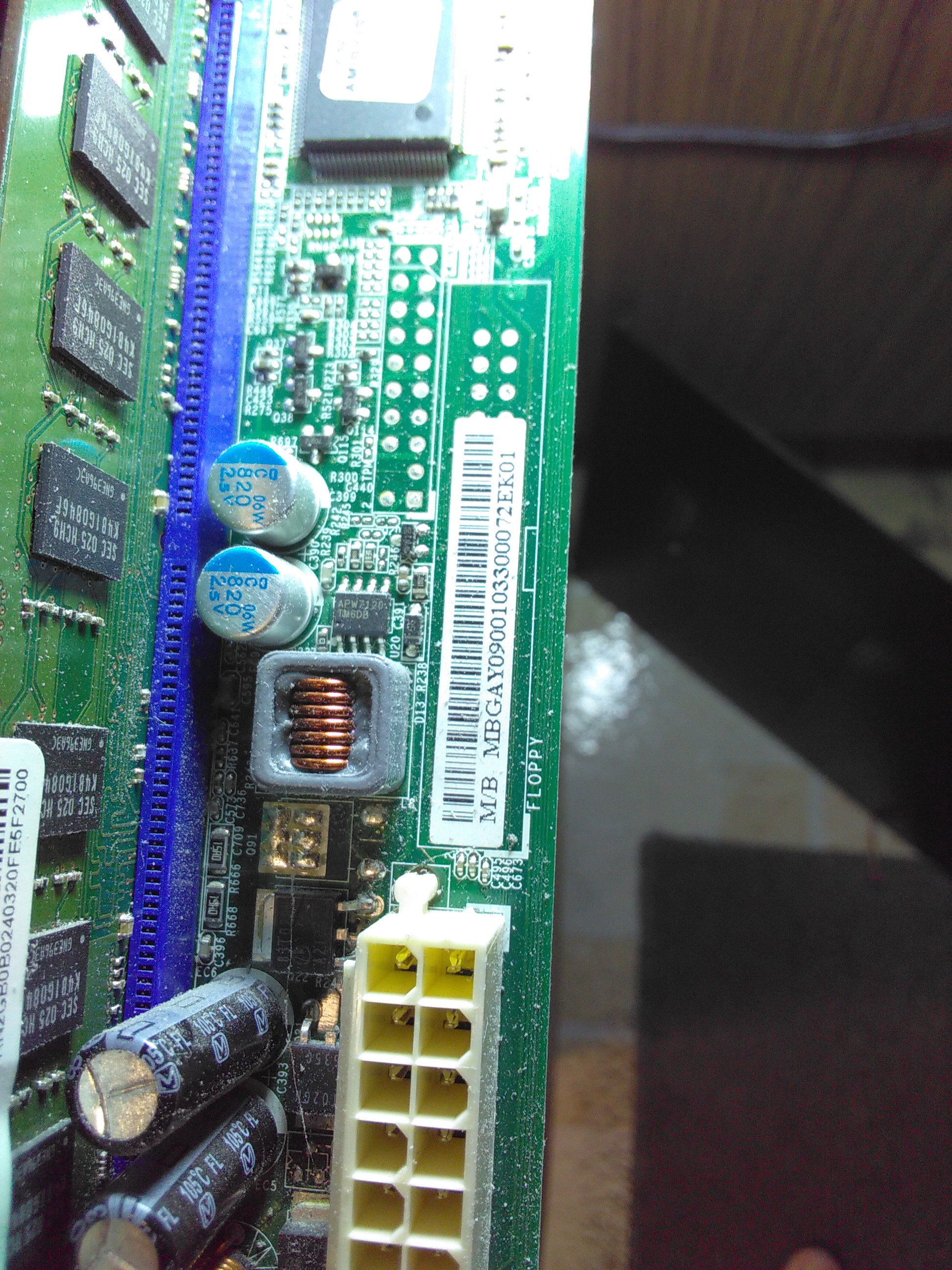

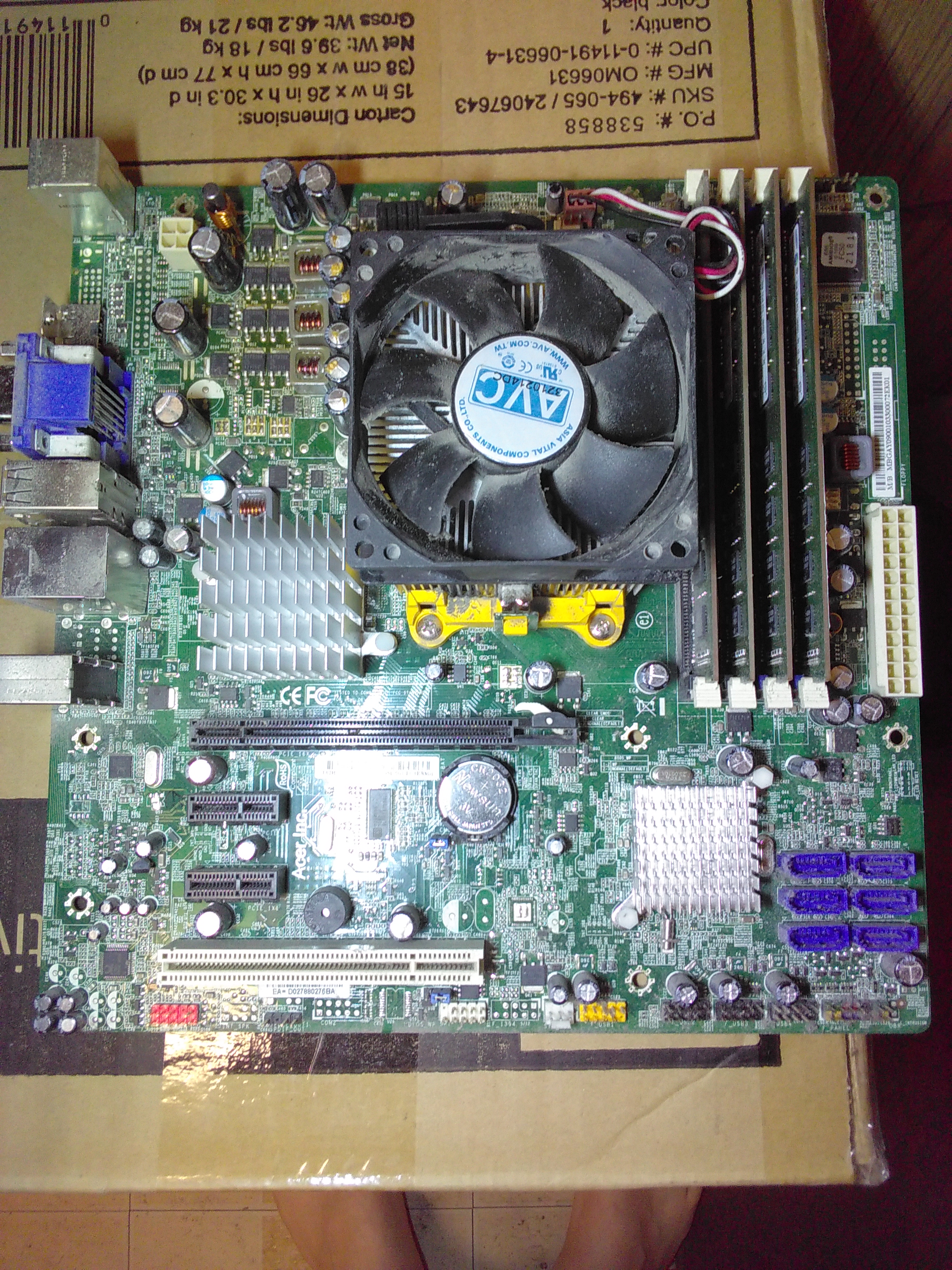

        Thanks. It says: M/B MBGAY0900103300072EK01, but I don't find anything for that part #.
        Please find picts attached. (Please disregard the first one - it's blurry.)
        No information on the board is available, and I haven't removed the CPU to find out what kind it is.
        Other than the 6.3v 1800uf rating, the caps just have an "FL" after the 105°C, and also an "M" inside of a box, which I've recreated in photoshop in a rough manner and attached below with the picts. There is nothing else printed on teh caps.
        They are 8mm in diameter and 22mm in height. I found the following on Digi-Key, when filtering only for 6.3v 1800uf radials with 8mm diameters:
        https://www.digikey.com/products/en/...=1&pageSize=25
          The "M" inside a box is Matsushita's logo - i.e. Panasonic. FL indicates the series. So you have Panasonic FL caps. These caps are of really high quality - one of the best you can find. So indeed they probably failed due to exposed to high heat for a very long time.
          Bad news is you're unlikely to find ultra-low ESR electrolytic caps as good as Panasonic FL.
          Good news is, your board certainly looks new enough to use polymer caps. Something like United Chemicon PSC 2.5/4V @ 820-1200 uF should work fine as replacements (at least for the caps around the CPU). There are many other options, of course. Just look up the specs on the Chemicon PSC caps I mentioned above in their datasheet (do a search online for Chemicon PSC and look for PDF files). From memory, I think Nichicon LF and Panasonic OS-CON SEPC (or Sanyo SEPC, if you find New-Old-Stock... ie. NOS parts) are all more or less equivalent to Chemicon PSC and readily available on Digikey and Mouser.
          Regarding the motherboard... given the yellow CPU HS retention plastic, I can only think of this board being a Jetway OEM... though they usually use Phoenix bios, so maybe not. Other two candidates are Intel (which is unlikely, as this is an AMD board) and ECS. Probably an ECS.
          In any case, the darkening near the CPU area doesn't look very good. What CPU is installed in this motherboard? I'm thinking it may be just right at the TDP limit of what this motherboard can handle, hence the darkening.
          Also, this appears to be an AM2/AM2+ board. Many of these boards came either with AMD North/Southbridge shipsets or nVidia GeForce 6150/6200 chipsets. If it's the latter (i.e. a GeForce chipset), put a small 40 mm fan on both the Northbridge and Southbridge heatsinks. If it's an AMD chipset, putting a small fan on the Northbridge is advisable too (but not always required, if case cooling is very good).
          And lastly, with this board appearing to come from an Acer PC, it's worth having a look inside the PSU for bad caps as well.

              Re: Unknown Motherboard Recapping
              Foxconn board maybe?
              Also this has DDR3 RAM so it is an AM3. NVidia MCP for AM3 are fully integrated, there's no external southbridge, so this is an ATi chipset. 780 or 880 northbridge probably.
              But yeah those are not really reliable so they would benefit from additional cooling.
              I confirm the discoloration around the CPU VRM MOSFET, this doesn't look good. Make sure you don't use a CPU that eats up to much power, and enable Cool'n'Quiet.

                      This is a 3 phases VRM probably with some random not really efficient MOSFETs. This will not be able to handle a 8 cores CPU properly. I would stick with 65W TDP CPUs, or some lower-end and "newer" 95W. Also this would mean it is an AM3+ board if it supports AMD FX- CPUs.
                      About the undervoltage, those CPU usually have some room for it. Sadly OEM BIOS don't let you tweak the voltages, but yep getting 0.2V lower isn't unusual. Cool'n'Quiet will take you from 1.35V to 1.1V on 1GHz already.
                      The Cool'n'Quiet SSDT ACPI table can be tweaked to get lower voltages permanently, although I don't know if you can inject an ACPI table with Windows without flashing the BIOS. With Linux, you can.

                                        My bad; I glanced at the search results page I linked to (with a bad link, mind you) and misread what I saw.
                                        They are, indeed, 8mm OD with 3.5mm spacing.
                                        (And DOH! The board says "ACER, Inc." right on it.)
                                        Awesome! Thanks so much for your help, folks.
                                        Now I'm wondering if I bit off more than I can chew with this soldering job. The board has no traces on the back of it connecting to the capacitor leads. And it doesn't look like any are visible on the front. So do I just solder the things in and trust that there are somehow traces imbedded between the laminates?
