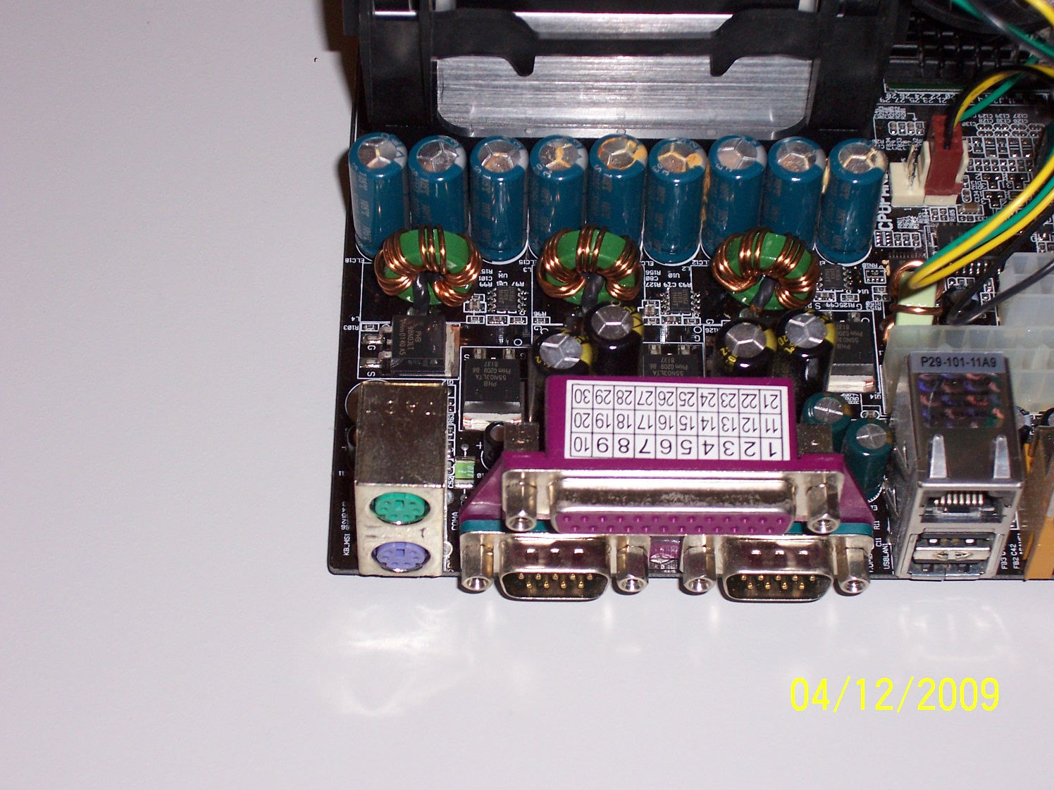

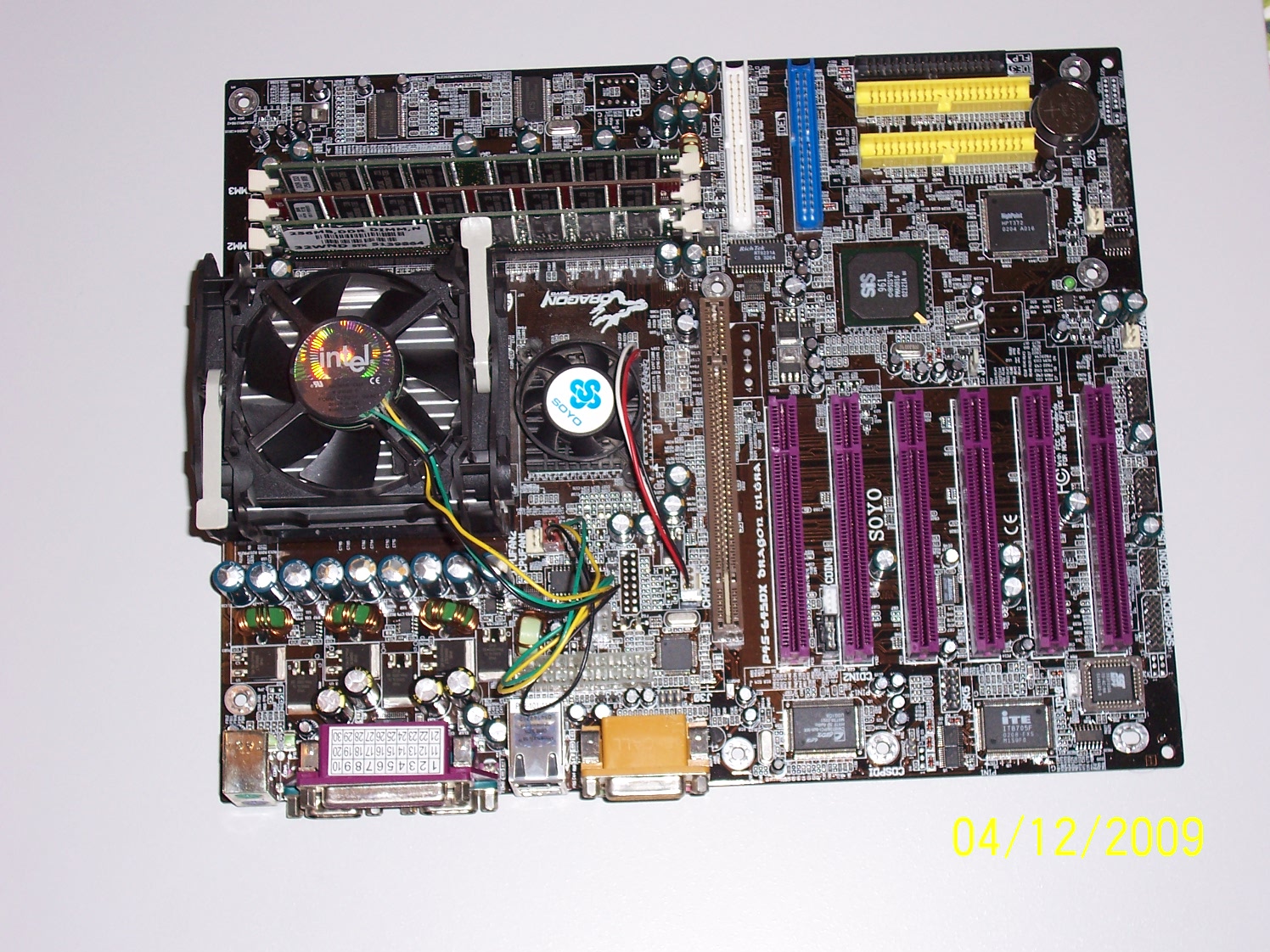

Soyo SY-P4S-645DX Dragon Ultra needed new caps
  • everell
    • Jan 2009
    • 1514
    Purchased November 2002
    Bank of nine 2200 uF/6.3 volt SACON caps bad
    Replaced with Nichicon PWM 2200 uF/10 volt caps
    Photos attached.

          Do you mean PW(M)? I didn't think they were low enough esr to use on motherboards.

              Use rubycon MBZ or equivilant. Nichicon pw are too high esr to use on a motherboard.
