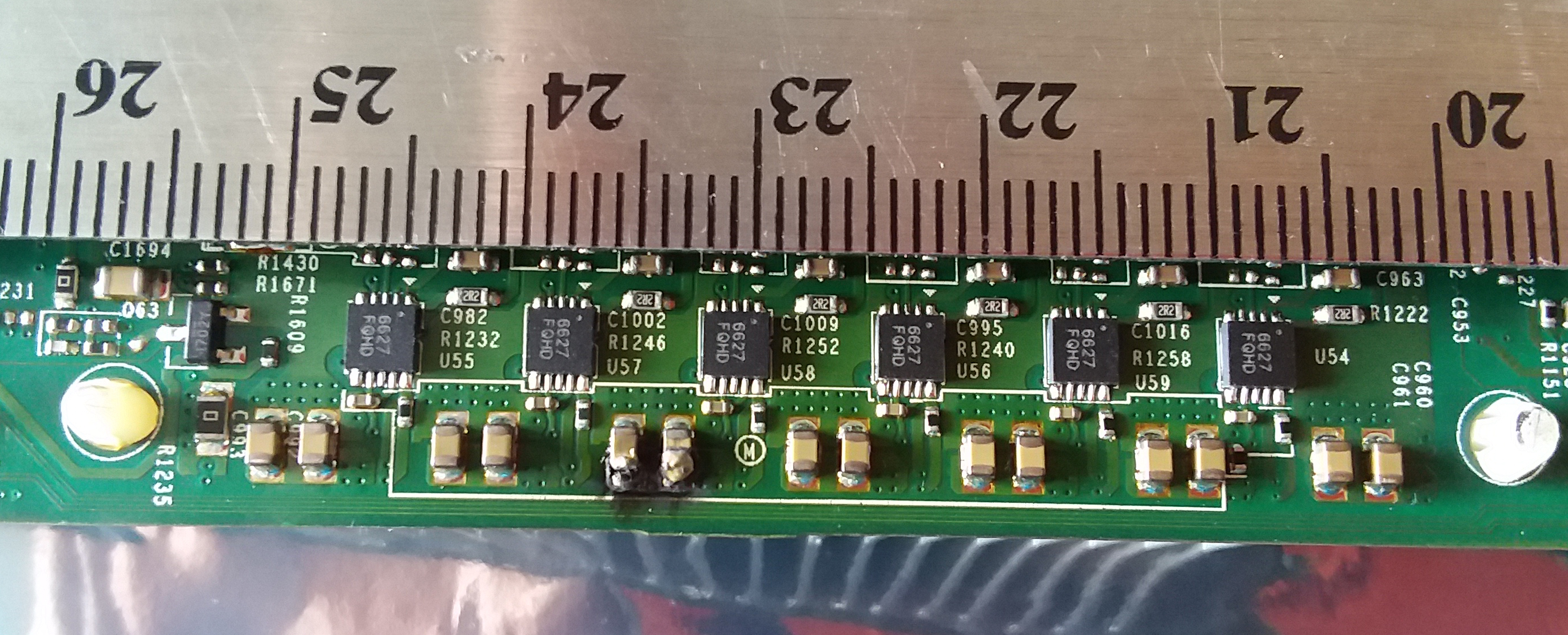

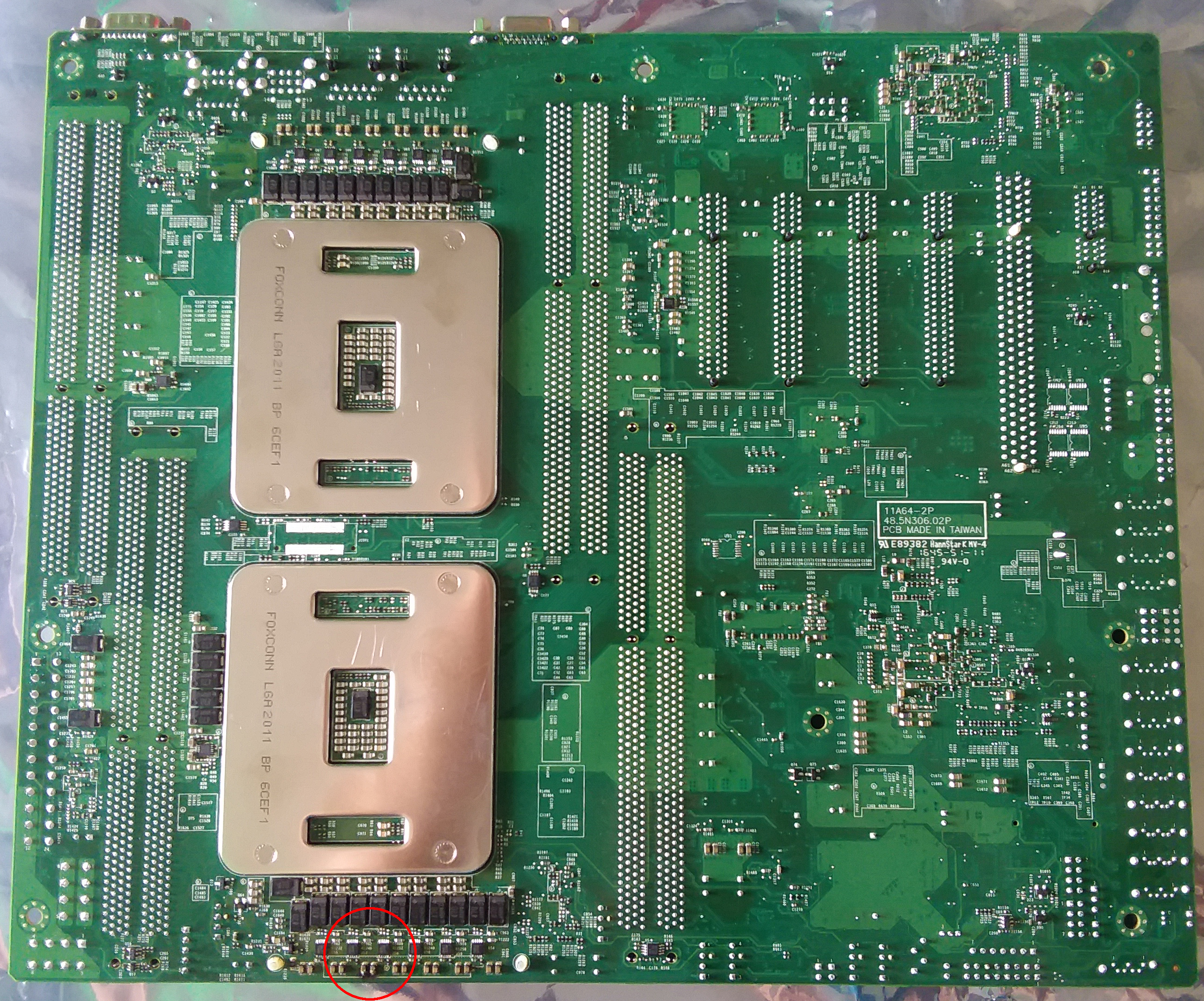

    Sorry this isn't exactly cap related but I don't know where else to ask. I have a Supermicro X9DRL-iF board and the customer told me that a bad power supply caused these components to blow after he tried a 2nd identical board and the same components blew.
    I need your guy's help, can anyone tell me what these components are called? and where can I find replacements? He would like to get both boards working again. I can't see any markings on them, and I haven't desoldered them yet. I will probably desolder two good ones from the other board just to see if it will even work and worth pursuing.
    Thanks in advance!

    Re: Need help identifying a component. Supermicro X9DRL-iF
    They are ceramic capacitors
      Thanks, is there a way to find out their values so I know what to look for?
        The ic's appear to be ISL6627CRZ, but the data sheet does'nt show the cap values.
        If you can't find the value, remove one of the good ones and check its capacity, I suspect the voltage rating will be low, 10 volts?
          Also check if the caps are connected to the CPU VRM low side (CPU V_core, which is usually 1.x volts) or high side (typically 12V). This will matter for choosing the voltage rating of the caps - for the high side (12V), a rating of 25V or more is recommended. For the low side, 4V or more would be needed.

          Probably best to remove one and check the capacitance (if you have a capacitance meter, that is). Otherwise, going by what voltage rail the caps are connected to, I find that high-side ceramic caps are typically 4.7 uF and low-side caps vary between 4.7 uF to 20 uF, depending on size and count.
