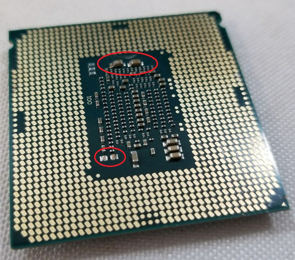

skylake (6700k) smd capacitor
  • ziddey
    • Sep 2015
    • 35
    • usa
    skylake 6700k
    Haven't received this cpu yet, but would anyone happen to know the specs for the circled smd capacitors / have a digikey link? Hoping that's all that's wrong with the chip.
    Thank you
  • piernov
    • Jan 2016
    • 4438
    • France
    Re: skylake (6700k) smd capacitor
    Use calipers to measure the size of the remaning caps, and then get the highest capacitance value (probably with the lowest voltage rating) you can find at this size and it should be ok.
