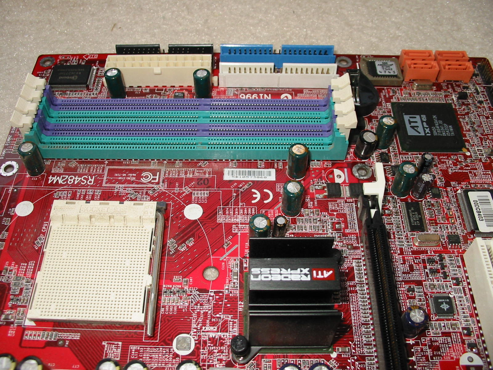

    I guess I might as well keep the motherboard recap threads on a roll. I have done quite a few recaps over the years, taken pics with intention to posting them, and then never did. So now is the time, I suppose. Like I said, I hope to revive the motherboard forums a little bit with these recaps.
    So… shortly after recapping the ECS MCP61SM-GM seen in this thread, I decided that it was finally time I get a motherboard with a PCI-E slot. I did have an AsRock 939Dual-SATA2 that had it already, but it was a finicky and unstable motherboard, so I wanted something better and more simple.
    In no time, I found a perfect candidate on eBay: an MSI RS482M4-ILD (MS-7191) motherboard with just a few clearly-visible bad caps that was sold For Parts or Repair. $25 later ($14 for mobo + $11 S&H), and I got it.

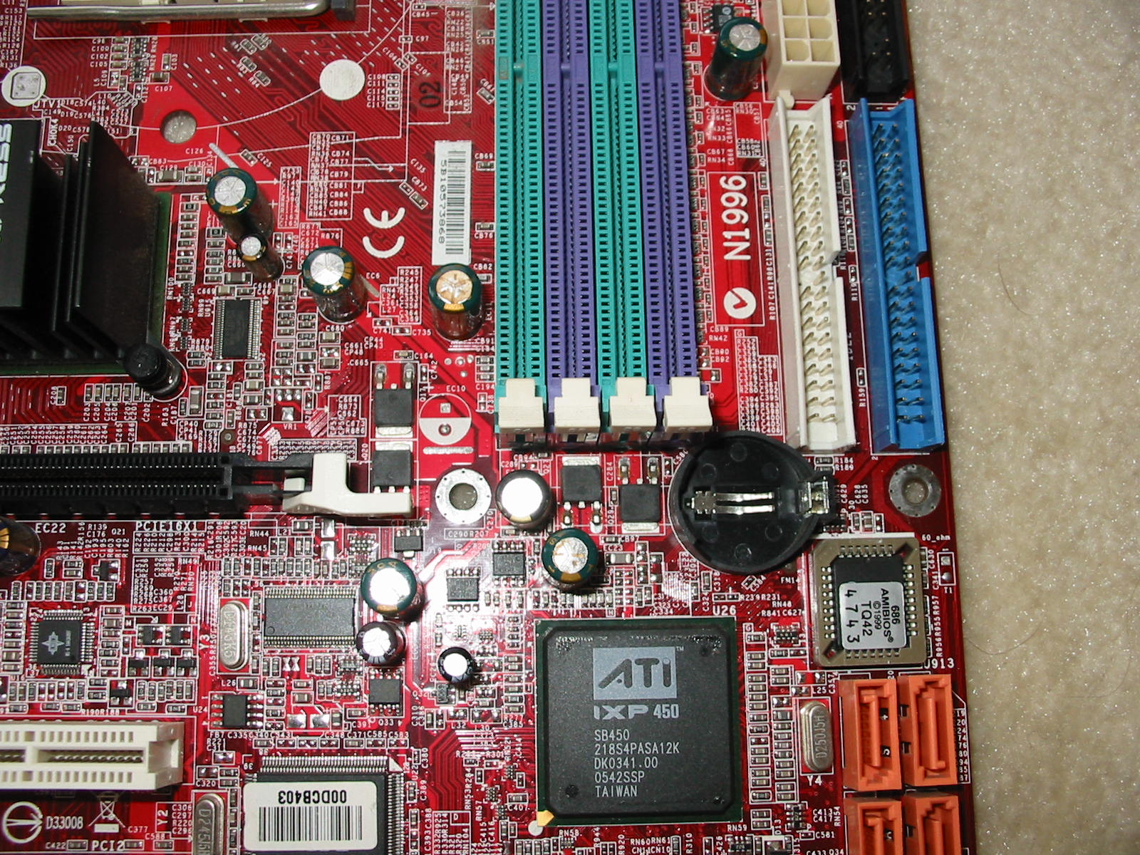

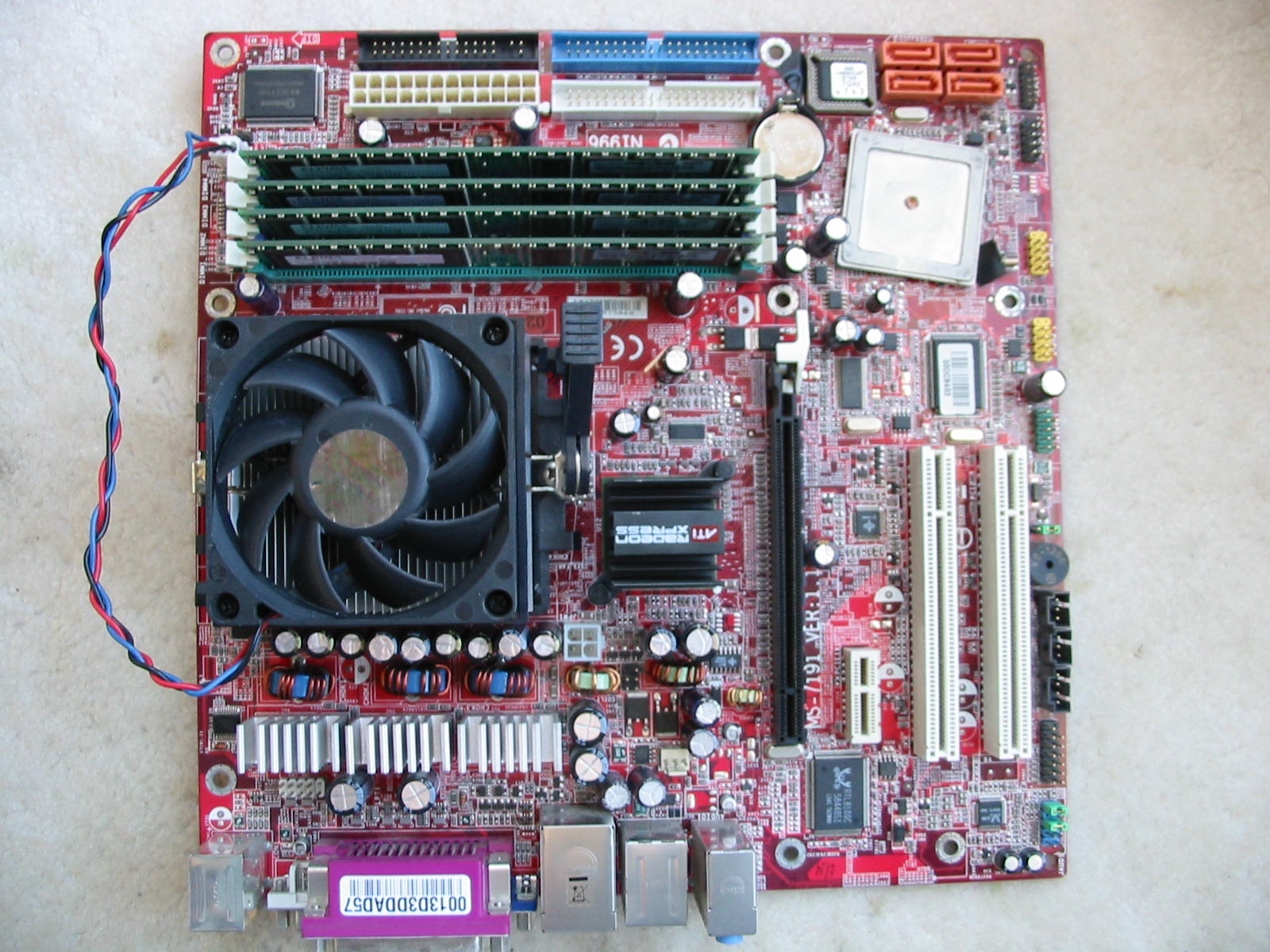

    Here is what it looked like when it came:
    Teapo caps on a motherboard? – Who thought that was a good idea?! Luckly, the CPU VRM output was all done with Panasonic FJ.

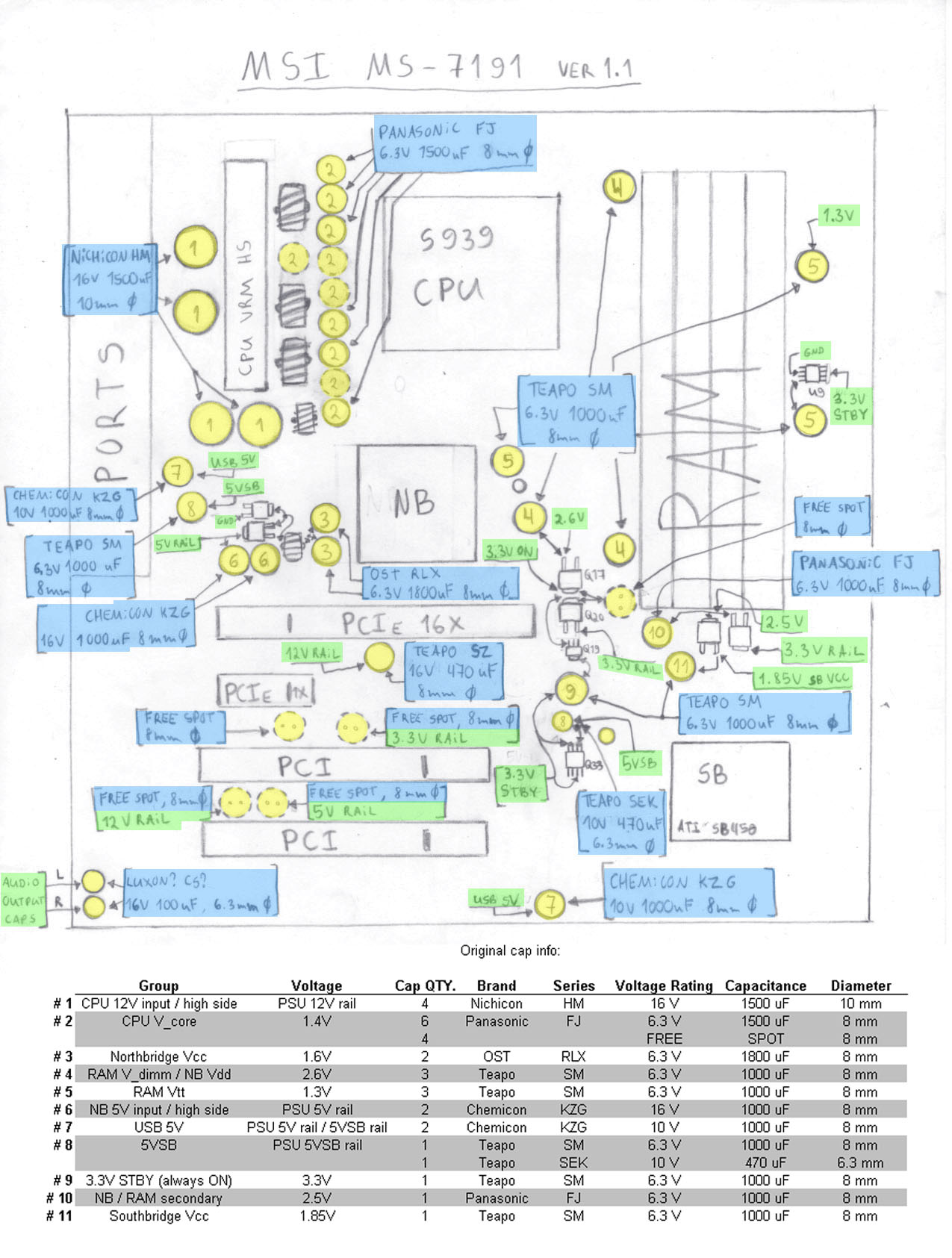

    As usual, I whipped out a cap map for the motherboard and got to cappin' them Teapos. So here is that:
    https://www.badcaps.net/forum/attach...1&d=1498861749
    The cap rails and quantity of caps on them can all be found in the above image. As such, I am only going to post the cap changes I made for each rail below.
    #1: CPU 12V VRM input
    No changes made here. Even though the caps were Nichicon HM with early 2005 date codes, I decided to leave them in and see how far they make it as I've seen many other HMs with early 2005 date codes still working. I don't actually remember if I pulled one of them to test on an ESR meter or not. But if I left them there, they were probably fine.
    #2: CPU V_core / VRM output / low side
    No changes to the original caps. However, there were 4 free 8 mm diameter spots. Three of those I filled with Rubycon MFZ, 6.3 V, 820 uF caps (from Xbox 360 motherboards).
    #3: Northbridge Vcc / VRM output / low side
    Another buck-regulated rail, so the original OST RLX caps had to go. Caps I used:
    1x Rubycon MFZ, 6.3 V, 820 uF, 8 mm Ø
    1x Rubycon MFZ, 6.3 V, 2700 uF, 10 mm Ø
    This made the total capacitance slightly lower than with the OST RLX caps. But the overall ESR should more than make up for it (22 mOhm for each OST RLX vs. 7 mOhm for the MFZ).
    #4: RAM V_dimm / NB Vcc
    I am actually not sure if this rail is for the RAM DIMMs or the Northbrdige (or both), as there is another 2.5V rail on the board. But with three caps on it, I imagine it is both important and provides a moderate amount of current. So it probably is for the RAM DIMMs at the very least. I used:
    2x Rubycon MBZ, 6.3 V, 1800 uF, 8 mm Ø
    Perhaps a bit overkill for a linearly-regulated rail (both in terms of total capacitance and ESR), but that may have something to do with the caps I had in stock at the time.
    #5: RAM Vtt (termination voltage)
    Another linear rail, generated by U9 on the board. For that one, I used a different mix:
    1x Rubycon MBZ, 6.3 V, 1800 uF, 8 mm Ø
    1x Panasonic FJS, 6.3 V, 820 uF, 8 mm Ø
    1x Nichicon HM, 6.3 V, 1000 uF, 8 mm Ø
    More overkill…
    #6: Northbridge 5V VRM input / high side
    Changed only one of the KZG caps on this rail with:
    In retrospect, I think I should have used another of the Rubycon MBZ caps from #5 above on this rail to replace the other KZG. Perhaps that will be work for some rainy day.
    #7: USB 5V filter for the front and rear USB ports
    No change. The two original Chemicon KZG 10 V, 1000 uF caps were left as is.
    #8: 5VSB rail filter
    Only changed the Teapo SM cap with the leftover Chemicon KZG from #6 above. Yes, I know this is not exactly a good replacement, but I have more faith in 16V KZG caps than I do in 8 mm diameter Teapo SC and SM series. And this is not a high-stress rail.
    #9: 3.3V STBY
    This is another linear rail. It is always ON and generated from the PSU's 5VSB. Replaced its lone Teapo SM 1000 uF cap with a Nichicon HM 1000 uF cap. If I had more entry-level low-ESR caps like Chemicon KY, I would have used them just about everywhere for these linear rails. There is absolutely no need for the ultra-low ESR caps I used above.
    #10: Northbridge and/or RAM V_dimm secondary 2.5V rail
    No changes. It came with a Panasonic FJ cap from the factory. I guess this must also be a very important rail if MSI thought about using a Panasonic cap here. I've seen this motherboard on eBay a few times now, and it seems that this spot is always populated with a good Japanese cap.
    #11: Southbridge Vcc
    Another linear rail. Out with the Teapo SM 1000 uF can and in with a Rubycon MBZ 1800 uF cap.
    That is all. I did not fill the empty cap spots near the PCI/PCI-E slots. I thought about re-using some of the Teapo SM that weren't bulged, but then decided against that, knowing how Teapo SM is likely to bulge and leak.

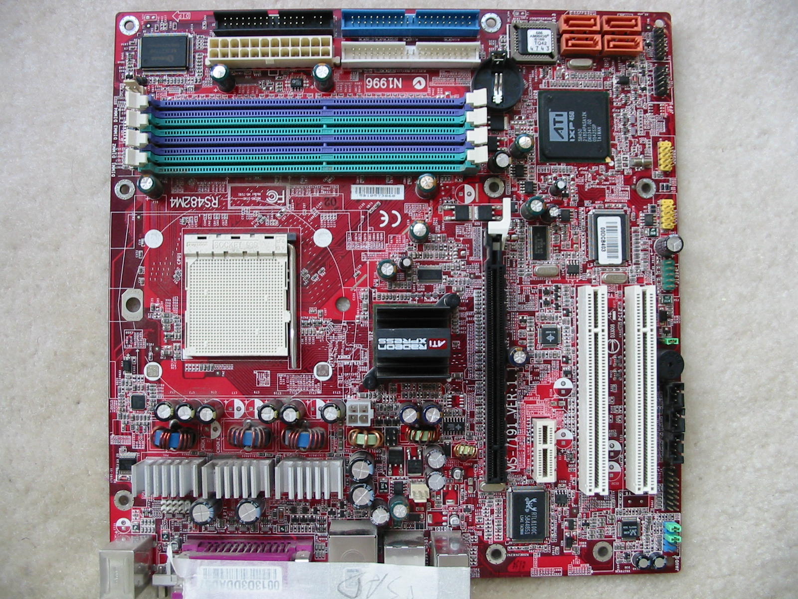

    Pictures of the board after the recap (sorry for the low quality):

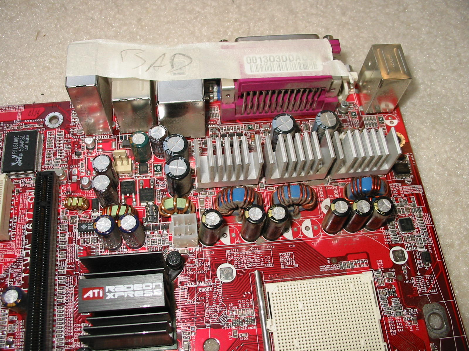

    And a beautiful red PCB finish:
    As far as stability: I have had ZERO issues with this motherboard since the recap. It has been in use in my secondary PC (which I also use mostly for playing old games) since May of 2013. So it has seen a little over 4 years of use now.
    It came with an Athlon 64 3000+ CPU and a stock heatsink. I upgraded the CPU to a 3500+ sometime in late 2015 or early 2016 or so. And finally this last February or March (2017), I upgraded the CPU again to an FX-57 (the fastest socket 939 single core CPU ). For those of you who remember, it is actually this one from the ghetto mod thread. What a beast!
    This is also the motherboard that also opened the eBay “flood gates” for me, so to speak. Ever since I got it, I've been buying crap off of eBay with bad caps and recapping it just for fun (as some of may have noticed with all of the Sacon FZ video cards I have posted here). On that note, I have probably spent more money on these parts than I would if I had built a brand new PC with mid/high-end components. However, I don't think a new PC would have been as much fun as fixing these old motherboards and video cards. Although some of them were simple recaps, I have still learned a great deal about repairs with just about every motherboard and video card I did. So overall, I think it was well worth it.
