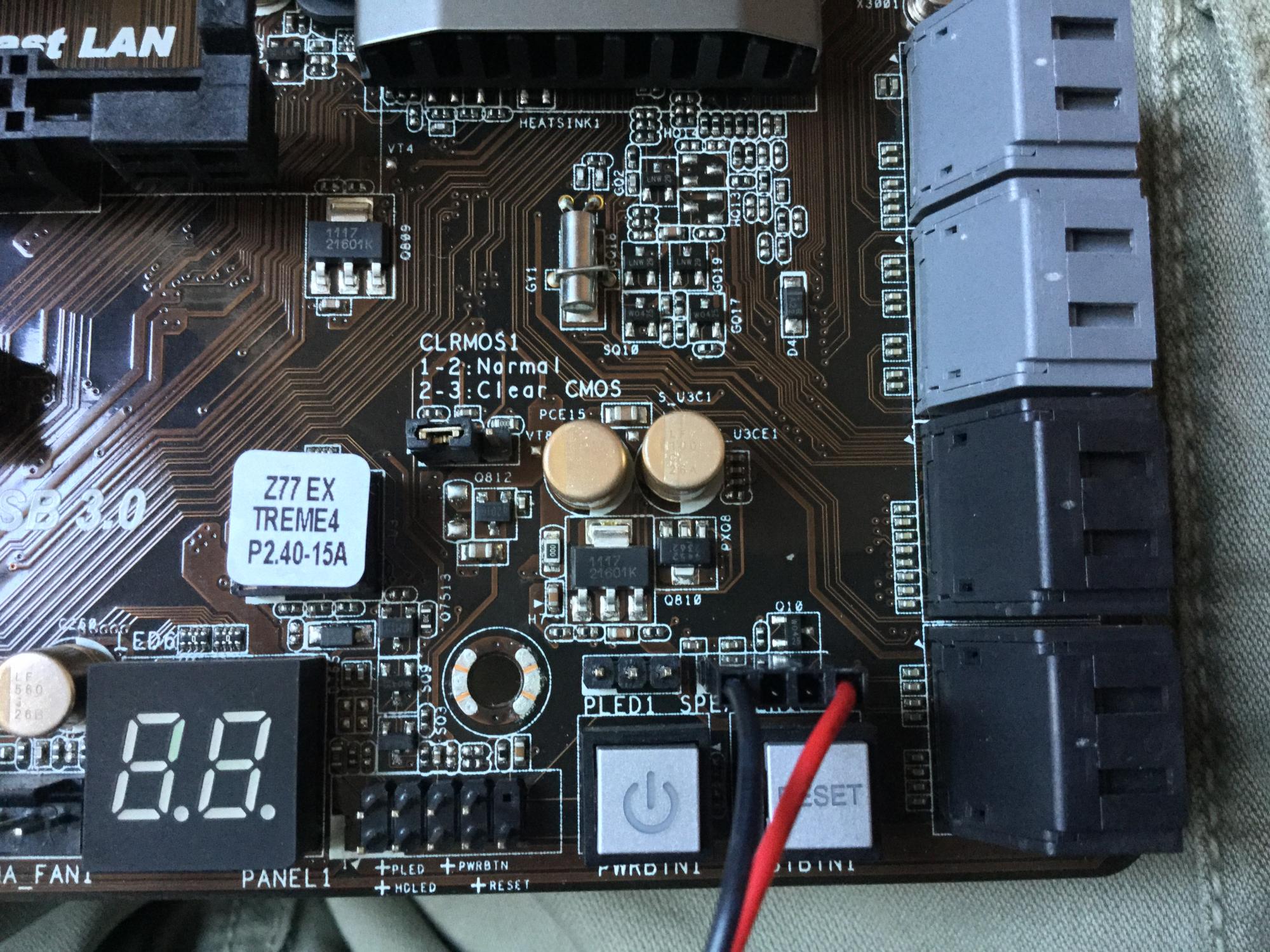

    Hi all...
    After attempting (with no success) to repair a Maximus IV Extreme, I am now trying to fix an apparently broken Asrock z77 Extreme4.
    The board seems really perfect, nothing to report.
    Except that it is dead.
    No beeps, no lights, no fan. Only thing it's on is the led on keyboard.
    After a full inspection I found that a gold cap near the internal power button gets extremely hot when I power on the PSU.
    Maybe the problem is the cap? Se the attachment.
    It says "LF 560 j 25C" on it.
    I don't see damages on it. It only gets hot (it hurts to touch in few seconds).

    could be. when polymer caps fail, their leakage current increases until they become like a resistor instead of a capacitor. try replacing it. tho poly caps dont fail without a good reason. most likely a junk psu with too high voltage spikes on the 5vsb is the culprit.

        sure the 1117 reg isnt the heat producer?

          The only thing I know is that the bigger gold cap is hot as hell, just plugging the power cord (the system won' t turn on anyway, no fan, no beeps, nothing).
          It is possible that the 1117 thing is also hot, I should verify, but I cannot see damages on it.
          But what does that means? What should I change?

            I verified the 1117 and it is hot indeed.
            I cannot tell if the heat it produces spreads to the caps OR they spread heat as well themselves.
            Anyway, should I change the 1117 as well?
            As far as I can tell, it is an adjustable regulator because I don't see any suffix after the number 1117. Am I right?
            Should I change (or look for)anything else?
            I need the more info I can get before I go to the technician (he doesn't care...).
            Thank you !!

              The 1117 is a linear regulator, and it's most likely adjustable as you can see the resistors required to set the output voltage below the chip.
              As for being hot ... it could be hot for several reasons.. it could be faulty, or something could pull so much current that the regulator is in short circuit protection or over temperature protection all the time.
              Check the input and output voltage of the 1117 regulator with a multimeter and see what's going on there.

                I just tested (I think...) the voltage regulator, following the guide on this forum.
                I used as ground, a space for motherboard screw (plated).
                Here the data:
                First line: 1117
                Second: 21601k
                1) 1,42
                2) 2,23
                3) 4,88
                Now, from the guide the second reading value should be the first plus 1.25v
                It is not, so the regulator is bad and should be changed. Right?
                What you suggest me to test?

                  I'm guessing that items 1) 2) and 3) above are the voltages at pins 1, 2 (or tab), and 3 of the 1117 IC. If that is the case, then you need to look only at the voltage on pin 2 (or the metal tab), which is the output, and pin 3, which is the input.
                  So with the above voltages, looks like the regulator is taking in about 4.88 Volts (roughly 5V, that is), and outputting 2.23 Volts (probably should be close to 2.5 Volts).
                  To get a bit more information, next you should try measuring the resistance between ground and the output (tab) of that 1117 regulator. You do this with the motherboard powered OFF and disconnected from the power supply. Basically, set your multimeter to the lowest resistance scale (if it's a manual multimeter) and put the black probe on a ground. Then put the red probe on the output of the regulator (the tab). See what resistance you get and post it here. This might give us a bit more insight if something is shorted or partially shorted.

                    1) 2) and 3) are the little pin on the 1117, from left to right.
                    I followed entirely the guide on this forum on measuring voltages on 1117.
                    I have a cheap digital multimeter, I hope it will be enough.
                    Putting the black probe on a ground washer space (or on the I/O connection metal case) and the red probe on pin 2 or the fat tab, I obtain nothing but "1".
                    The same for another 1117 on the motherboard.
                    Maybe I am not using a proper "ground" point??
                    If I put the black probe on pin 1 and the red on pin 2 I obtain a stable value of 178 ohm.
                    Don't know what it means...
