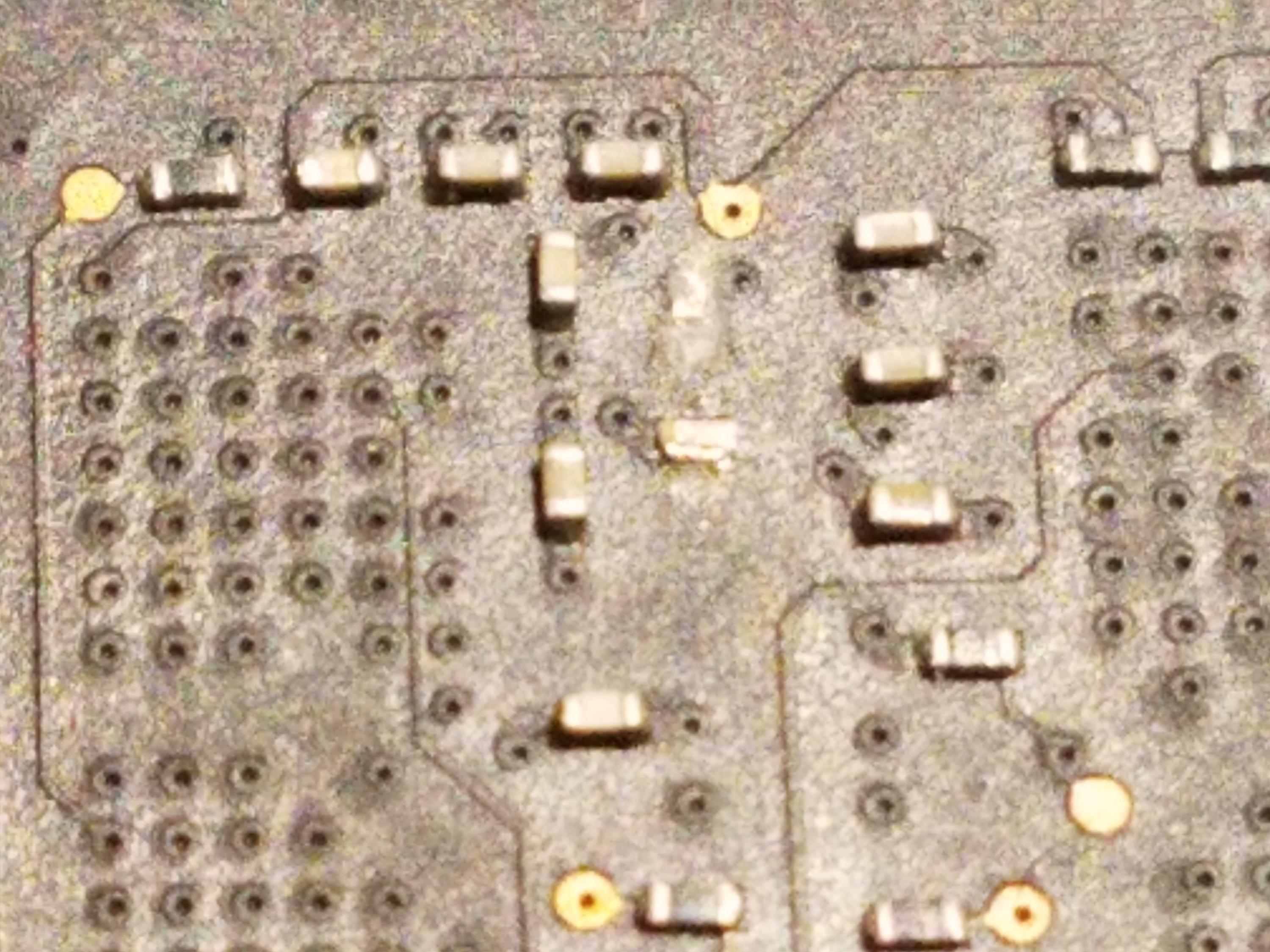

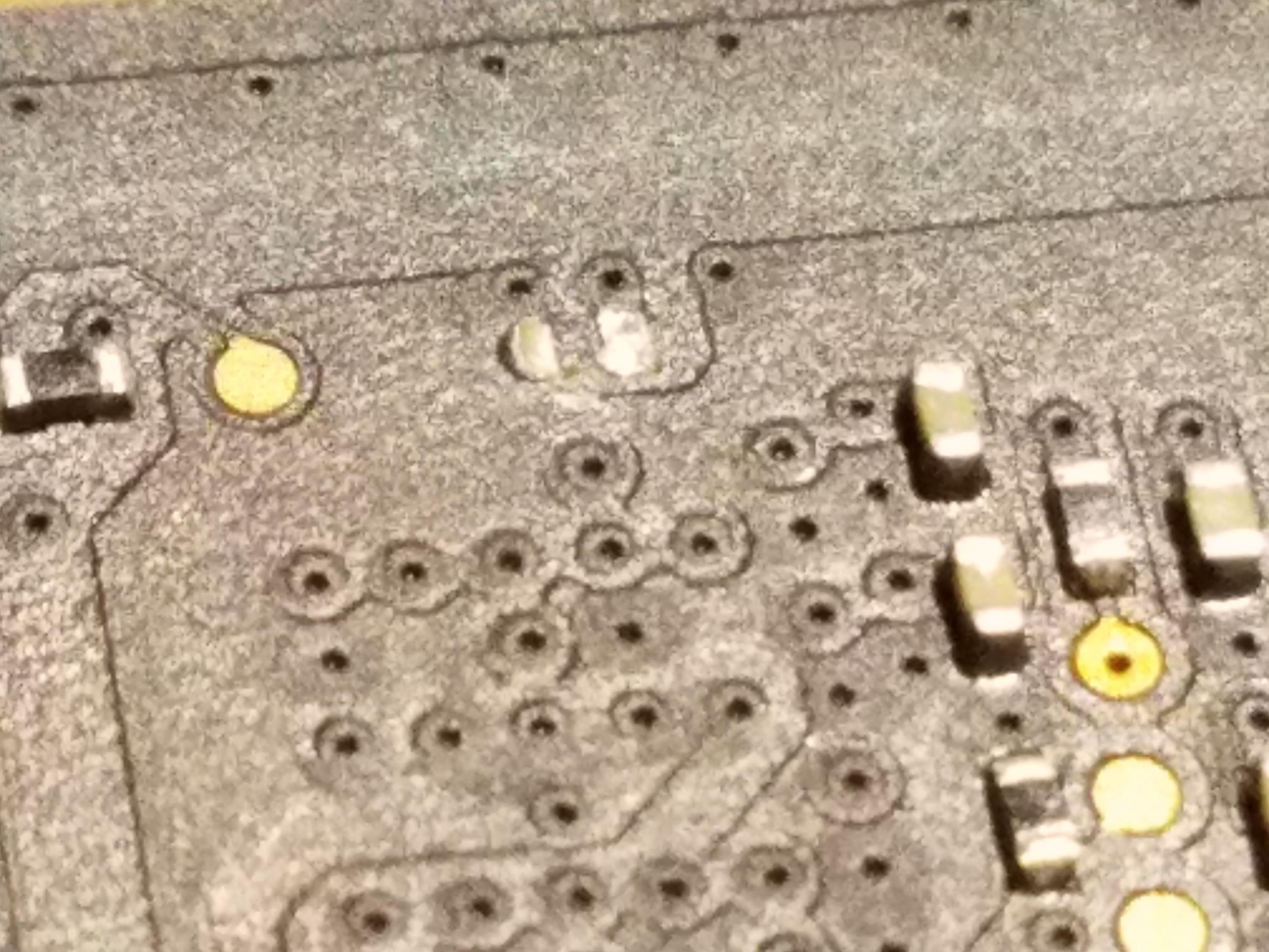

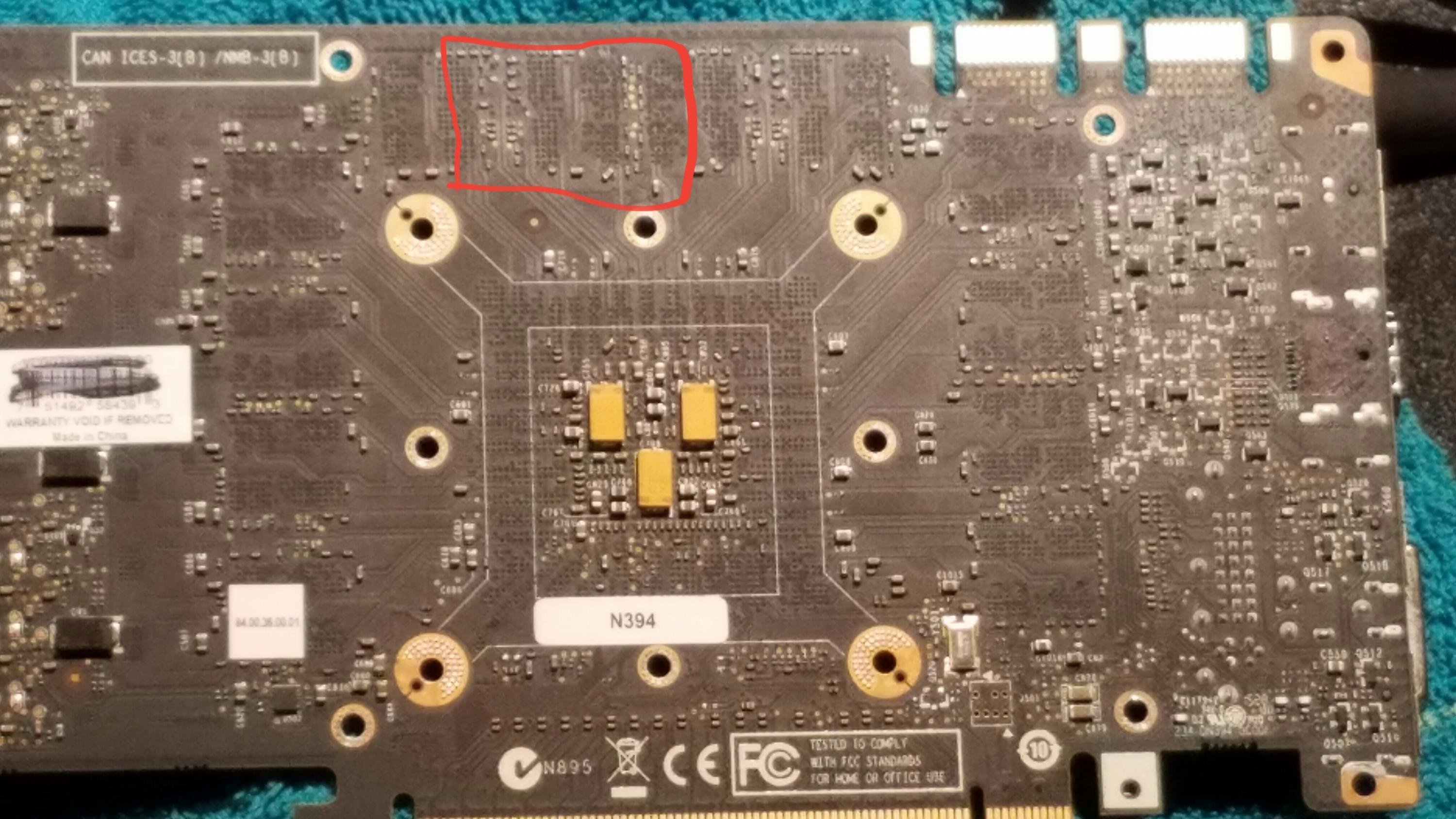

    GTX 980 ti missing 2 caps...
    Well I bought this card on Craigslist and I guess I should have looked at it a little closer like with a magnifying glass LOL. Anyways thinking it was good to go in installed it in my PC only to find I had no video output (fan and lights work fine). After messing about with bios and drivers for 20 minutes and not getting my PC to acknowledge the card in any way I decided I better pull it and give it a good once over and to my dismay I found 2 small components (I believe they are capacitors) have been ripped off the the pcb! They are located directly behind the ram specifically module 7 & 8 I will include some photos so you can see what I'm talking about I was hoping someone could tell me what components I should order to replace them. Also from the reading I have done it sounds like if they are just capacitors they should not be preventing the card from operating do you think I have underlying issues? The photo with the DMM lead is for size reference. Based on the visual appearance of the circuit I found another component on the board that should be the same and took it out of circuit to get a reading I set my digital multi-meter 20m ohms and got a reading starting around 1.0 and slowly climbing to infinity so it's a cap I assume right?

      Re: GTX 980 ti missing 2 caps...
      They're decoupling caps for the GDDR5 memory chips. The layout should be the same for each gddr5 chip (you should have pretty much the same position 8 times on the board)
      Try to match the capacitor with the same capacitor for other memory chips. Then desolder one of those capacitors and measure the capacitance. Should be something like 0.01uF, 0.047uF, 0.1uF, at most 1uF .. and probably a voltage rating of 10, 16, 25v .. the voltages on the gddr5 chips are 1.2... 1.4v so a 10v+ rating is more than enough.
      These missing capacitors shouldn't cause so much instability or problems that you wouldn't see anything on the screen. Maybe some components are missing in other locations as well?
            Yes, in many cases, those ceramic capacitors (especially near/around/under the RAM and GPU) are not critical to the operation of the GPU. That said, some of them are if they are near the PCI-E slot (the PCI-E lane coupling capacitors) and any ceramic caps around the PWM controller and PWM MOSFET drivers - those can certainly make the video card not work.
            Because there were multiple broken caps on your video card, I would say inspect the video card again. Maybe even two more times, because there may be other components missing. If you find any missing components, look for high-resolution pictures on the internet to help you determine what the components are. Typically, if it's a square component with two leads only:
            tan color = MLCC (ceramic capacitor)
            black = resistor (sometimes with value printed on top, and many times not)
            gray or white or dark gray (graphite) color = inductor or ferrite bead
            In my opinion, I think the video card may have other, underlying issues as you suggested - most likely bad BGA under the GPU (fixable with a reflow or reball) or bad BGA between chip and GPU substrate (non-fixable).
