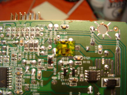

    Hello to everyone ,got a small problem here . I seem to not be able to Identify this little SMD that self destructed on this inverter circuit. I spent alot of time surfing the net for the meaning of letter L in electronics and what it's purpose was when it was still alive.
    It is now smokeless because it all leaked out. I resembles an SMD Capacitor but there is no numbers on it, it has a twin brother on the other side of the board. What does the letter L mean other than a land . Is it a component or just a jumper? I am curiosly waiting for someone to help me, It is driving me nutzer. It is above the black line and highlighted nothing in the way of markings on it or even the other on just like it.

    A surface mount inductor like this.
    http://www.koaspeer.com/inductors.asp?part=4
    If you have junk boards it's not hard to scarf one from something else.
    Old cell phones etc.

      L is a coil.
      coils burn when too much current passes thru it, so prior to replacing it you should establish what caused it....

        Thanks ,I watched this thing turn to charcoal just as I put the power to it. It is for a HP monitor that the one backlight was staying on even when the power switch is off. The one side of backlights that stayed on got reeealy bright right before it's demise.
        The one mosfet is shorted out causing the light to stay on ,I was in the process of troubleshooting it and the smoke came out.Did not know what the L meant,I thought it was a SMD capacitor at first

          You better believe I will scarf one up I got alot of old junk laying around ,Jim. It apparently has no values to it I guess because it is not identifiable in any way other than color or size.
          Does this mean any one I "scarf " will work ? I also think something went crazy right before it happened I recapped the board and put 4 new C5707's transistors on it.It worked beautiful ,but the top ccfl's wouldn't shut off. I found the bad AO4411 mosfet Scarfed one out of an old monitor It worked till this mishap. I couldn't find these mosfets unless I would buy almost 2000 at 1.38 each. Nope.

            I could use some input on how to tell what inductor I need. Is there a way to identify them.Then I would know what to purchase ,scarf ,steal or even borrow from another source.Come on Jim, you know ,don't you?

              Color and size are your only clues. If you searched long enough you would eventually find the schematic..
              I didn't respond becuase I was thinking you were sick of that unit by now.
              I'm guessing to say it handles a few hundred milliamps at 1.5uH.
              If it burned and measures open you'll be looking for the cause.

                  could it be that backlight is faulty and consuming too much power?
                  can you hook some other backlight to test it?
                  other than that you said it has 2 baclights and one is ok: that means you have a working circuit you can compare against a faulty one.
                  although i dunno is it possible to unhook the flawed one while measuring the good one, and then just hook it uop when you wanna test it, briefly.

                      The monitor that fried the inductor the other day (I have yet to get a replacement one) ,I had it connected up to the spare set of lamps because I wanted to test it before I completely assembled it. They are a known good set of ccfls . The one set got real bright then the smoke came out of the inductor and out go the lights. OK got to go.
