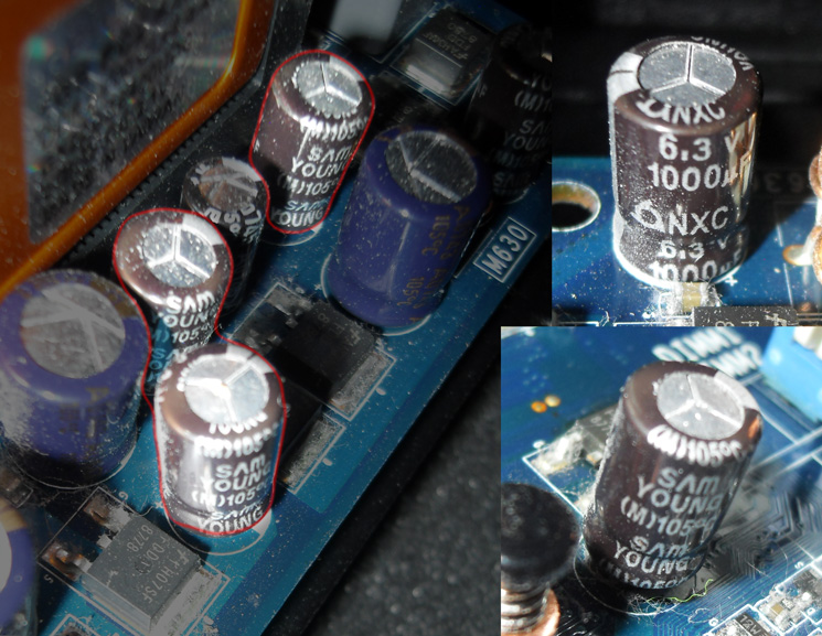

    I have a (relatively old) Abit IP35 board with a Q9650 and 8GB RAM that I was hoping could do some service for years to come still.
    Everything is working fine at the moment, but when inspecting the board I can see quite a few caps that show every sign of going or being bad. There's only one type/size that show any visual degradation, but it's used loads of places on the board. Many have bulged tops, and 2-3 have dropped electrolyte in the bottom.
    They seem to be 1000uF and 6,3V, and the make is Sam Young(?) from what I can read.
    There will be quite a lot of soldiering to replace all of them, I haven't counted them yet but it's somewhere around 20. Is this one of the terrible ones so that all should be replaced, or should I take a chance and only change those with visual deformations?
    The cost isn't the issue, I'm more worried about the time it will take me. My "tin suction thing" is some cheap chinese thing that really doesn't do the job very well and spend more time jamming than sucking. I haven't been able to find a decent one locally, and it's hard to judge their quality by a photo on a web shop. If any of you have a tip for a good one, I guess replacing all would go pretty quick.
    Also, looking in the master list here on badcaps.net I can only find one that seems to match (article number 131):
    1000uF 6.3v Nichicon HM 8mm 13mm
    This cap seems to be unavailable. I'm measuring the existing ones to be about 8,3mm in diameter and 13-14mm high. I don't think the 10mm diameter ones will fit, as some of these are in some tight spots.
    Any and all suggestions/feedback are appreciated.

    Just replace all 20. Don't replace only the failed ones because if you only replace the specific ones you pictured,others will follow the same fate soon. Better replace them from one run and be happy with it.

              You *don't* need a solder sucker / solder vacuum pump for this. In fact, it is usually very hard to use one on a motherboard and actually have it work.
              The way I normally remove caps is with this method:
              https://www.badcaps.net/forum/showpo...7&postcount=23
              Then I use a sewing needle or cork board tac/pin to push solder out of the holes on the board. To do that, I simply heat each hole with my soldering iron and use the pin/needle/tac to push the solder out from the other side of the board. Of course to do this, it is best to have the motherboard propped sideways so that you have easy access to both the solder and the component side.
              Also, most of the time I don't even clear the holes all the way. Instead, to make the installation of the new caps easier, I pre-cut their leads to proper length so that I can then use the above same method to put the new caps back on the motherboard.
              I hope this helps.
              And yes, definitely replace all of the Sam Young capacitors. In fact, not just those, but anything that is not Japanese-made. That is, the only caps you should see on your motherboard should be Rubycon, Nichicon, Panasonic, Sanyo, Fujitsu, and United Chemicon (but beware of KZG and KZJ series, as those are failure-prone as well). Oh and Samxon GC and GD series are okay too (they are not Japanese, though ).

                Thanks momaka. I agree that I don't need a sucker for most of them, but some are in tight spots where I'm not sure that there's room to "bend" the caps. I'll manage anyway, the caps only have two leads so I can always go back and forth moving it a little bit on the tight ones - most should be easy enough.
                I didn't really think (?) when I asked about the desoldering, it's a general issue I've come across when desoldering and that I find troublesome (on 3+ leads/legs close together). I'm a bit afraid that I'll make some stupid mistake and ruin the motherboard (it's still working, if it was dead I would have nothing to loose), so I just thought that having some proper way to remove the tin would reduce the chance of any trouble. Working LGA775 boards aren't that easy to source anymore (at least not here in Norway).
                I've used a needle to clean the holes myself, I just didn't think it was that "simple" and figured it was some smart trick I hadn't heard of
                It seems the 1000uF's are the only Sam Youngs on the board, all the others look completely different and have no sight of bulging/leaking. Most of the others are physically smaller as well, and I have a hard time to read their values without desoldering many of them first, so I think I'll stick with replacing all the 1000uF's for now. This site doesn't seem to sell 8mm 1000uF's anymore, but I've found a local source for some 8mm Panasonics so I guess I'll go for those.

                  I haven't found a motherboard where I can't bend the caps. At the worst, there may be other caps around the cap you are trying to remove. When that happens, I sometimes remove the caps that get in the way. It's only a bit more work.
                  Well, just so you know... bad caps can ruin the motherboard and render it unrepairable sometimes. In particular, beware if you see bad caps around any inductors and coils. Buck regulator circuits don't take it too well when their output caps go bad and the energy stored in the inductor has no place to go (it actually does have a place to go - through whatever IC it is powering.... whether that IC needs it or not).
                  So don't be too afraid to change the caps - at least the bad ones anyways.

                  That's fine. The small caps are usually not that important. Worst case, you might get a non-booting motherboard if an important small cap (if there is one) goes really bad. But no way you will get a burned coil or shorted chip from that.
                  Well, there are these, but the height (16 mm) might be an issue for you near the PCI/PCI-E slots (in particular if you have a video card with a heatsink positioned close to the slots):
                  https://www.badcaps.net/store/produc...products_id=46
                  If for any reason you can't find suitable caps, then just know that 820 uF caps will more than likely work fine too. I looked at a picture of the Abit IP35-E, and it seems that most of these 1000 uF caps are used as general filters and only a few of them are critical (hence why your motherboard still works). But if you use good low ESR caps, the reduction in capacitance won't really affect anything.
