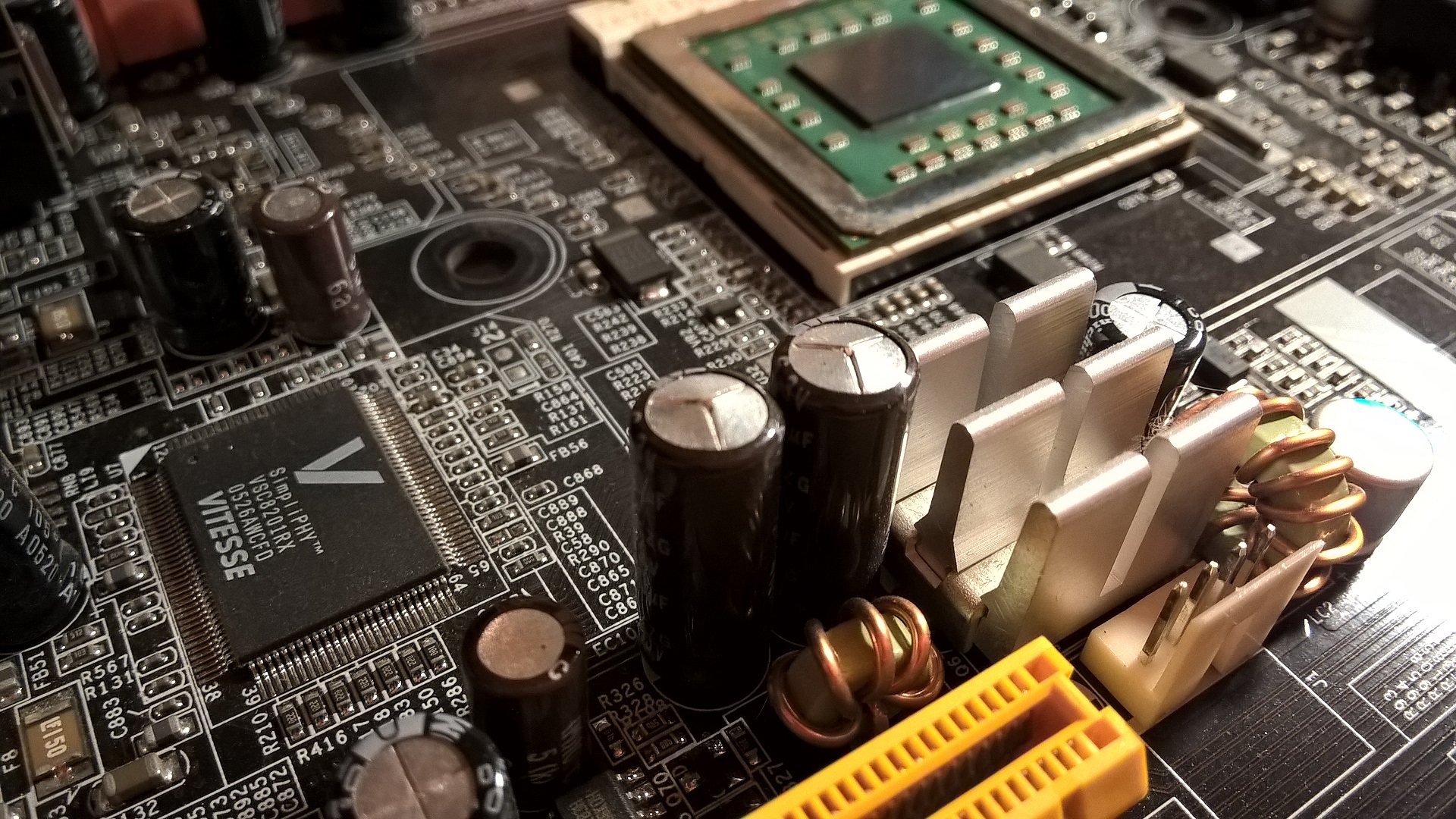

    I have this motherboard that won't post and I have decided to try and fix it. The last time I saw it working must have been Oct/Nov 2014 and when the PC didn't turn on any longer I just blamed it on the PSU because I didn't really care to investigate why it wasn't working.

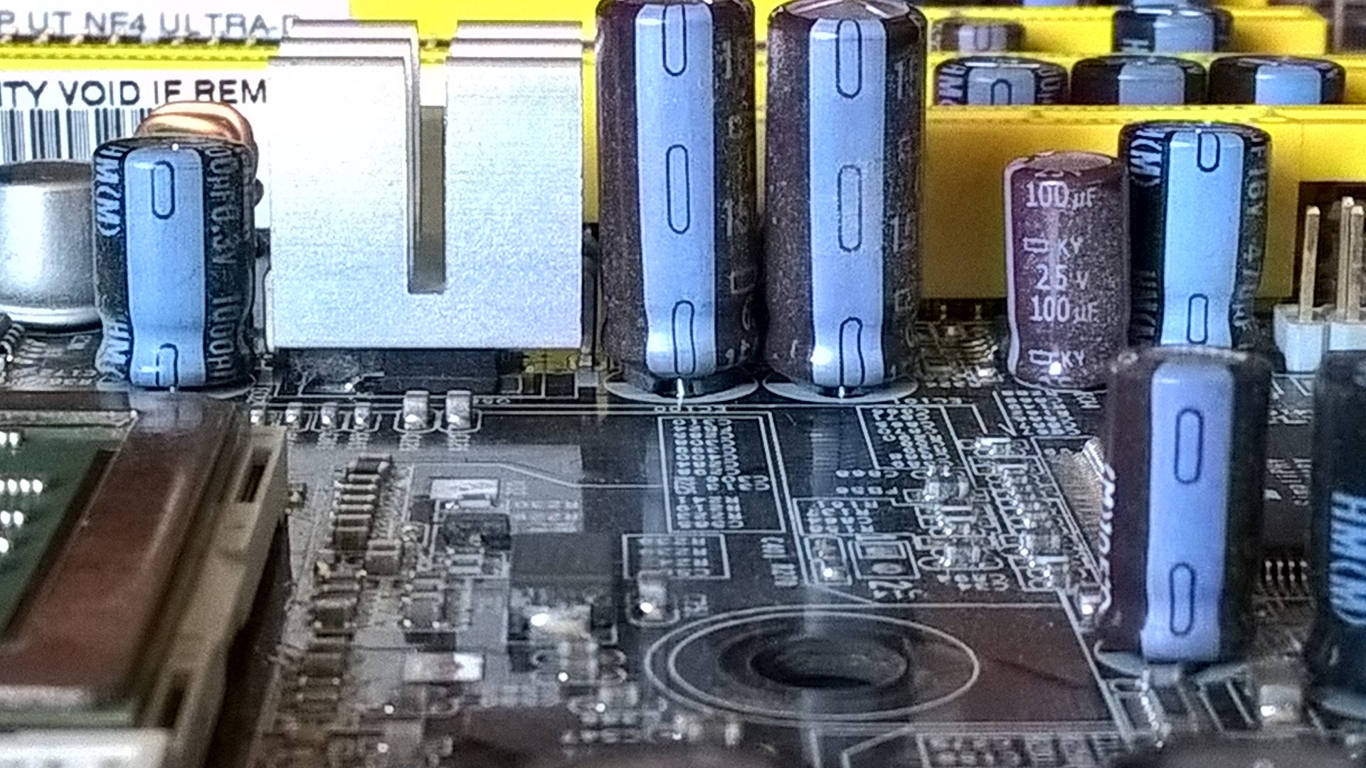

    Last week I finally did decide to investigate what was wrong and I noticed two bulging caps near an auxiliary power connector, they are KGZ 1500uF 6.3V which I understand are bad. One has the bung popping out also but apparently it didn't leak on the PCB.
    I thought I may as well replace ALL the capacitors while I'm at it in order to avoid future failures but I don't know if it's really necessary so I need a few directions.
    Let's get to it.

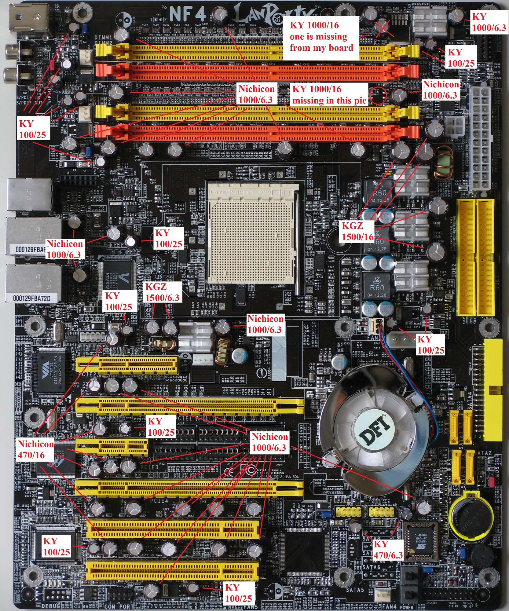

    On the board there are 61 electrolytic caps and 8 polymer caps (these are all 560uf 2.5V, brand unknown, A 54J if it rings any bells).
    I'm attaching a few pictures for your viewing pleasure. In one I indicated the values of all the lytics, the original picture (here) is from the Techpowerup review of the board (check it here if you want to see close-up shots of the board) although the PCB revision is different. In the other two pictures you can see the two bad caps.
    The two bad KZG and the other five KZG caps near the ATX connector are going to go, but I would like to know what you guys think of the other caps on the board, if they need replacing or not. I can guess what a certain cap does but I can't really tell where the VRM or other sections begin or end so I need some guidance. And the polymer caps are staying, right?
    If you have any questions or need more info, just ask.

          HM and HN are good series of capacitors.
          However, there was a small time period around 2002-2004 if I remember correctly when the Nichicon factories used too much electrolytic (or some other substance) inside these series of capacitors which made them failed prematurely.
          Capacitors made after somewhere around April-May 2004 (again, if I remember correctly) from those two series are good.
          If they're failing or failed on motherboard, it's not due to technical faults but due to other reasons (for example whole pc overheating or power supply giving bad quality power to the motherboard.
          There's usually a datecode on the capacitors (4 digits), the first two are the manufacturing week and the other two are the year, that should tell you if you MUST replace the caps, or if you just SHOULD (if you want to replace with polymers)
          Also, HM and HN were discontinued recently by Nichicon but big stores like Digikey should still have some in stock. Nichicon recommends HW series as replacement for the two (and indeed it works well for most cases) but you can use polymers instead if you want.
          KZG series is just bad, it's one of the series that has lowest esr possible, and my guess is the electrolyte inside is of another formula compared to their other series, and this formula wasn't quite stable. They're known to fail even without usage, just by sitting on shelves or in boxes.

              I'm going to do a real capjob
              I'm planning to replace the KZG caps with polys and all the others with lytics. Going full poly would be too expensive.
              The supplier I chose to buy from (that would be RS) has a lot of stuff but many types of capacitors are sold only in packages of 10 or 25 and up and I don't need that many, so the selection was somewhat reduced. Anyway, these are the caps I have selected for now.
              KZG 1500uF 16V >>> Panasonic OS-CON 1000uF 16V 16SEPF1000M
              KGZ 1500uF 6.3V >>> Nichicon L8 FPCAP 1000uF 6.3V RL80J102MDN1KX
              Nichicon HM 1000uF 6.3V >>> Panasonic FM 1000uF 6.3V EEUFM0J102
              Nichicon HM 470uF 16V >>> NIC Components NSRG 470uF 16V NRSG471M16V10X12.5F
              KY 470uF 6.3V >>> Panasonic FC 470uF 6.3V EEUFC0J471
              KY 1000uF 16V >>> NIC Components NSRG 1000uF 16V NRSG102M16V10X20F
              KY 100uF 25V >>> Rubycon ZLG 100uF 25V 25ZLG100MEFCT16.3X11 (I fear these at 6.3mm diameter are too big, gotta check)
              Are they looking good?
