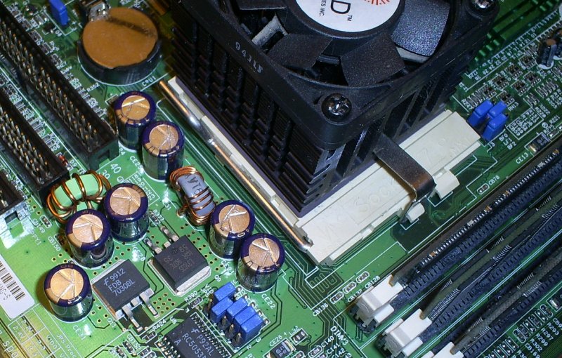

    The customer is going to buy a UPS. That will certainly put some isolation between flaky house wiring, bad breaker, garbage disposal startup, microwave, etc.
    I don't mind doing another board for them, it is just that I did such a *nice* job recapping the existing board. Yes, I can pull those new Rubycons and probably re-use them.

      i really doubt its the board if you can take it home for the weekend to pound with f@h
      if it passes its something in the office and you can swap mobo's till the case screws wear out and not fix it.

        I just finished the most useless recap so far: Compaq Presario 5000, with 1Ghz T-Bird, and VIA chipset. Yuck.
        Gotcha beat.
        I did this one about 2 weeks ago. Also a Compaq Presario board, but this one is Socket-7. SiS530 w/ K6-2 400MHz processor. Works perfectly, and the old caps were junk, and there were only 7 of them so I figured why not.

                  I threw in the towel and replaced the board. It continues to suddenly drop power at random moments. Not acceptable.
                  I plan on a holding pattern while the customer runs with the replacment board. The board installed works flawlessly in my environment. If this one fails for the client... ??
                  Eventually I will pull all the new Rubycons off this board, and give it a toss. I don't know how to bug shoot a dropping dead problem. It acts like the Power Good signal simply goes away. Instant off.
