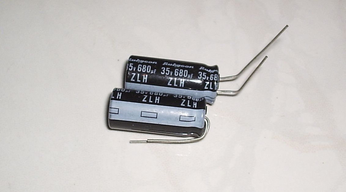

                            • yanz
                              • Nov 2004
                              • 910
                              Re: Silly Recap on Compaq
                              Originally posted by bgavin
                              I billed him $75 for an hour's time, and $1.50 each for the 21 caps.
                              I noticed how much more expensive MCZ caps are now at Wai Fong... I have to buy in 200 pc bags to get a decent price, but they are still expensive. Factor in the FedEx charges, and I should probably raise the cap unit price. The bummer is, Wai Fong is out of stock on several values that I need, such as 16v / 1500uF. They don't stock any of the ZLH I want.
                              The machine is certainly not a 747 in the performance department, but it works well for them. The point above about software tied to the hardware hash is a very good one. I don't have that issue on this machine, but it is still good thinking.
                              Off topic: The only ZLH i can get here are 680uf 35v (10mm) ones, for $1/10 pcs. Those shops kinda ignored my demand: 1500uf/16v or 2200uf/6.3v 1 in 10mm dia.
                              Well those ZLH aren't bad for PSu recapping and mobo recapping (<1000uf)..
                              days are so short when you actually do something..
