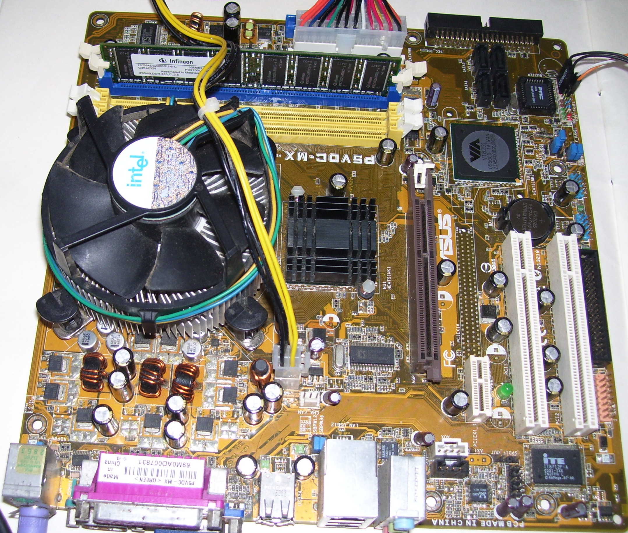

    Hi y'all,
    Good PSU/voltages
    CPU fan spins continuously - but no POST/Beeps
    Tried several good RAM in all slots
    Power LED on "system panel connector" does not light up - get 1.4V across terminals
    Green SB light is activated on Mobo
    Shuts down when holding in power button
    12V present on input caps, but no voltage on CPU caps (2 X 6.3v lytics and 5 X 4v smaller metallic "FL" caps)
    Removed CMOS battery and replaced.
    Also tried starting with no CMOS battery - But no change in situation
    If the CPU is faulty, does that mean that the VRM controller may not be activated?

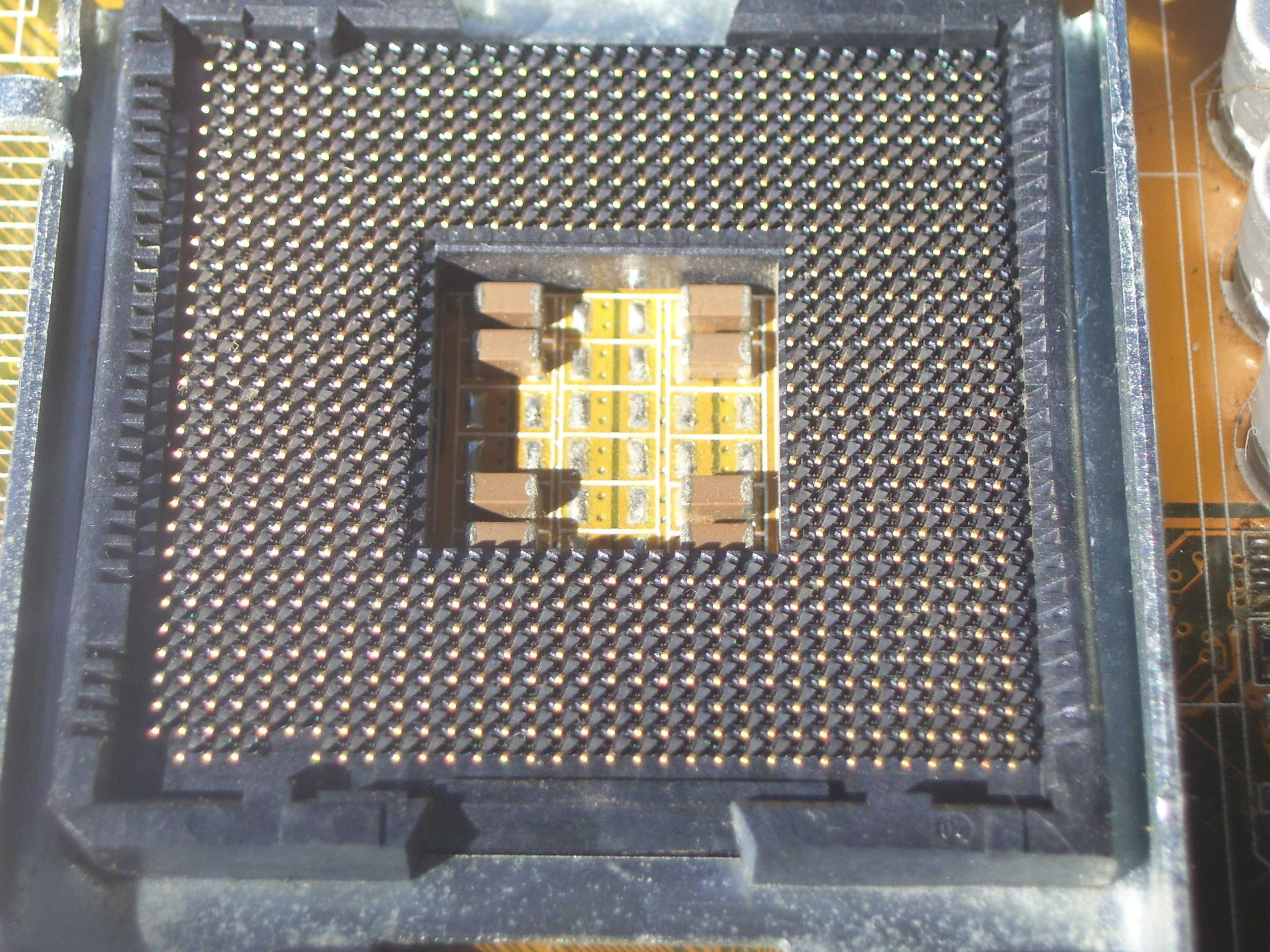

    Socket pins are the first thing to suspect on socket 775. Especially when it still powers up.
    If it powers up, then it's possible that it's just bent or a broken socket pin that's not shorting.
    (Only if the socket is fine, could RAM slots then be a possibility.)
    IOW, it's usually socket pins followed by RAM slots.
    Only if socket pins look fine would I then check the VRM circuit...
    But, I see that the motherboard in the photo has the heatsink on, thus the CPU got to be in there, too, so that makes the likelihood of a bad socket pin lower...
    It honestly looks like a bad socket pin, VRM problem or a broken trace to the CPU.

          All of the pins look good
          Replaced with known good CPU, but still no change

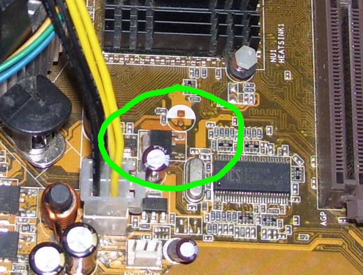

          The backside of board (that you circled green), and the the cap on the opposite side of the heatsink, shows no signs of heat damage.
          No, the VIA chip, or the north bridge HS, does not get hot

            what is the 3pin thing that got hot?
            maybe it's now dead.

                3pin package in the circle, the heat that darkened the board came from it's legs!
                • socketa
                  Asbelowsoabove
                  • Jun 2014
                  • 662
                  • samsara
                  Re: ASUS ASUS P5VDC-MX Dead CPU?
                  That's a vacant capacitor location.
                  Looking at the reverse side of the board, it doesn't look like there was any cap there to start of with - looks factory soldered
                  I did an image search for this board, and all the photos that i looked at showed the position to be unoccupied.
                    • 31214
                    not the missing cap, the fet/regulator just below it.
                    • socketa
                      Asbelowsoabove
                      • Jun 2014
                      • 662
                      • samsara
                      Is that what happens when a mosfet fails - it seriously overheats?
                      Is the sink leg (as opposed to the gate) the one that would heat up like that, as there is no evidence of overheating anywhere else around the mosfet
                      And what would you do next?

                        Here is the voltages across all the mosfet legs when it is turned on
                        I've labelled all the mosfets A to O on the photo
                        Letter Gate Drain Source
                        A 0 0 0
                        B 0 0 0
                        C 0 12.4 0
                        D 0 12.4 0
                        E 0 12.4 0
                        F 0 0 0
                        G 0 0 0
                        H 2.75 3.37 2.75
                        I 2.1 3.4 5.2
                        J 2.17 3.43 5.0
                        K 3.08 2.46 1.63
                        L 3.9 3.38 2.46
                        M 12.4 5.2 5.2
                        N 5.7 2.6 0
                        O (hidden behind RAM) 7.99 5.2 2.7
                            The mosfet in the green circle is: Advanced Power Electronics Corp AP9T15GH
                            I get multimeter readings of:
                            1.53V G-S
                            2.12V D-S
                                Looks like either CPU is not being detected by the board or the board gets stuck before even POST begins. Or perhaps CPU VRM controller is dead or not getting a signal from the board to start running the CPU (but that would be a very rare case).
                                Try this: remove the RAM and see if the board beeps at you (usually two beeps).
                                Also, see how much resistance you get between Drain and Source on MOSFET H. Make sure to keep the multimeter on it for at least a few seconds (if there are any caps, they may need a moment to charge, and then your readings will settle more)
                                And just for your information:
                                C, D, and E are upper MOSFETs of CPU VRM
                                A, B, F, and G are lower MOSFETs of CPU VRM
                                MOSFET M is a pass-through MOSFET (when the PC is on), likely for RAM VRM supply
                                N is lower MOSFET of VRM for RAM Vdd (2.5 Volts for DDR, 1.8 Volts for DDR2)
                                O is upper MOSFET of VRM for RAM Vdd (2.5 Volts for DDR, 1.8 Volts for DDR2)
                                MOSFET L is likely for Northbridge<->RAM communication (2.5 V for DDR and 1.8V for DDR2... I think)
                                MOSFET K is either 1.5 Volts for the AGP connector or RAM Vtt and NB<->RAM communication (normally, that's should be about 1.3V, though, so probably AGP)
                                MOSFET J converts 5 VSB power into 3.3 V standby-power for the SouthBridge
                                MOSFET H... I have no clue! 2.75 Volts seems a bit too high for Northbridge Vcc (which tends to be 1.6 Volts or less for boards from that era). Yet, it is very close to the NB, which suggests NB Vcc supply. Or
                                The SOT-223 component labeled "I" on your diagram is perhaps for the clock generator - that "ICS" chip with crystal next to it. And possibly for the RealTec audio and LAN chips.
                                So overall, most of the voltages seem fine, except for CPU VRM, which is just not there.
                                I have an ASUS A8V-MX, which is the socket 939-equivalent of your board... more or less. At least it appears to have the same Via NB/SB combo and same AGP and PCI-1x slots. I'll try to pull it later this week and see if I get similar voltages to yours.
