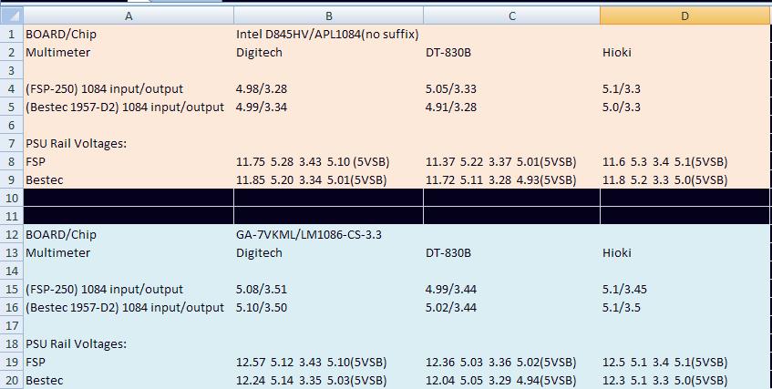

                              Re: ASUS ASUS P5VDC-MX Dead CPU?
                              No, haven't checked that out yet.
                              Just found another, budget, multimeter
                              This one displays 5.59V for the 78L05 regulator output after putting the new battery in it
                              The Hioki display reads spot on 6V
                              And the original meter displays 5.7V
                              So now that's 3 meters that are apparently reading wrong
                              The most worrisome thing, though, is the voltage on PWROK2. It either has to be below 0.4 V or above 2.2 V. 1.22 V is right in the deadzone - i.e. the IC can arbitrarily interpret it as either "1" or "0" ... and if it's interpreting the wrong value, that could well be causing the motherboard to halt POST.
                              I measured this again with the meter that i just found and get 1.21V
                              So now there is a couple of last resort options to try:
                              Inject a voltage onto that pin, or the Power Ok pin of the CPU PWM controller chip

                                Well, don't assume we know everything (we don't... or at least I don't). So with a lot of problems like this it is looking up datasheets and trying to think creatively .
                                I don't know what to say here.
                                Three meters showing that high. Maybe that 7805 regulator really is outputting that high of a voltage. Or maybe it is somehow throwing off the meters.
                                I guess the best bet would be to find another motherboard with a 7805 regulator (doesn't matter if the board is working or not) and measure its output voltage with the meters again. If you still get a high voltage like that... then those three meters are all wrong... which is highly improbable, but not impossible I suppose. And if they are not wrong, then that 7805 regulator should probably be replaced. Depending on what is connected to it, 5.7 V could be enough to blow some chips. I know the FIC AM37 motherboard (used in many eMachines) had some 5 V logic gates rated only up to 5.5 V. These gates were sitting on the 5 VSB rail. What's worse is that eMachines often used the Bestec ATX-250 12E power supply in those PCs, and that power supply is known to get bad 5 VSB, shooting well up to 9V+. So you can imagine what happened to many of these motherboards.
                                By the way, is your house very old? Maybe some ghosts are playing tricks on your gear.
                                Frankly, I've never seen anything like this before (a linear reg being that far off without being bad).

                                      Thanks for suggesting those alternatives,
                                      Didn't find any more 5V linear regulators in any package - even checked a few socket 745 and AM2 boards - bit of a bugga
                                      But did find a LM1086 CS-3.3, and an APL1084 on 2 different boards
                                      (Measurements included in attachment)
                                      To me it's looking like there there was something odd going on with that 7805 regulator, because (if the various meter readings of these other two regulators are any thing to go by) these meters are not giving readings that are suggesting that any one of these meters are at least 0.45V out of calibration (Taking 5.7 to be the actual reading, and 5.25 to be maximum that the 7895 chip should output).
                                      Or perhaps there was a stray voltage that was coming from the other direction?
                                      P.S Can't stick the mosfet back on that board because the chip cracked and the leg came off of one when i was removing it, so then i successfully removed the one next to it.
