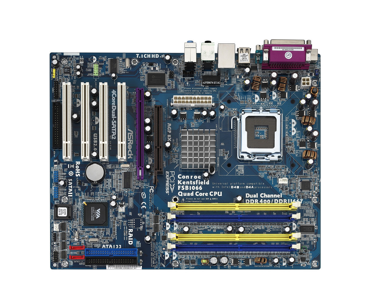

    Hey guys,
    got this mobo with no power to USB or PS2 Port.
    Temporary solution is a PCI to USB card.
    but i am eager to find the problem as this mobo worked until 2 days ago.
    i couldn't find even one fuse on this entire board!
    im afraid that the windbond chip failed-(didn't check it with scope yet)
    what would you suggest?
    (the image is from google for now- as no visable damage such as burnt chips or bloated caps

    Re: Asrock 4Core Dual-VSTA no power to USB,PS2
    get a manual first.
    there will be jumpers to switch the ps2 and usb power from 5v to 5v-standby so you can power keyboards & stuff while it's turned off.
    you should check these, and the surface-mount polyfuse will be near them.
      STJ THANK YOU!
      i know what fuses you were talking about, they don't exist in this board.
      but, i jumpered it to 5stdby it WORKS!!!
