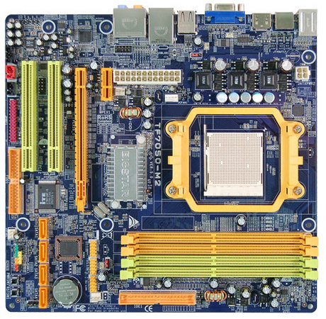

    Nothing failed, but I use this in my test computer, so I need it to be reliable. I pulled all the OST's with vents and replaced them with Rubycons.
    The board had:
    15x OST RLP 1000uF 6.3v
    3x OST RLG 1000uF 10v
    Those were replaced by:
    18x Rubycon MCZ 1000uF 10v
    In addition to some UCC on the VRM input, and other smaller OST's without vents. I left those alone.
    Now I know I violated my own rule by using a different series than what was on the board (replacing the GP RLG's with low ESR Rubycons), but I dont think it will hurt anything.
    The board seems to work fine after being recapped.
    Here's some pics:

    Just a notice on your otherwise good job: put a fan on the chipset heatsink, it tends to be between warm and hot.

        im thinking of recapping my boards that looks similar to yours, i also have a biostar 7050-M2 with solid capacitor on output vrm but KZG at the input. the rest are all OST (yuck..)
        probably 3 month later i will recap all the ost and kzg with rubys or sanyo caps... wonder how much difficult it is to recap a rohs board with a 30W solder iron..

          The board has now destabilized. I used Rubycon MCZ, the ones they sent me from Badcaps, to replace the OST's. I will be running folding, and if I come back an hour or two later the machine will be hard locked. It was always reliable before the recap. I would suspect the ESR is too low somewhere. I'll let everyone know if I can stabilize the thing.
          So I wouldn't go recapping these things, just yet. If you do, make sure you get exact replacements for the cap series that come out of it!

              I figured it out. It now needs .012v more processor voltage to remain stable at the same speed. This despite the fact that I did not change anything in the CPU VR area.
