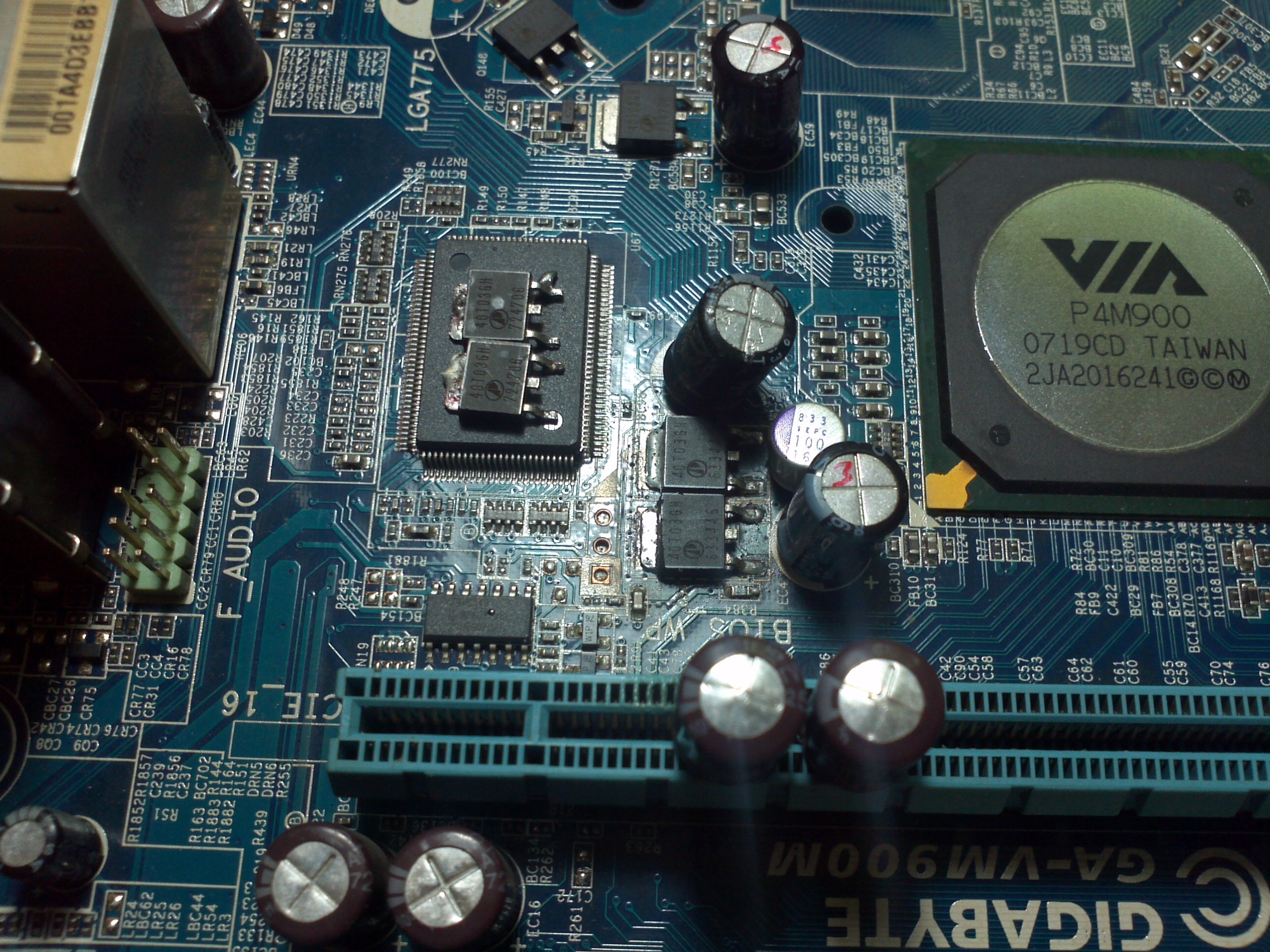

    i have a GA-VM900M REV.2. bought from junkman..
    i am writing post from this board.
    there are 2 swallon and 1 broken off caps middle of the board.
    The back line of this area is red and fried.
    i changed these caps with Nichigan.
    and i realize that couple of mosfets is overheated these are near the bad caps.their name are 40TO3GH.
    i could not put my finger more than 3 seconds one, 5 seconds other.
    all of them swapped. overheat is disappear now.
    i can put my finger at least 15 seconds.
    pics will be add.

    Stop!!!!! Immediately stop using those replacement caps!! They are unreputable and can do more harm than good! Also, it is never a good idea to use any electronic device with bad caps. It can kill the board dead.

          maybe i couldn't do clear explanation.
          i desolder fat caps.
          changed with normal caps. value's normal.. 1000 mF.

            The problem is they are counterfeit. The good brands are Rubycon,Nichicon and Panasonic. What you have is a counterfeit copy of the Nichicon brand.

              i don't remember the full name. maybe i'm wrong spelling
              i will control it.
              but pic are here..

                Sorry. This is nichicon..
                is this good one?

                  Nichicon is a good brand.

                    The failed caps look like Toshin Kogyo ATWB or ATWY series. You should replace ALL of these capacitors. I have seen tons of them fail on 775 boards, they are very bad series, I've even seen them take out a chipset. What series nichicon caps do you have?

                        ^ They do that so as to get it to outlast the warranty period. And possibly because ultra low ESR lytics have been going out of production for a while now and because polymers have much better conductivity.
                        And yes, TK's ATWY and ATWB series are egregiously bad. Worse than KZG and KZJ and only a notch above Sacon FZ/GSC.
