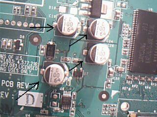

    I have winfast A310td nvidia fx5600 last night i was playing a game a few hours after my pc locked suddenly

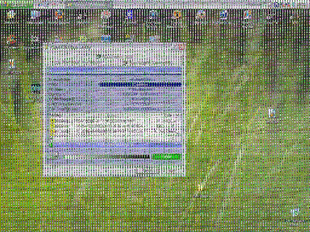

    I restarted but didn't opened I tryed a few times nothing happened but at last time opened but screen was striped
    if i try install nvidia 3d driver after windows can't open but on vesa mode can open windows but screen striped

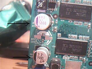

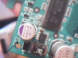

    i will recap my card but i don't know cap value which i use caps

    I don't think this case will solve by recapping. I have a A310 in previous period, similar case.
    I don't suspect the caps problem on that card, no worth to replace the caps. I guess the display core or display ram are failed or short circult.
