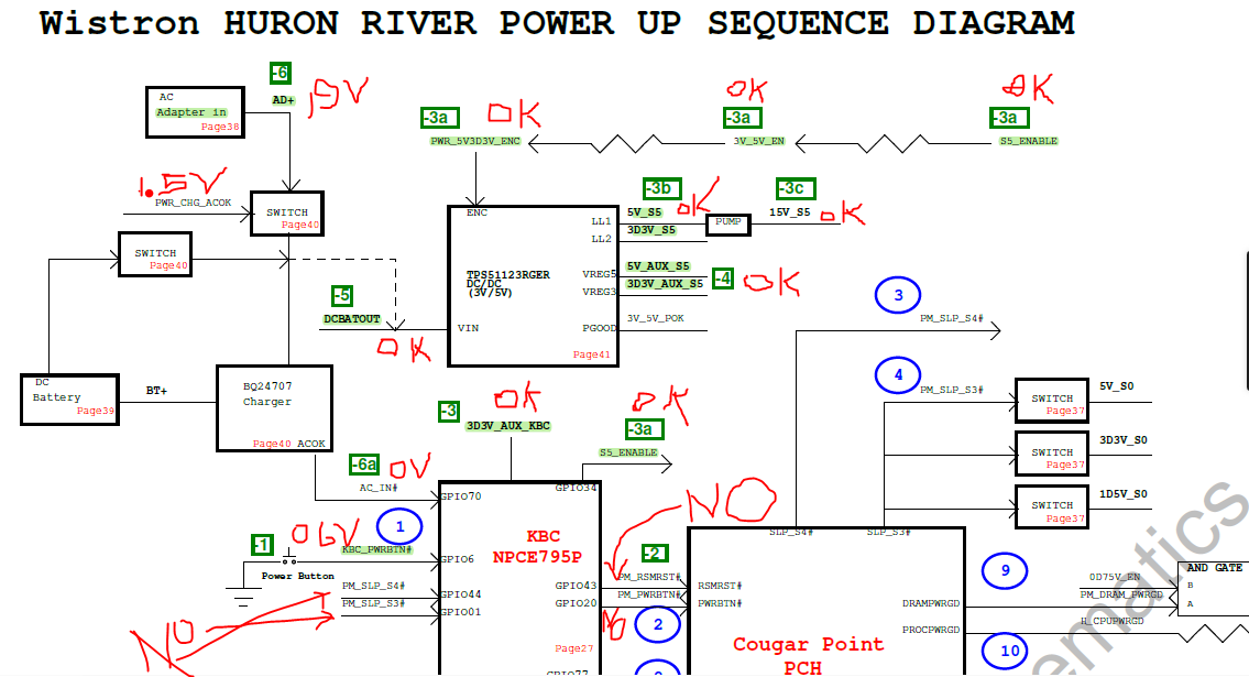

    I have this Problem with Dell Inspiron 3520 40_DV15 MLK MB 11280 mother board,
    I couldn't found board view for this board I have similar schematic currently board not turning on.
    +RTC_VCC is ok
    RTC_RST# 2.5V on q2102 drain pin, in this mosfet gate RTCRST_ON_ showing 0V also kbc RTCRST_ON is 0V
    SRTC_RST# also 2.5V
    3D3V_AUX_S5 is precent
    S5_ENABLE is ok
    5V_S5 is ok
    3D3V_S5 is ok
    Ac in# is 0V
    +5VA_PCH_VCC5REFSUS i don't know where to check
    PM_RSMRST# No voltage
    AC_PRESENT No voltage
    KBC_PWRBTN# is 0.6V and when i press the switch it go to 0 and rice up.
    I replaced bios bin form working same kind of board but no change. and no short anywhere in the board. also when i connected to power suply no change in amps 0.00amp showing in power supply. please anyone can help me to fix this board

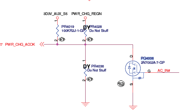

              PQ4002 not in this board ,
              pq4006 Source pn is ground
              D pin powe charger Ac ok present - 1.5V
              gate pin AC_IN# is oV this gate directly connected to the KBC pin 73 (PSL_IN1)

                PQ4006 open drain MOSFET: When the gate is at negative 0V, the drain will also be negative,PR4019 pin 2 It will be negative,AC OK present The voltage of 1.5V seems to be incorrect or PR4019 is not working properly, what voltage you get PU4002 Gate ?

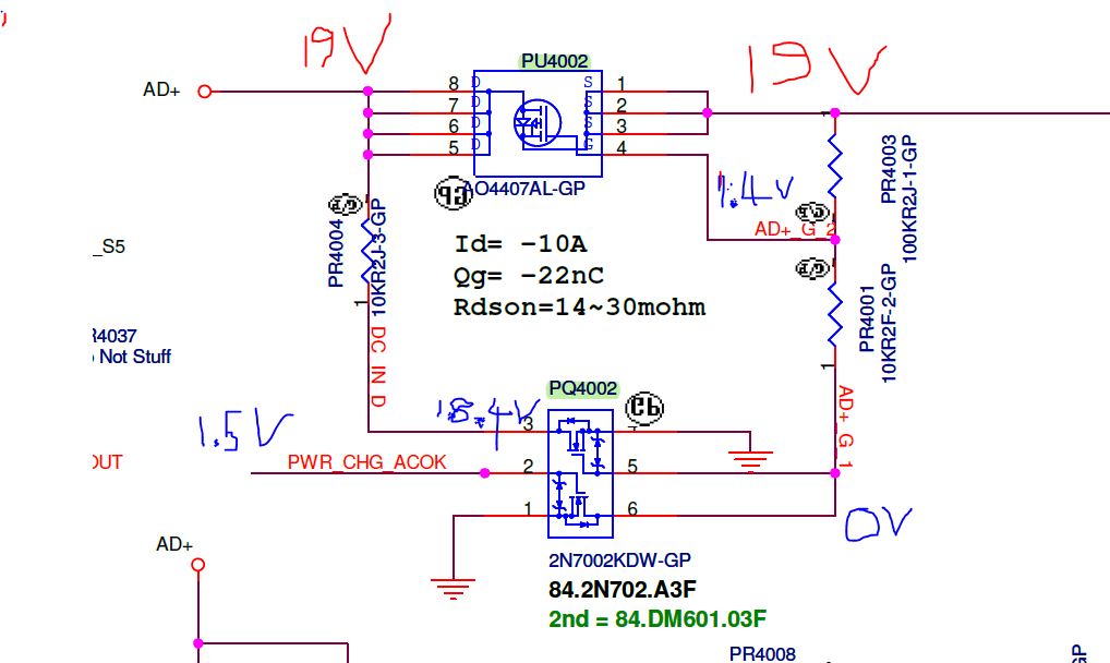

                  PU4002 Gate valtage is - 1.4V
                  I chaneged PR4019 from same donor board
                  I also changed PQ4006
                  I reprograme bios again
                  also I changed q2703 and q2701 but the problem is same
                  also I grounded PR4019 pin 2 manually but nothing changed,
                  I don't think PQ4006 open drain MOSFET because I injected gate pin 3V then source pin become 0V but the problem still same,
                  I feel like probelm with q2102 as I mentioned before in this mosfet drain pin RTC_RST# is 2.5 V mosfet gate RTCRST_ON_ showing 0V also kbc RTCRST_ON is 0V, SRTC_RST# also 2.5V is this voltage normal??
                  I also attached schematic here

                    when I grounded PR4019 pin 2 manually PU4002 Gate 1.4V valtage rise up to 9V, but in both cases 19V pass to the other side,
                    in the other hand RTCRST_ON not generating by kbc 120 pin, now I have no idea how to fix this one

                      PU4002 is a P-channel Mosfet. The internal diode will conduct at +19V to switch on the +3/5V LDO, but this doesn't necessarily mean full switching
                      The BQ24707ARGRR internal logic includes a delay. I suggest you test the PU4002 and the Gate line. There should be 2 resistors. If the PU4002 is not in use, trace it back
                        The assumption was made based on the schematic I have in my hand. According to this schematic, the source is connected to GND. The schematic you uploaded illegible
                            please check the screenshot i marked voltages there

                              here is power up sequence i marked voltages there. onlr rsmrst missing , I have no idea what to do

                                The diagram you're referring to is for 10316-1 with HM65 chipset whereas your mb is 11280-1 with HM76 chipset. A more appropriate diagram in this case is DELL INSPIRON 3420-11282-1. Its available in the forum.
