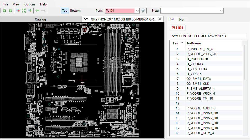

    I need to fix a z97 Gryphon with bootloop, exactly what happens here:
    https://www.badcaps.net/forum/troubl...ling-boot-loop
    I would like to try the same solution but the Gryphon appears to be different from others.
    I cannot find schematics and I fail to find PU1 position.
    Maybe it uses a different IC for the same function and in a different position.
    I am sure the problem is the same.
    Can I have some help?

    NO PU1. ONLY PU101 PWM CONTROLLER ASP1252MNTXG Click image for larger version

      PU501 RT8065ZQW
