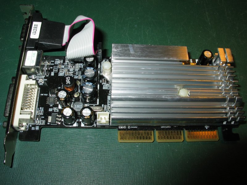

    Gainward GeForce FX5200

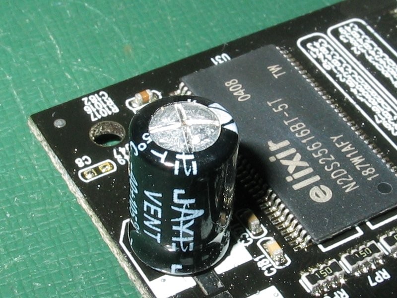

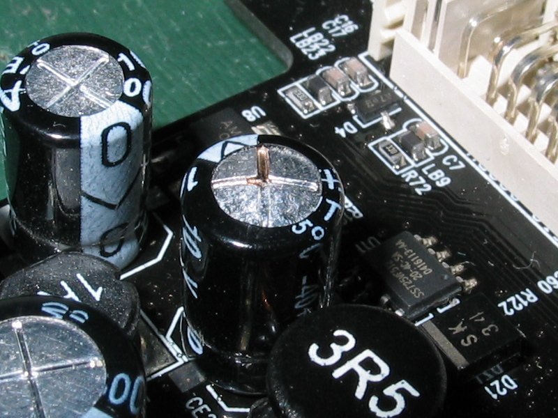

    Two bulged caps
    Bulged and leaking
    Oh, looks like a new crap cap brand!

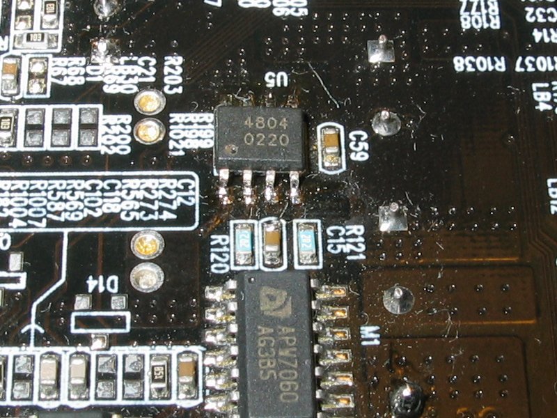

    Double MOSFET is also fried

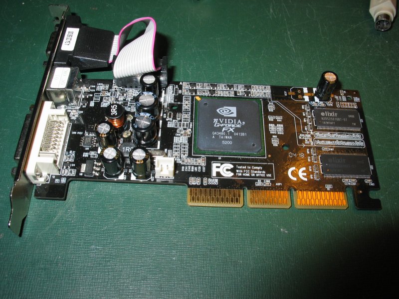

    Replaced 5 crap caps (the two bigger ones were not replaced as they're TAICONs)
    Double MOSFET replaced too
    Heatsink attached (removed a piece of it so it does not heat up the cap in the top right corner anymore)

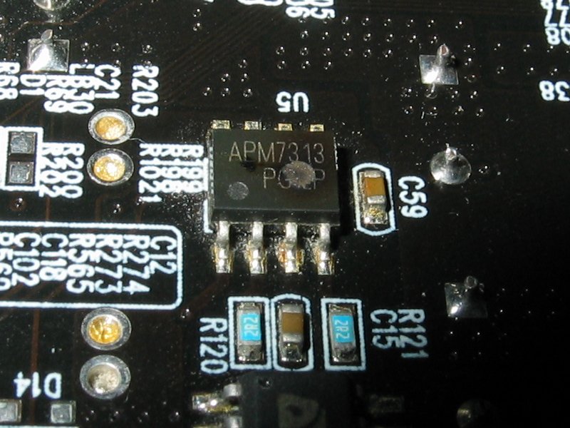

    I was curious on how you determined the correct MOSFET to use. I googled the number on the old one and came up with a data sheet. Is this the correct one?
    APM7313
    Just trying to hone my skills in case I ever have to replace one.
    • Rainbow
      • Aug 2005
      • 1375
      Re: Gainward GeForce FX5200
      Yes, that's the original one. The replacement is from dead Radeon 9500 card and it's SI4804DY or something like that. The parameters are not the same but very close.

          I'm surprised they bothered soldering the fan power connector on a passively cooled card. Most manufacturers will cut every corner possible to save money.
          • Rainbow
            • Aug 2005
            • 1375
            It's probably cheaper to put the connetor on all cards and just install different heatsinks than to make two different cards.
            The heatsink is really, really hot. No wonder that the caps failed.
