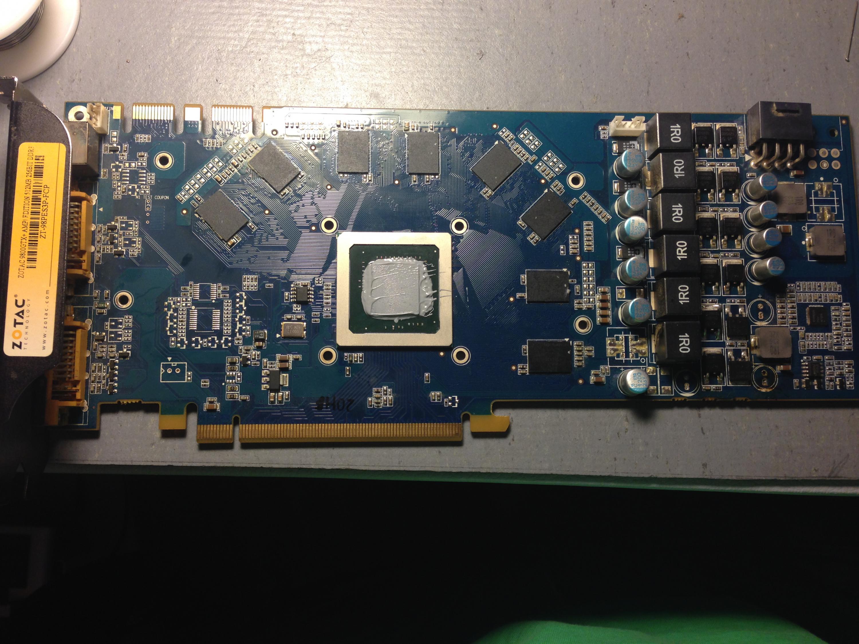

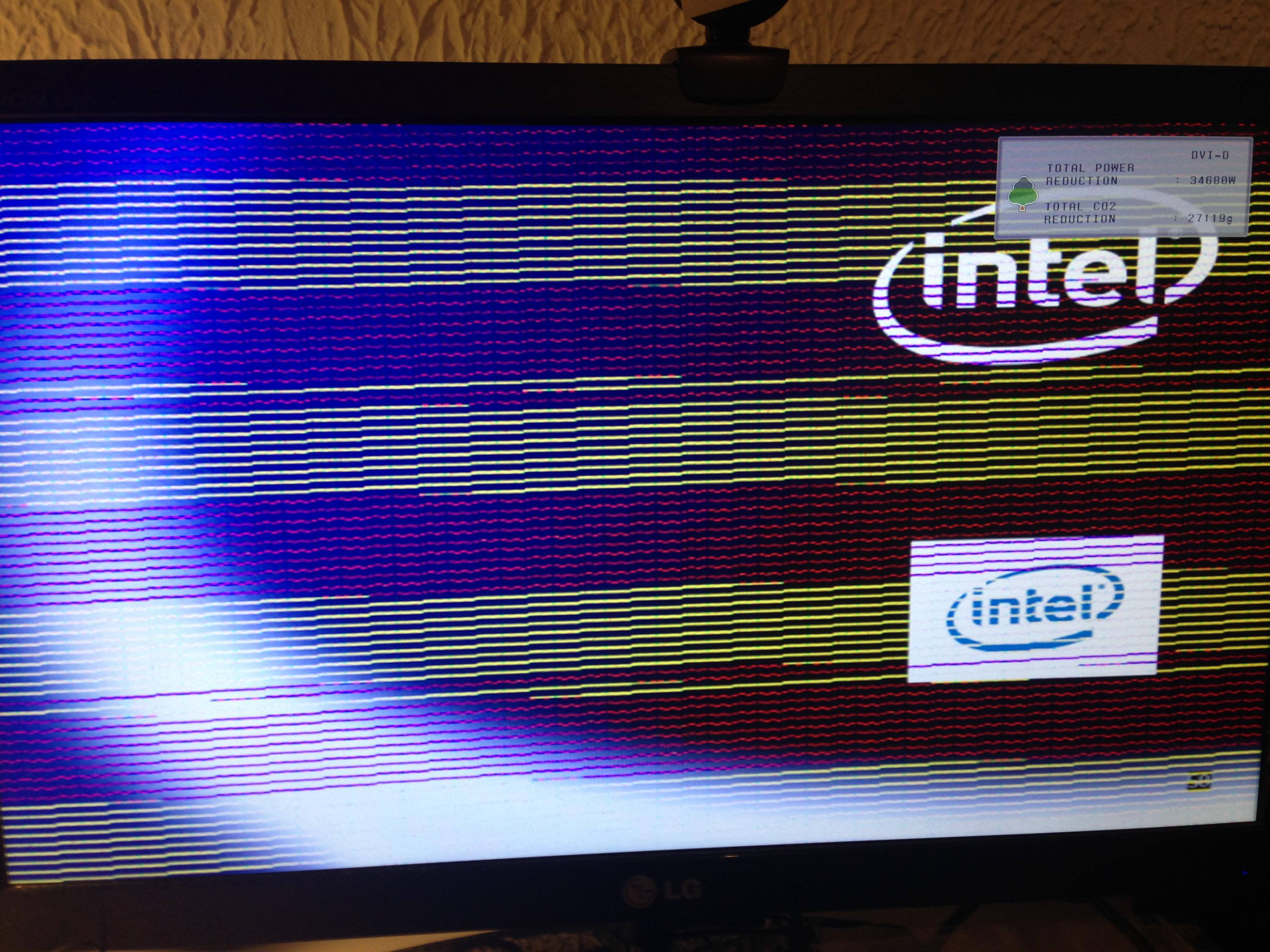

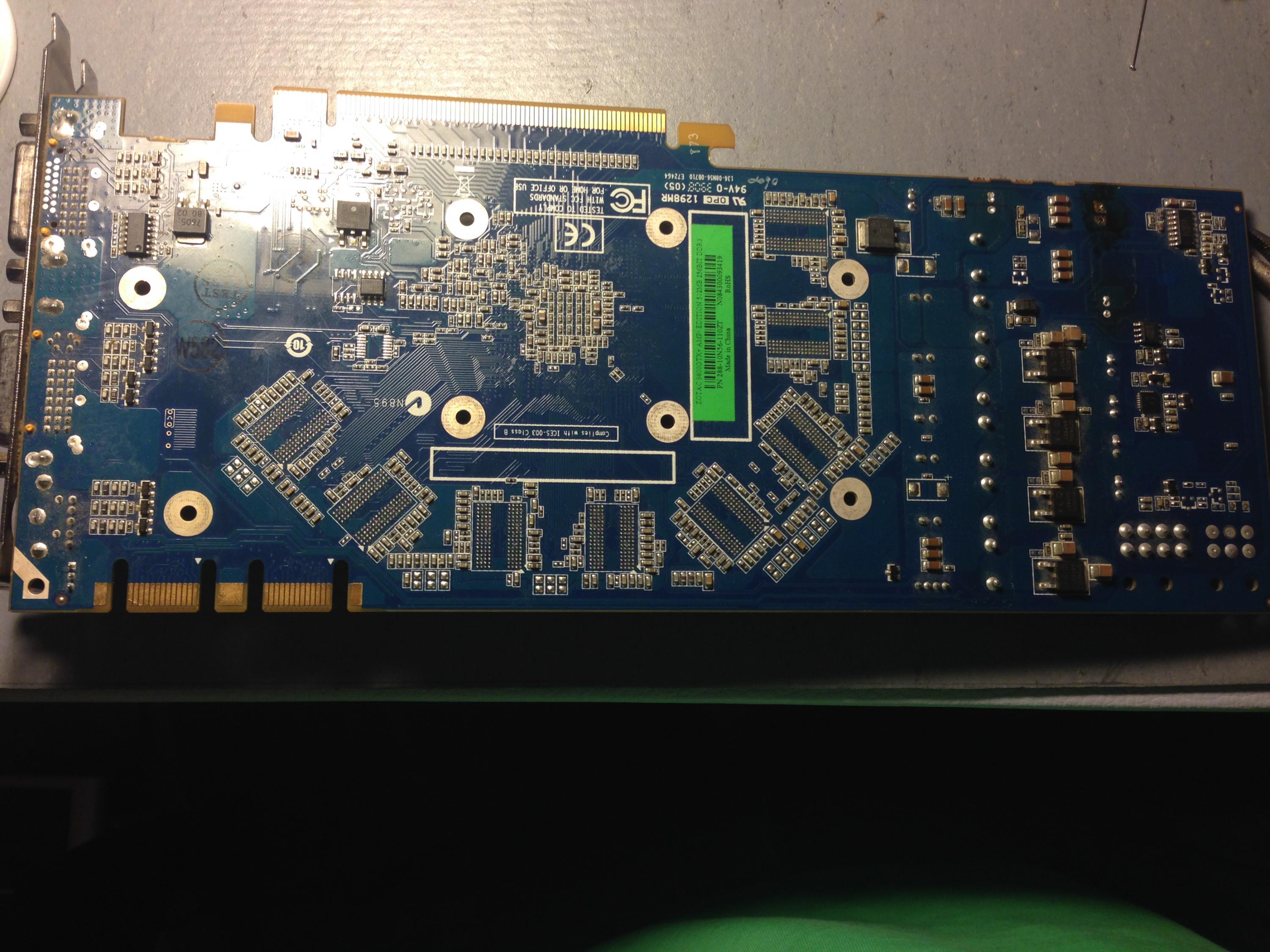

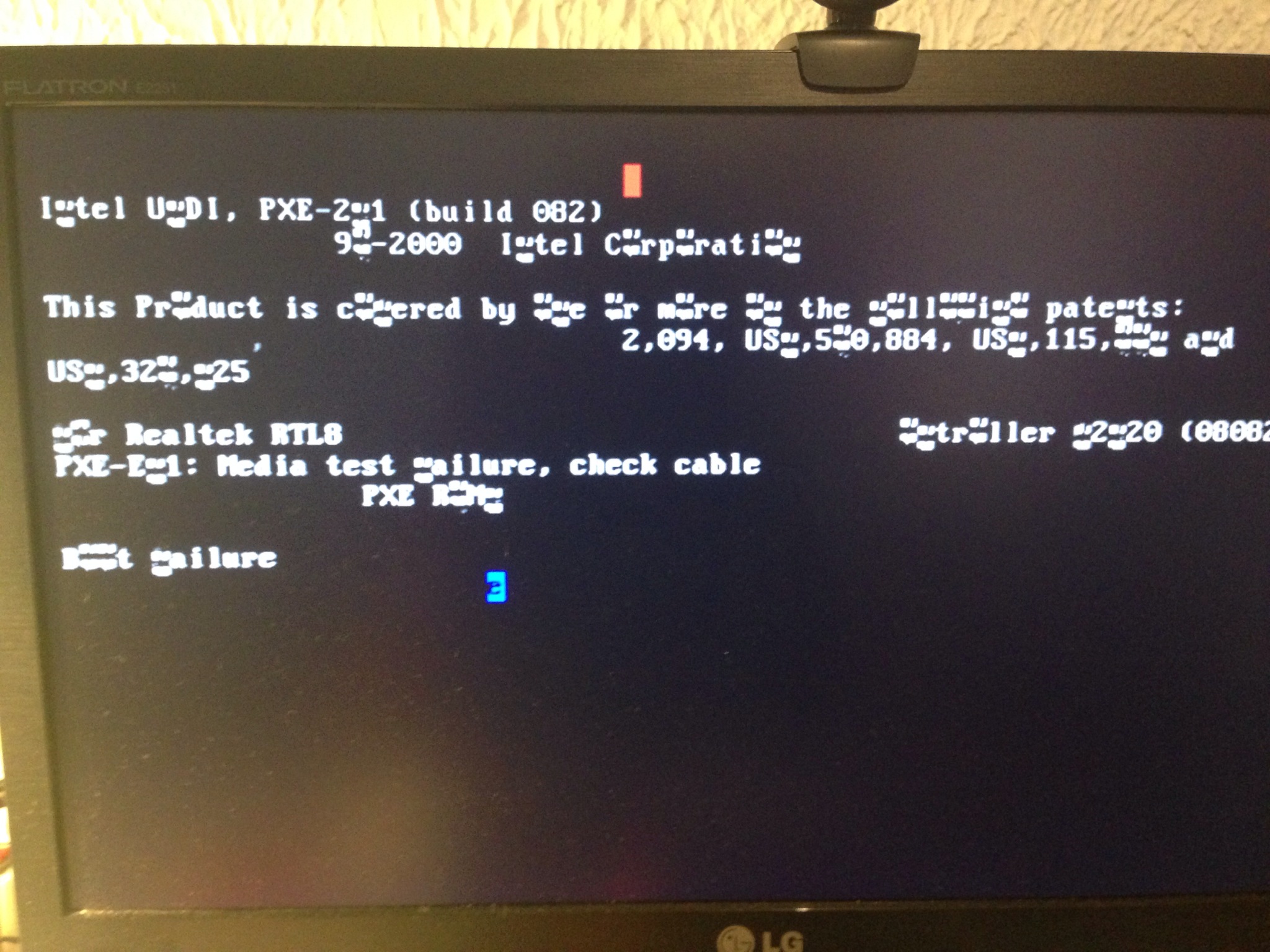

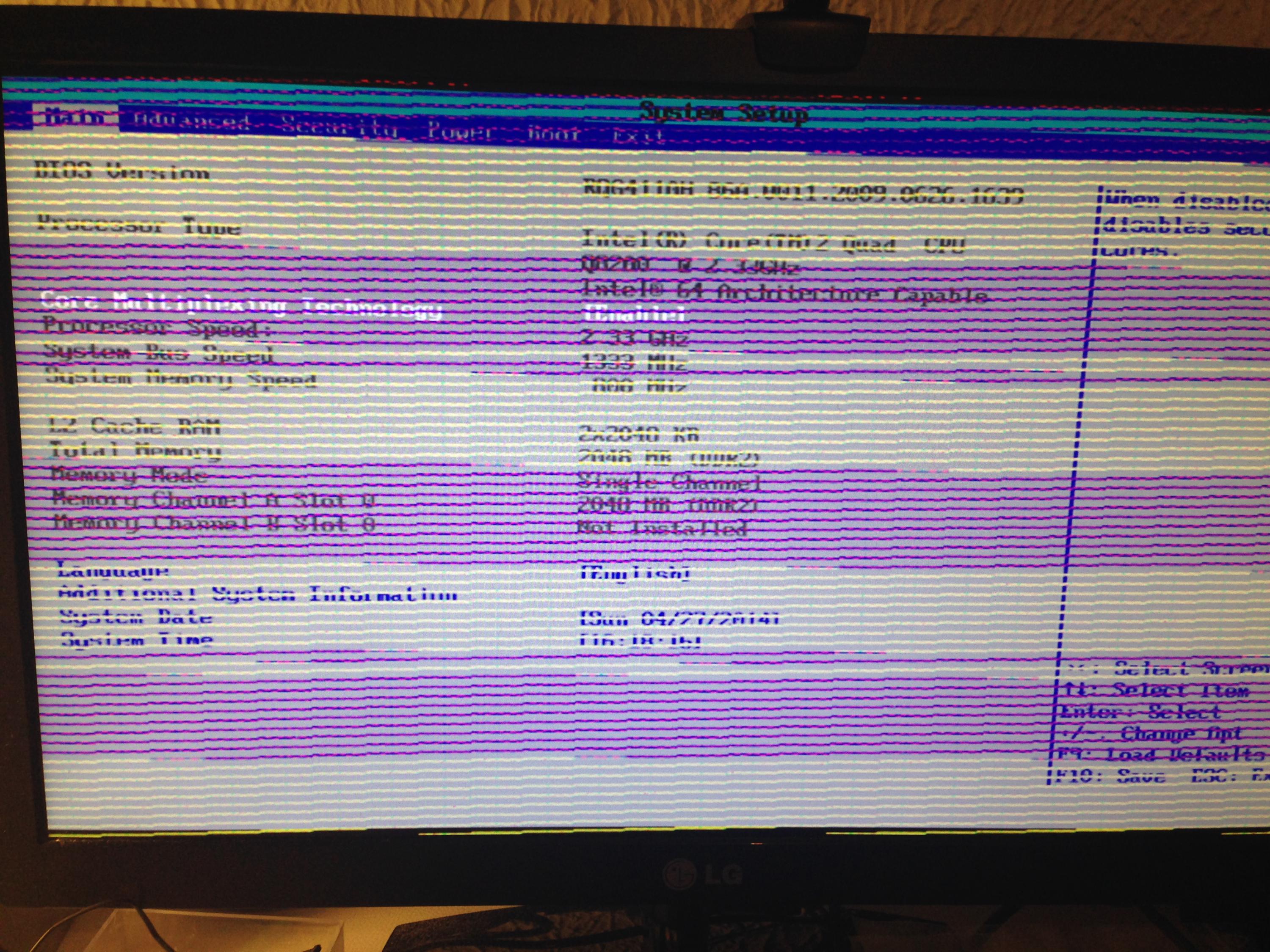

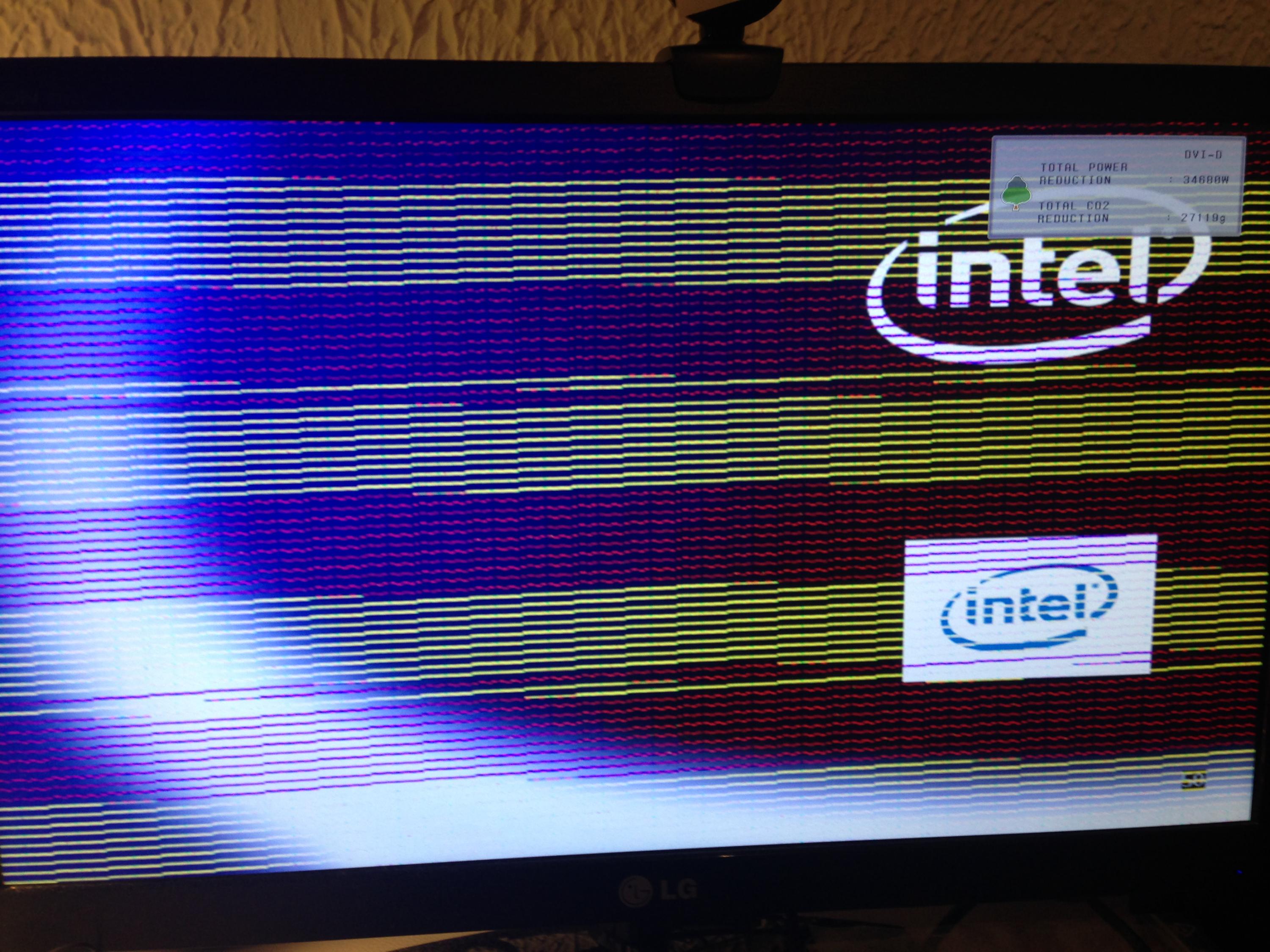

    Hi, i have ZOTEC GeForce 9800GTX+ that wont start, i fount that one MOSFET (060n03l) that went bad, so i replaced it. Now PC start but picture is defected.
    I try reflow GPU but that did not help.
    Please any ideas?

    is it possible that some of this aluminium caps are bad?

      Re: GeForce 9800GTX+ video problem
      No. It's either a dud GPU or bad memory chips. Usually the memory only makes vertical or horizontal lines, so my money's still on the GPU.
        Yeah, I'm going to say dead GPU as well. The only times I've seen this kind of stuff is from thermal damage over long periods of time and not caps.
          Did you try reflow the memory chips? and if the problem remains, the solution is re-balling he gpu.
              i try to reflow all memory IC no help still defect picture, reballing of GPU will wait for better day
