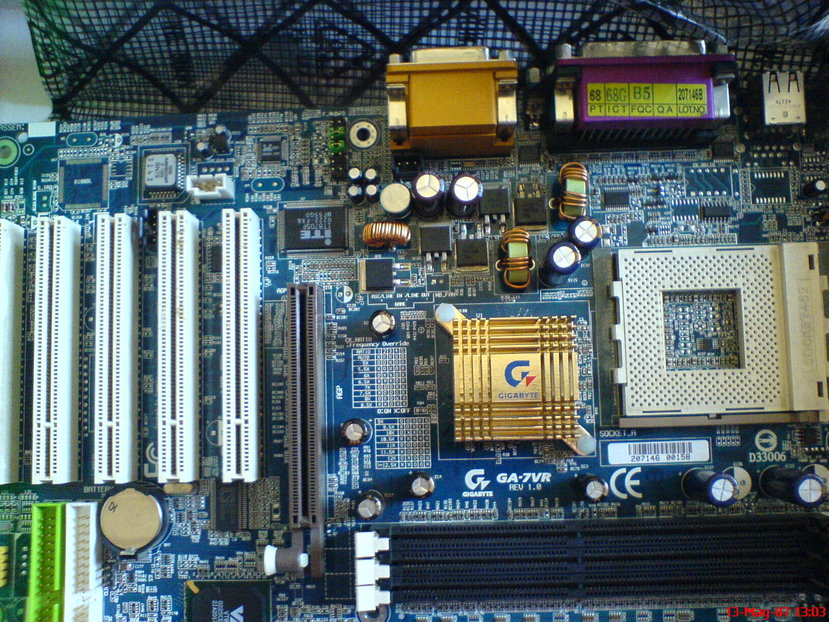

    bad caps on gigabyte GA-7VR
    well i had 3 bad caps,2-1200uF and one 1000uF all of them @ 6.3V know i face another problem it won't start
    the caps worn't leakin just a little, more bent
    this motherboard crashed a year ago or so, and i got another one then and now i tought it's time to fix it. so i changed the caps, they were corectly placed.
    When the computer starts with this motherboard i noticed it gives a little jog to the cpu fan... besides from that nothing else

      From what I have read on these forums, that does not sound very healthy at all. It sounds like the MOSFET's are dead or at least dying. This can be attributed to the bad capacitors.
      If I were to save this motherboard, I would replace the capacitors (which you have, just realised) and at least test the MOSFET's, if the MOSFET's are dead than you will have to replace those as well. Only trouble with failed MOSFET's is they tend to kill other components in the system, things like CPU's, Northbridge/Southbridge chips, maybe graphics cards.
      Maybe some other members can help you out some more. However I would test the MOSFET's with a digital multimeter before deciding whether to save this motherboard or not.

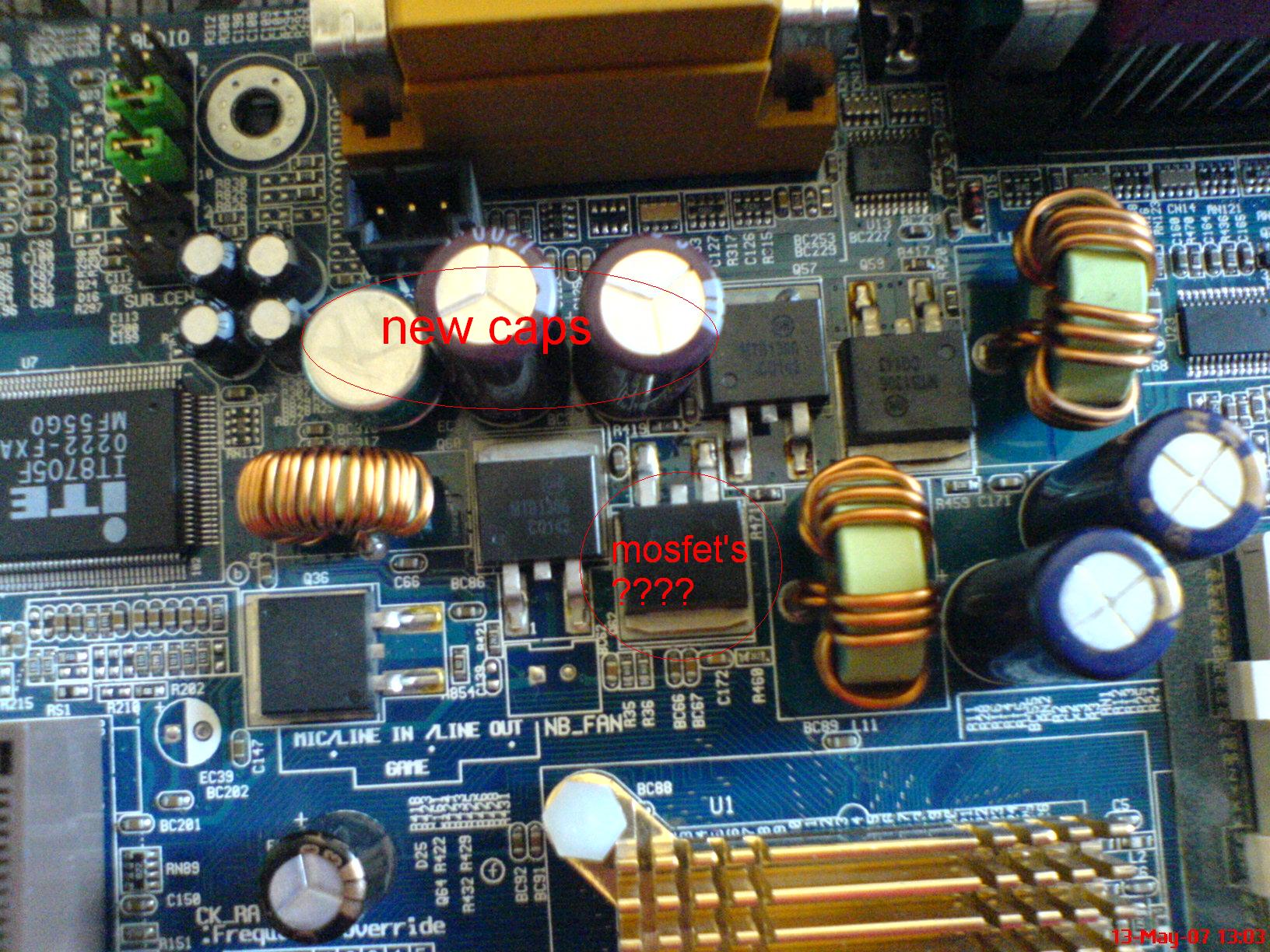

              yeah but what do they look like... i have some pics with my motherboard with the caps changed and a question... are those the mosfet's?
              if not where are they:P

                Those 3-legged guys with the missing middle leg are most likely the MOSFETS. At least the ones I am familiar with were that package type.
                Look here:
                http://www.overclockers.com/tips1095/
                The middle leg thats missing is the ground and those are soldered to the board and thus grounded that way.

                        Well not sure what the state of the PCB is, look like the mosfets were getting nice and hot and could well be stuffed
                        Generally
                        Ideally replace all caps of same type (and value) and replace any that are on the badcaps list of baddies
                        If there any GSC get rid of them asap
                        Mosfets can cook, do the test with multimeter to be sure.
                        Haven't got a decent link to hand but there are posts here on it
                        here one on it thought
                        They can be a pain to remove there are a few posts on it.
                        If they are stuffed cut the two little legs with nippy cutters near the body
                        (careful not to cut pcb, remove the legs off pads later)
                        Ideally for the Tab a nice heavy duty hot iron (60~80w see posts)
                        Hold body with small pliers or tweezers flow a bit of solder on tab to help with heat transfer pick it off when solder goes molten
                        Thats the hard part
                        ....hot and fast is the name of the game.
                        If you use a low wattage iron (15 ~25w) you will probably not do the job, just possibly damaged the pcb
                        Practice on junk if you haven't done it before.
                        There are tools that make it easier but $$$$
