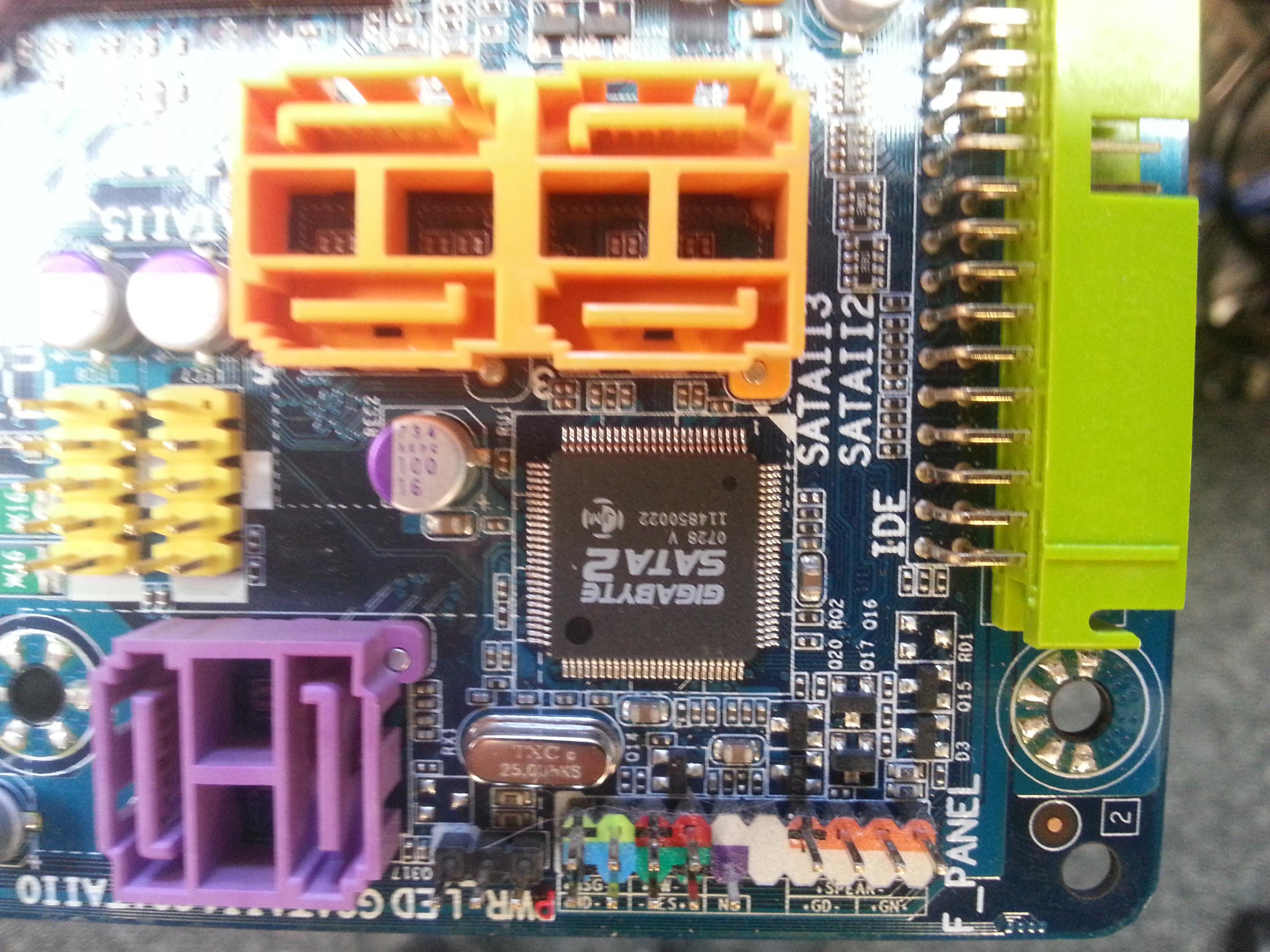

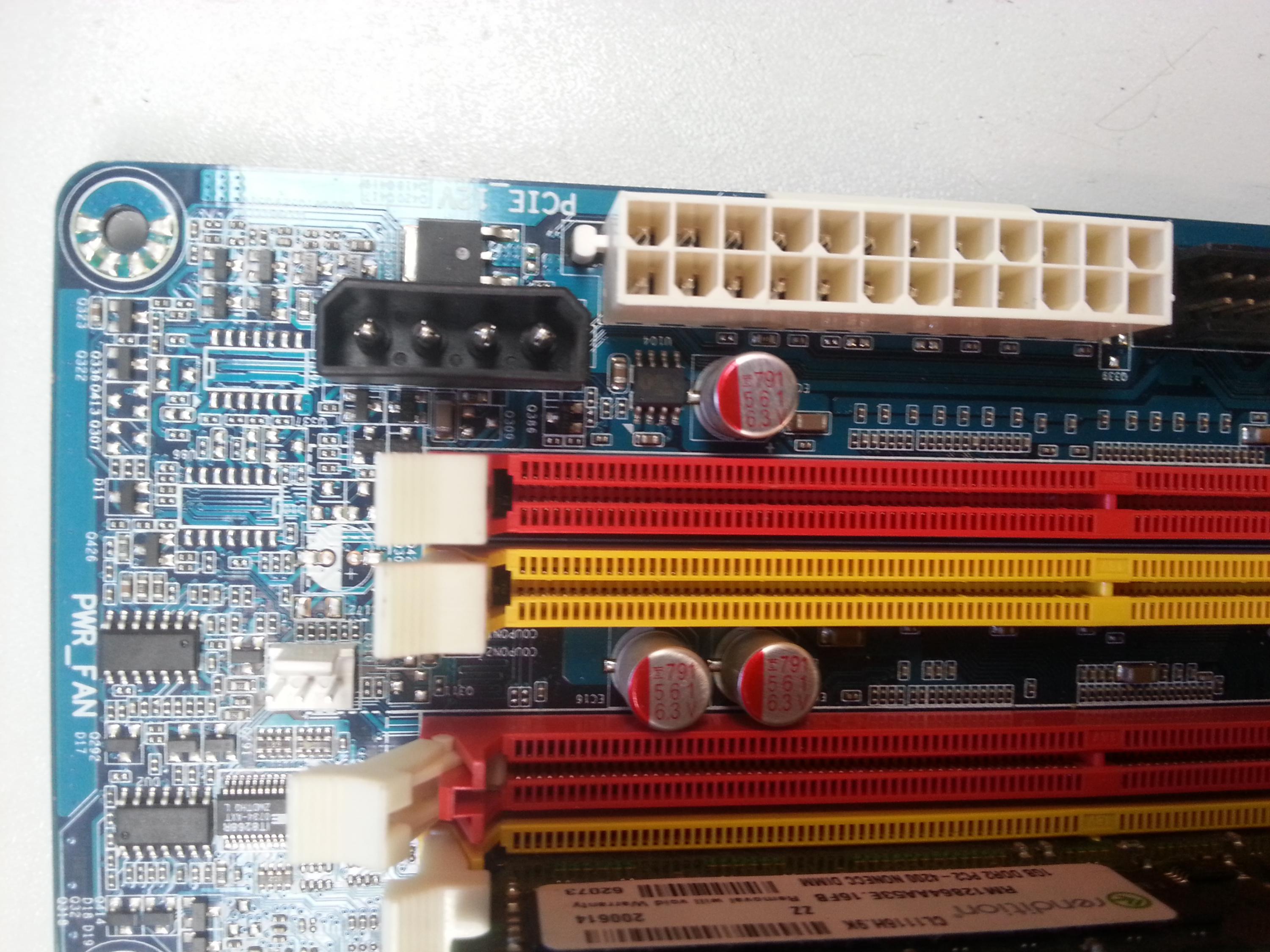

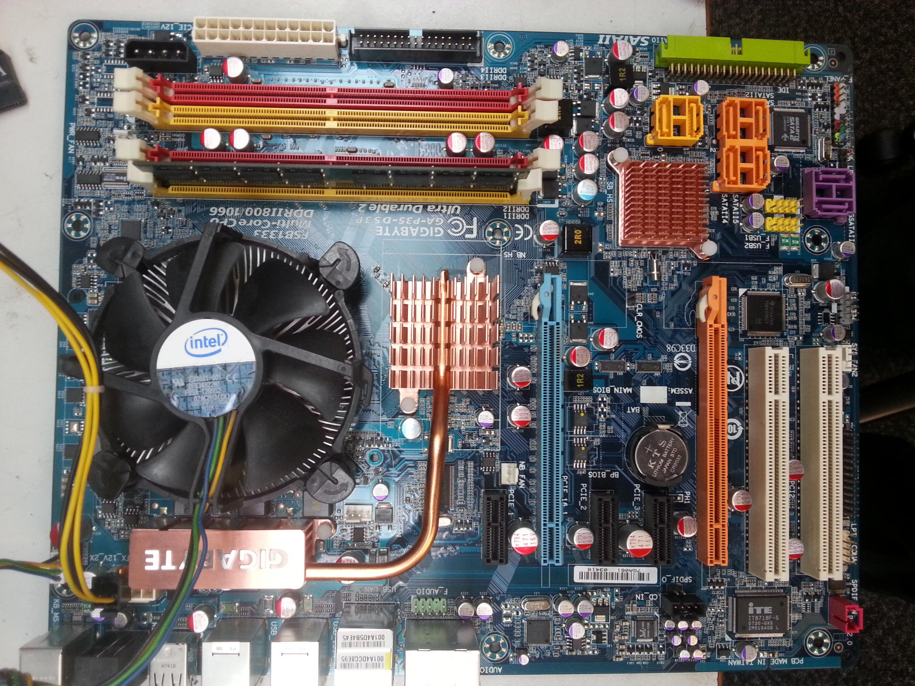

    This motherboard had two graphics cards fitted. One of the graphics cards had a couple of exploded caps over the weekend and the PC was dead Monday morning. Caps repaired on the graphics card which now works but the motherboard is dead.
    I measure 5v at the power switch but there is no fan spinning, nothing.
    Does anyone have a service manual or an idea where to start ?
    Thanks.

      You can start by measuring the voltages at the main power connector. It appears to be a standard 24 pin ATX power supply connection. This link is to a page that shows the pin diagram with labels for all of the connections of a 24 pin ATX power supply.
      http://pcsupport.about.com/od/inside...in-12v-psu.htm
      Edit: There may be fuses on the motherboard that were blown. I would expect them to be close to the power connector. I can't tell from the photo if there are any fuses there. Is there anyway you could provide a more detailed photo of the area around that connector?

                Let's isolate the issue here, first. But first, some obvious questions...
                - Does the PSU fan try to turn on at all when you try to power on the PC?
                - When you replaced the caps on the graphics card, did you place them in the right way? If you don't already know, electrolytic, tantalum, and polymer caps all have a set polarity. If you put them in backwards, that might have created a short in one of them and caused the PSU to not start.
                If you are absolutely sure the PSU works, try hooking it to the motherboard, but take everything out of the motherboard except for the bare essentials - that is, CPU, CPU heatsink and fan, and RAM. Leave the graphics card out or try a completely different graphics card. If the computer powers on, the issue is with the graphics card. If not, you'll need a multimeter and check all of the major rails on the motherboard (with PSU disconnected) for short circuit. I can walk you through that, but first just try to narrow down the problem as stated above.

                  Please take a closer look at your blue pci-express slot near the hold down latch. There is an area of discoloration just near the 2 red striped caps. I cannot tell from the picture if all of the contacts are there. That may be where the original video card was that blew up, just not sure. Good luck!

                      You likely have a short circuit on the motherboard then. It's usually repairable, but requires some hunting with a multimter. Do you have a multimeter and do you know (at least vaguely) how to use it?

                          Disconnect the motherboard from the PSU and remove all RAM. Leave CPU in the board for now. You may also want to remove the CMOS battery.
                          Next, start probing at the ATX connector on the motherboard for short circuit. That is, you are looking if any of the power rails (5VSB, 3.3V, 5V, 12V, and -12V) have a short circuit to ground. You may also want to get a diagram of the 24-pin connector. Here is one on Wikipedia:
                          http://upload.wikimedia.org/wikipedi...PS_signals.svg
                          Next, do the same with the 8-pin CPU connector.
                          If you see any readings in the 100 Ohm range or less, note them down and no which pin. Keep in mind, however, that it may take a few milliseconds for the caps on the board to charge (especially on a line with many caps), so it is normal to see a "short circuit that dissapears" after a seconds or two.
                          Also note that you do not need to take measurements of ALL of the power pins. Just one 3.3V pin, one 5V pin, and one 12V pin on the ATX connector is enough (i.e. you don't need to probe all four 3.3V lines).
                          One last note: the 12V rail on the 8-pin CPU connector is physically separated from the 12V rail on the ATX connector, so do separate measurements for these 12V rails.
                          Let me know what measurements you come up with and definitely post the units on each (i.e. Ohms, KOhms, and so on).

                                  That 264 Ohm reading on the 5VSB seems suspicious. Usually it's in the KOhms range too.
                                  Before we dig in deep, try this test:
                                  connect PSU to motherboard and plug PSU in the wall. Next, set your multimeter to measure DC voltage and check the voltage on the 5VSB pin. It should be 5V. If it's not, then the 5VSB is more than likely shorted. If it IS 5V, check if any of the regulators on the board get hot. That is all those black 3 and 4 -terminal rectangular components (google image SOT223 and SOT252). I see there are quite a few around the Southbridge. There is also one above the ATX connector, two under the blue PCI-E connector, and a few more where the Realtek and ITE chips are. Just touch them with your finger and see if they are getting hot (or even note if they are getting warm).
                                  U104 (8-pin SOIC - google image SOIC-8 to see what I mean) is also of interest, so check if it gets warm too.
                                  That's all for now. If we don't get any conclusive results from this, then the next step would be to check whick of these is connected to the 5VSB line. But all I wait to see what results you get.
