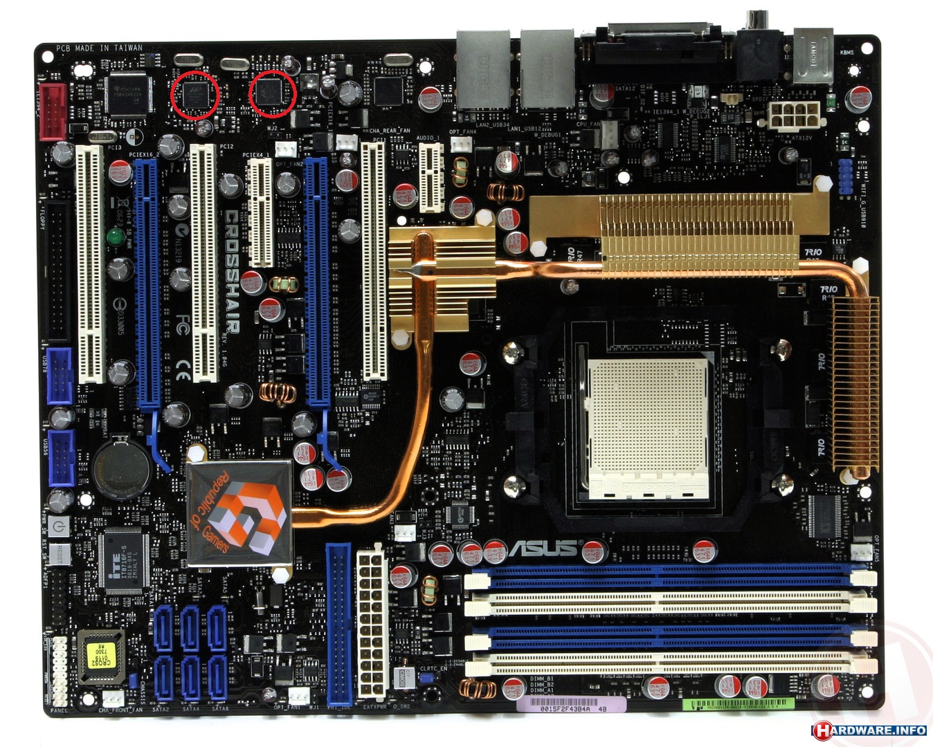

    Hello all i have a crosshair, older board that is just socket am2. it has a very weird problem which is it will not power on at all. there are leds on the board that will illuminate and the lcd screen on the back will light up too. but the power supply isn't coming on and all the fans remain dead. the board has no physical damage with most of the caps being polys. a few tk caps but none are bloated and most are on the bottom of the board. iv also tried two different power supplys that i know work fine. Its looks extremely clean so im confused to why it wont power on at all. any ideas would help me out and ill try to get some pictures up soon. Thank you all!

                So iv come back to this board to see if theres any hope for it. it will not power on even when the power supply is shorted to be turned on. with the power supply off and i can see the board has power it appears that its either the little audio chip or ehternet chip that is built on the board starts to get fairly hot for some reason. i dont know why this would happen but i have little hope for this board now.

                  I've had that happen before - it's often caused by the Ethernet chip getting taken out by a lightning hit through an ADSL router. The Gigabyte GA-Z77M-D3H-MVP motherboard in my main rig had that happen to it before I got it, and refused to power up. I was able to remove the Ethernet chip with a heat gun and the board came back to life.
                  EDIT: These two are the Ethernet controller ICs on the original Crosshair. If it's one of these two, then yes, you'll have to remove it.

                    so ill try removing it with my trusty heat gun and see what happens. im guessing the Ethernet wont work but nothing a Ethernet add on card shouldnt fix. ill report results soon!
                    question only one of them seems to instanly get hot to the touch. should i just remove that one for now?

                      Yes. Try just the one that gets hot. If problem is not gone, try the other.
                      Also, since you will be using a heatgun, I suggest you make a heat shield around any electrolytic caps in the nearby surrouding area that may get blasted from the hot air. Aluminum foil should work great. That said, don't cover the caps completely as if you are roasting something in the oven. Just put the shield/aluminum foil so that it deflects heat from the heat gun but does not cover the caps directly on top or the sides where they won't get blasted with the heat gun.

                          So i removed the first one but still the same result. ill remove the 2nd one and report the results.
