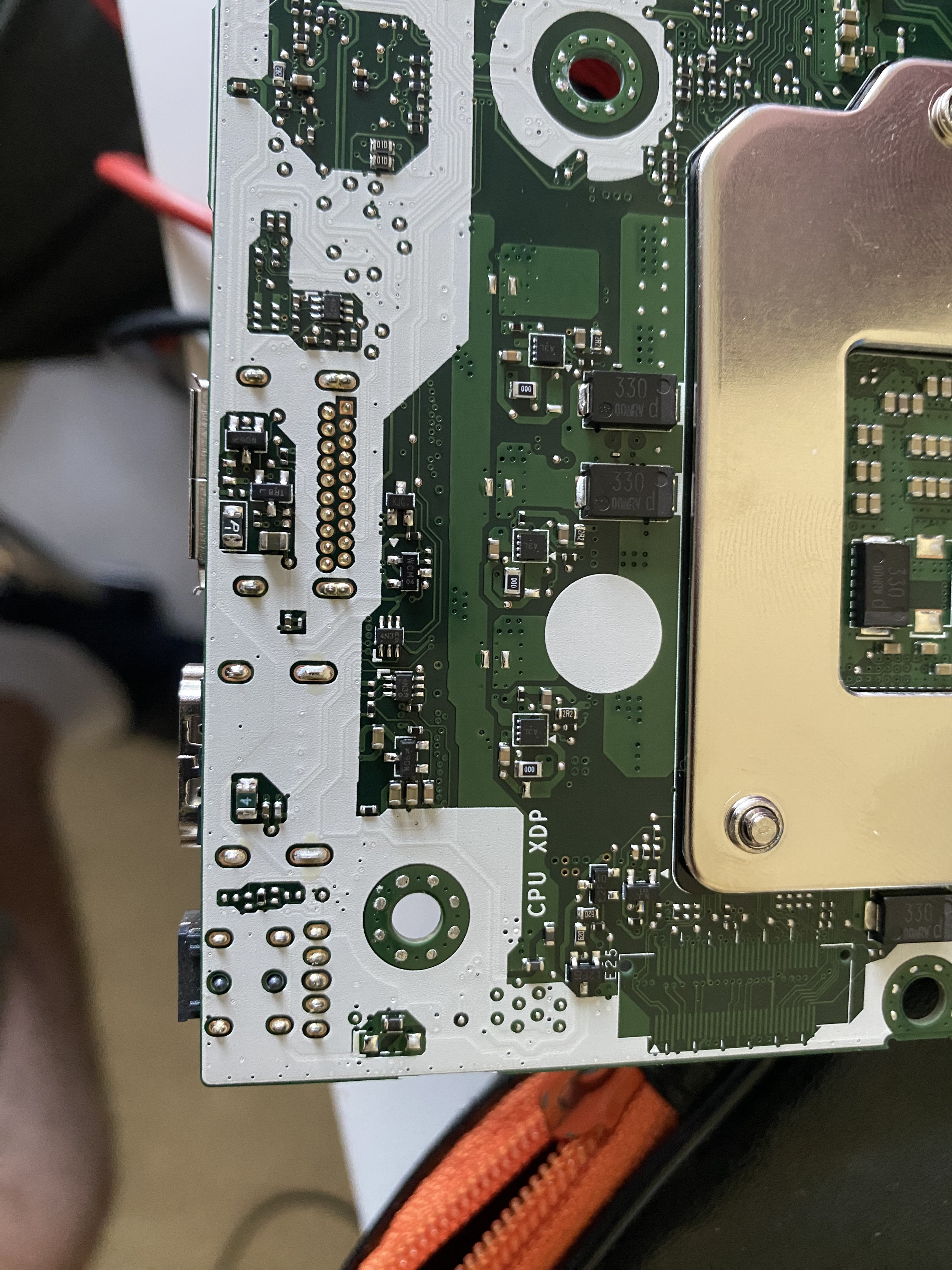

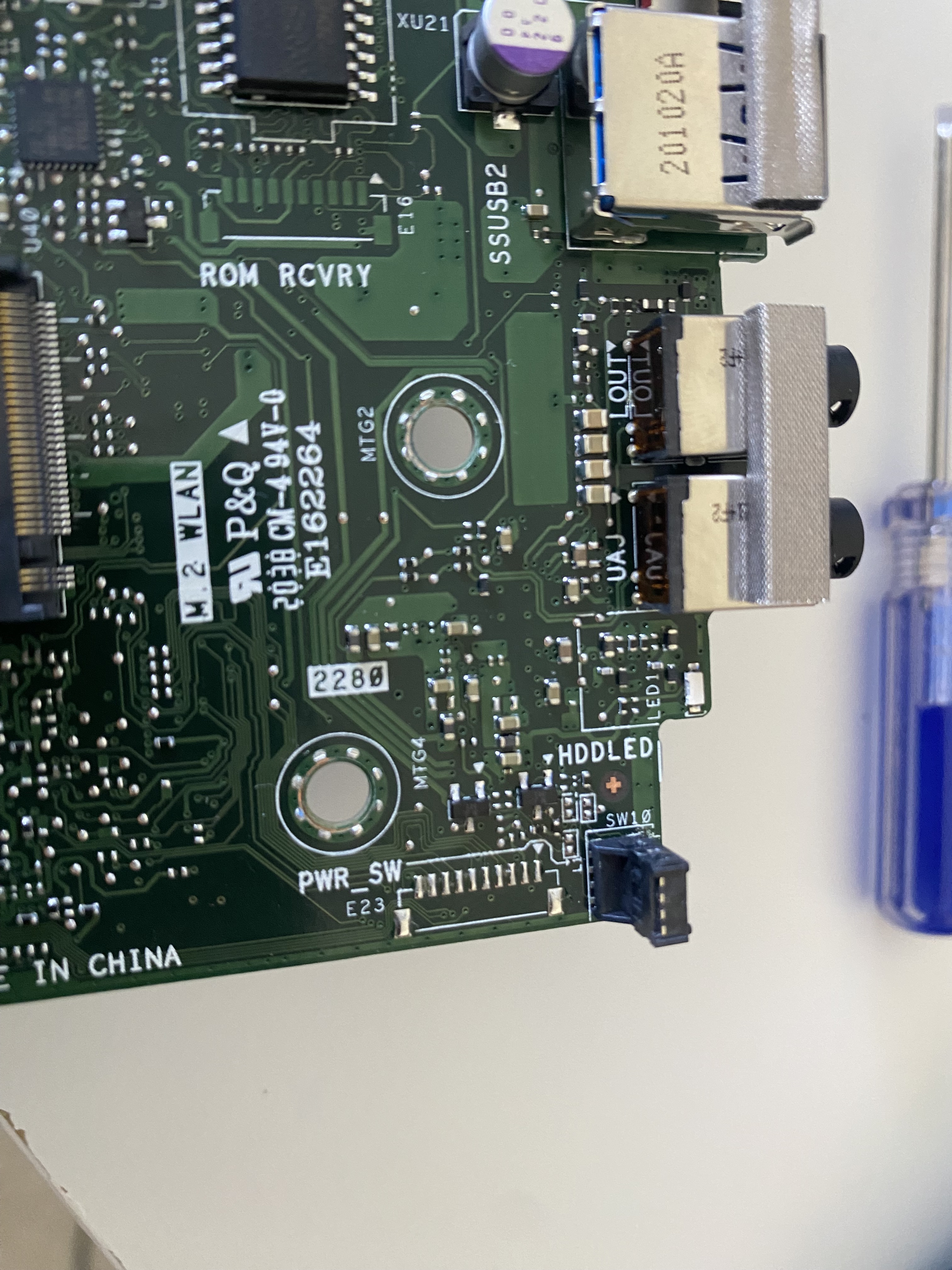

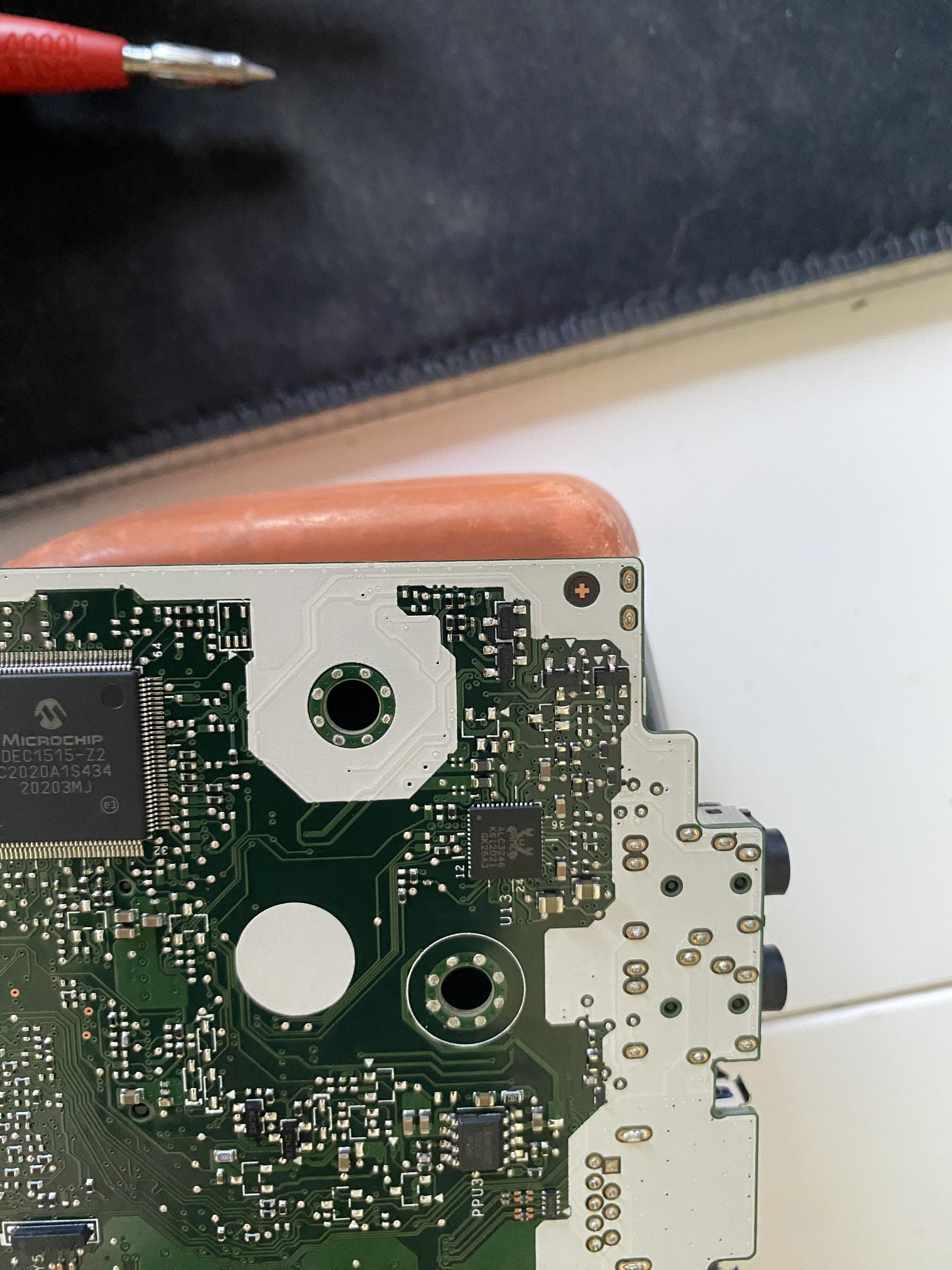

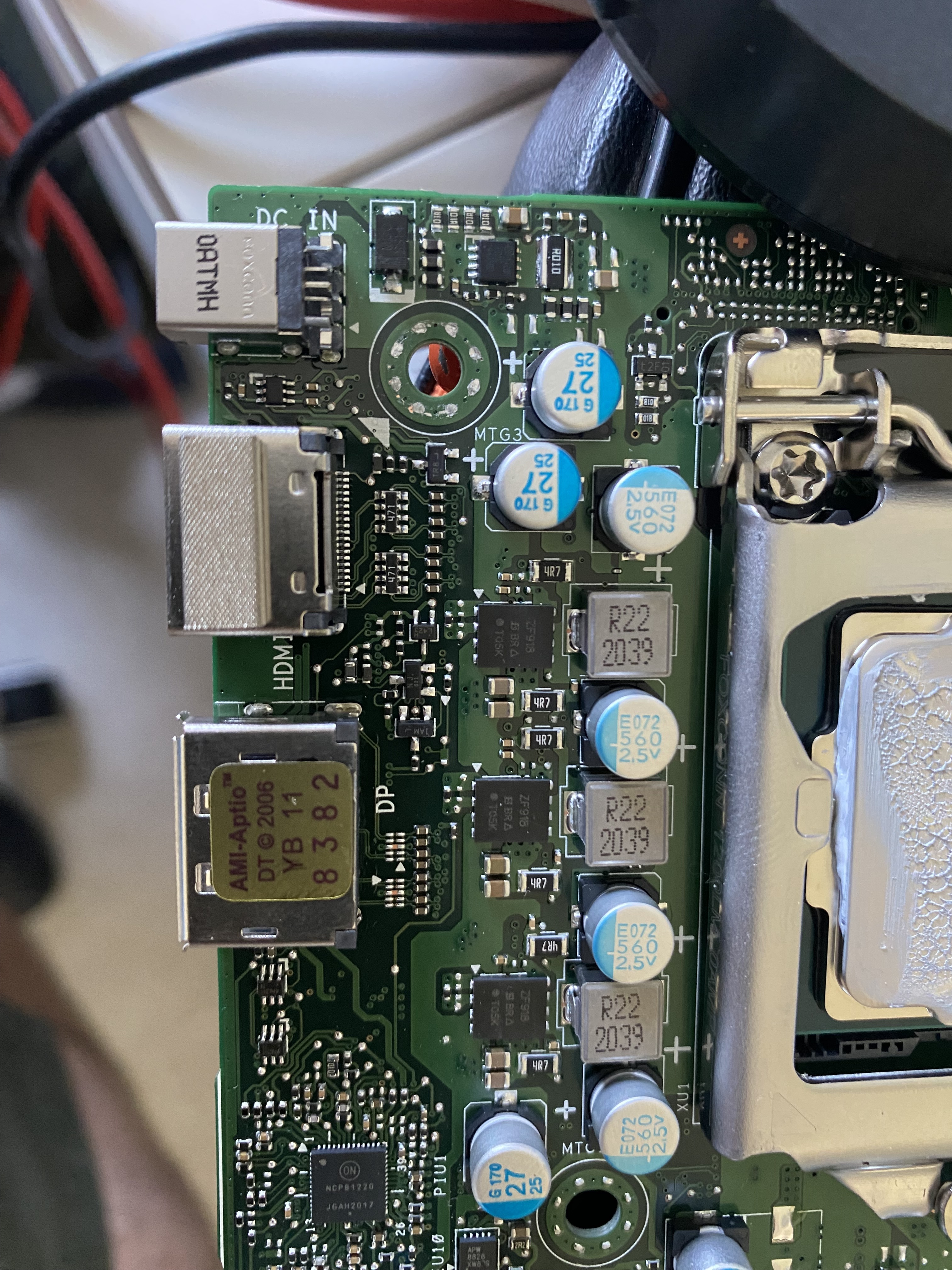

    Hi everyone,
    I have a problem with this dell mini desktop, no LED lights up and there is no response from the front power button. It literally feels defunct, with no feedback whatsoever.
    IPCML-CT motherboard rev.A00
    CPU: Intel Celeron G5900T
    I tested the power supply (19.5v correctly) but to be careful I also used an alternative power supply to test, nothing. No LEDs, no power on.
    I tested the power button pins and they correctly measure 3.3V, so when I press the button or put a bridge with a wire, the pulse seems to be there correctly.
    What could be causing the motherboard to not turn on?
    I also tried without RAM, without SSD and without CPU. but without the cpu it wouldn't turn on anyway.
