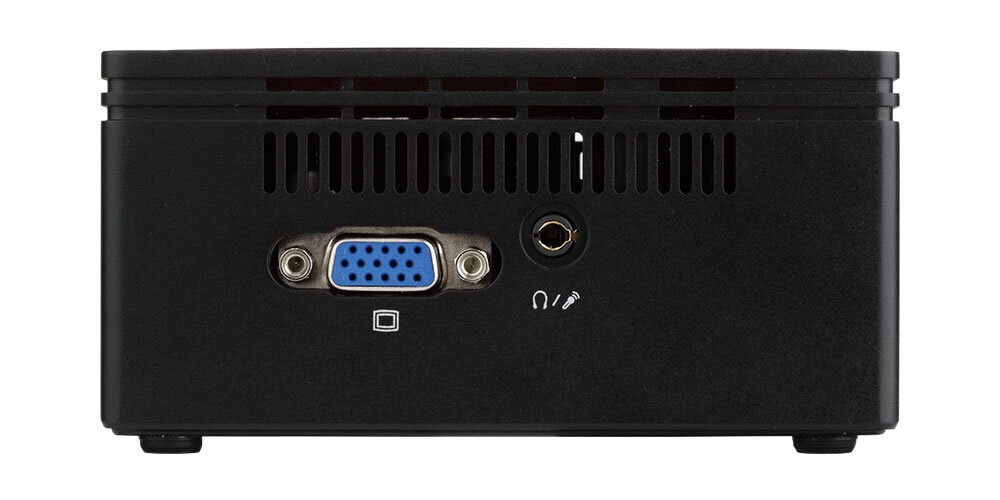

    no video output on the VGA port ? Click image for larger version
    • YellowJacket
      • Dec 2020
      • 105
      • Slovakia
      No, nothing on the screen. ​​
