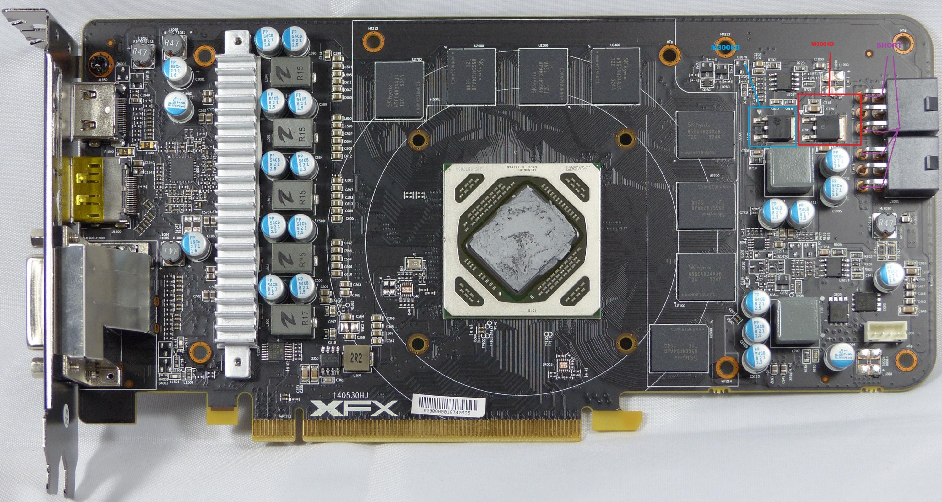

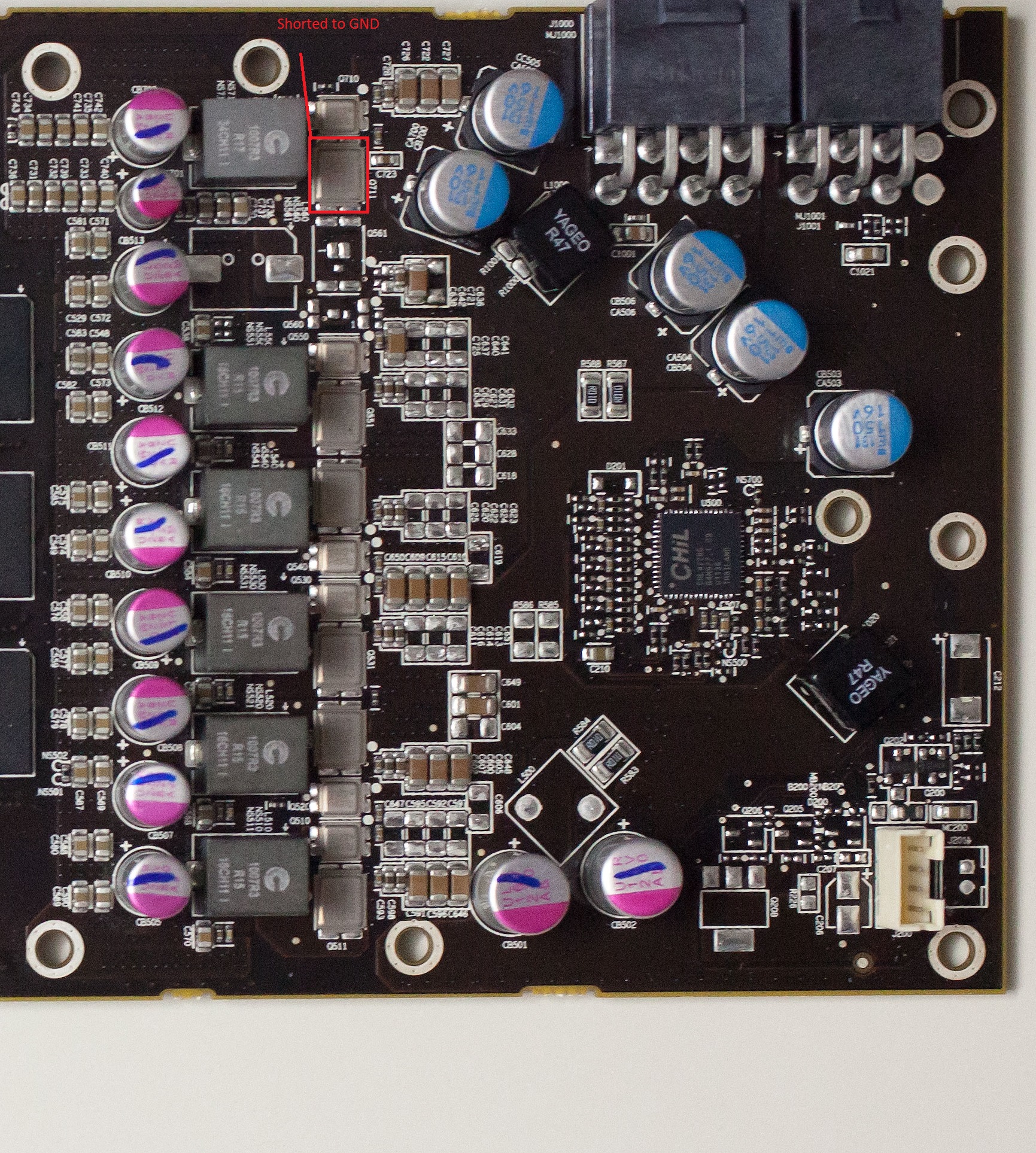

          Hi guys,
          So my XFX R9 380 was working fine but I wanted to put it to my cheaper/weaker PC since I got upgraded, everything was working fine, but I think my generic PSU killed it somehow.
          I installed the GPU and it turned on ok, started playing a game and suddenly black screen.
          I restarted PC but the GPU seems to be as if not pluged in.
          Took the heatsink if and saw the connector terminals are shorted, spotted these 2 MOSFETs shorted and replaced them with indentical, nothing changed.
          There is a short somewhere but I dont know where.

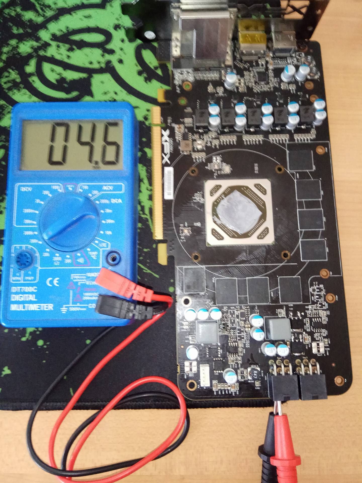

              Re: Sapphire HD 7870 possible short
              With the video card plugged in the PCIe, and both connector from the PSU to the Video card the PC turns on, works well on the integrated GPU and it boots normaly even thoguh Ohm meter shows 1 Ohm on the marked terminals.
              The GPU did not have any problems so far with the BGA and has not been "oven repaired".
              Also I would like to add that while the PC is on, the heatsink is cold and the GPU is not developing any heat.
              So I would say that the GPU chip is not shorted, however I do not understand how can the PC boot and work if there is a short anywhere in the PC, in my caste the video card connector is shorted (or is it)?

                #67
                If you had a shorted MOSFET like you say, then the PC would NOT turn On. Reason being is the GPU (and sometimes also the RAM) has a very low resistance - typically less than 10 Ohms (usually around 1-3 Ohms on recent GPUs). Thus, a shorted upper MOSFET will cause the GPU chip to try to draw an extreme amount of current from the PSU. This will almost always trigger the PSU's short-circuit protection (the few cases where that didn't happen, I saw the GPU shoot up smoke like a Diesel truck, but only white in color and with a TERRIBLE smell ).
                So check that you are measuring the pins in the PCI-E power connector properly. On a 6-pin and 8-pin PCI-E power connector, the row of 3 (or 4) pins on the side of the lock/latch are ground. The 3 (or 4) opposite of that are 12V. Have a look on Google for a diagram.
                Also, note that on an EPS12V connector (those 8-pin CPU connectors), the ground and 12V pins are completely the opposite to that of the PCI-E power connector: the row of 4 pins closer to the connector lock/latch are 12V and the other side is ground. So keep that in mind while measuring.
                Finally, make sure you keep your multimeter probes connected long enough to measure the resistance. Due to capacitors in the circuit, your multimeter might show a low resistance of a few Ohms for the first 1-2 seconds. But if you leave the probes connected long enough for the caps to charge, the resistance should rise (typically it will be more than 1 KOhm with the video card removed from the motherboard and disconnected from the PSU). And last but not least: make sure you are not misinterpreting your multimeter (especially if it's a manual-range one) - a "1" on the left side of the screen does NOT mean the resistance is "1 Ohm". It means "over range of the current scale". I've seen people make this mistake, so I am hoping that's not what's going on here.
                That said, just because the video card didn't have BGA/bumpgate issues up to this point and was never oven-baked doesn't mean that it couldn't have just developed them. Given the symptoms you describe and the fact that your computer can run without the video card shorting out the PSU strongly suggests BGA/bumpgate issues.

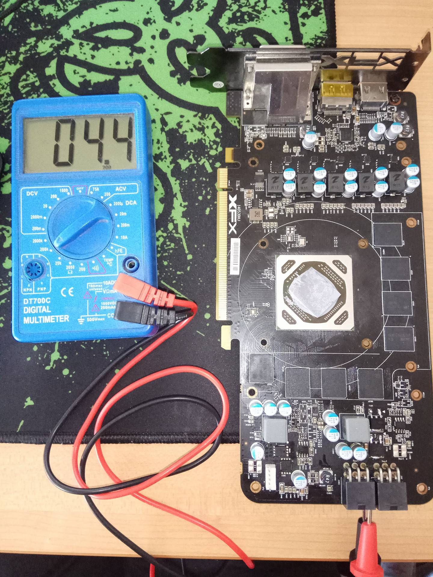

                  Momaka, you were right, after leaving it for a 2-3 min the caps charged and the measurements are different, here are the photos, the same thing applies to the second connector.
                  So I am looking for a blown fuse/component that is connected to the second pin on each power connector? Since the resistance is infinity on those.
                  I did not upload the second connector photos since they are exactly the same.

                      #70
                      Yup, that's a pretty high resistance. That means you *don't* have shorted MOSFETs.

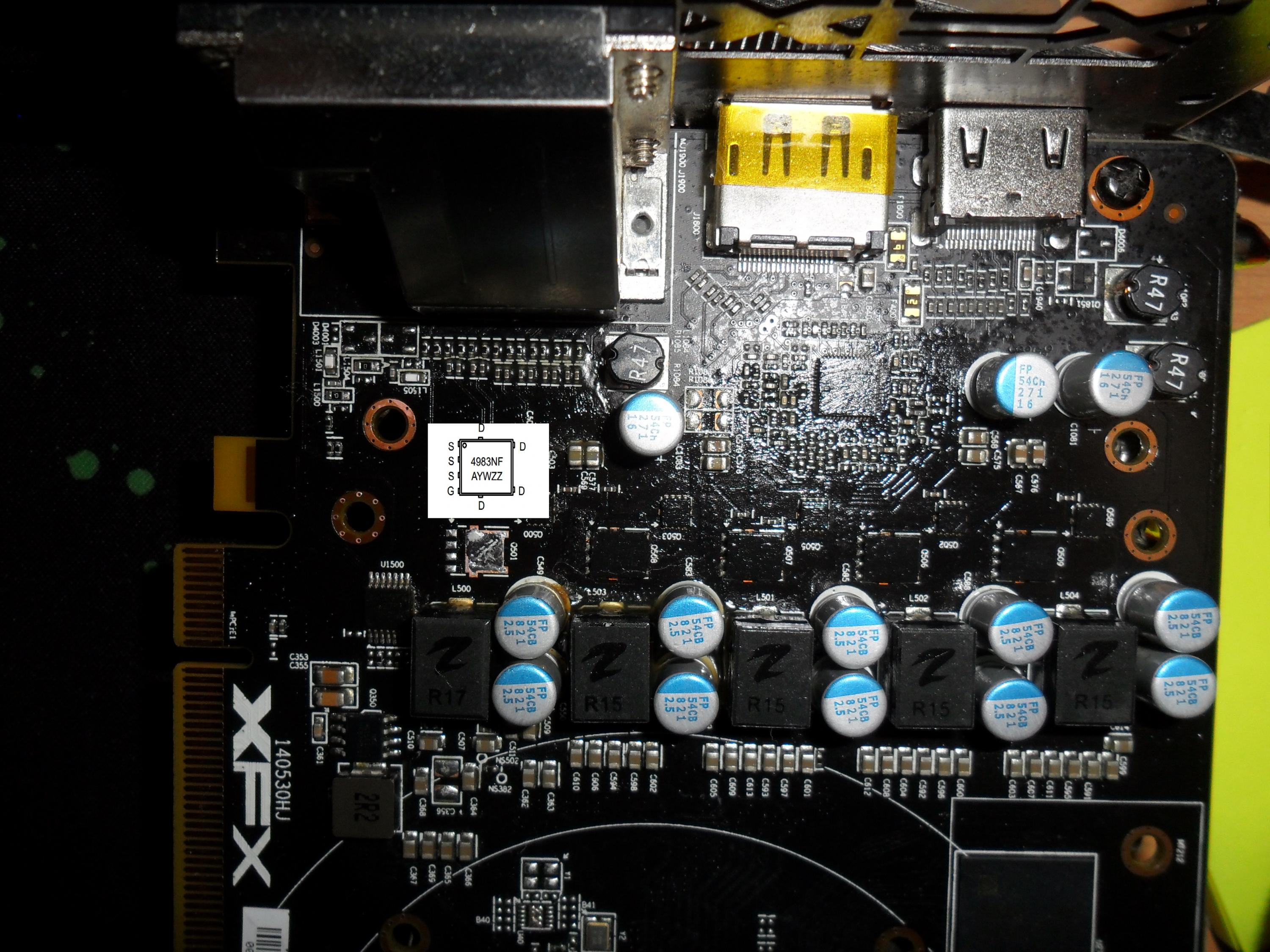

                              Back with more info.
                              Found out that you can measure Vcore on the middle SMD capacitor on the back of the gpu, while PC was on, and everything connected I got 0.02V so that is saying the core is not getting the voltage.
                              Also started looking the VRMs, I have 4983NF
                              Tried this method
                              Diode mode beeps on DRAIN TO SOURCE no matter which probe is on which, also tried discharging the gate to ground, also beeps, and that is on every MOSFET
