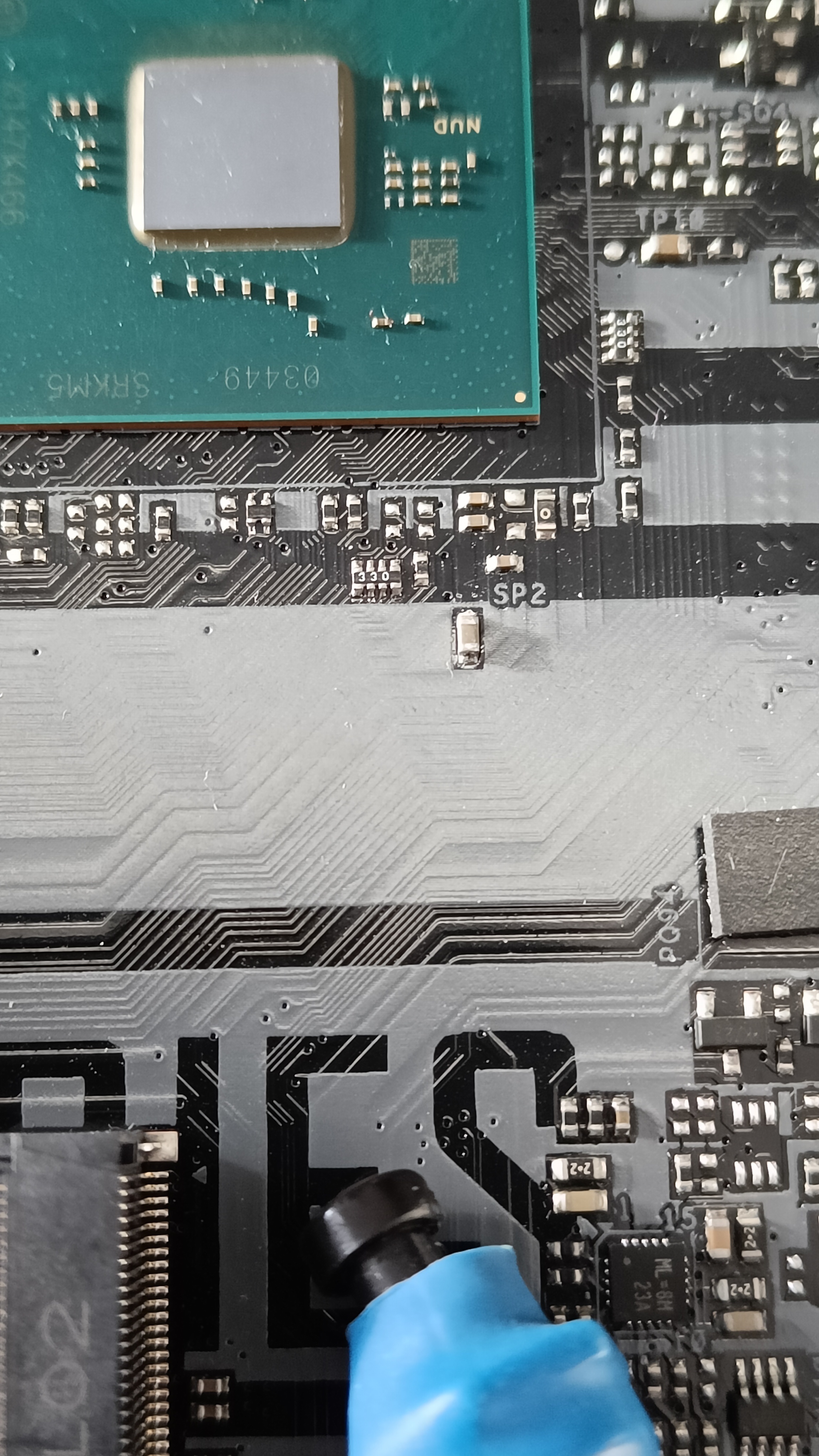

                                      Hy there.
                                      On coil PL53 (1.8VBS) is 1.8V on pin 2 (up) and 2.03V on pin 1 (lower side).
                                      On PL1V2 I have 1.8V on both pins.
                                      On PS2 I have 3.37V on one side (pin) and nothing (no reading or zero) on the other one (my resistor or whatever, is a little in another position, like horizontal) - pin 1 is the same value as the pin 2 of the BC1 (low from it) and same as same as pin 1 of SC15 and SC16 (up from it).
                                      If RTCRST (I cannot find it) is one (left) pin from CLRMOS1 then is 3V.
                                      If RTCRST is one pin of the PWRBTN then is 3.3V
                                      • johnnys25s
                                        • 18
                                        Picture of the SP2...
